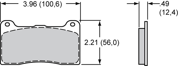

hmm, I did put a pad dimension image in my post from the wilwood site but it's been removed......
weird..............
