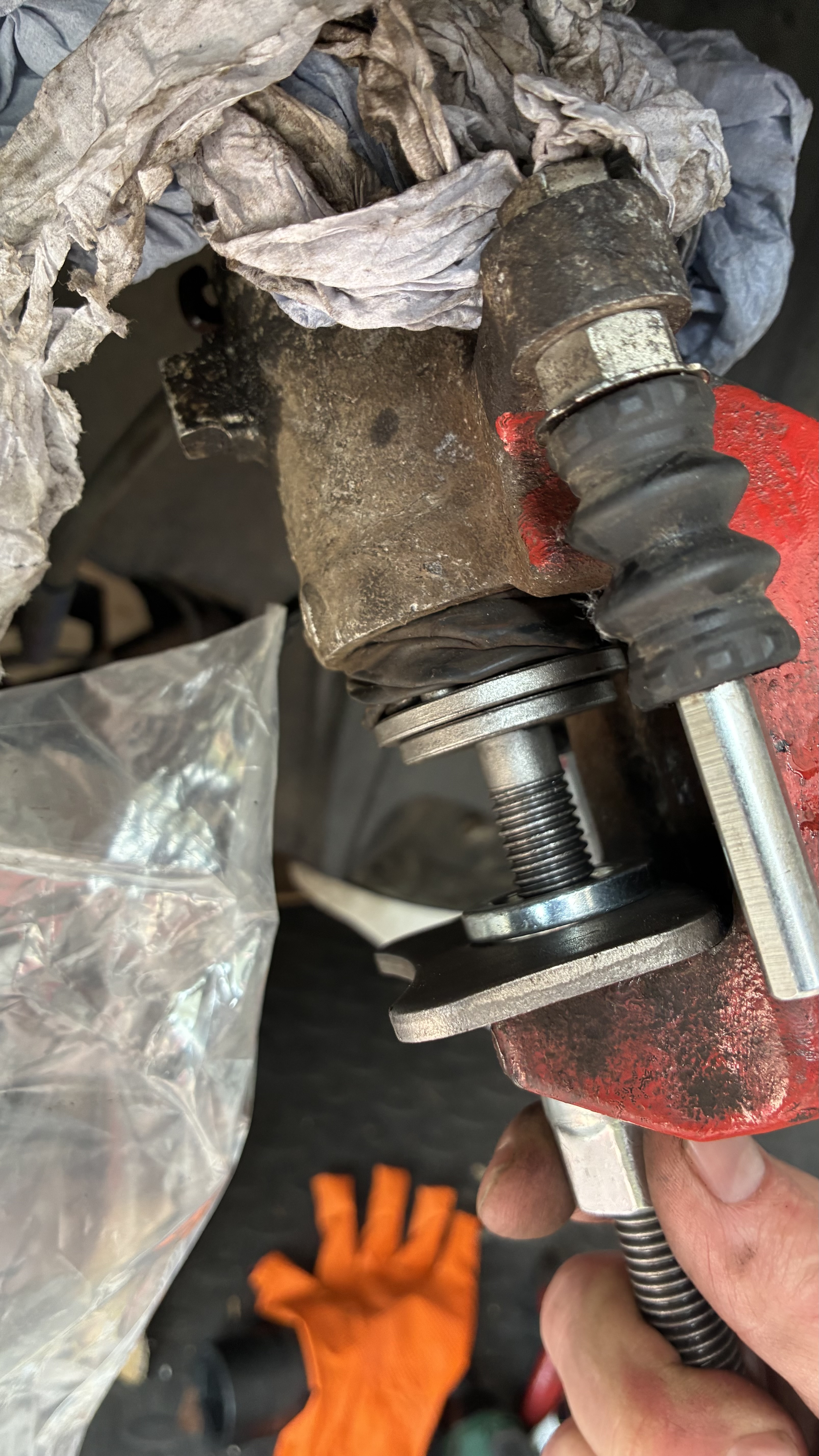

Trying to rewind my calipers and having no luck, on either side....
Have a rewind tool - doesn't matter which tool I use (clock/counter) I can't turn the T bar under tension....
Where am I going wrong please?
That’s weird. I’m sure they are clockwise like Megane’s? Have you taken off the brake fluid cap?
So I wondered if I was just not using enough force so extended the T bar…. It moved a bit but then I stopped to look and now the boot looks rather twisted…
I’m doing something wrong.
I have indeed removed the handbrake cable and the brake fluid res in the bonnet and the bleed nipple here.

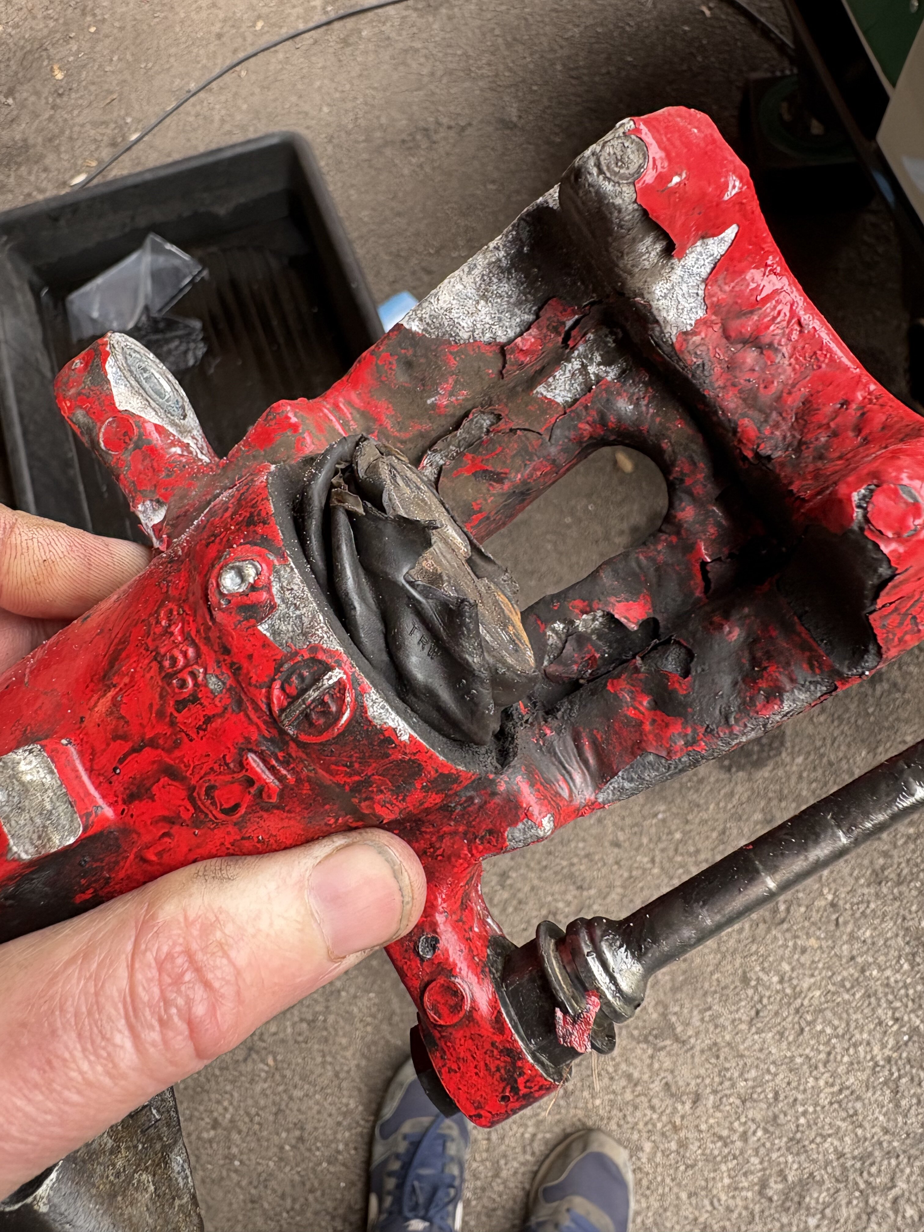

Have a look here @sub

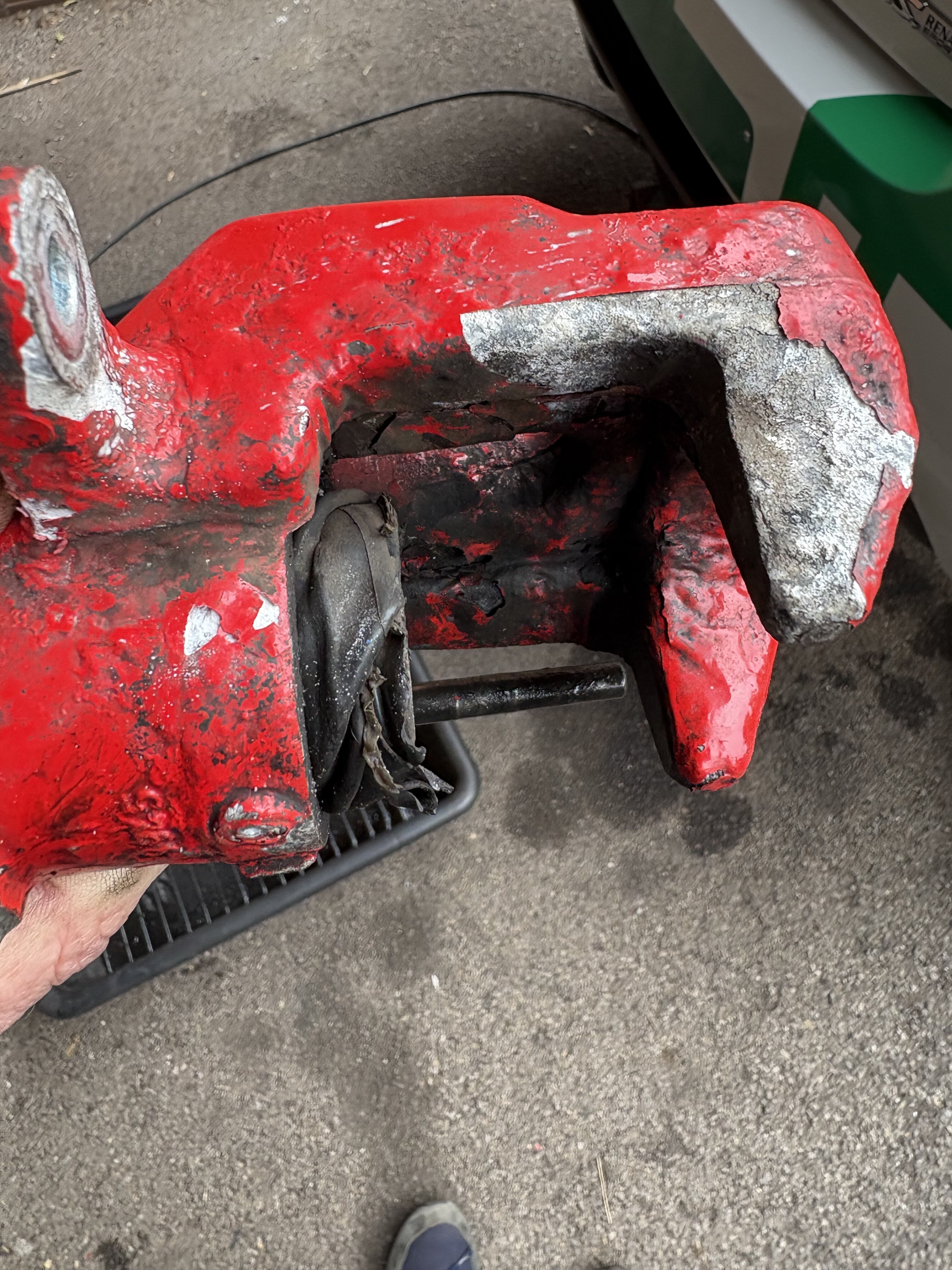

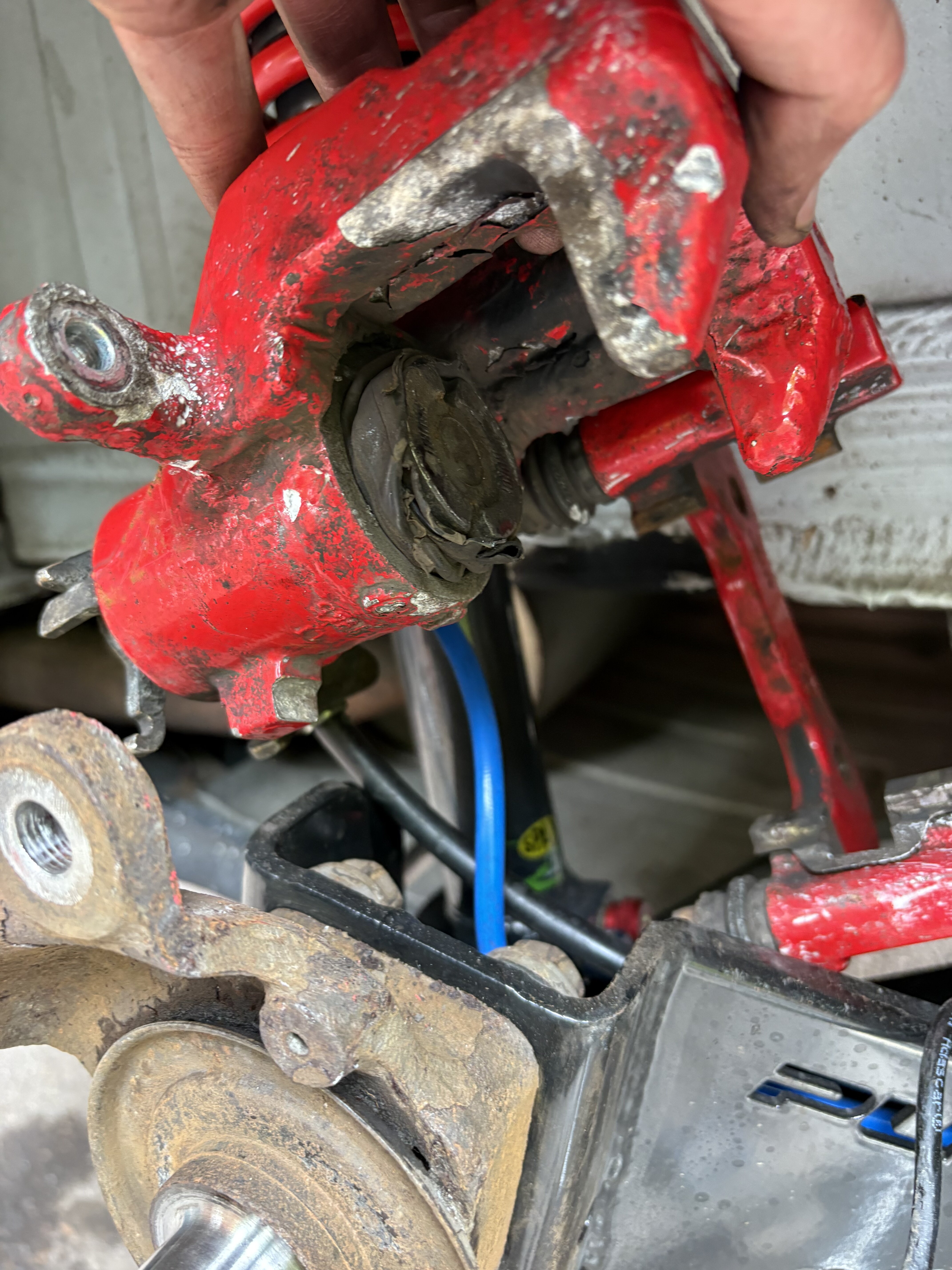

I had this on my rear caliper.. in essence it needs a caliper rebuild. The cover is all twisted so won’t seal properly. Best to get a new caliper or rebuild it…
Here’s what mine looked like

Thanks!
I managed to free the boot and it all snapped back into a much prettier looking boot... will see if I can lube it up....
It's a crazy stiff rewind, but I think I've managed one side.
As above piston starting to seize, its not knackered yet if its moved back in though.
Wind piston out as far as you dare to inspect, prob see a little corrosion. Be mindful if you wind out too far piston comes out and your in the s**t :LOL:
Clean piston up with scotchbrite and wd40, lube up piston with red rubber grease, (lithium grease will get you away if thats all you have).
Wind piston in and out shoud free up. This sorts 80% of sticky calipers out for good.
