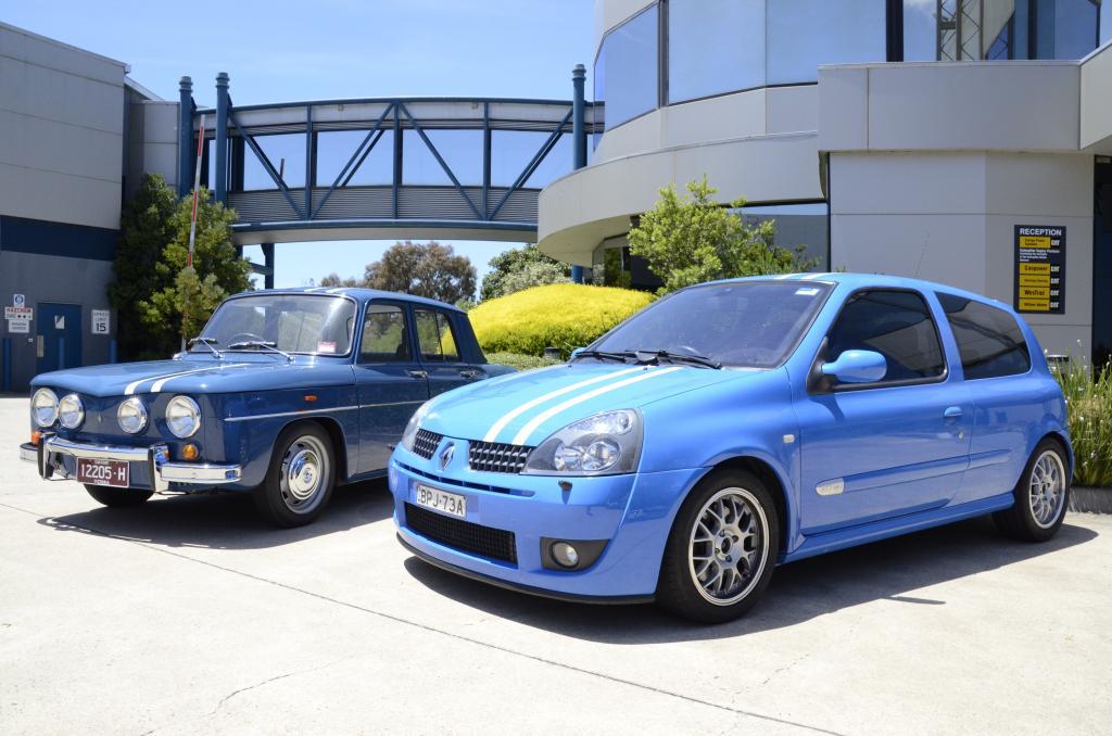

Pic of my ride back when she was a little younger
