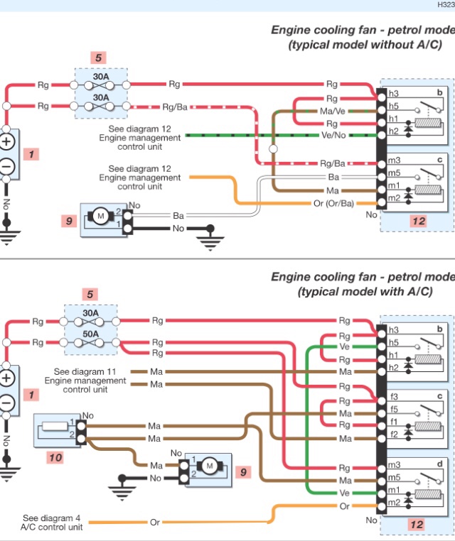

You need to check wires from the CTS to the ecu . Seems to me that the ecu isn’t getting the info .
That said - it’s detecting you pulling off the connector and activating the fail safe .
Make sure you’ve checked that the replacement CTS has the 3 pins to match the 3 wires , I’ve seen people say that only 2 wires are present , so maybe only 2 pins may only be present on the switch . I’d like to think that a default 3 pin switch was the only one that could be purchased , but I may be wrong .
Is your car with or without air con ?
Few wires to start checking .
Pic is a general one not model specific , but Clios generally run the same across the range.

Yes, I thought it might be a wiring problem and thank you for such a detailed reply.
And yes I generally search 1.4 Clio problems when dealing with snags on the Kangoo as aside from the body shell, I believe there is not much difference between the two and I have had a Mk1 Clio 1.4 to notice a fair few similarities. I fact I used to consider the Kangoo as a Clio van.
But no no air conditioning on my Kangoo.
