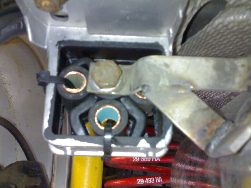

My exhaust hangs too low below the bumper,
bought the car like this,
anyone got a guide and a list of what I need to buy/do to make the exhaust sit up in the bumper more.
Need to push the backbox up to the required height (use a jack with some padding if needed) undo the bracket and push it up (basically re shape the bracket) around the backbox. Takes a bit of work but is possible.
Do this, you can pack out the holes with anything though tbh....
Okay, ty mate, so cable tie it tightly.
I think the problem is, the car was fitted with the exhaust a month ago?
Perhaps i need to reshape the mount?
yeah but, arent I meant to put a jack and padding under my backbox and start to jack it up so it bends the mount thats connected to my backbox?
