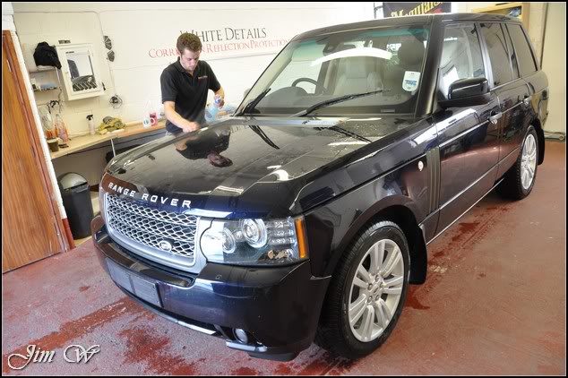

Range Rover Vogue SE – Major Paint Correction Detail with Interior & Leather Care
A three day booking required to bring the Range Rover back to showroom standards both inside and out.

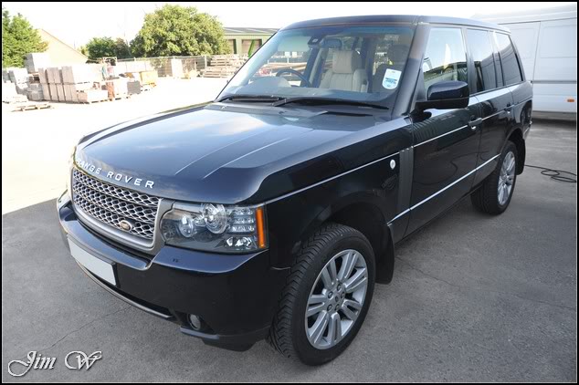

Inspection.

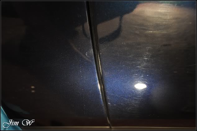

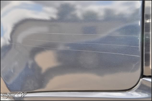

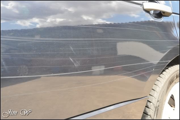

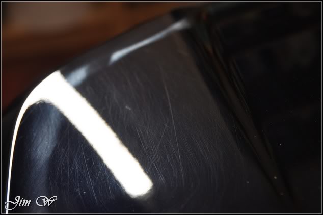

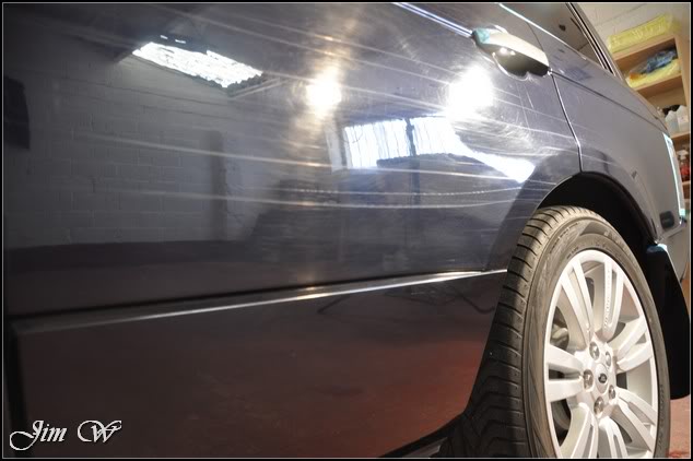

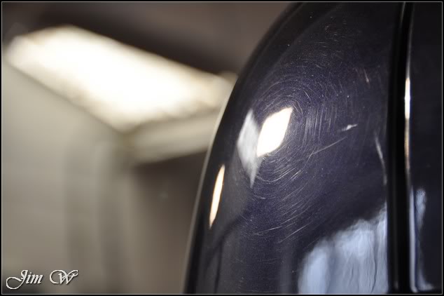

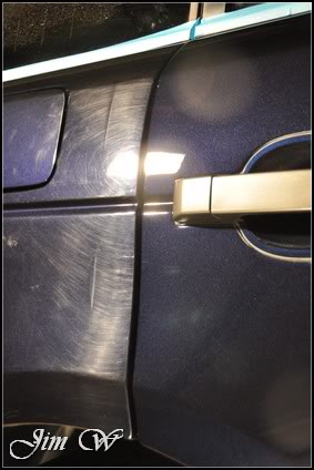

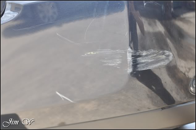

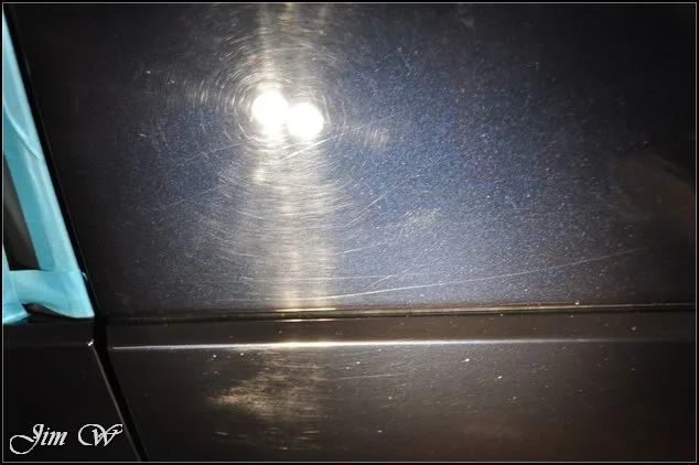

One or two deeper scratches down the N/S:
…make that several! (hedge inflicted)
Oops. “You missed a bit!

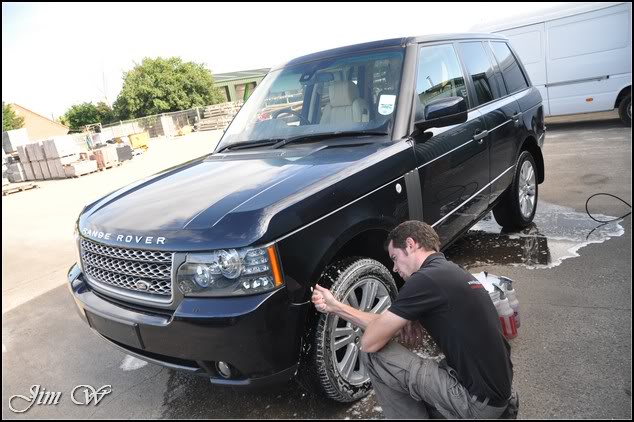

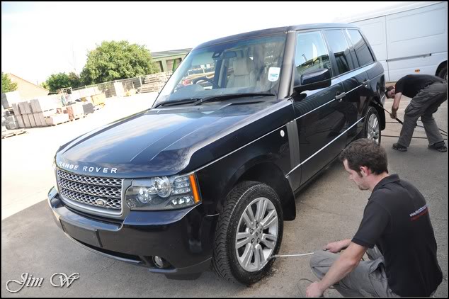

As per, starting with the wheels and arches.

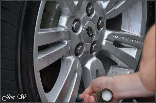

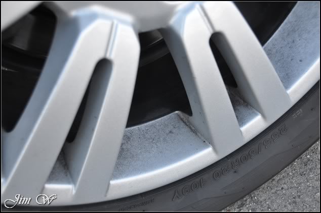

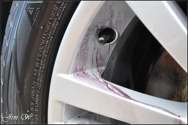

Pre-soaked in AS Hazsafe and jetted down before scrubbing the tyres with a degreaser and allowed a wheel cleaner to dwell before light agitation.

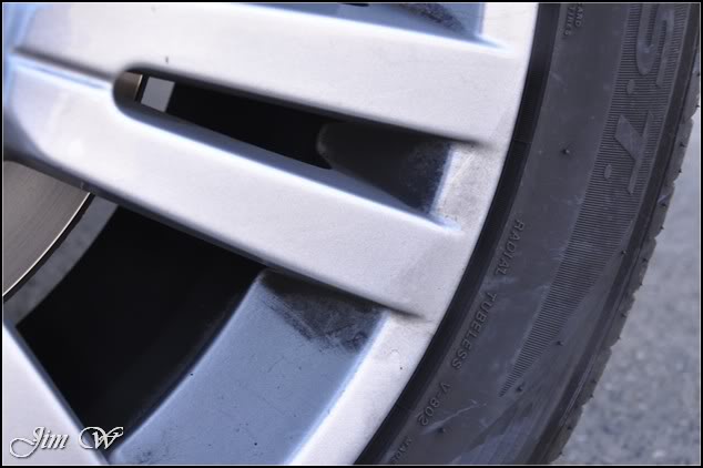

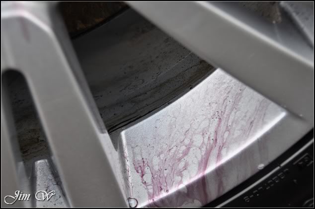

The wheels were heavily pitted. Requiring LOTS of Iron-X to break down the dusting and leave a like new finish.
From memory, each wheel took a minimum of 4 hits to get right. Each time allowing the product to dwell for 5+ minutes before agitating with various stiff bristled brushes.

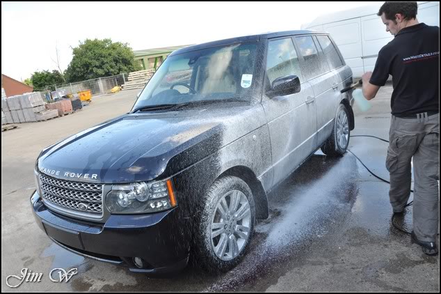

AS Hazsafe used to pre-wash the vehicle before moving on to AM Snow Foam and Shampoo for the safe two bucket wash.

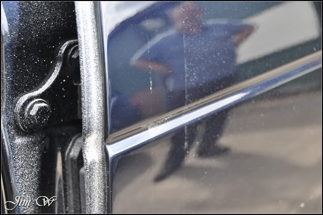

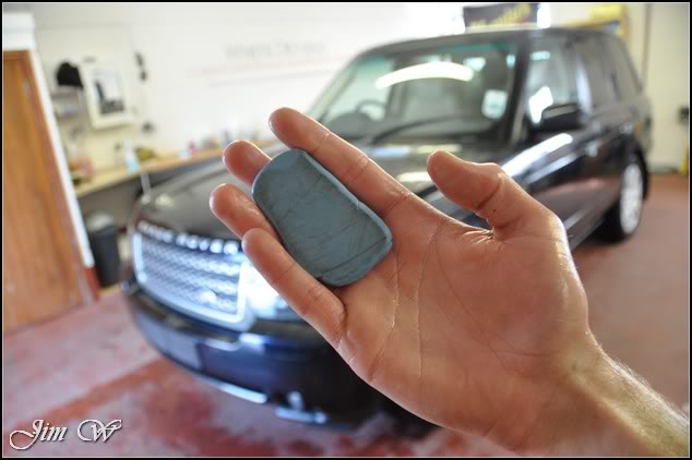

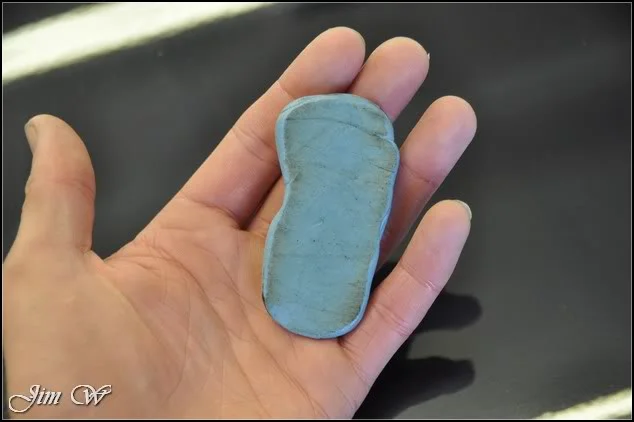

Moving inside for the claying stages, AM Mild Clay Bar was used alongside ONR as lube.
Lots of surface contaminants removed:

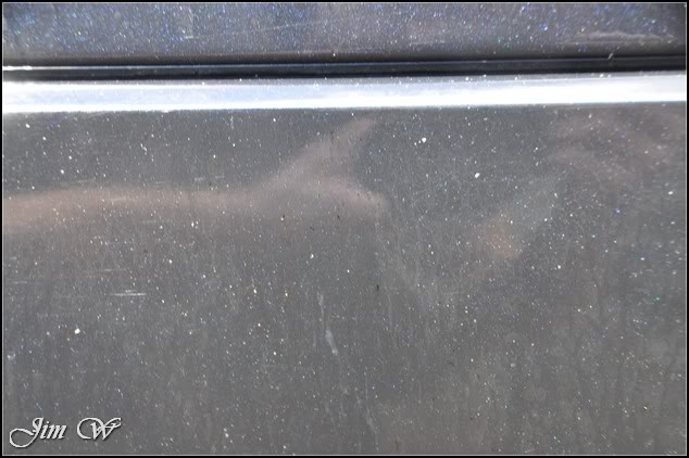

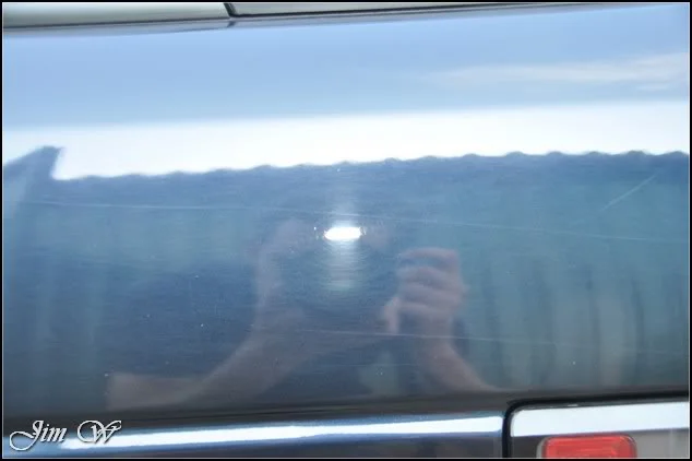

Something I wasn’t expecting, massive amounts of tar on the rear window:

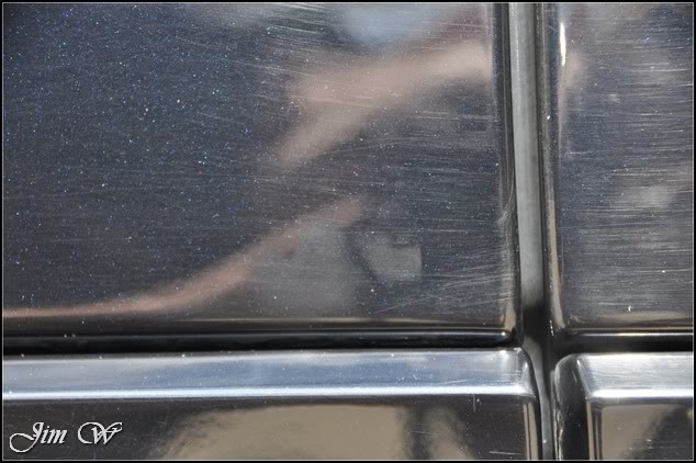

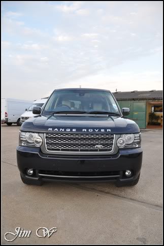

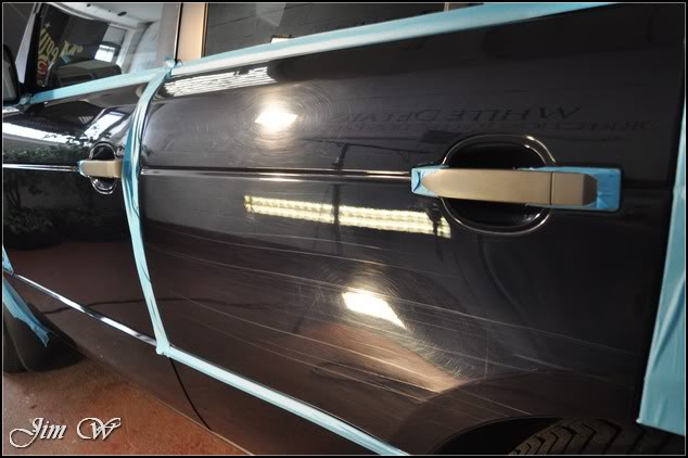

With the vehicle clean, contaminant free and blown dry, it was brought back outside for a better looks at those defects.

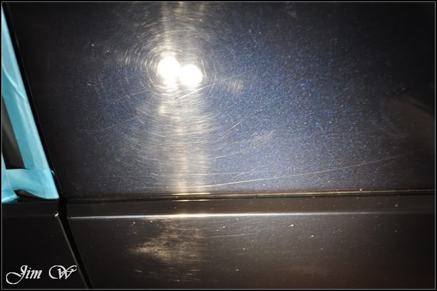

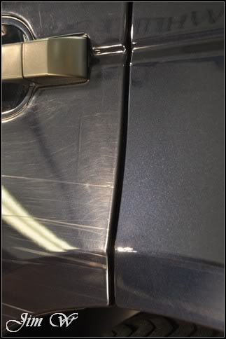

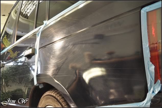

Scratches on the N/S from hedge encounter
Aswel as the scratches, the N/S/R door and wing had been resprayed. Badly.
A dull, heavy, lifeless finish. This is main dealer Land Rover work, too.

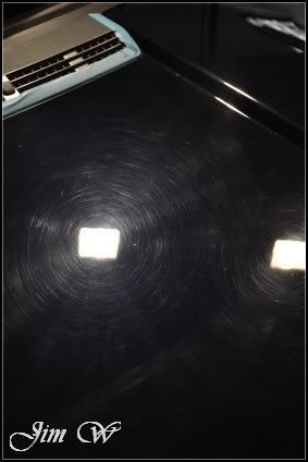

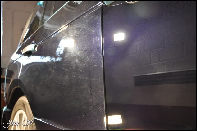

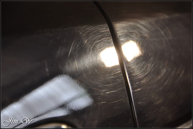

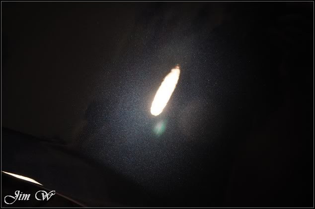

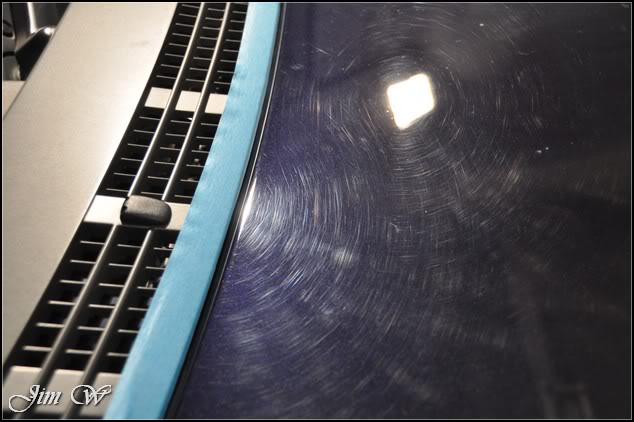

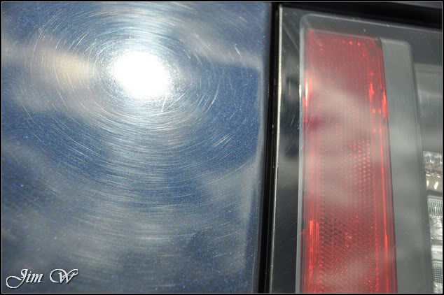

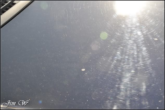

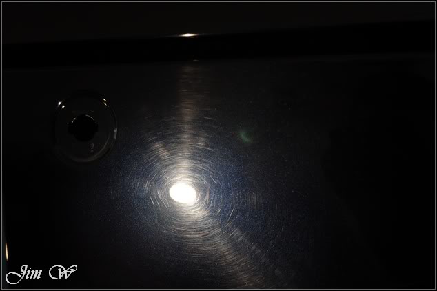

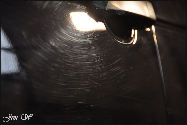

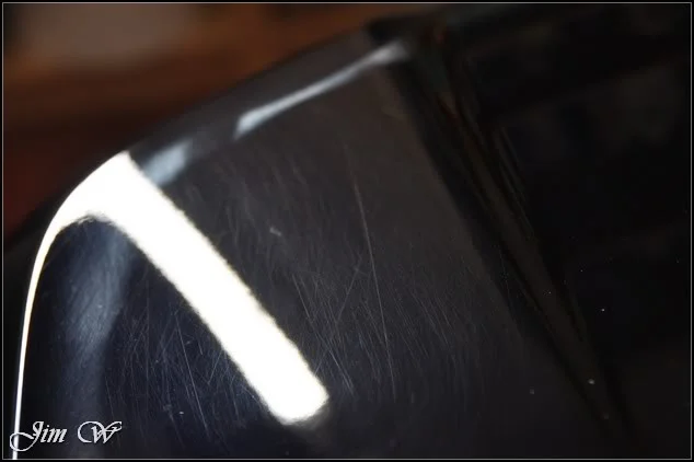

An example of the general ‘haze’ that was covering the car:
and a nasty bumper on the N/S corner of the rear bumper:

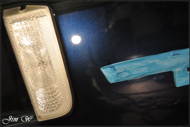

Inside under the forced lighting: (plenty to get stuck into!)

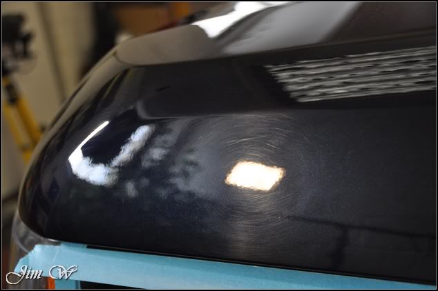

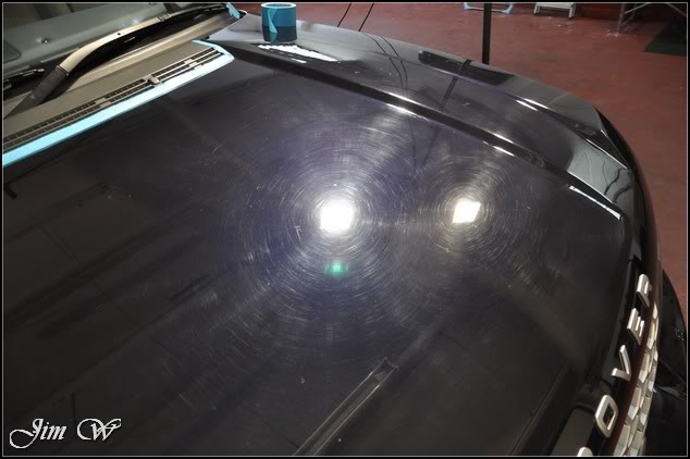

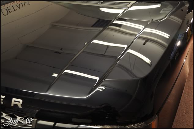

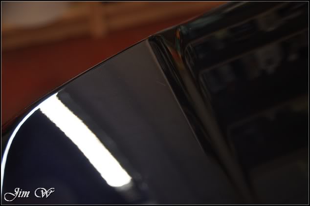

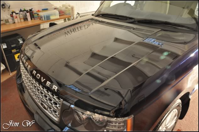

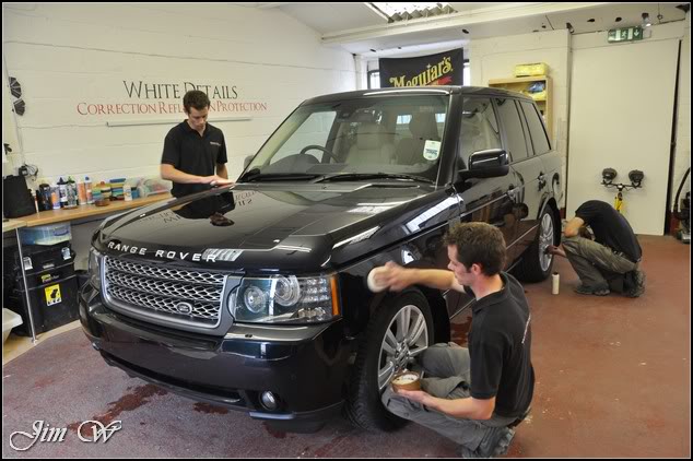

Starting pad and polish combinations on the huge bonnet.
Before:
50/50:
Happy with the results, I power on through down the O/S.

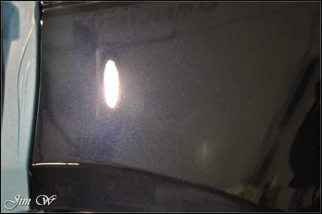

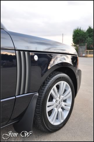

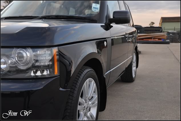

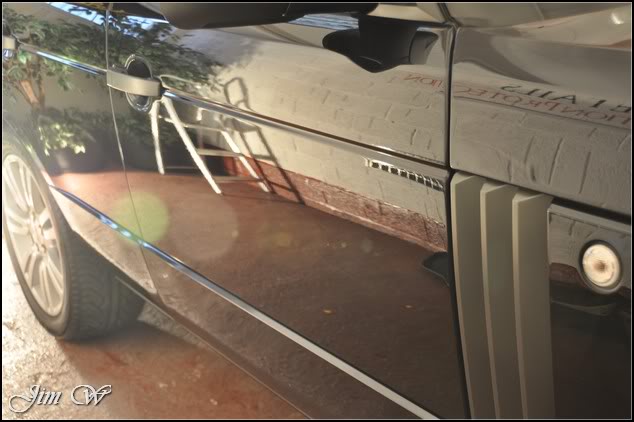

Wing before/after:

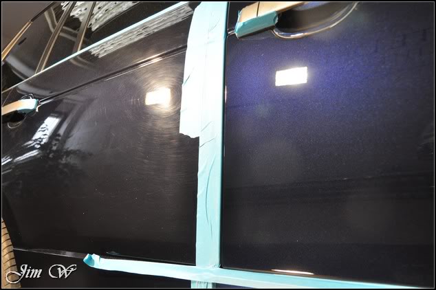

50/50 between O/S/F door and the bonnet edge:

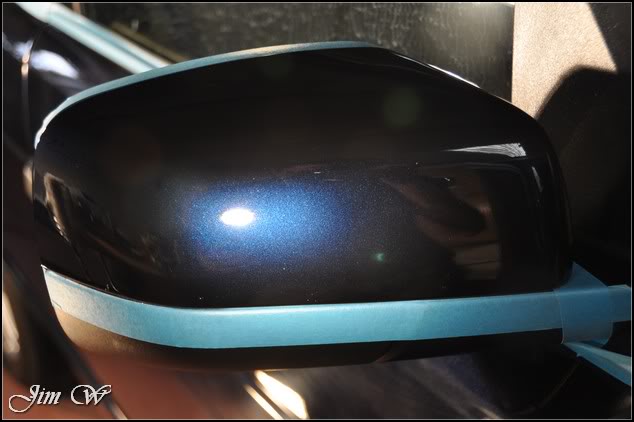

Mirror after:

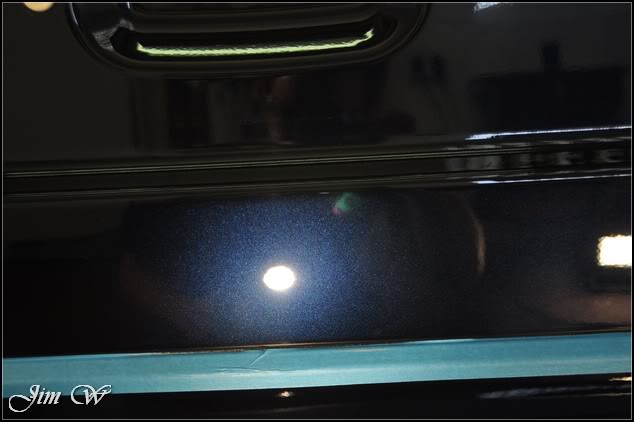

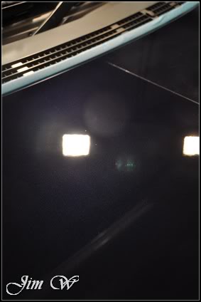

in the refining stage with a blue 3M finishing pad and Menz 106FA:

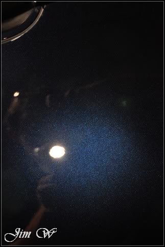

A few IPA wipedowns to pull out remaining polishing oils and then checking correction levels and finish with various light sources:

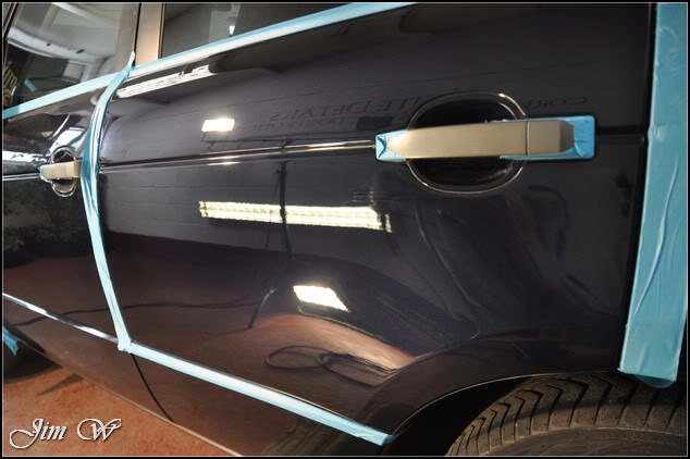

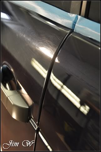

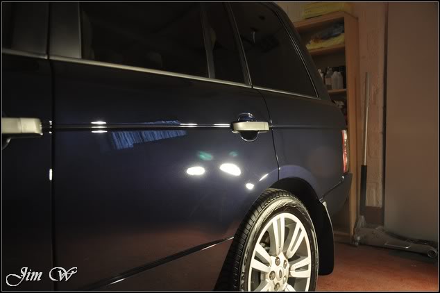

50/50 between O/S doors:

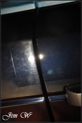

O/S/R door before/after:
A great example of how badly swirls and scratches can steal the colour/depth of the original paint hidden beneath.

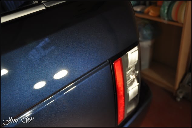

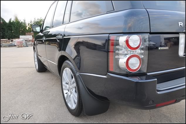

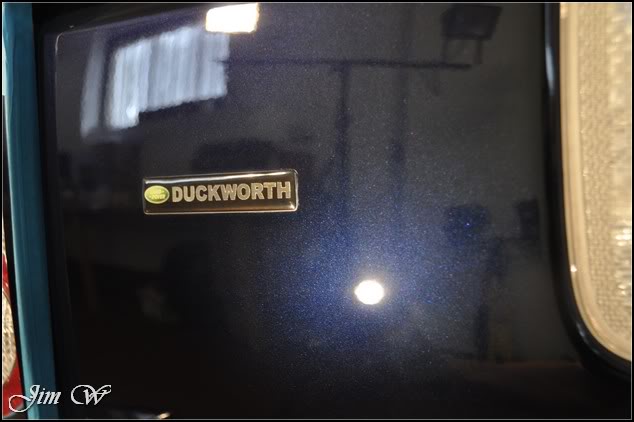

Rear quarter before/after:
Boot lid/tailgate before/after:

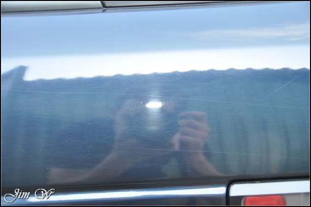

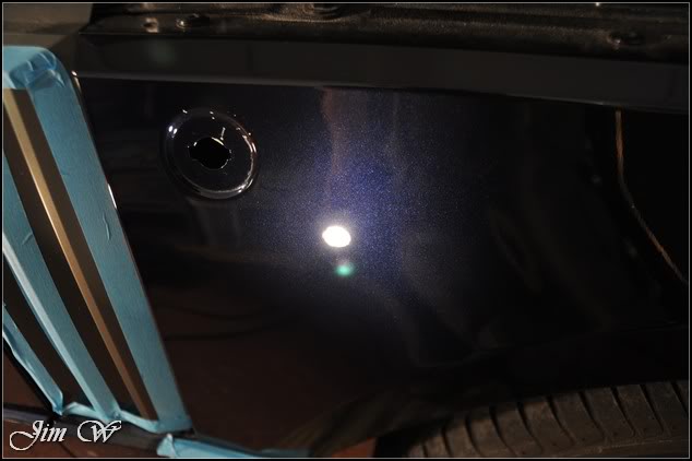

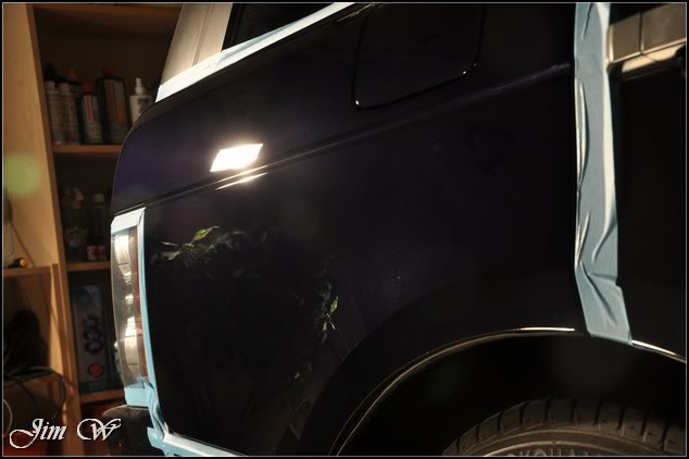

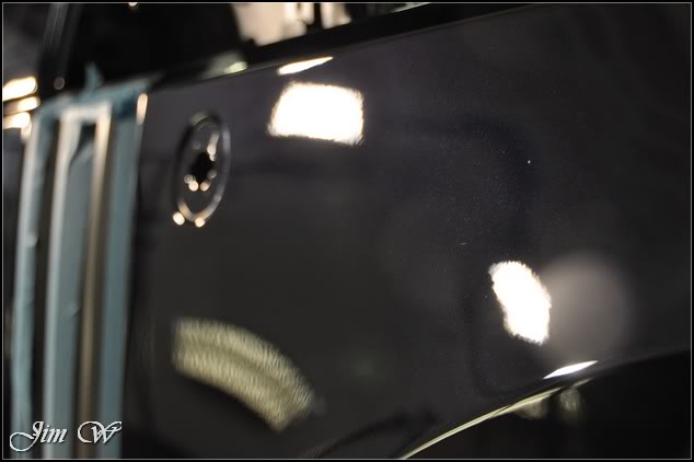

The flat resprayed N/S rear quarter ready for some heavy correction:
After:
A N/S rear 50/50:

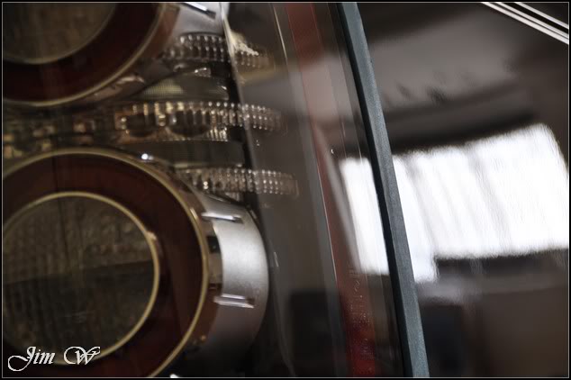

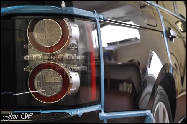

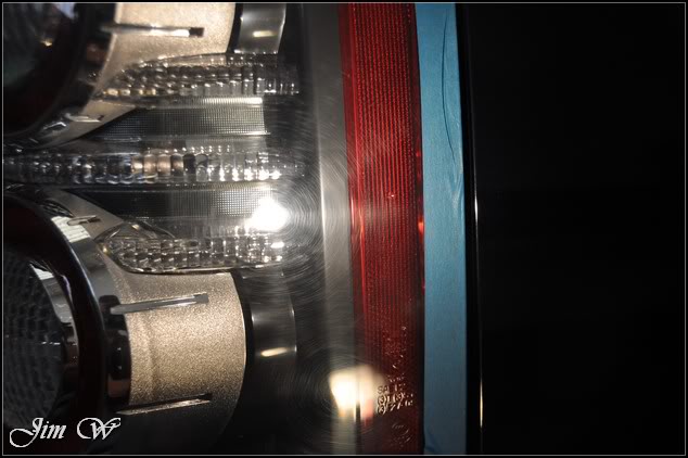

Rear light clusters before/after:

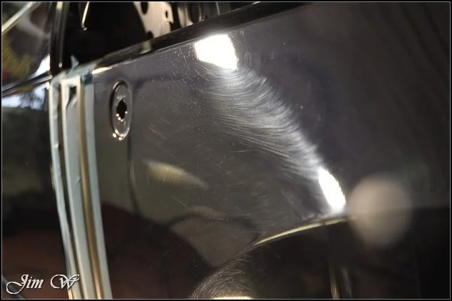

To get ‘right’, this one (the badly scratched N/S/R door) took some time!
50/50:

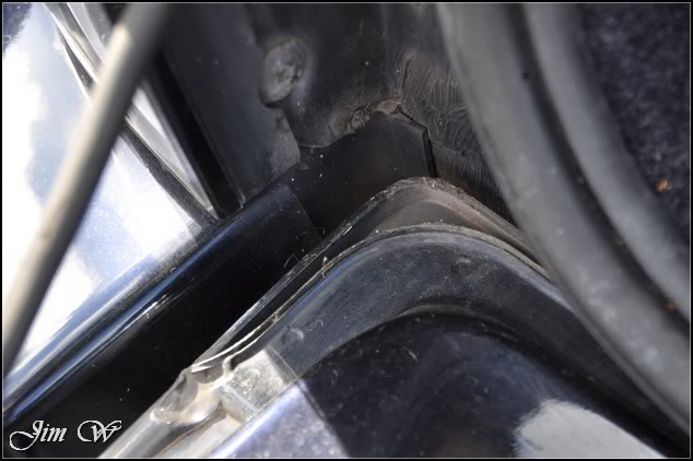

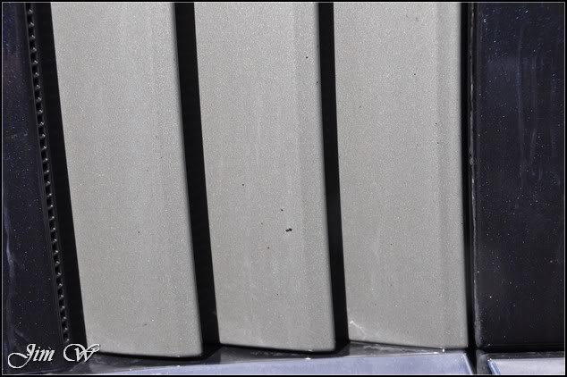

Down on the lower sections, a nasty burn through/chafe on the delicate leading edge of the panel.

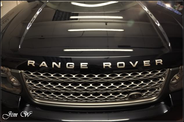

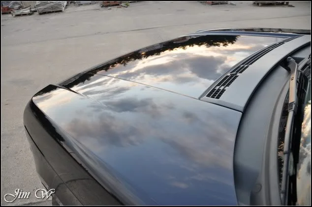

Finishing the rest of the bonnet.

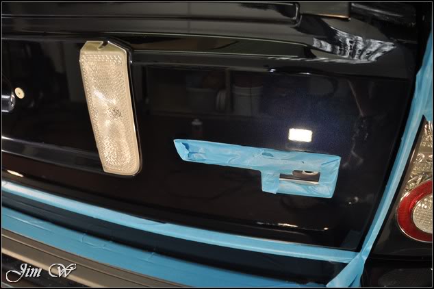

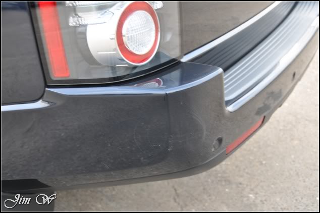

After multiple hits with wool, there was little I could do with the scuff on the rear bumper. No where near perfect, but, vastly improved.

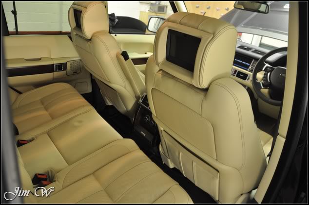

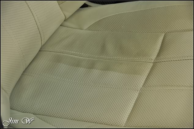

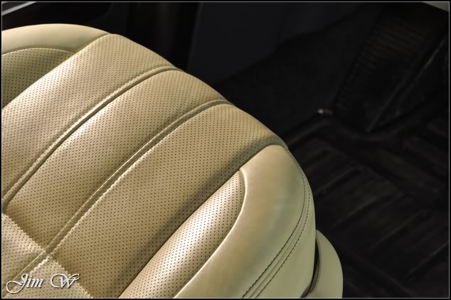

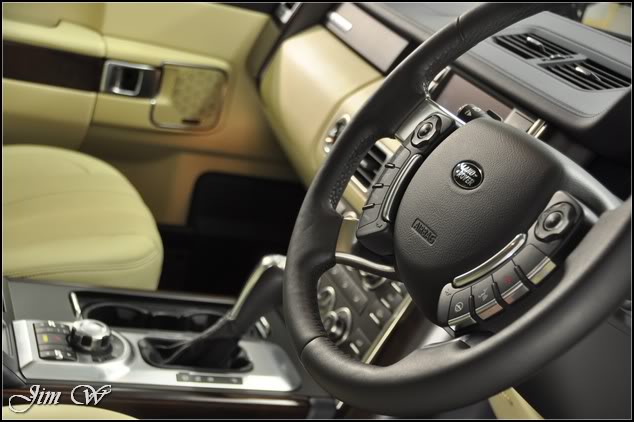

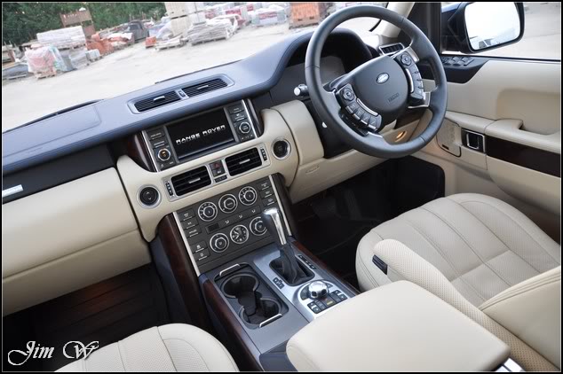

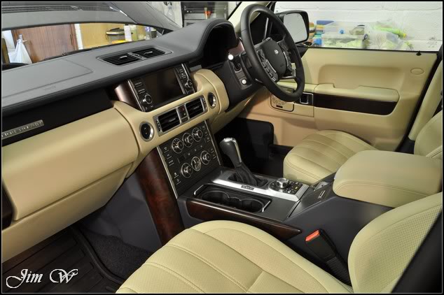

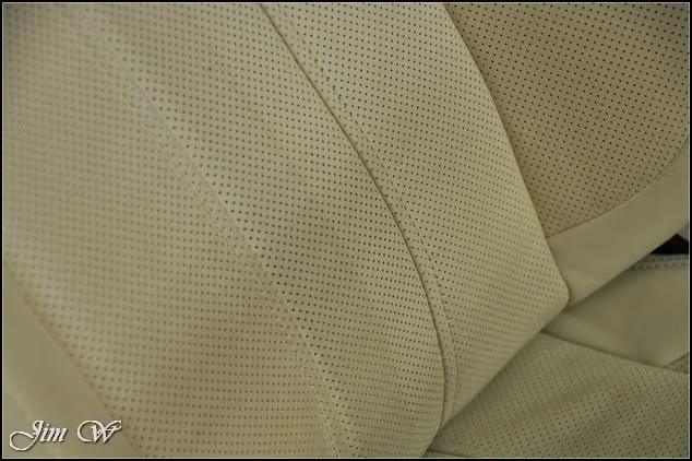

Moving on to the interior. Leather in need of a deep clean!
Two 50/50s throughout the leather cleaning process:
Any other leather trim was cleansed with LTT’s Auto Foam. Plastics, rubbers and visors etc wiped clean with a mild AS G101 mix.

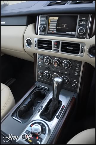

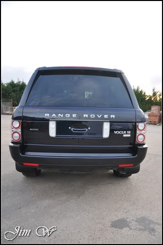

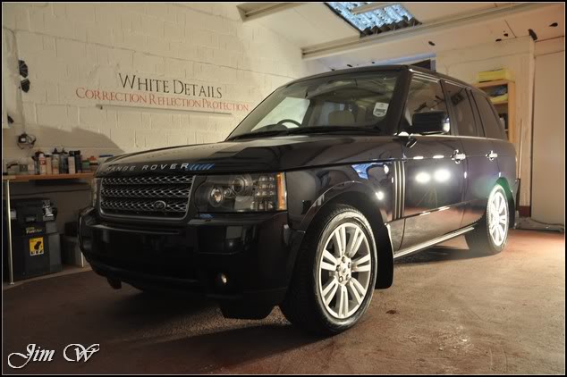

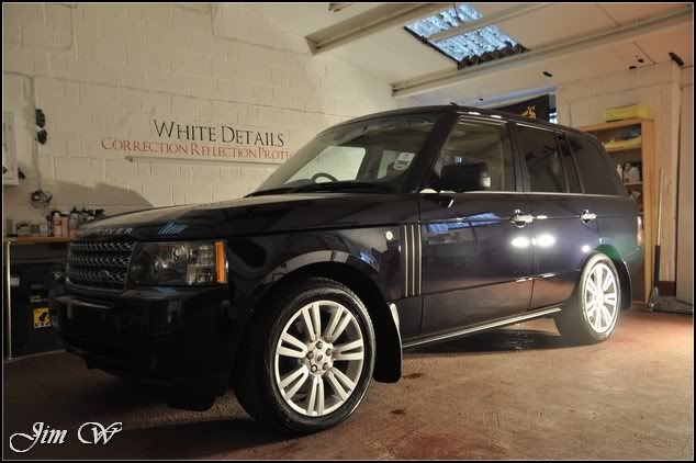

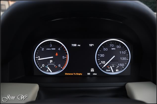

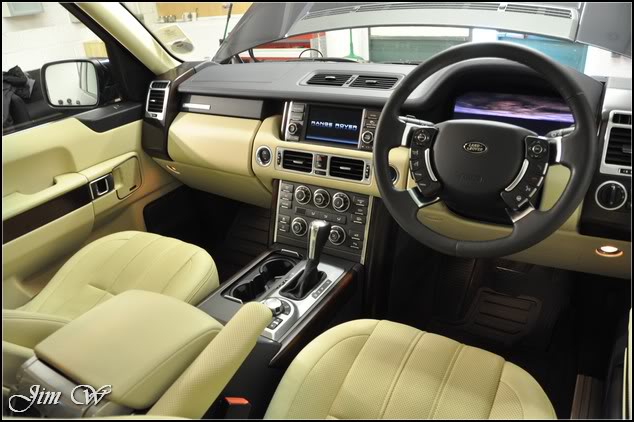

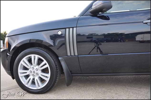

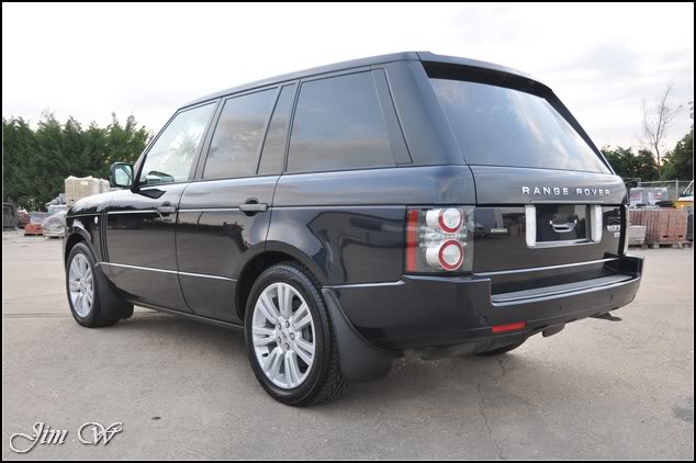

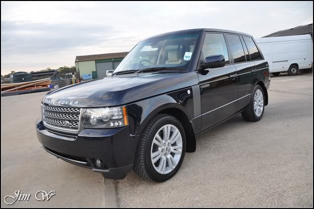

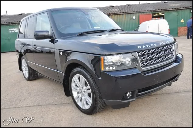

31 hours later, the Vogue sits awaiting collection:
Remember that scuff?

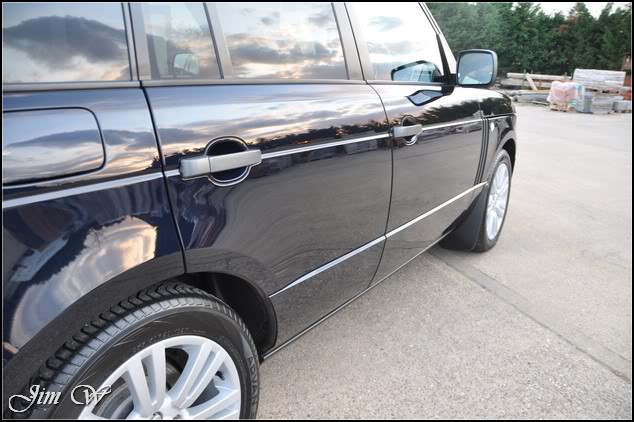

Much better:
Excellent. A nice turnaround here!

How the hell did you get rid of those dreadful scratch marks down the side?! Top work as always.
They were pretty bad to be honest. Was very impressed that they came out - wasn't easy and took a while, but, got there in the end. Finishing Land Rover paint can sometimes be a little tricky; marks easily so have to be careful when compounding/finishing to make sure you're not leaving trails behind.
