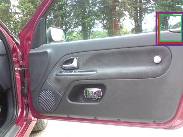

Rattle, is it fixable? (see attachment)
Basically had to take my door apart once to fit the electric window motor.
Now, the inside door pillar plastic sits a bit high, and there is a gap (as seen in the attached pic, not my car but shows the same bit)
Basically when driving that area makes a rattle. When i push down on the pillar (closing the gap between the pillar plastic and the rest of the door card) the noise goes, but after a few seconds the gap pops into existance again and the rattle returns.
All of the clips for the doorcard etc are intact... is there anyway i can force the pillar to stay in its correct position so it wont make this rattle?!!!

I have just used a little bit of sponge behind.
Also, if you take the trim off, you will see 2 or 3 clips and circular plastic washer type things. Basically i glued these to stop them from moving, fixed it :)
