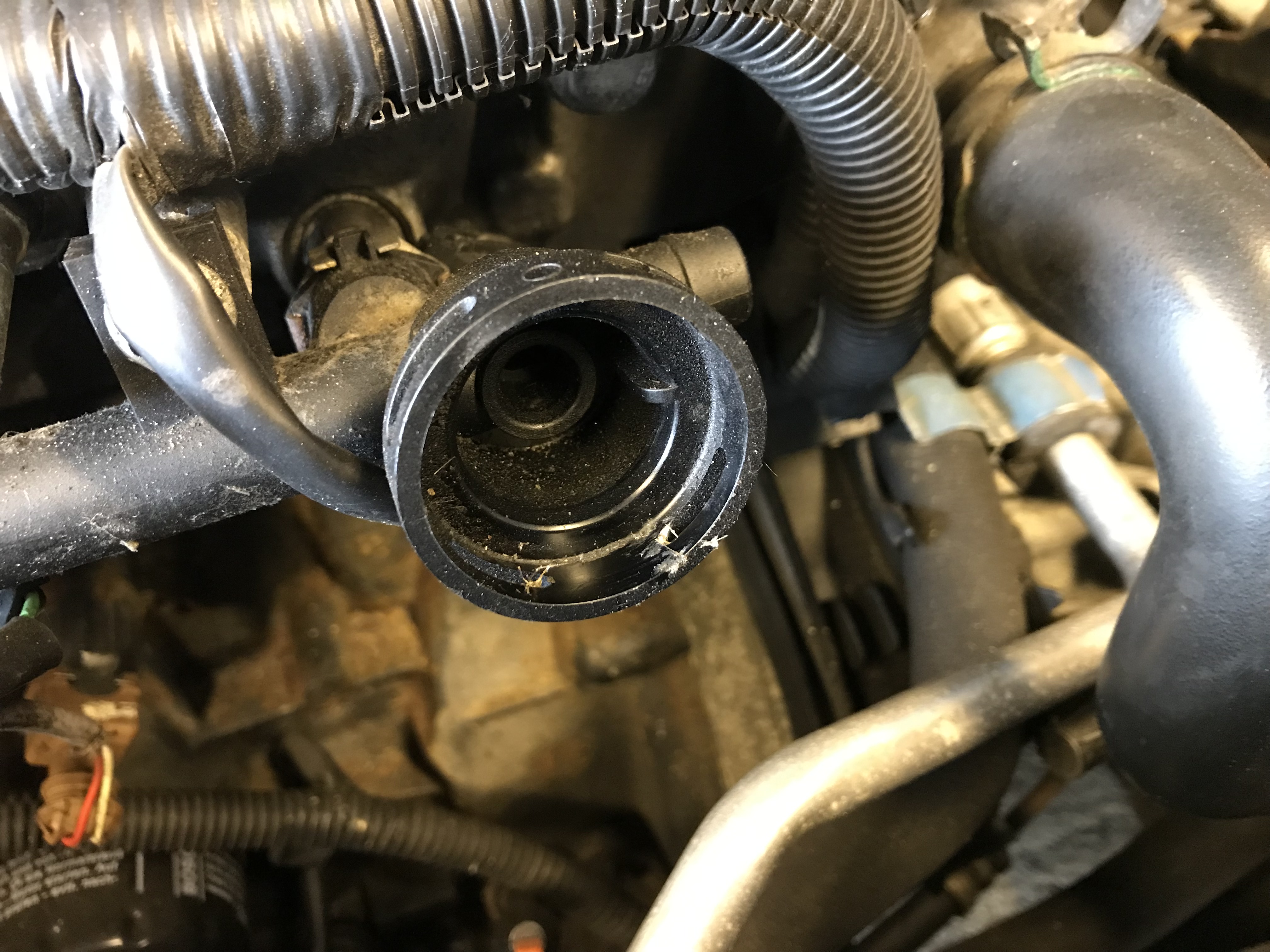

Hi, I removed the fuel rail guard to get better access for an oil filter change and noticed what I assume was a fuel pressure regulator attachment is blank/missing. Is that standard or an aftermarket adaptation as it has an ITG air filter/feed in place of the OEM filter/feed setup.
