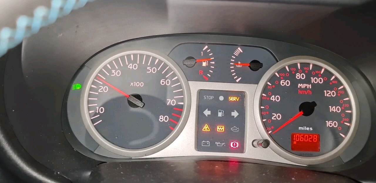

Another update with only a couple of pictures this time as its mostly been electrical issues.
The airbag light has reappeared after a long time of not seeing it, this time it wouldn't go after cleaning so got it to a specialist for looking at with a CLIP, it appeared that it had been coded incorrectly previously as it was showing all sorts of codes that they weren't expecting, promptly reprogrammed and the light has gone again, hopefully for good this time. Whilst it was in for that I also finally got the PAS fluid replaced alongside the switch, the revs no longer drop when turning at low speeds even at full lock, not sure if the pump has quietened with the new fluid or its just placebo but it just sounds smoother for general driving as well.
The other electrical issue they found that I wasn't aware of was the rear indicators crossing over when braking, and fog lights not working (Not that I ever use them), just required cleaning the contacts and was all good again.

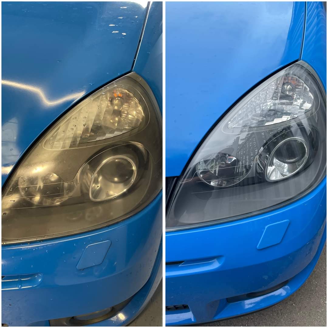

Headlights had started to go yellow and hazing again, this headlight kit I have seems to last less and less each time, figured it was time to just get it done properly:
Seem yellower in the picture than I remember so either they were worse than I thought or it's just the lighting they used made it look a bit worse.

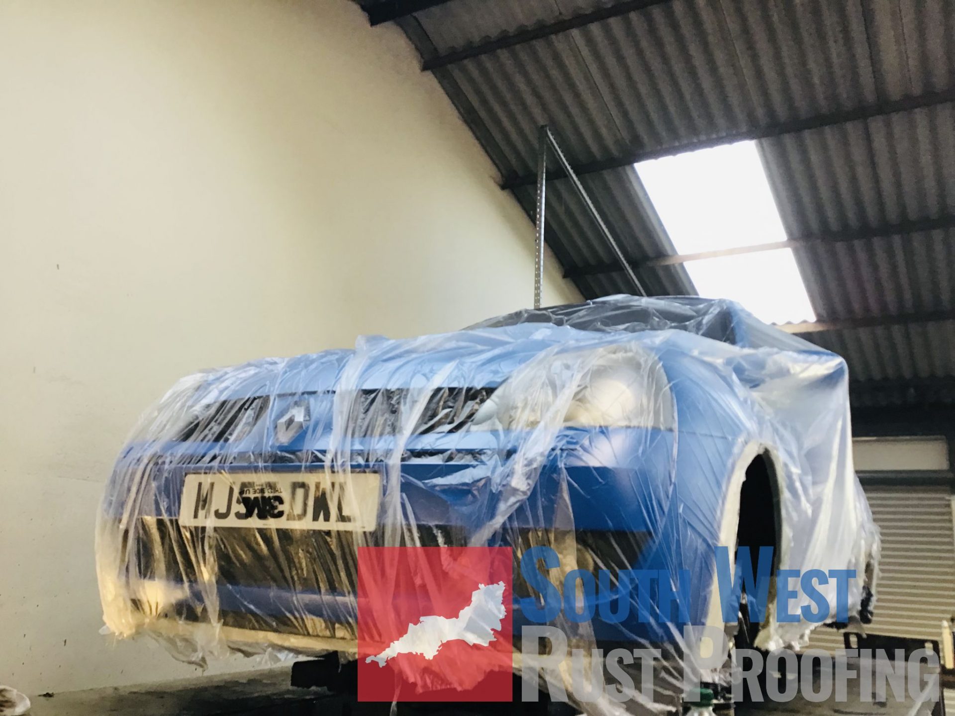

Was only planning to treat and sort the underside of the car for rust in the summer, so far the weather hasn't been the best for this with nowhere dry to store anymore, and quickly running out of time that I can get it done this year. Luckily there are no major rust issues yet, but I am starting to see signs of it creeping in, in particular areas so want to get it sorted sooner than I would be able to myself. Will be looking into some professional options of getting it done, and that will probably be the next major update, hopefully within the next few weeks...
Travis

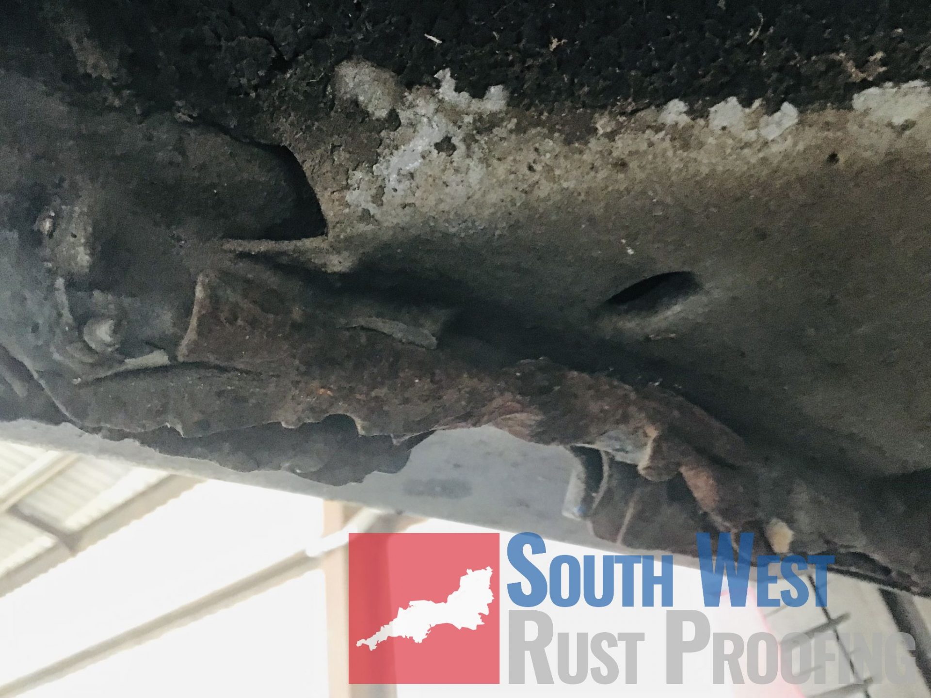

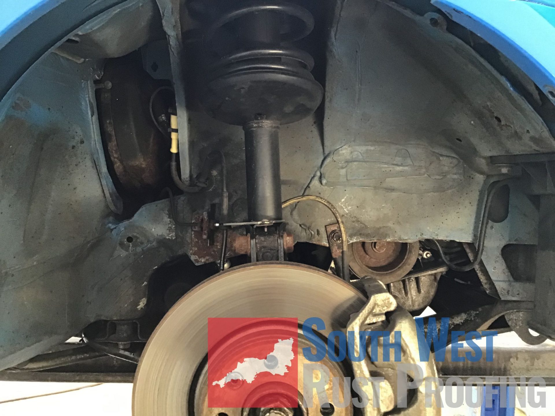

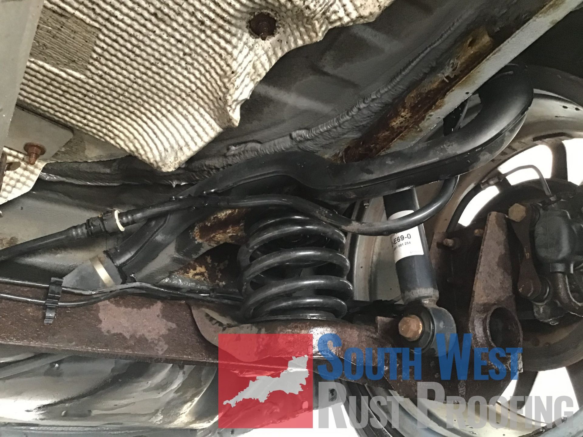

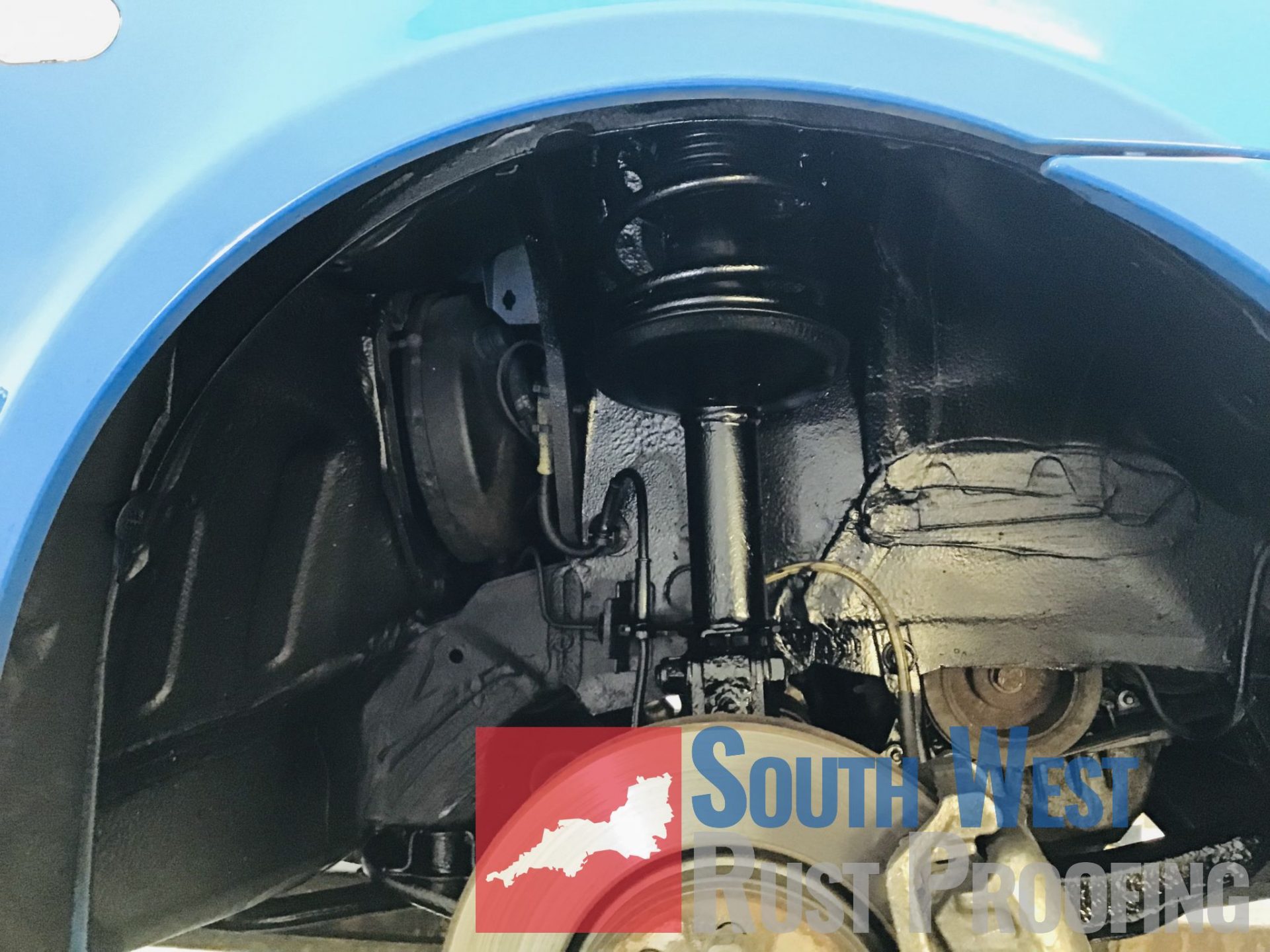

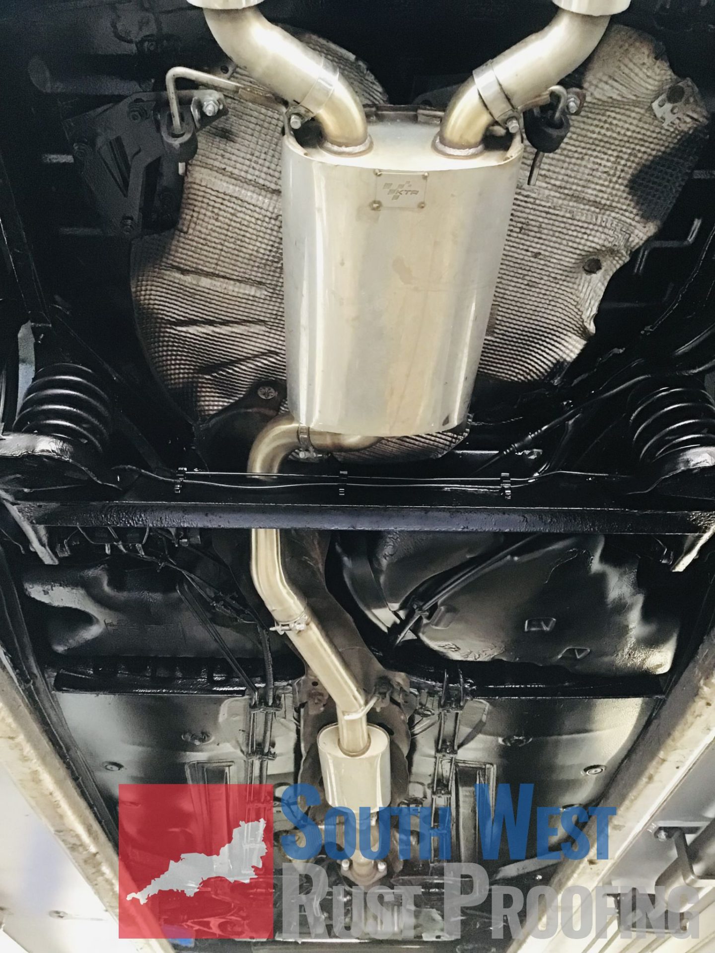

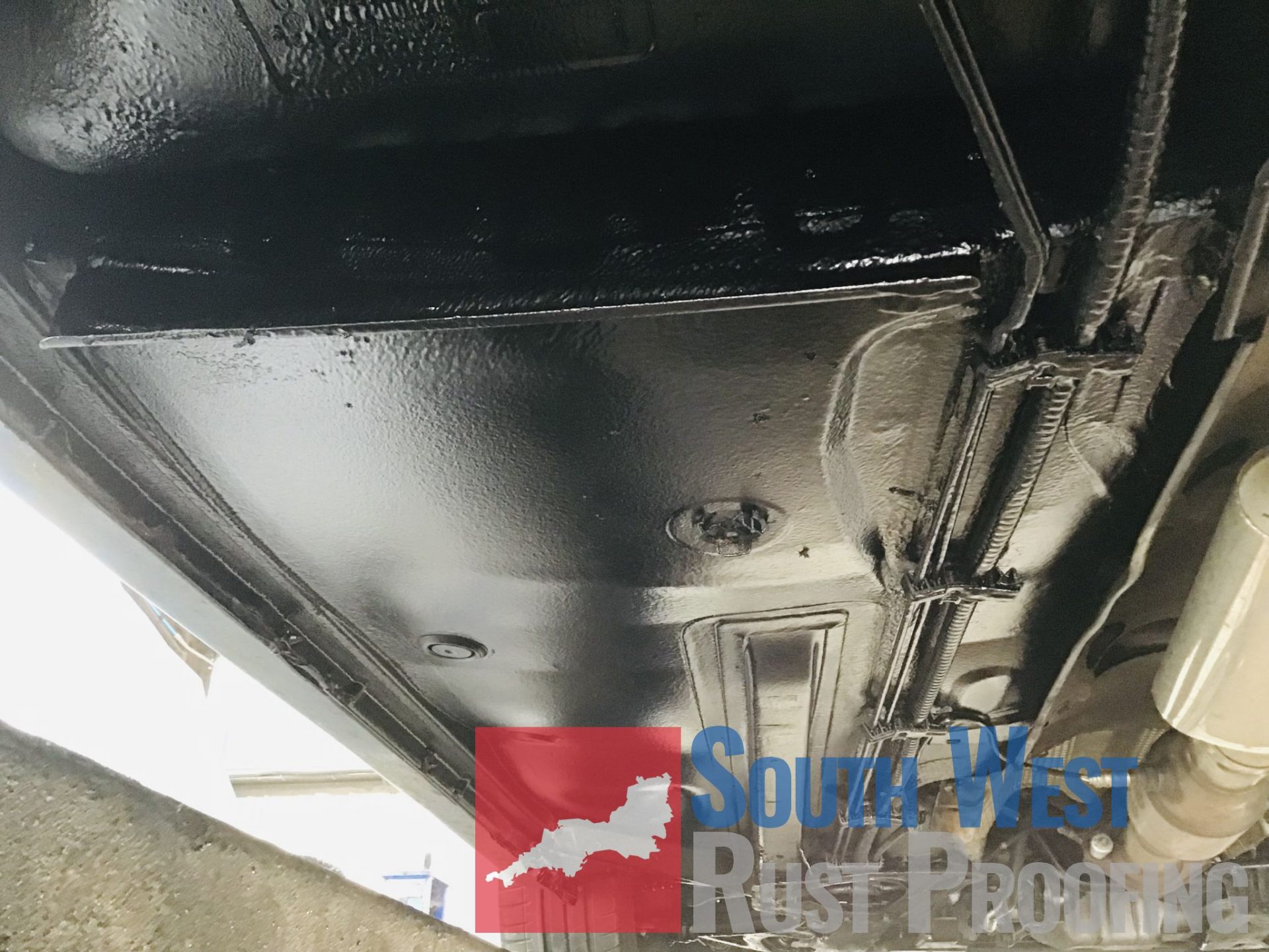

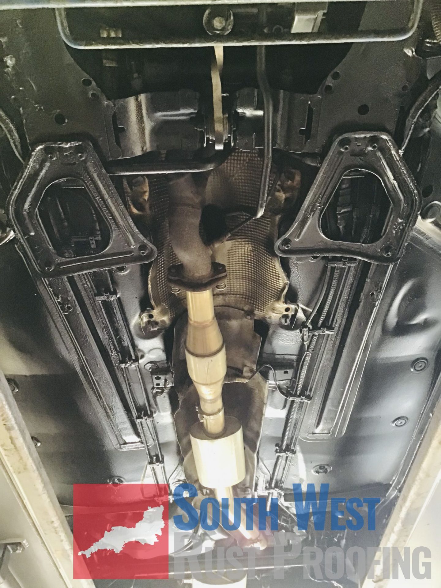

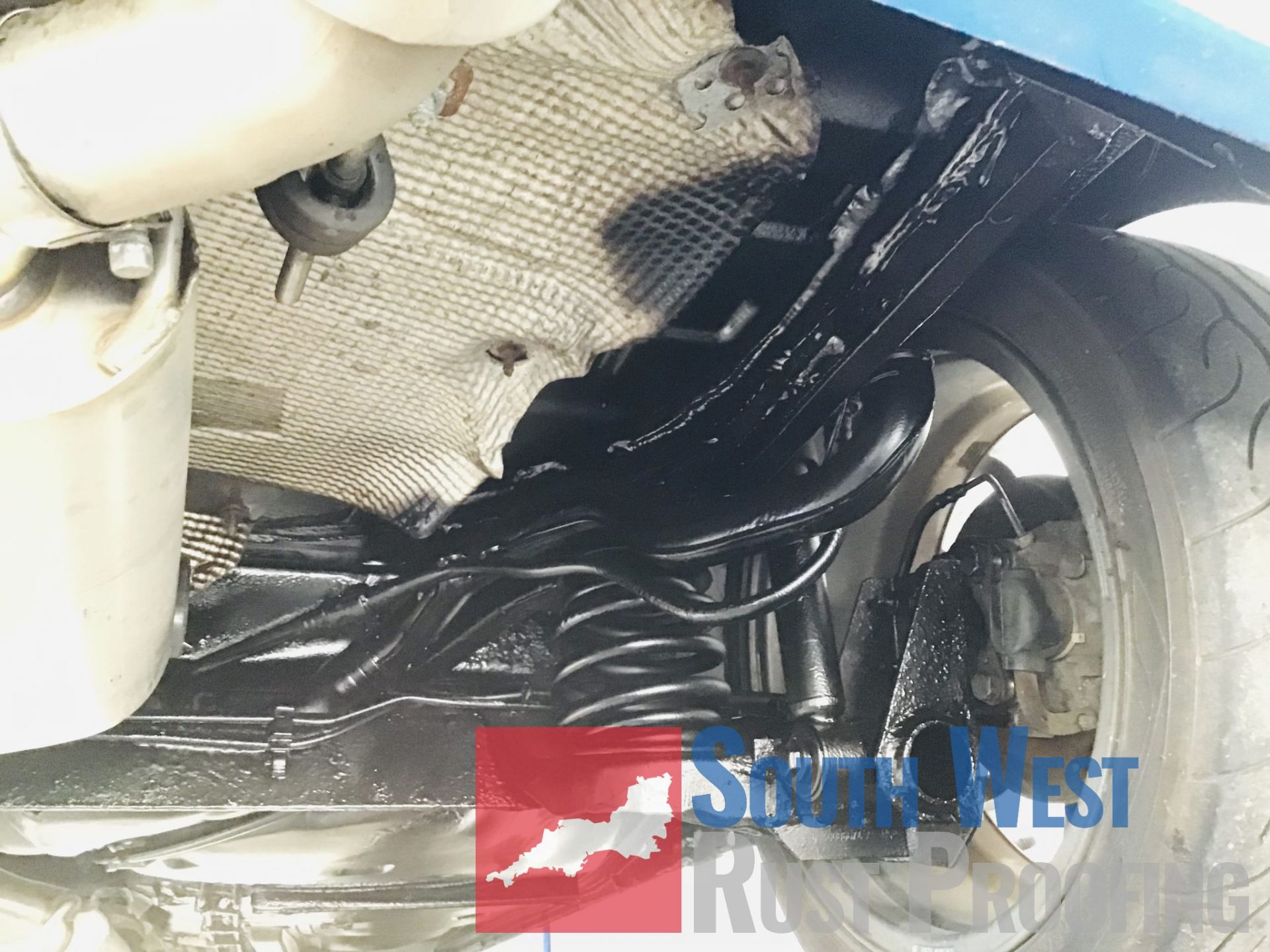

Just finished being prepared and treated at a Rust Specialist, think its obvious who in the photos. The whole underside, sills, internal cavities (Inside doors, boot etc.) have now been cleaned, treated and protected. This should see it through at least a few more years...
It wasn't as bad as I was expecting compared to the life its had so far, nothing that wasn't treatable apparently including the sills which I had expected to need a more serious repair. Just a few of the highlights below:
Before:
After:

That looks great. I've been looking at getting mine rustproofed at SWRP, too. Glad to see they mask off everything so well, looks like a proper job. Great work (y)
Travis
Yeah they were happy to mask anything else that I wanted but I just went with whatever they normally do as there isn't anything special underneath that needed masking. Even sent through some pictures of the masking, I definitely wouldn't have gone to the effort of masking to the level they did if I was to do it myself...
Travis
Mind me asking how much that cost? Looks like a great job.
It seems to be just a standard price depending on what car it is/size, if any repairs were needed they would have been quoted separately and then decide if I wanted them done as well but luckily it didn't come to that. Was just under £700 including VAT and a couple of clips to put the sills back on with.
Thanks.
It looks great.

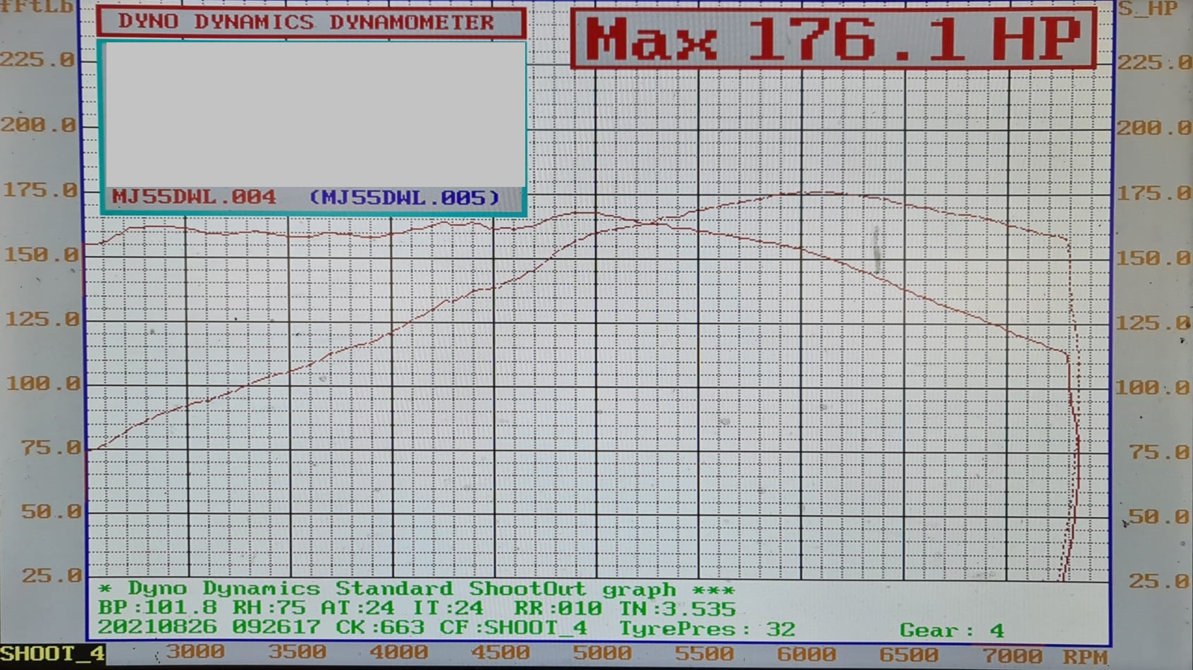

Car was making some knocking and rattling sounds recently from somewhere under the front driver side, and far more than what I had previously experienced. Nothing out of place or worn on the suspension or lower arms as I was expecting it to see so got the engine taken out and engine mount investigated, don't have a picture unfortunately but the engine mount, both the metal and rubber parts had split quite significantly this was a yellow powerflex one. I replaced this for just a standard Renault engine mount and all the knocking and rattling had gone even some of the minor vibrations in the cabin I had learnt to put up with have all gone. There are still a couple I can hear occasionally on very rough roads but far more manageable and changing the other powerflex bushing on the gearbox mount should resolve that when it eventually needs doing anyway.

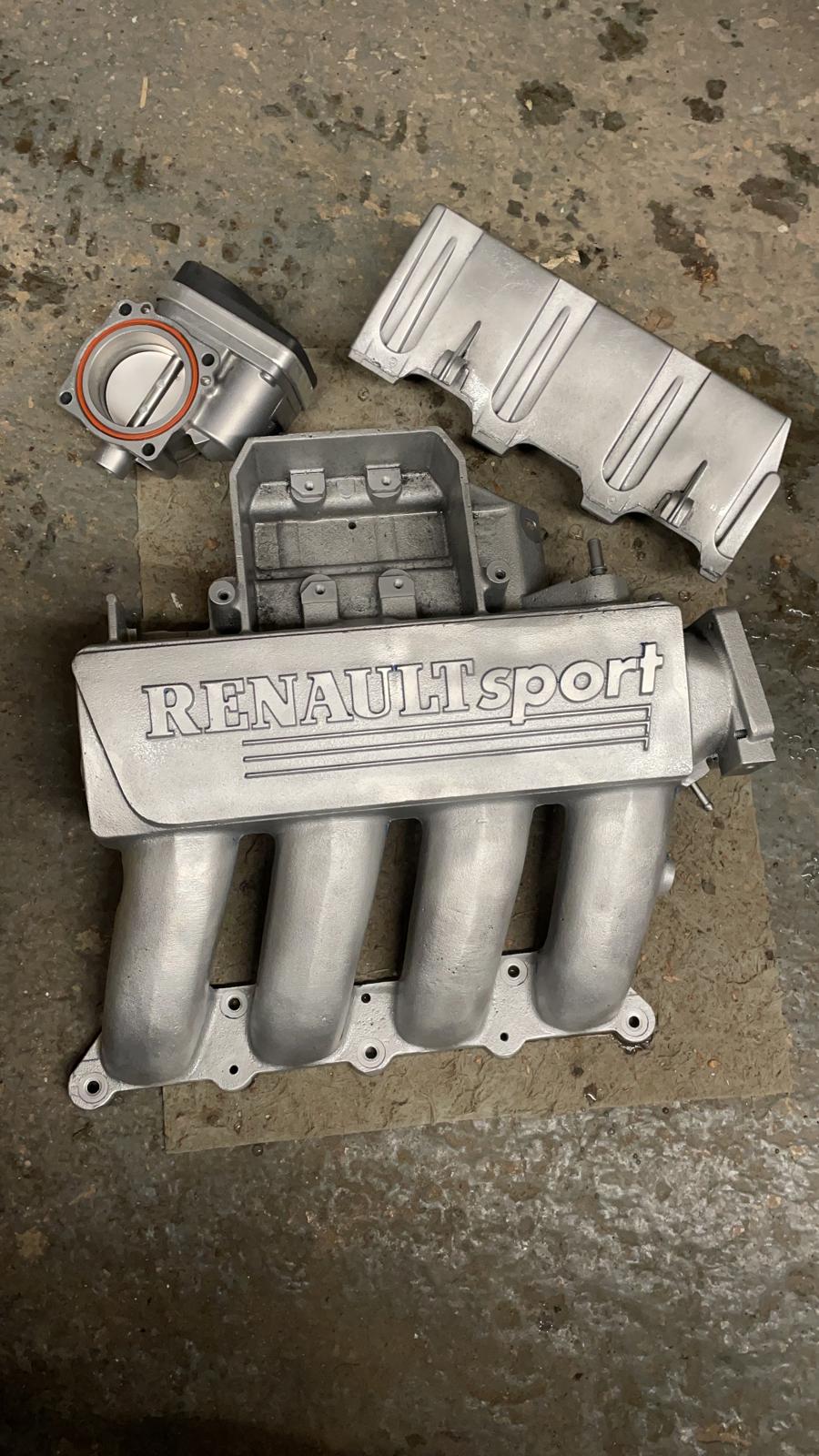

It had previously been suggested the car had been mapped and catcams fitted, although no proof of this so was sceptical and assumed it hadn't been. Took the opportunity after the engine mount was changed to get a quick dyno run and see both if it looked mapped and how the car had fared over the years, as can be seen below it appears much as a standard 182 should be so quite confident it hasn't had anything done, although if I have missed anything and it looks mapped feel free to correct me as only seen a couple of "Standard" 182 graphs. Overall not bad considering 105k miles and over 15 years old even if its a bit optimistic.
Travis

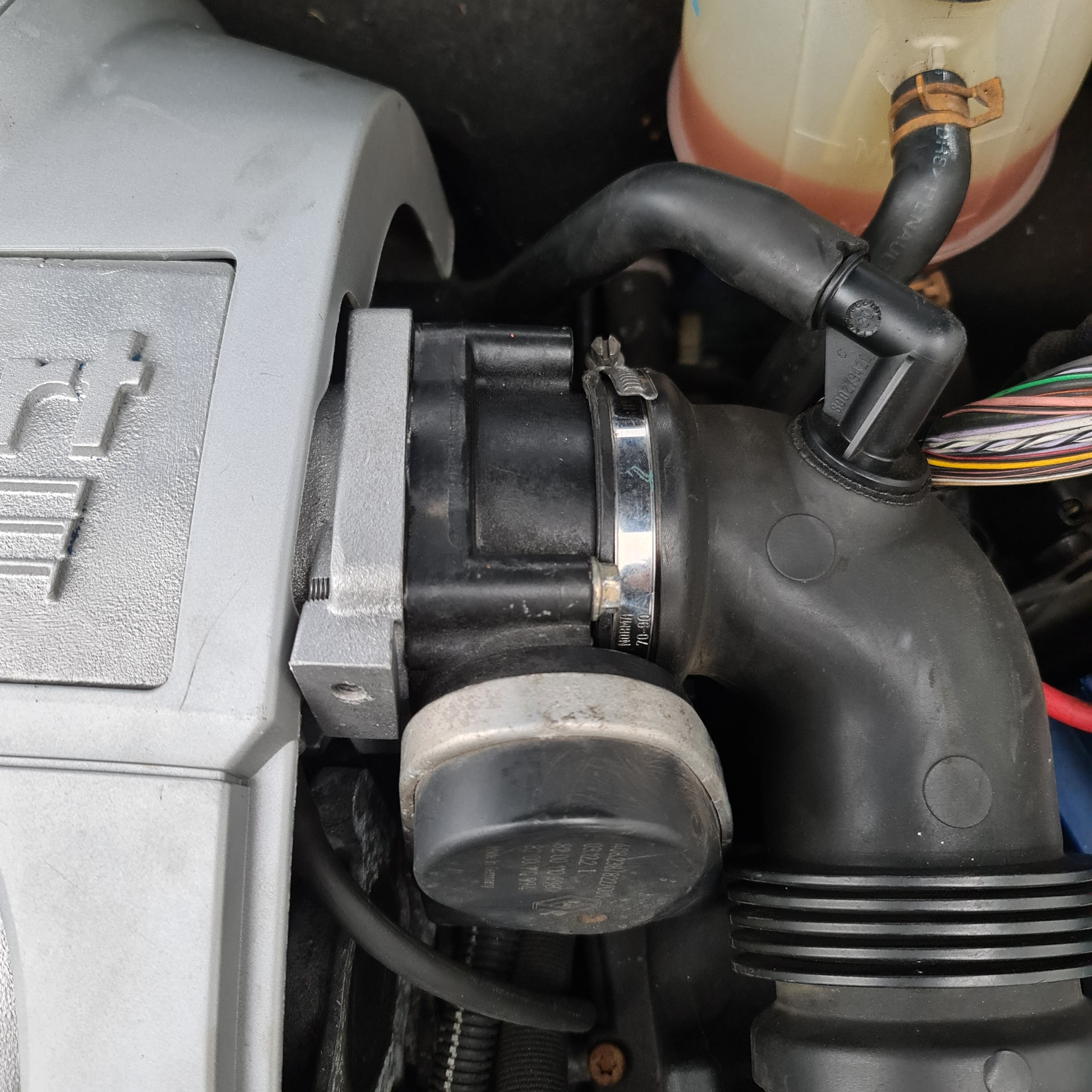

So after all that effort to remove the black paint from a few of the bits I ended up replacing the throttle body for a used one as that was all that was available at short notice.
The revs have always been a bit unstable but nothing major or worth worrying about and couldn't quite figure out where it would be coming from so left it until it got bad enough to figure out a fix. All of a sudden it started doing the below if left in idle/neutral for more than 10 seconds:
Replaced the throttle body for the one mentioned above as a throttle body error code was showing and problem fixed, even the slightly unstable revs that has been there since I got it has vanished. Only issue now seems to be the revs drop quite low when going slow and under heavy engine load so may need to get the idle increased just to avoid any further issues but will see if it fixes it self now the throttle body has been changed.
2nd hand unit, not as clean as what was on before but works much better which is all I really care about:

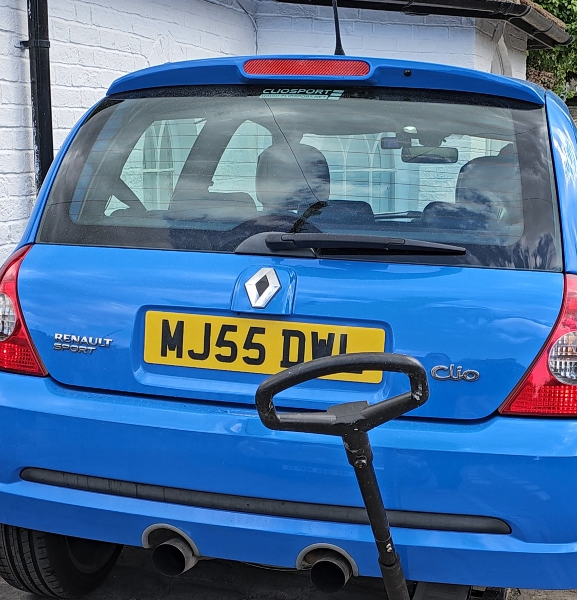

Long overdue update on the 182 photos below of the brake light fix, but here’s what’s been done since my last post:
Been a while as I’ve been focused on another project (now complete), and honestly have no interest in taking on another, the Clio always seems cheap and easy in comparison.

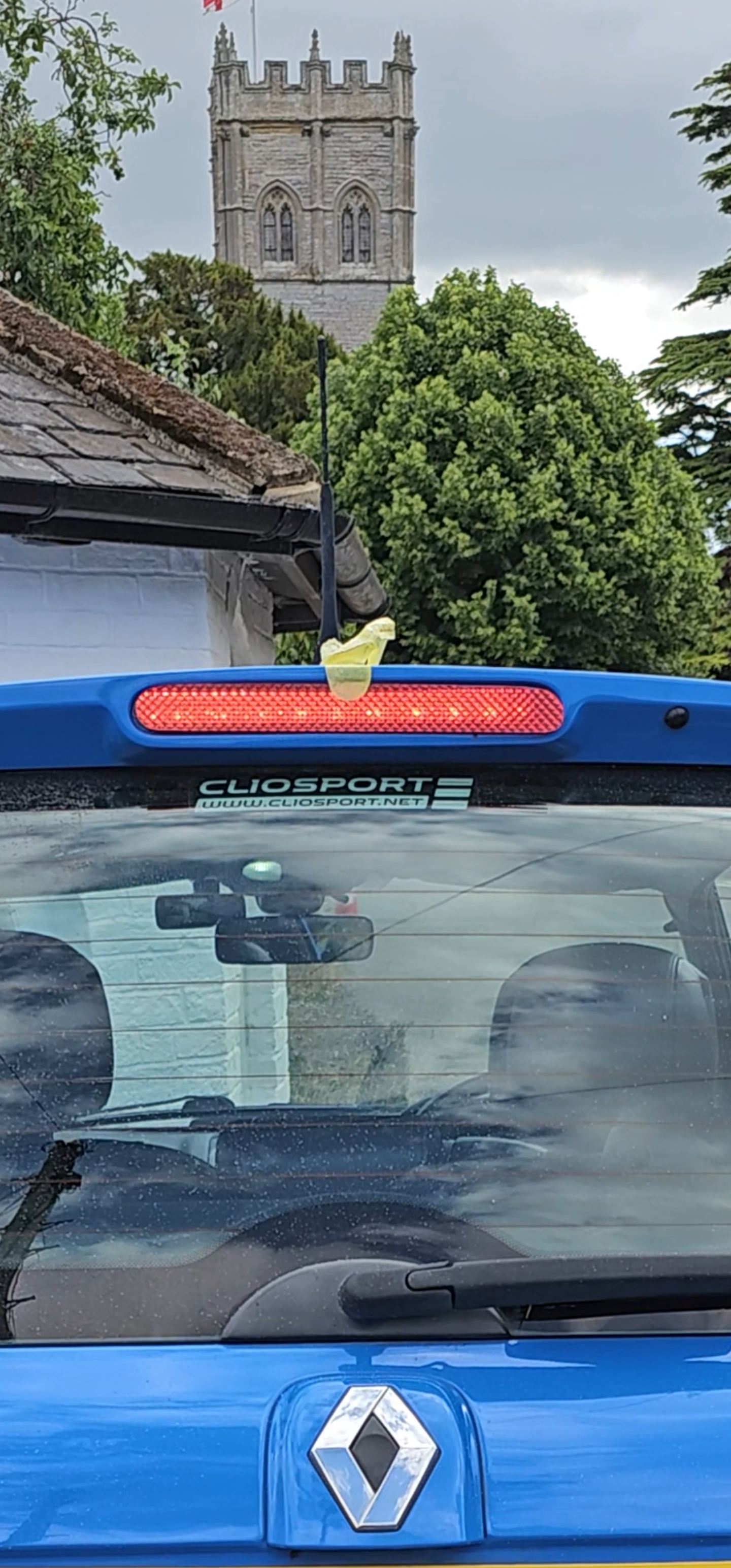

Replaced the third brake light, rebuilt it myself with new LEDs as sourcing them in good condition is near impossible

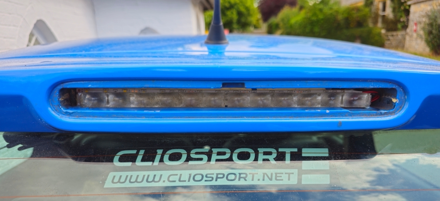

Getting back onto it now, photos below of the brake light rebuild:
Before
The original third brake light had completely failed, the LED strip was gone, and when removed, the old brittle plastic housing cracked beyond repair. As sourcing a Cup spoiler brake light is basically impossible now, I decided to rebuild it myself.
1. Removed the old unit, which unfortunately cracked due to age and sun exposure making the plastic extremely brittle.
2. Rebuilt using a waterproof LED strip, wired into the original connector. I sealed over the top of the connector to make it watertight.
3. Fabricated a new lens from prismatic acrylic:

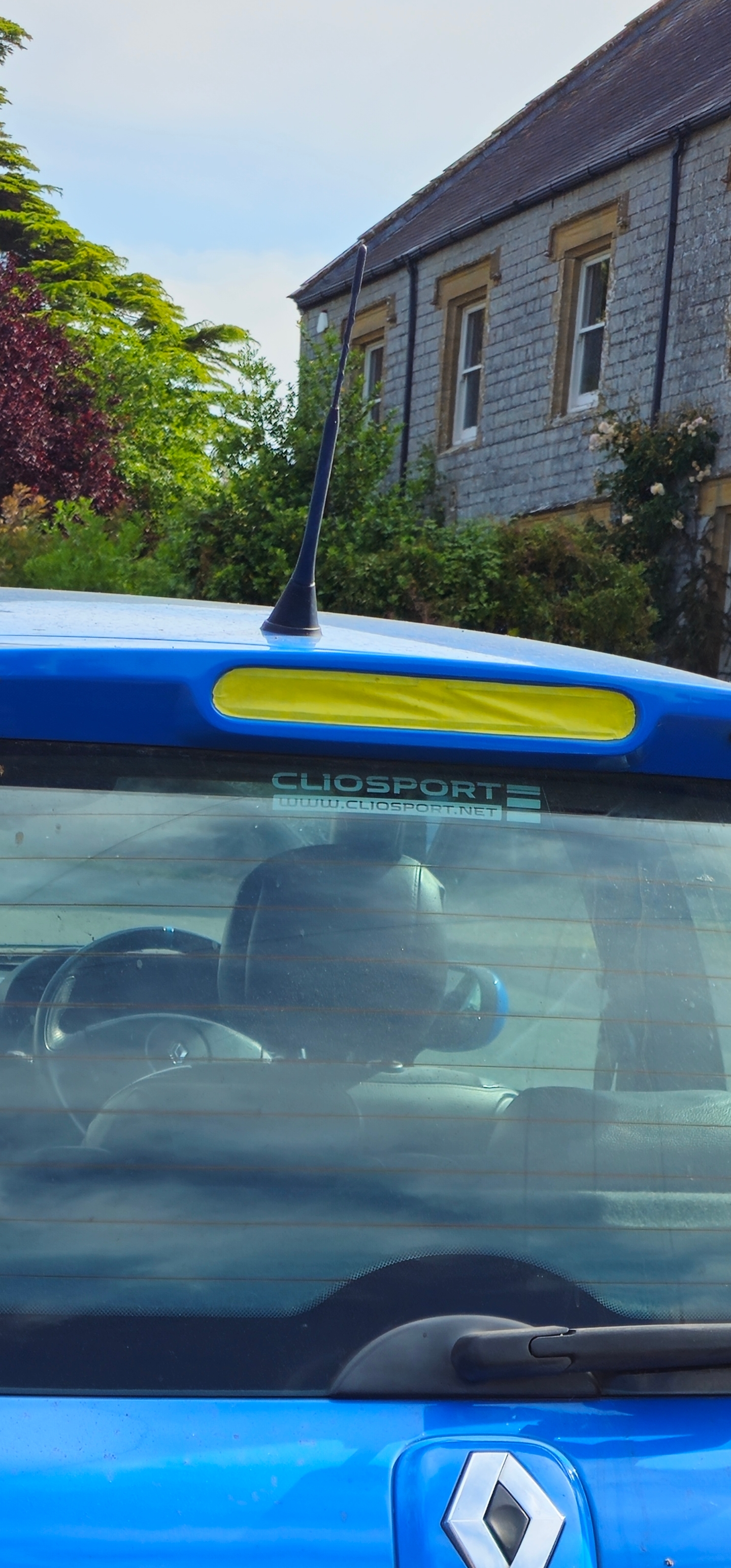

4. Applied a red tint to match the original lens colour.
5. Finished with a UV resistant clear coat to prevent fading or yellowing over time.
6. Reused the original inner diffuser lens to retain a similar light pattern and diffusion to OEM. This was glued back down around the edges.
Checked polarity to ensure the LED strip worked correctly.
Tested colour and brightness against the original pattern (hence the yellow tape visible in one of the photos during checks and poor alignment).
