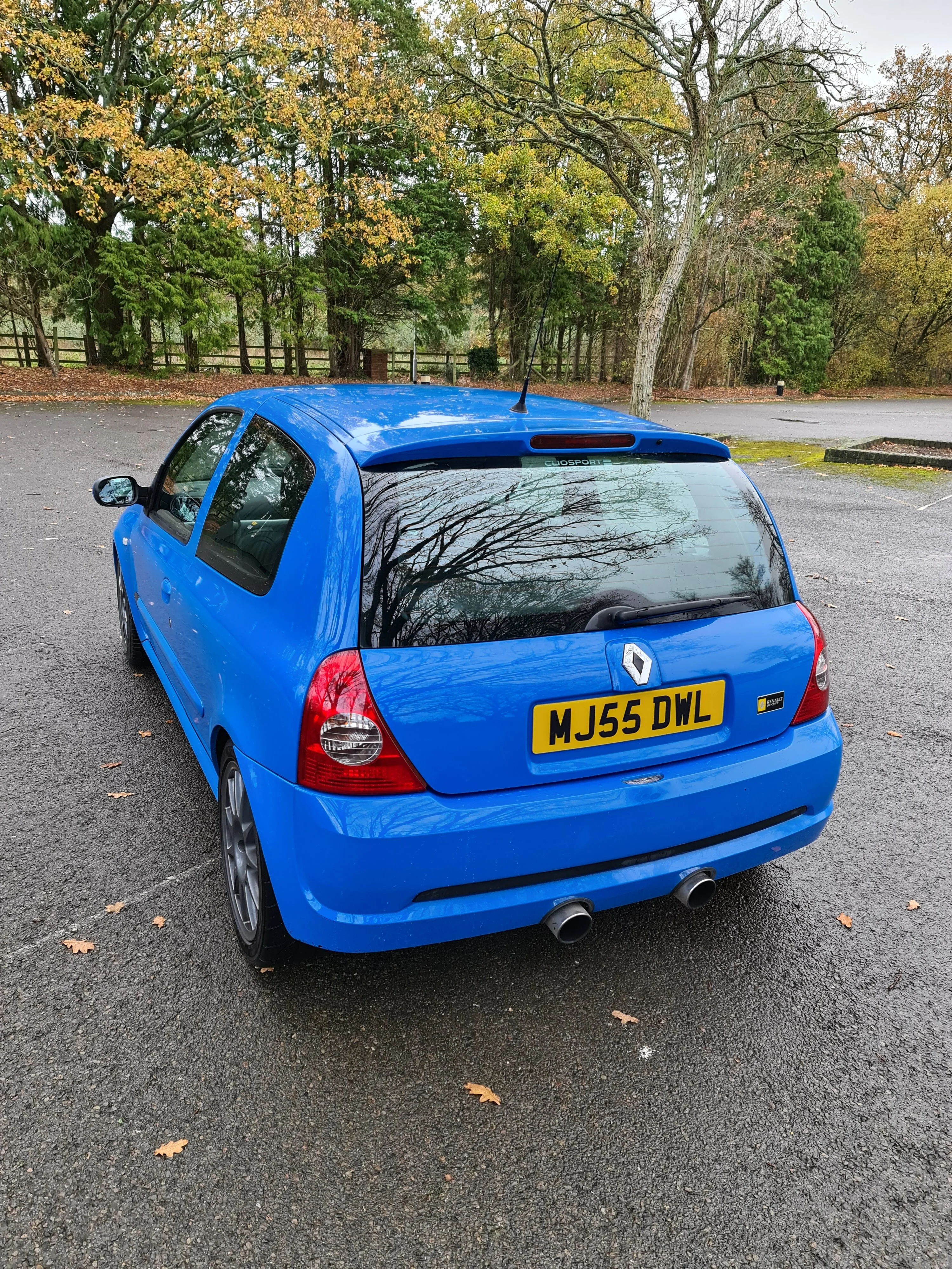

Picked this up from @Cads last weekend, arrived at around 2am on Saturday morning. Not done much to it yet, but should do as a bit of a project. Long term plan is to keep this and sort out all the issues then just enjoy it as it is.
Delivered spec:
Miltek exhaust including decat pipe
Espace V6 Airbox
Cooksport springs
Yanoo quick shift
Couple of carbon fibre bits on the exterior
Plans:

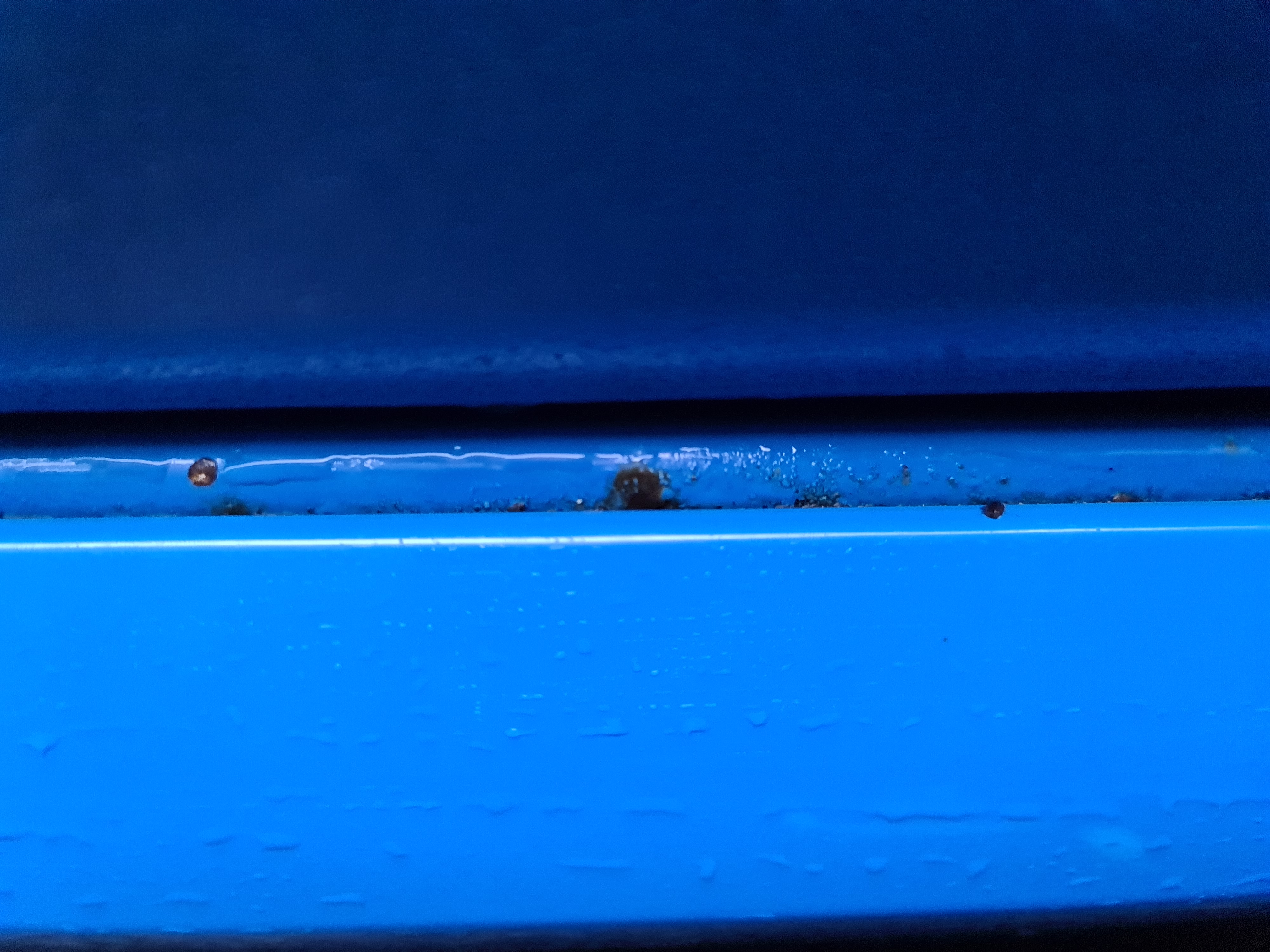

Sort rust spots and poor paint work on the rear arch

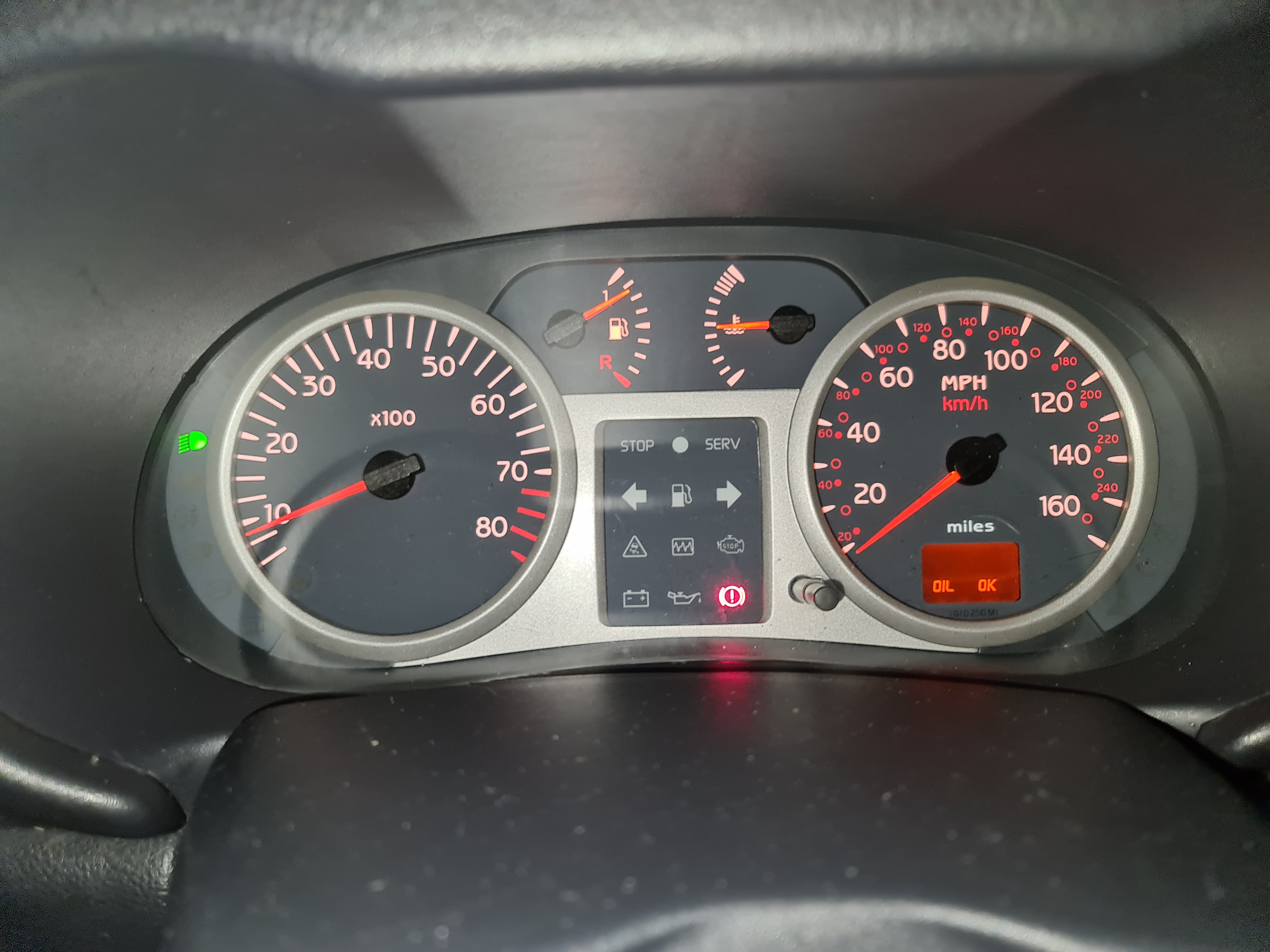

Replace rear ABS sensor, currently bringing up three lights on the dash
Refit some standard parts (Airbox and some interior/exterior bits)
Sort other minor issues (Rusted bonnet catch, air con...)

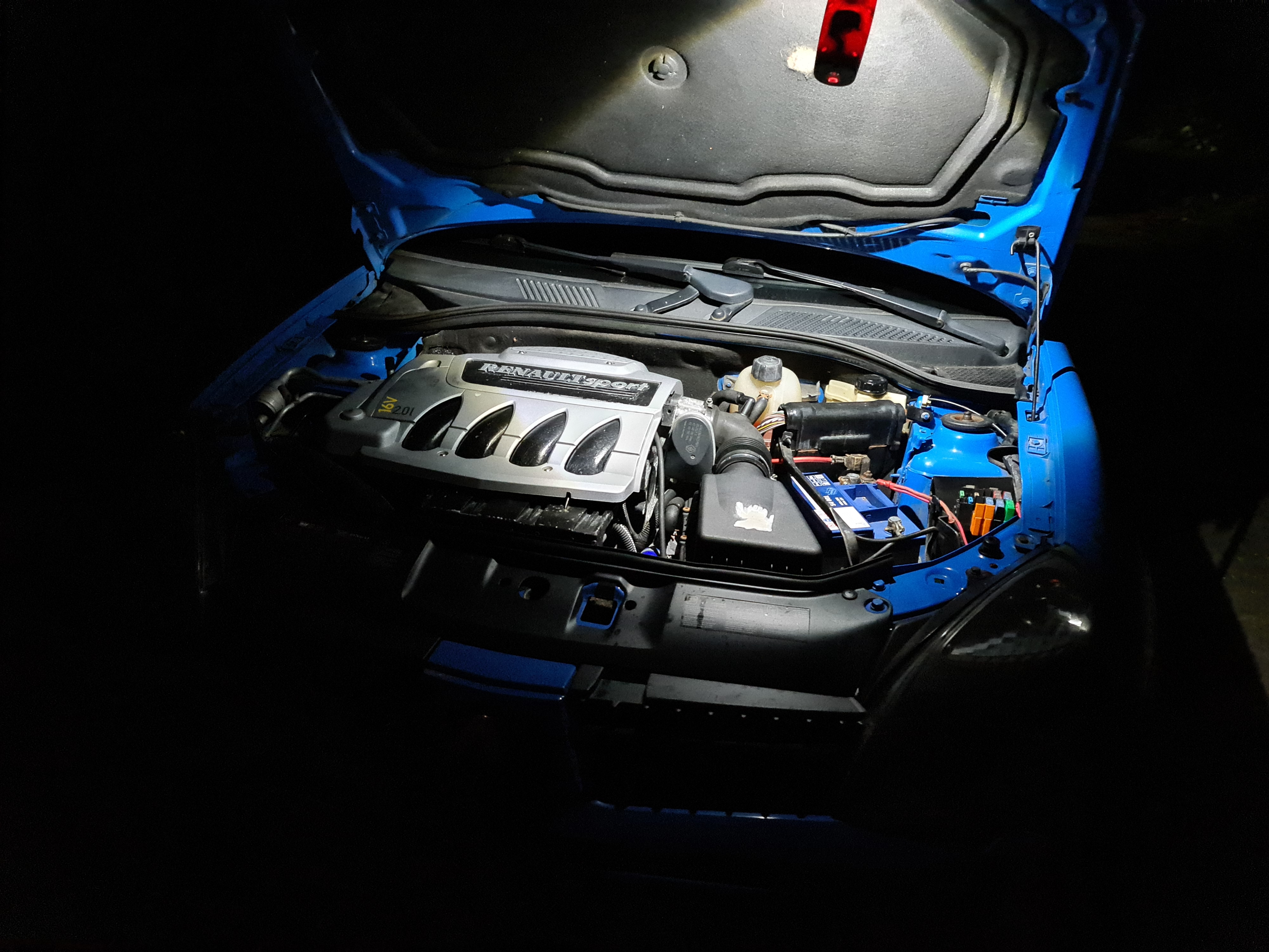

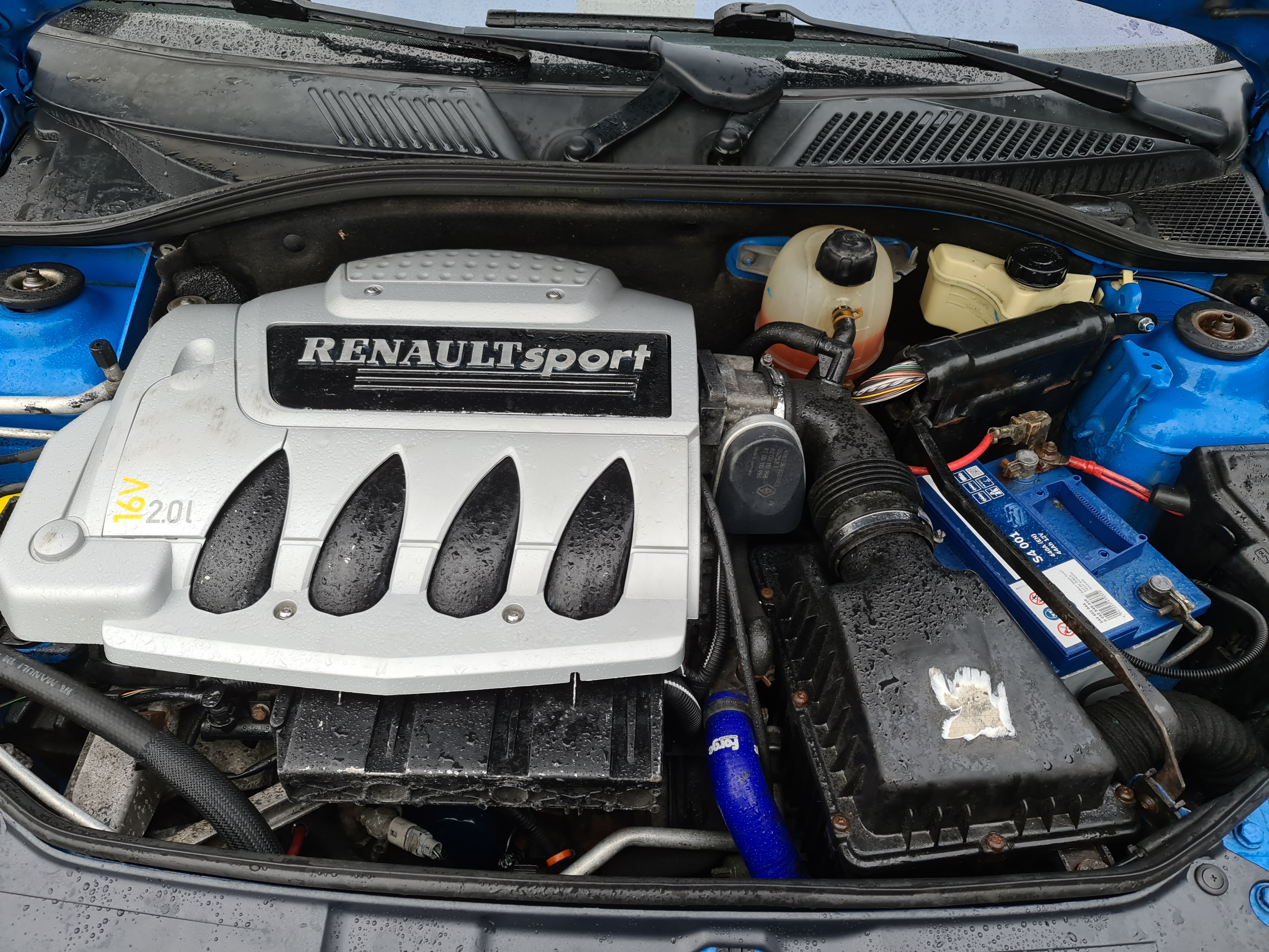

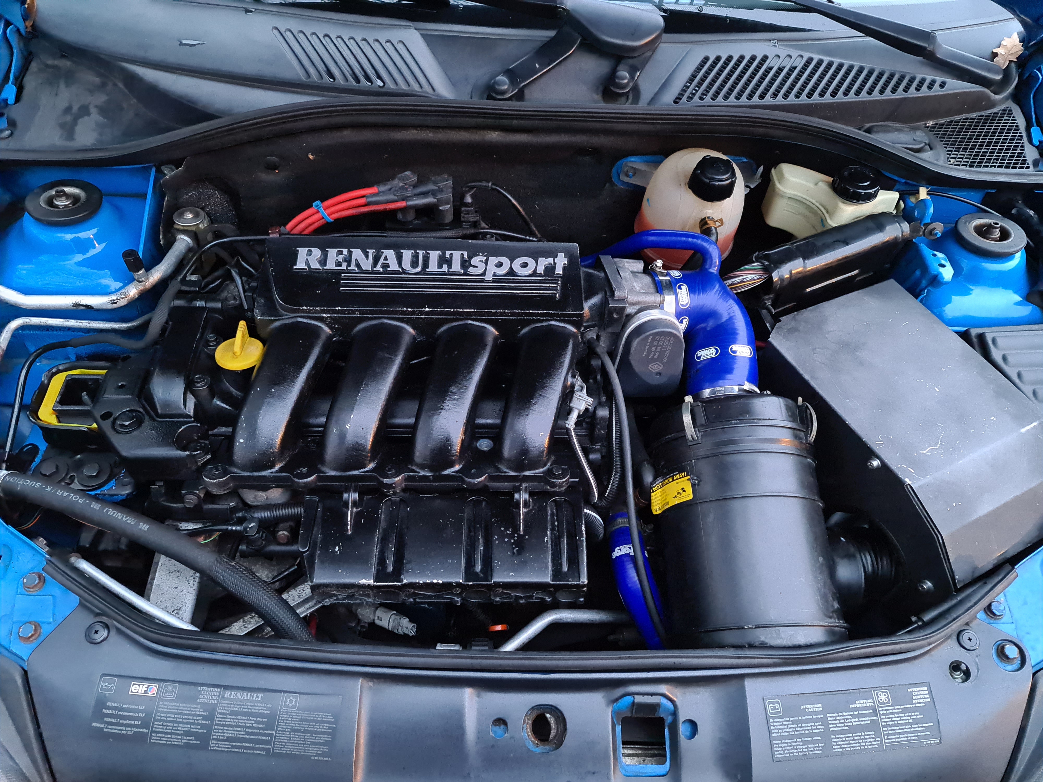

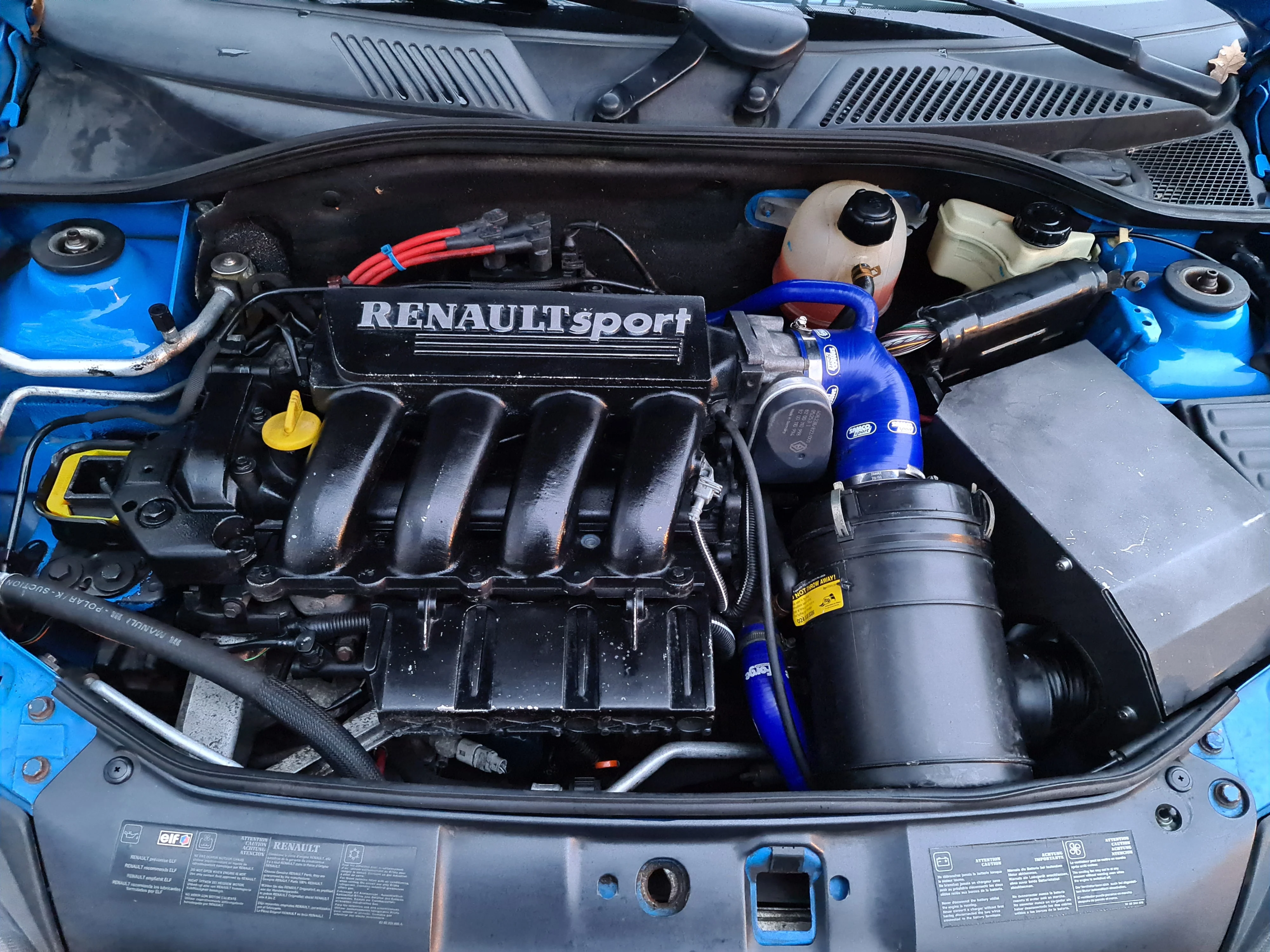

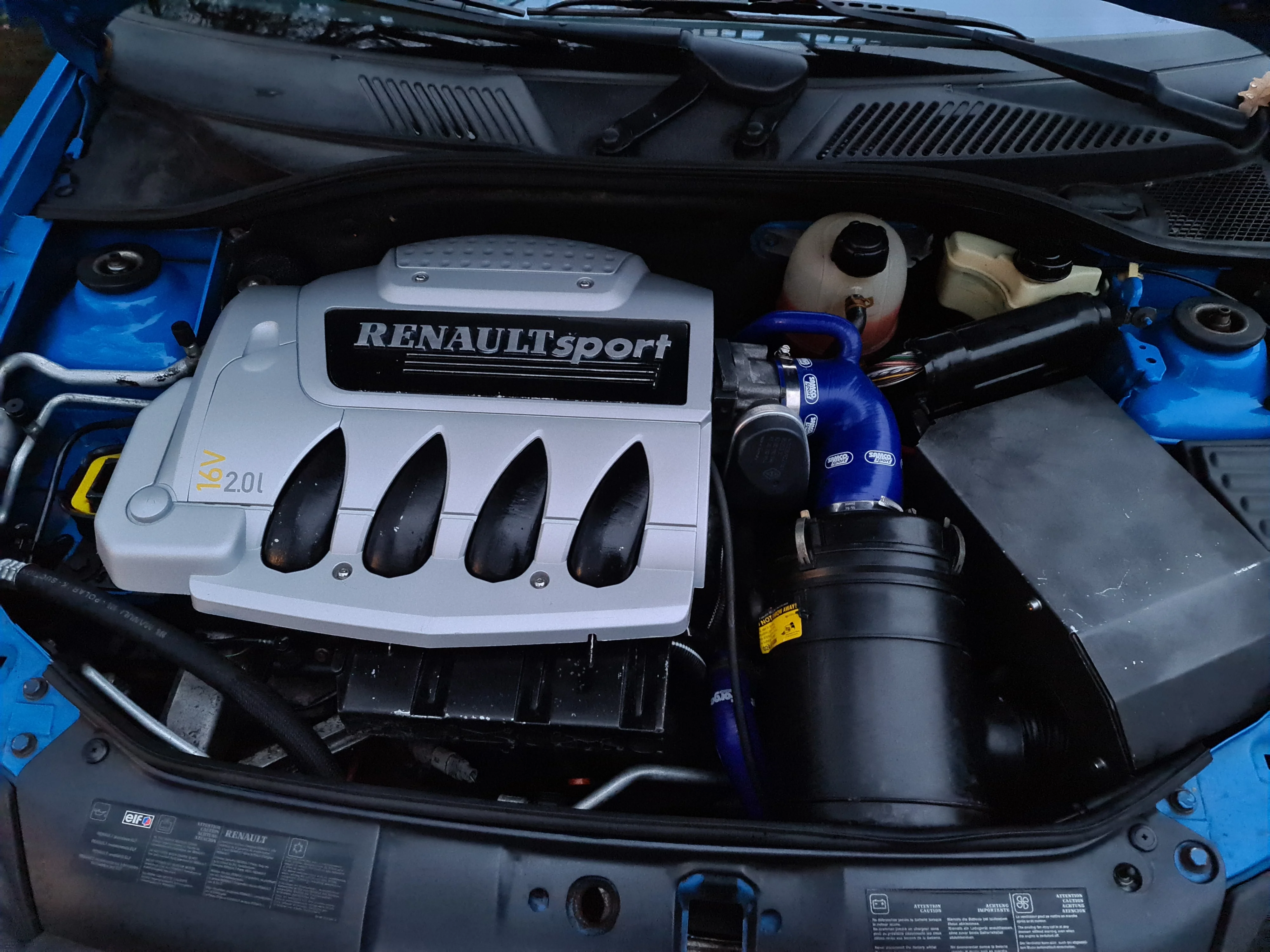

Next job was to give the engine bay a clean and fit an engine cover.

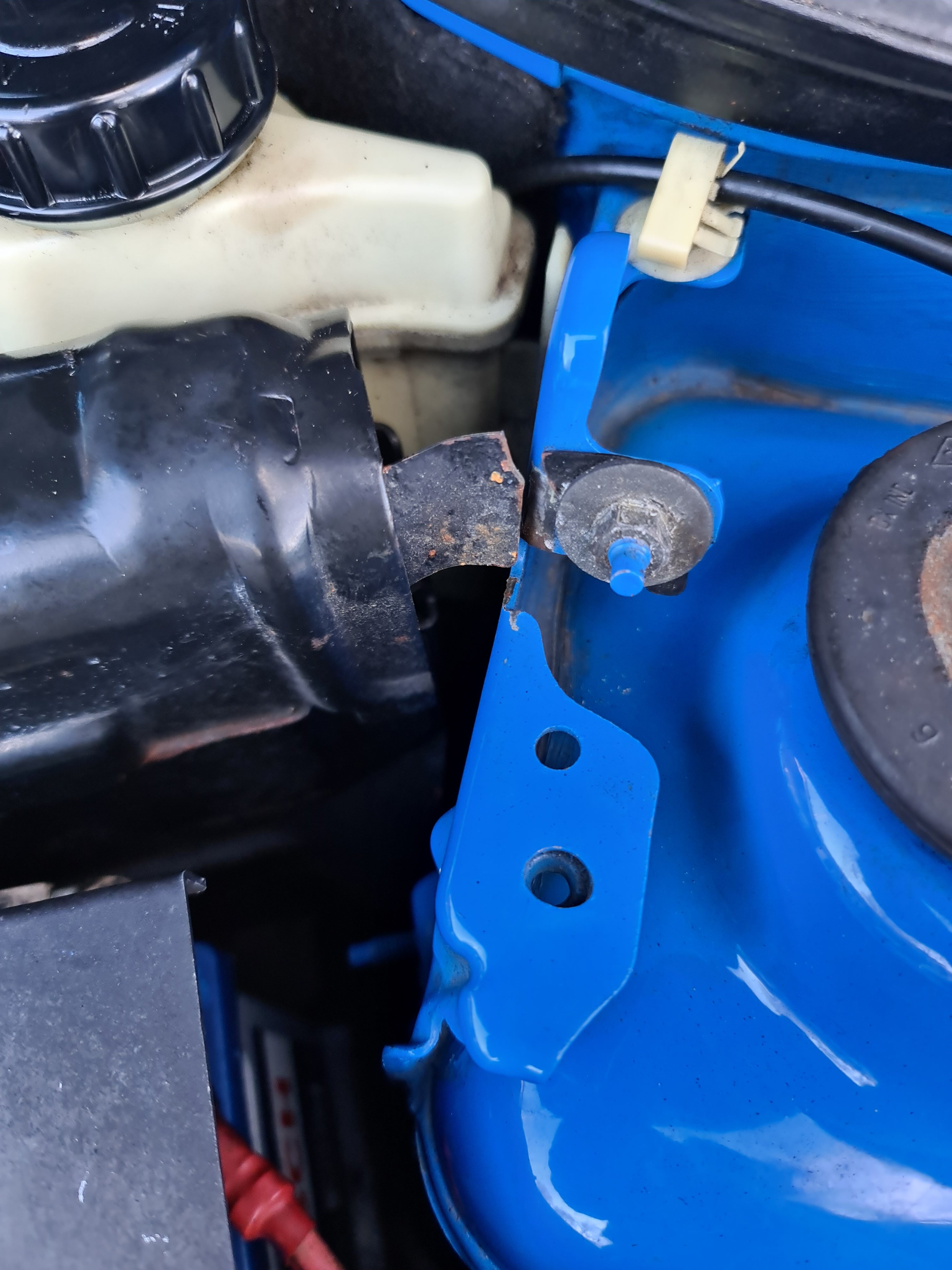

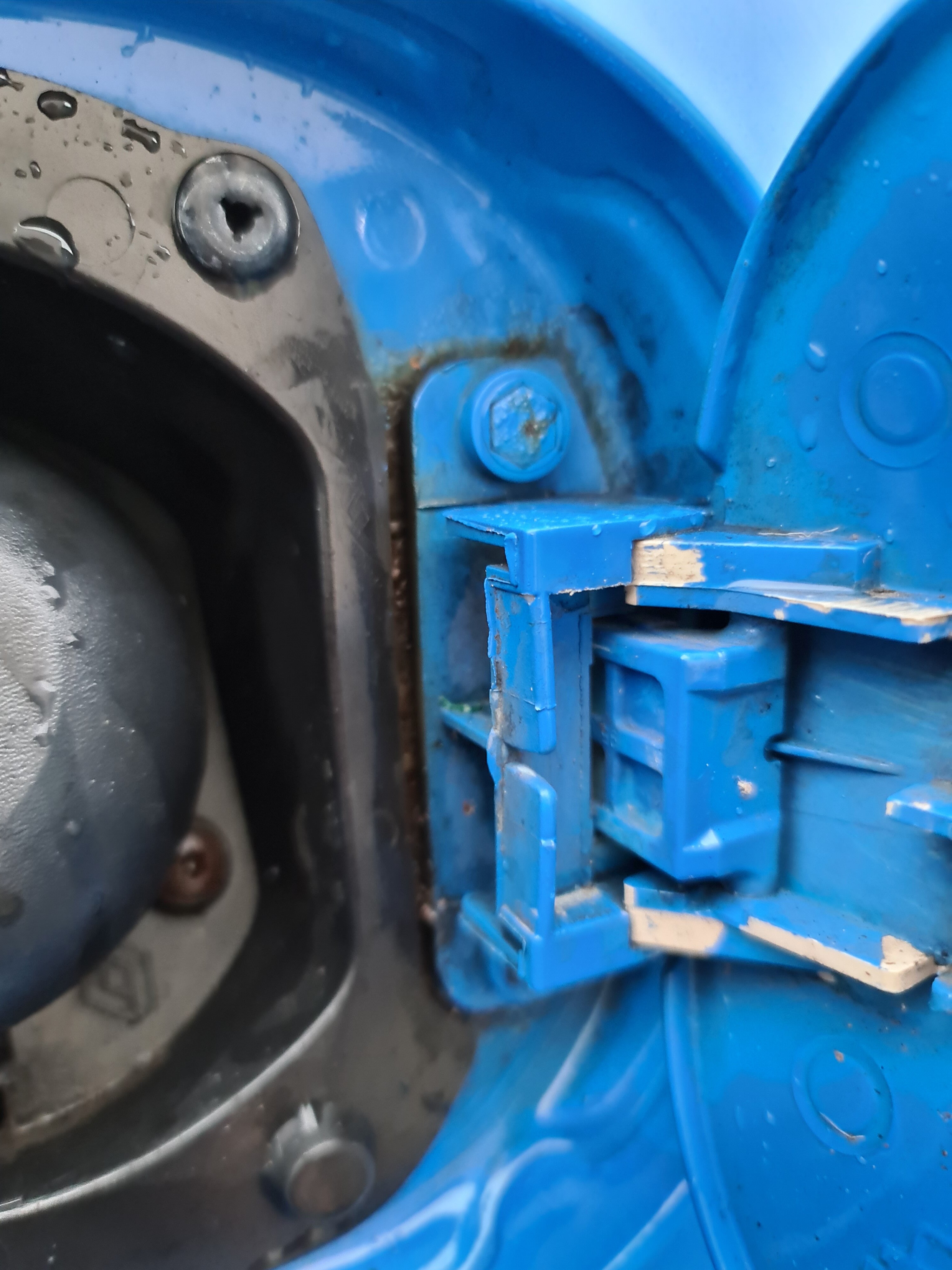

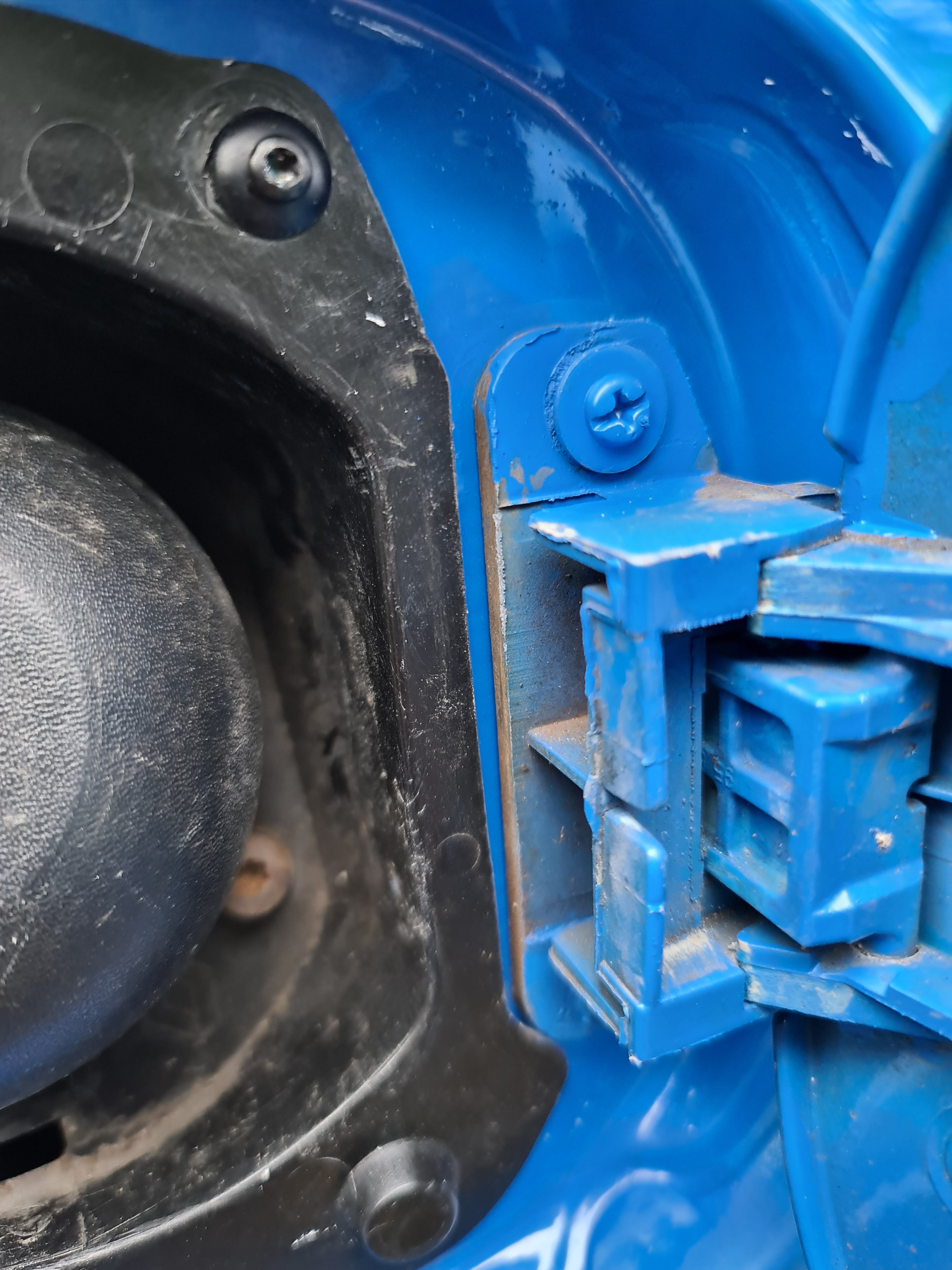

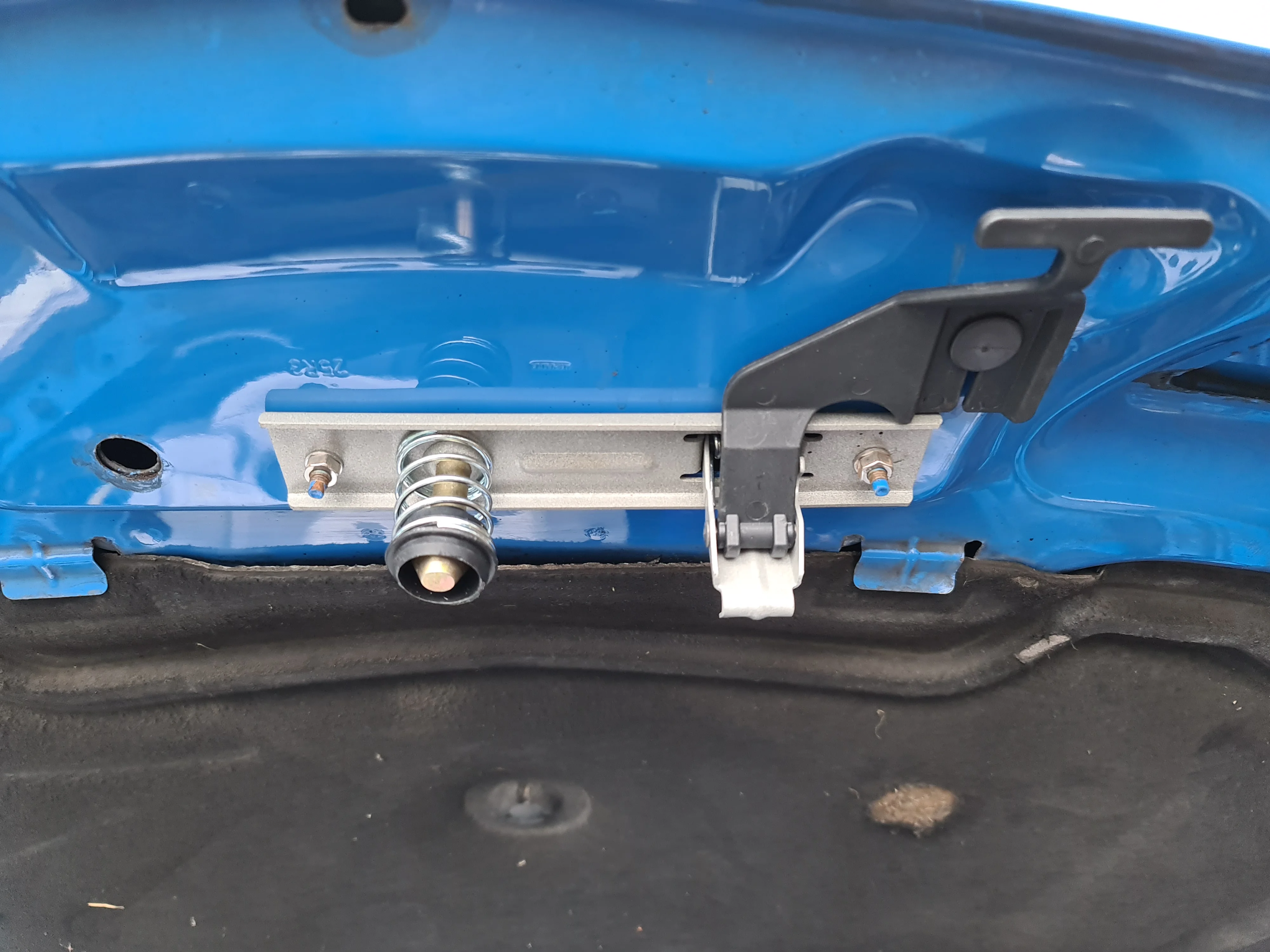

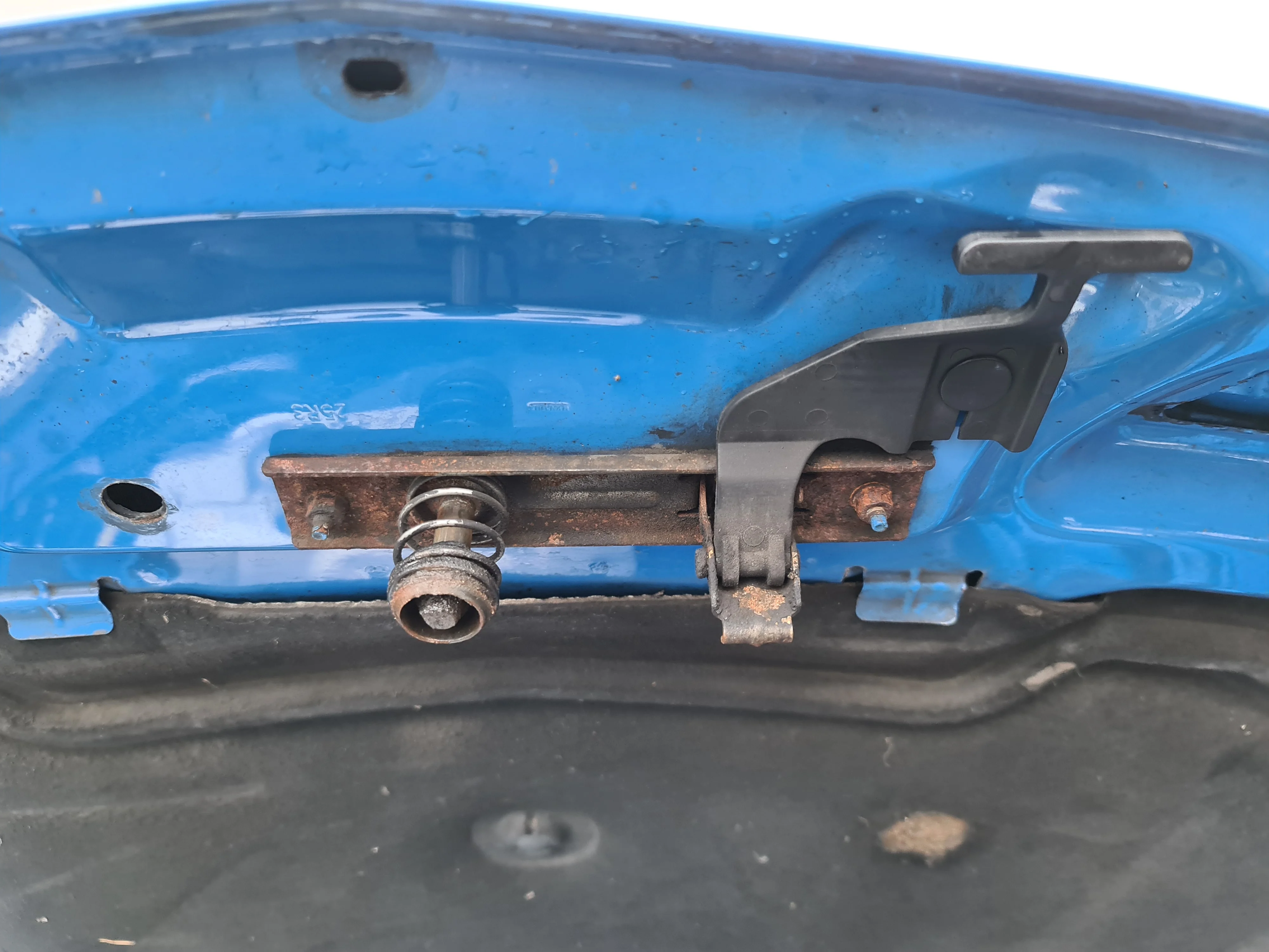

Rusted bonnet catch:
Cleaned and replaced:

I had a catch in my eBay basket for ages. I never thought it would clean up that well. Nicely done.

Probably the same one I bought, the plastic pin doesn't seem to be the best fit although it doesn't appear to do much other than stop it from dangling when the bonnet is open so not too bothered about that.

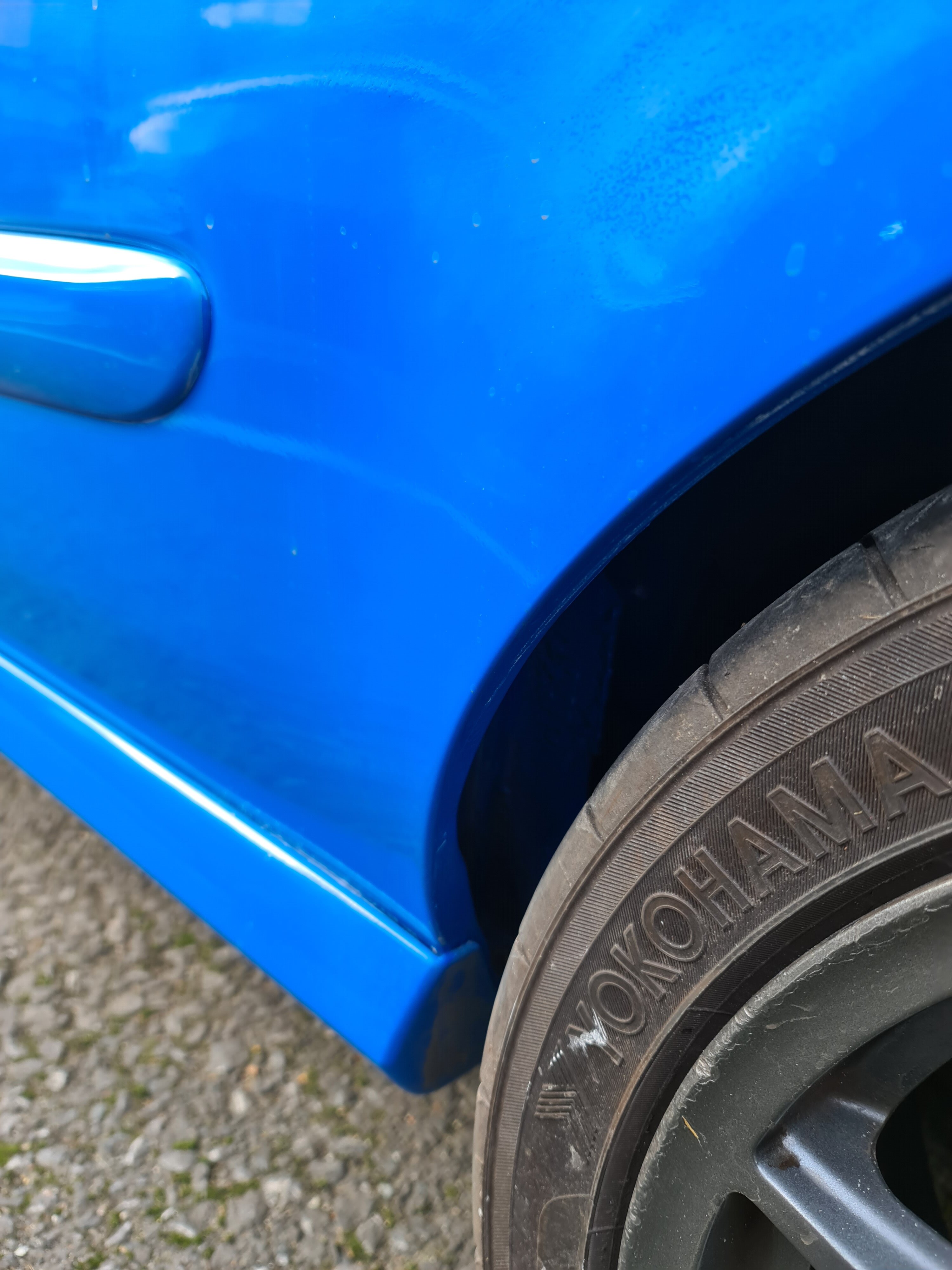

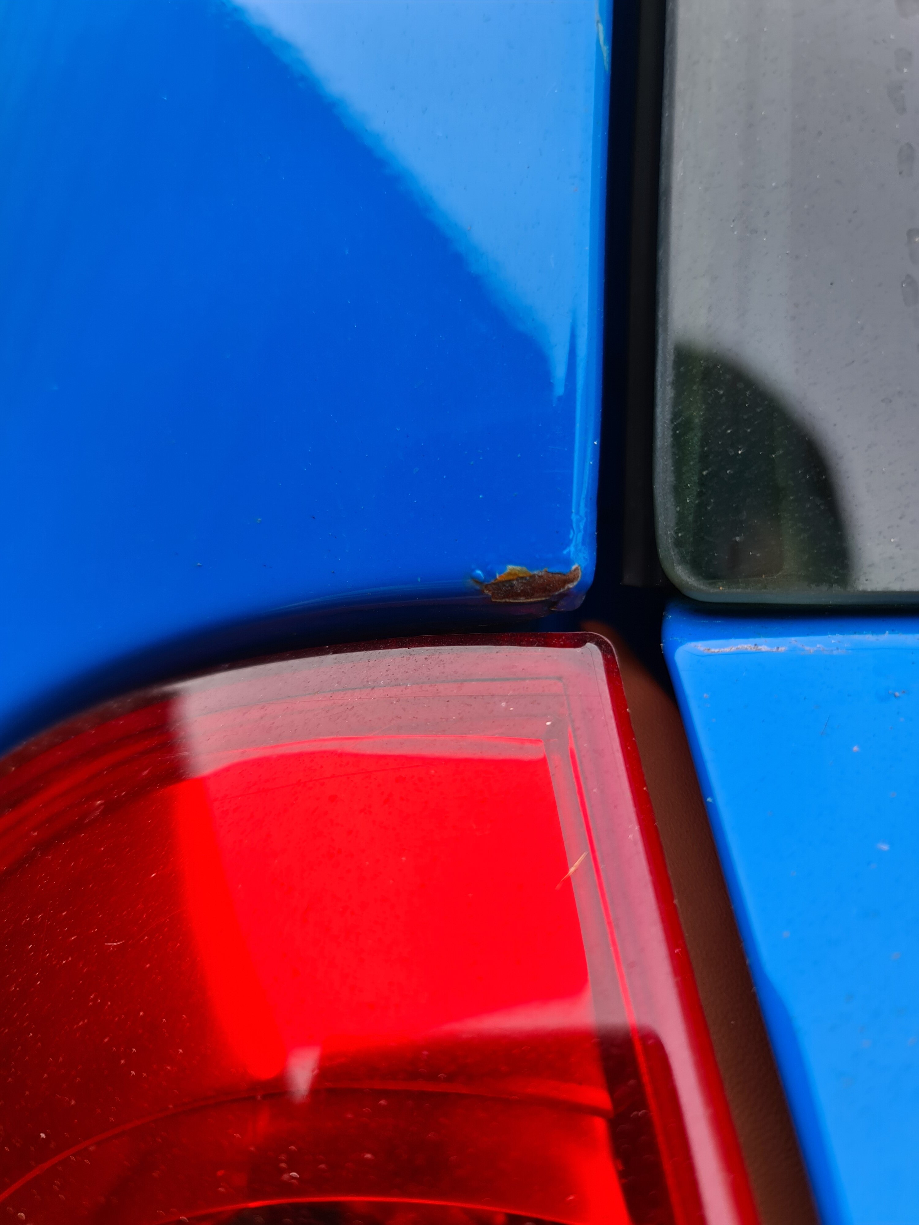

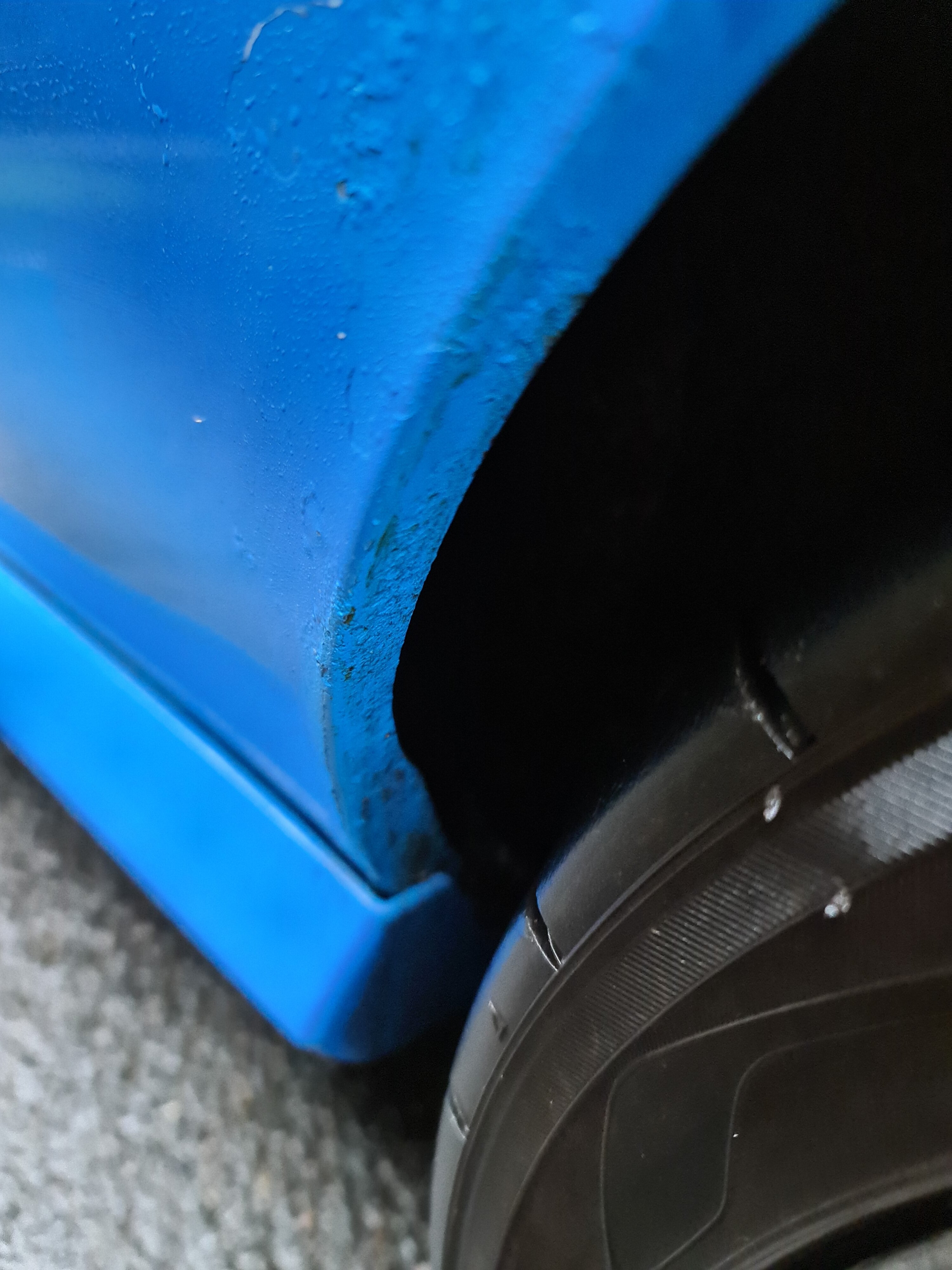

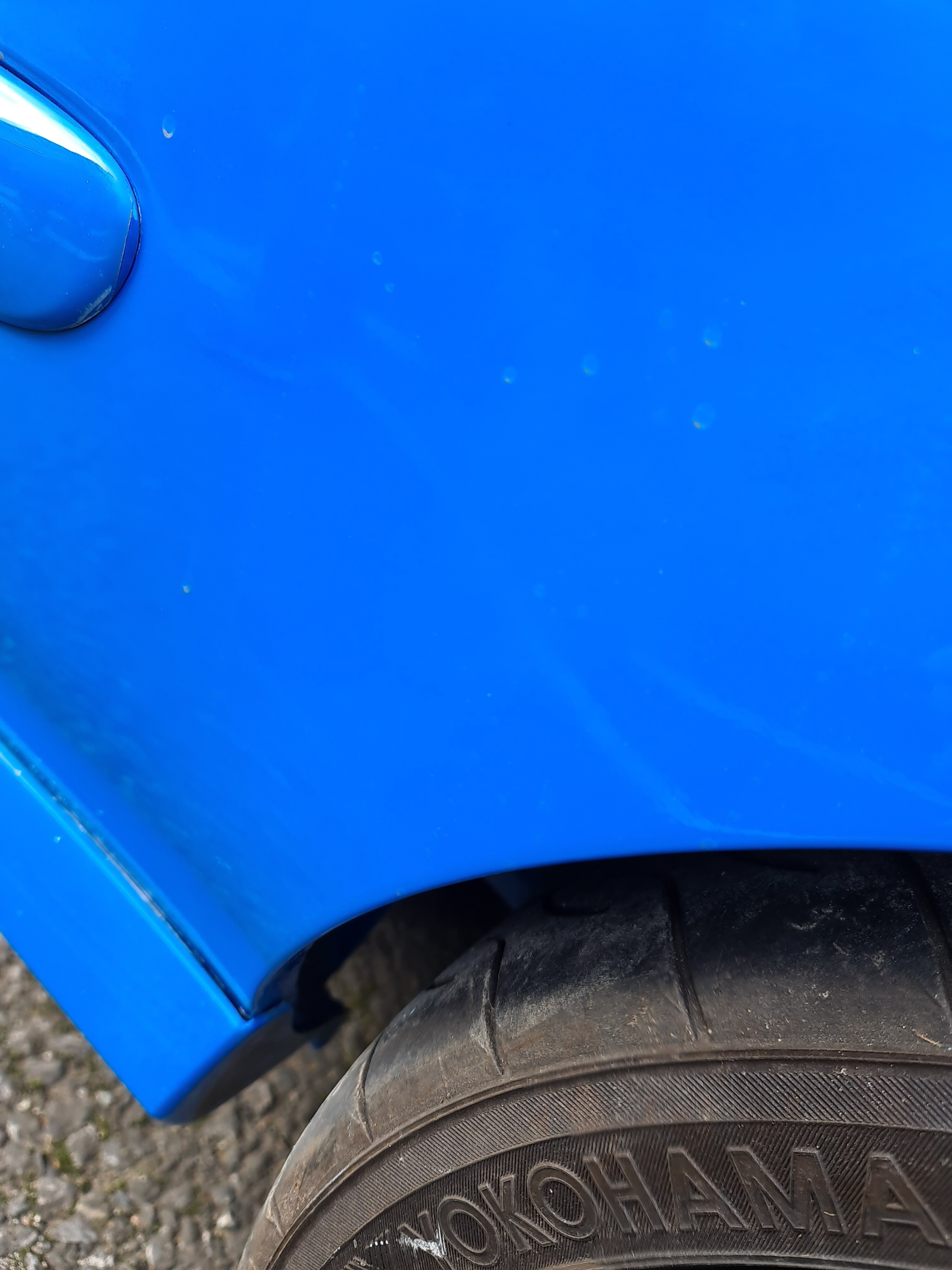

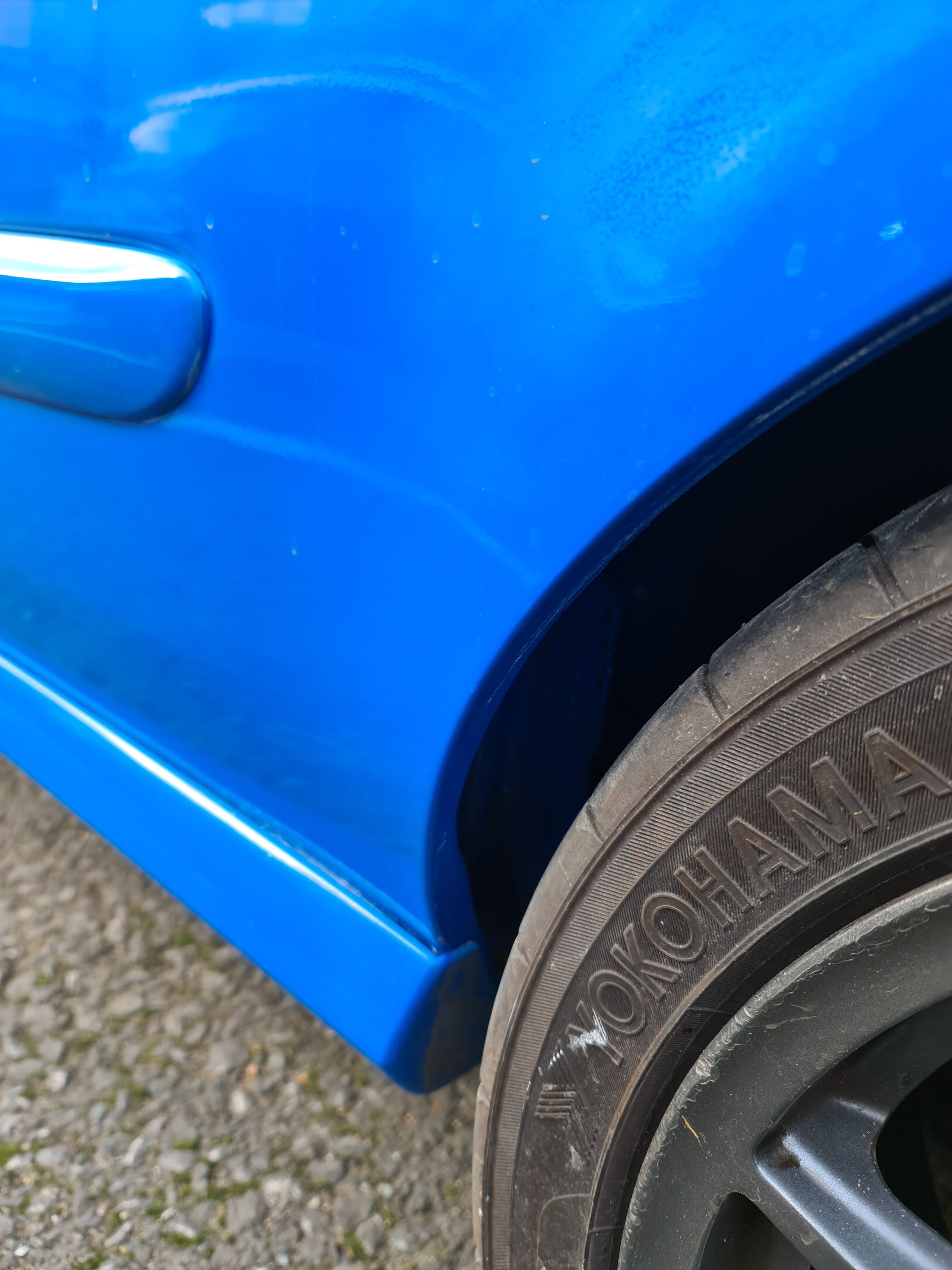

Got a quote for the rust and paintwork to be corrected, booked in for later this week.

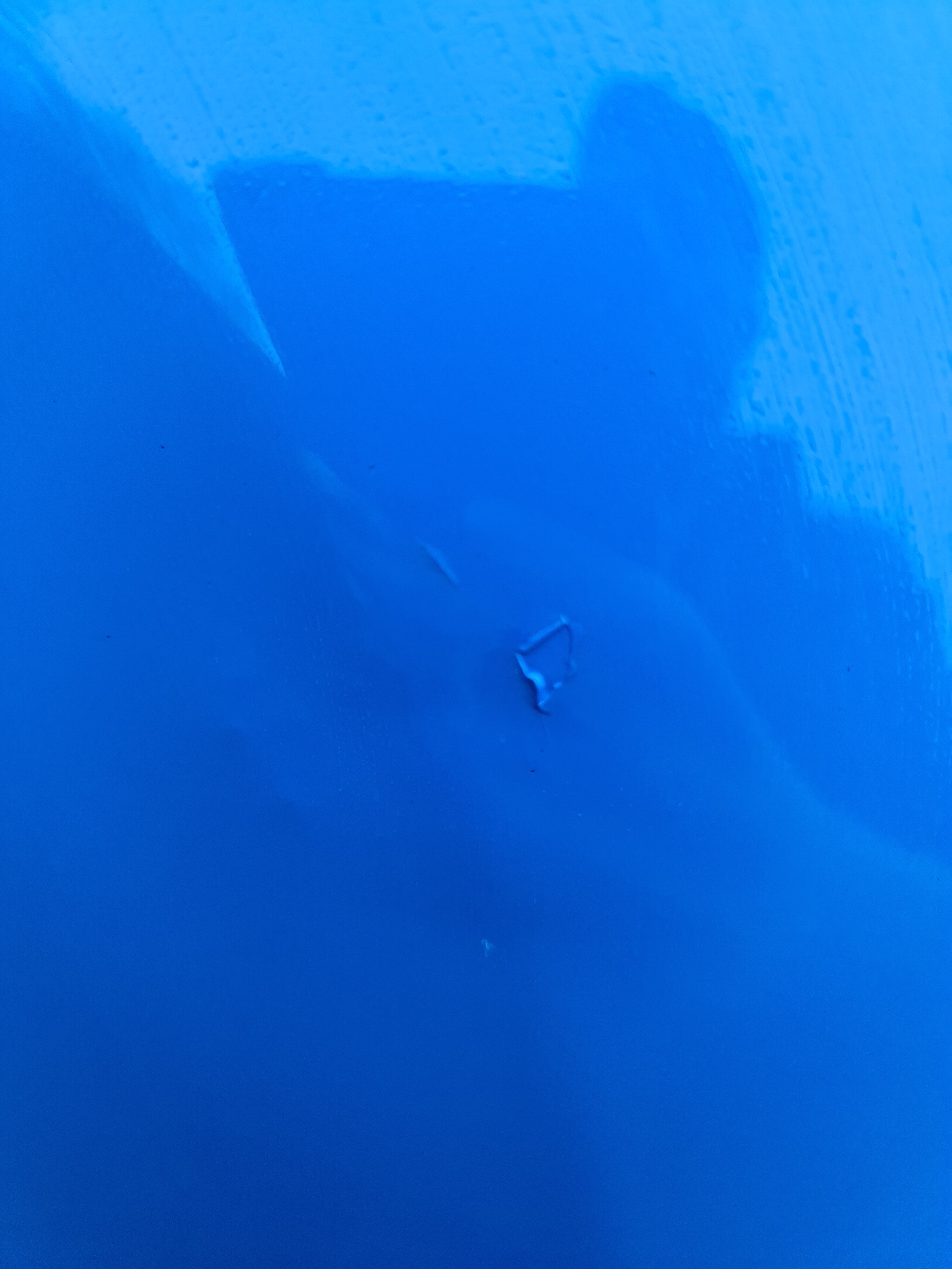

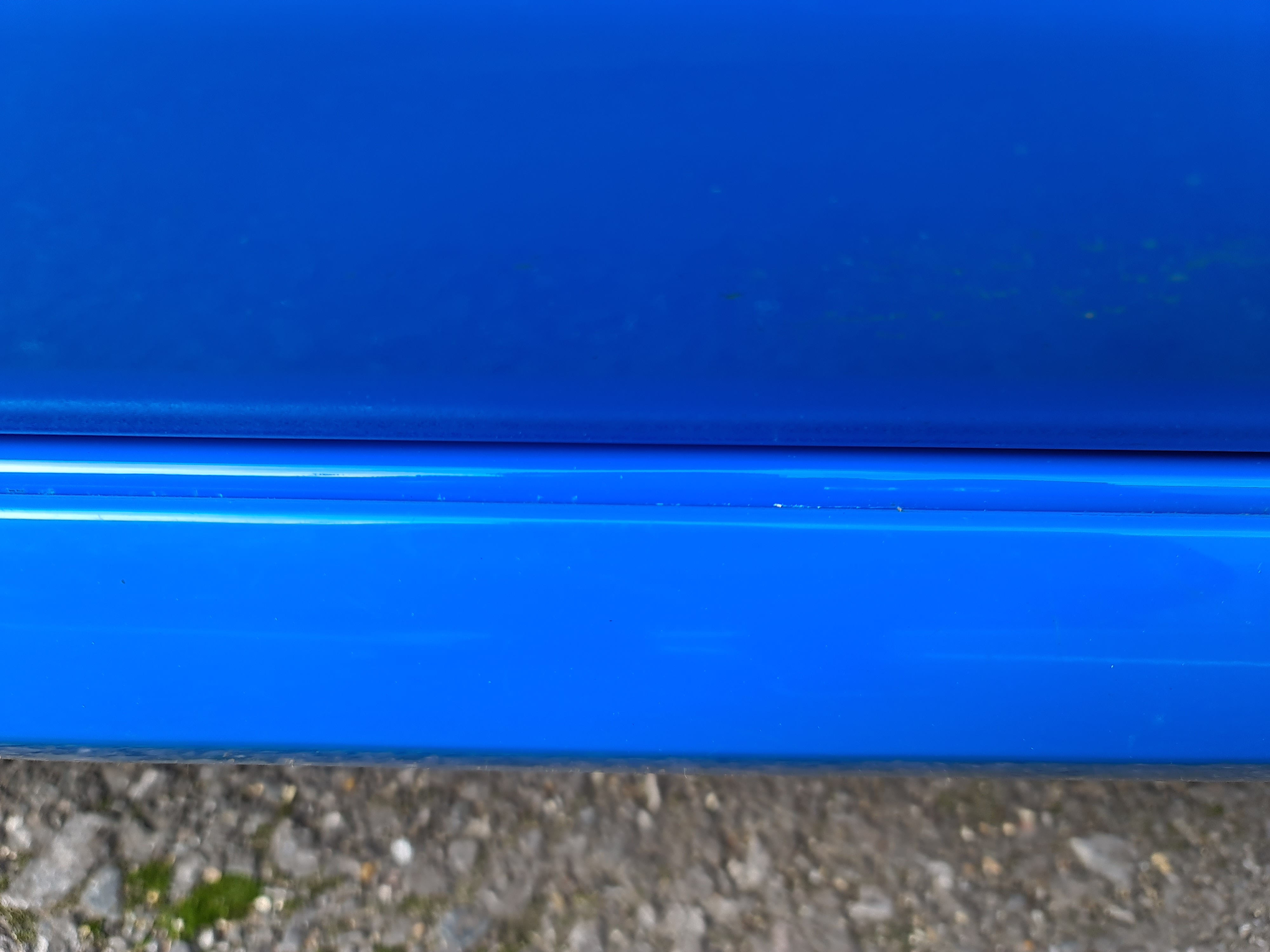

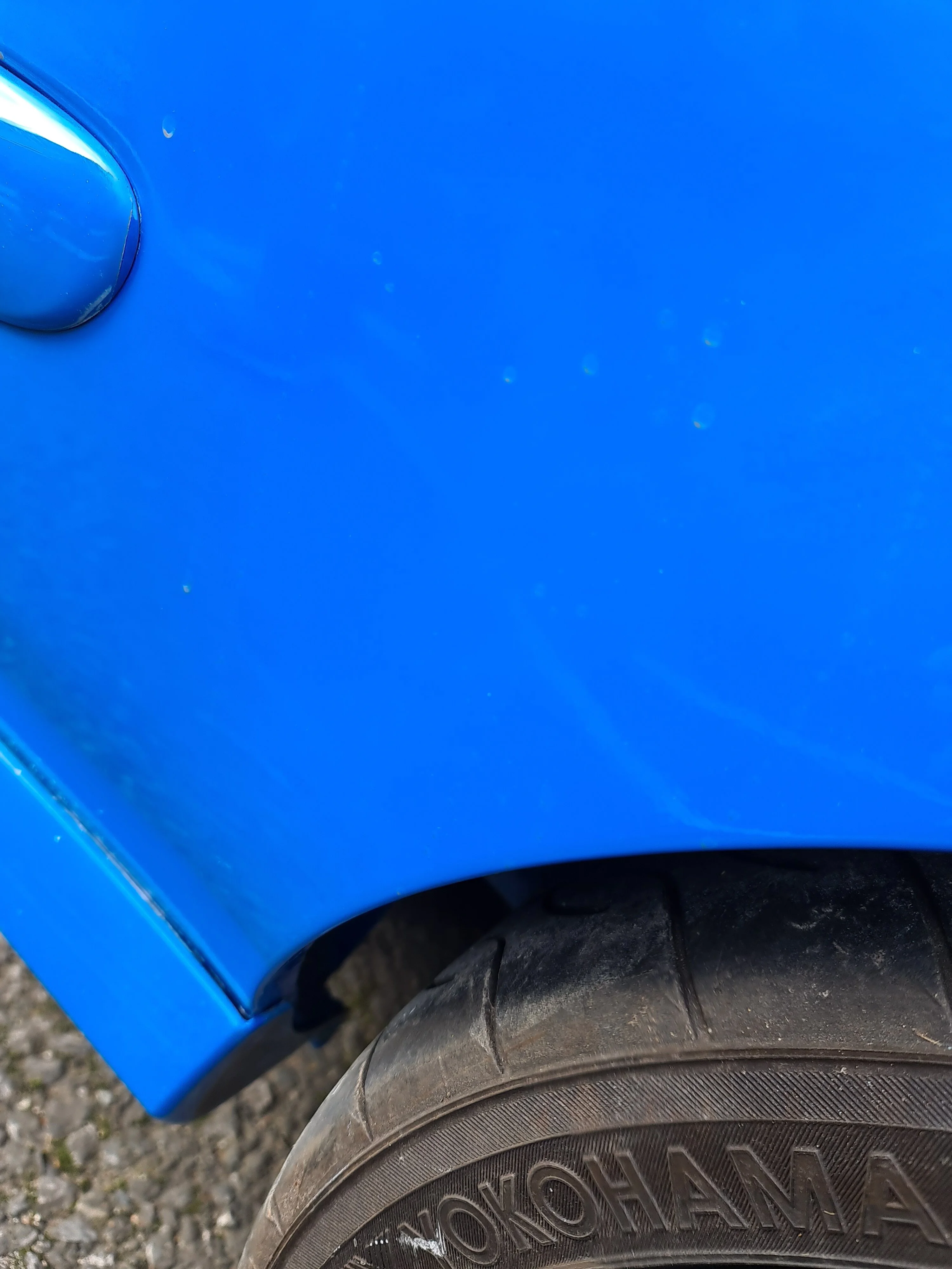

It also appears as if the OS rear quarter has been replaced at some point due to the arch not being rolled and the join at the back under the boot being slightly off, the car has never been declared in an accident and cant find any paperwork to prove it has ever been replaced or why...
Could be why rust has appeared on that panel although the body shop did note it was a very good repair/replacement otherwise.

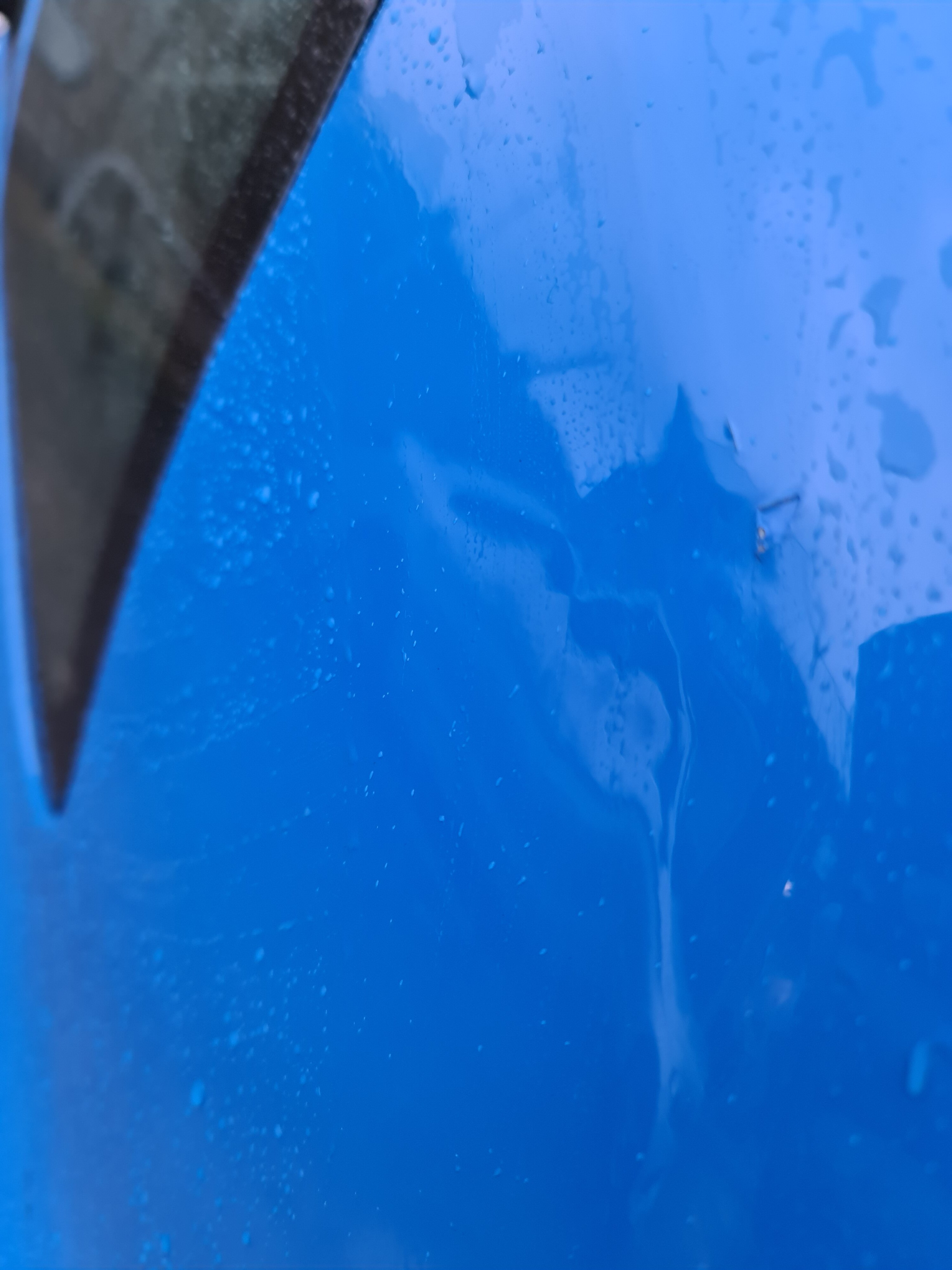

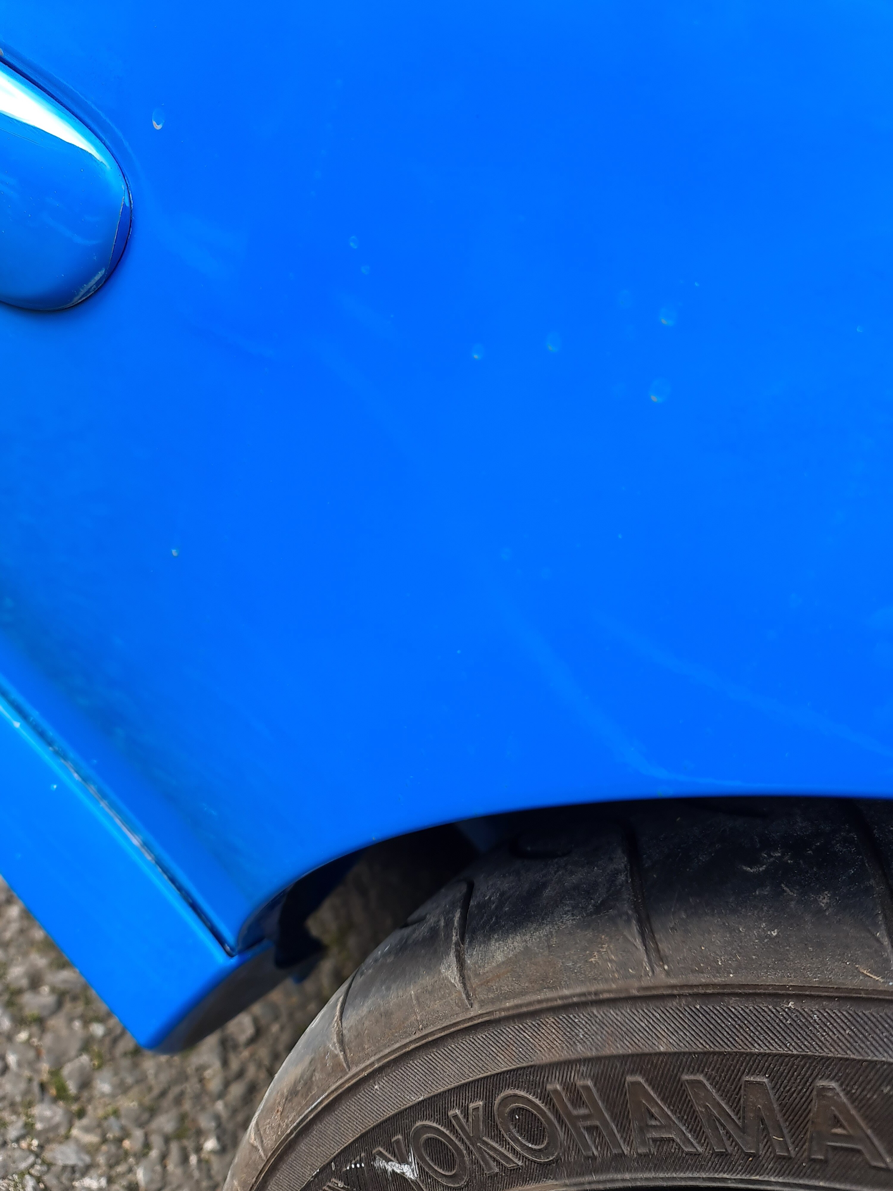

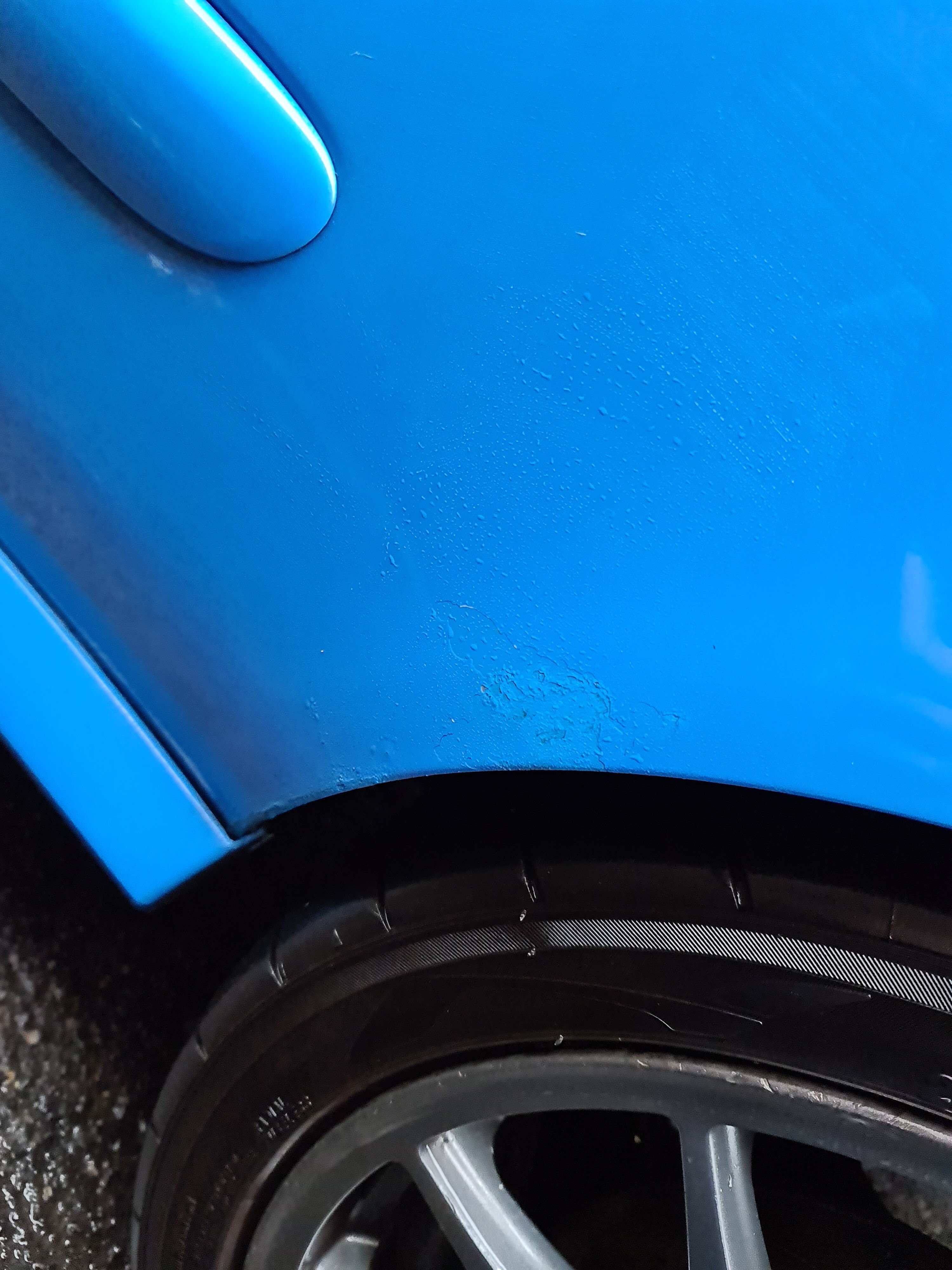

Current paintwork:

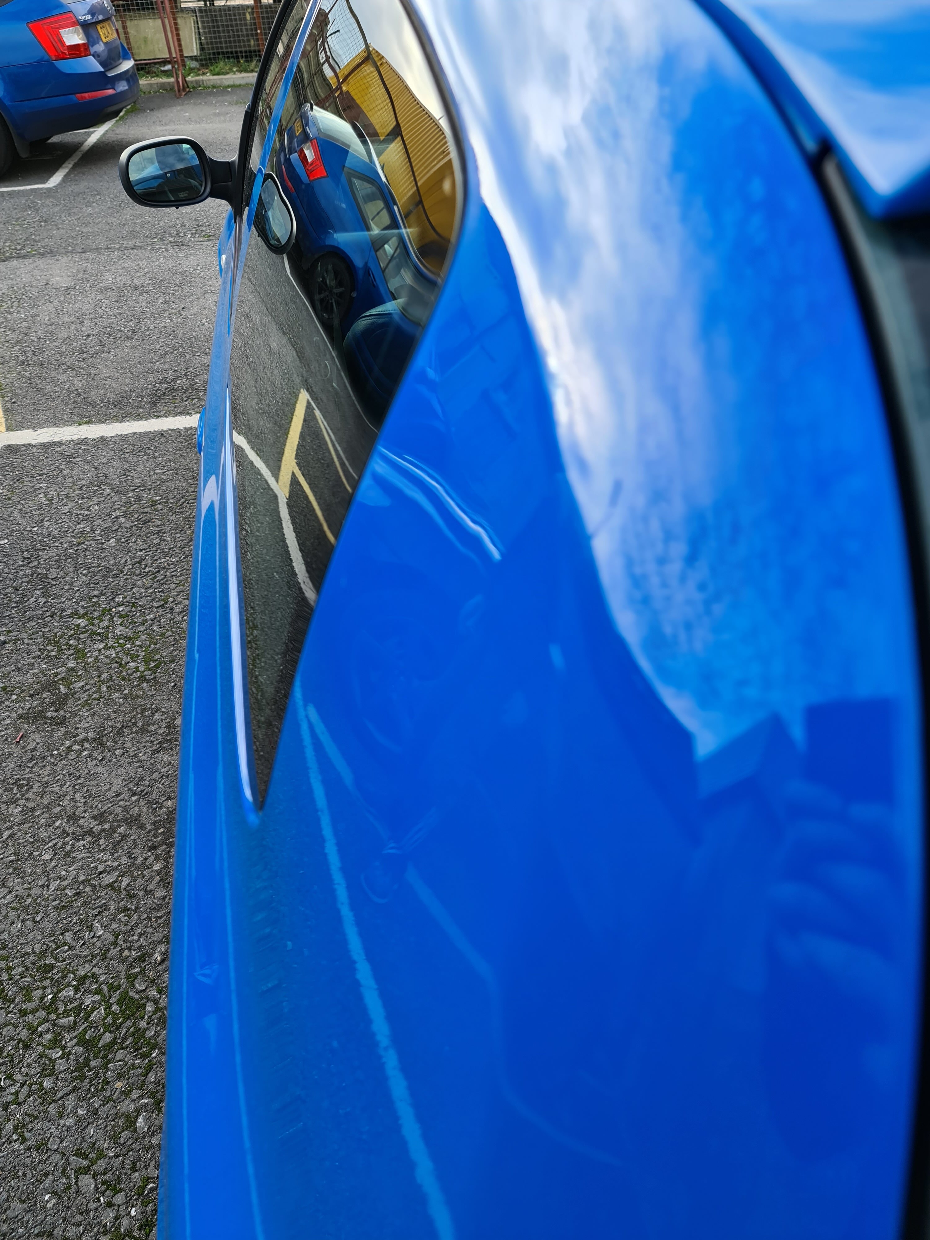

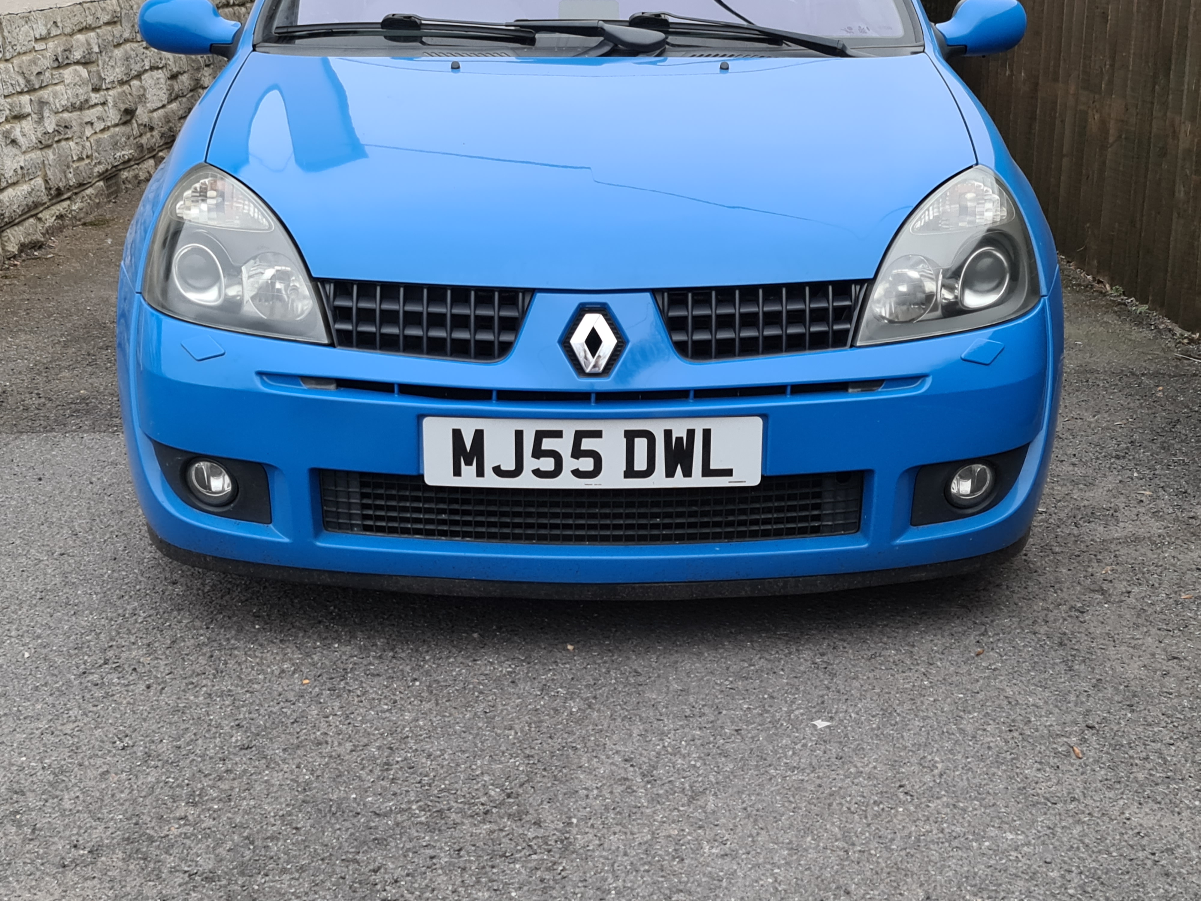

Just a quick update whilst the car is getting the poor/rusted paintwork and a few dents seen to, due to be picked up on Friday:
A bit of a better picture of one of the dents that appears to have been repaired previously but just not very well!
ABS sensor replaced, cat and mounting kit fitted, split exhaust hanger replaced, driveshaft replaced due to the split oversized CV boot and all dash lights have disappeared, seemed quite weird not seeing any errors lighting up the dash. Good news is it didn't last long, on the way over to drop the car off for the paintwork the airbag light popped up, will have to check once its back to see if anything has come loose under the seat.
Car sounds much better/quieter with the cat fitted and after securing the exhaust a bit better, no more rattles or vibrations.

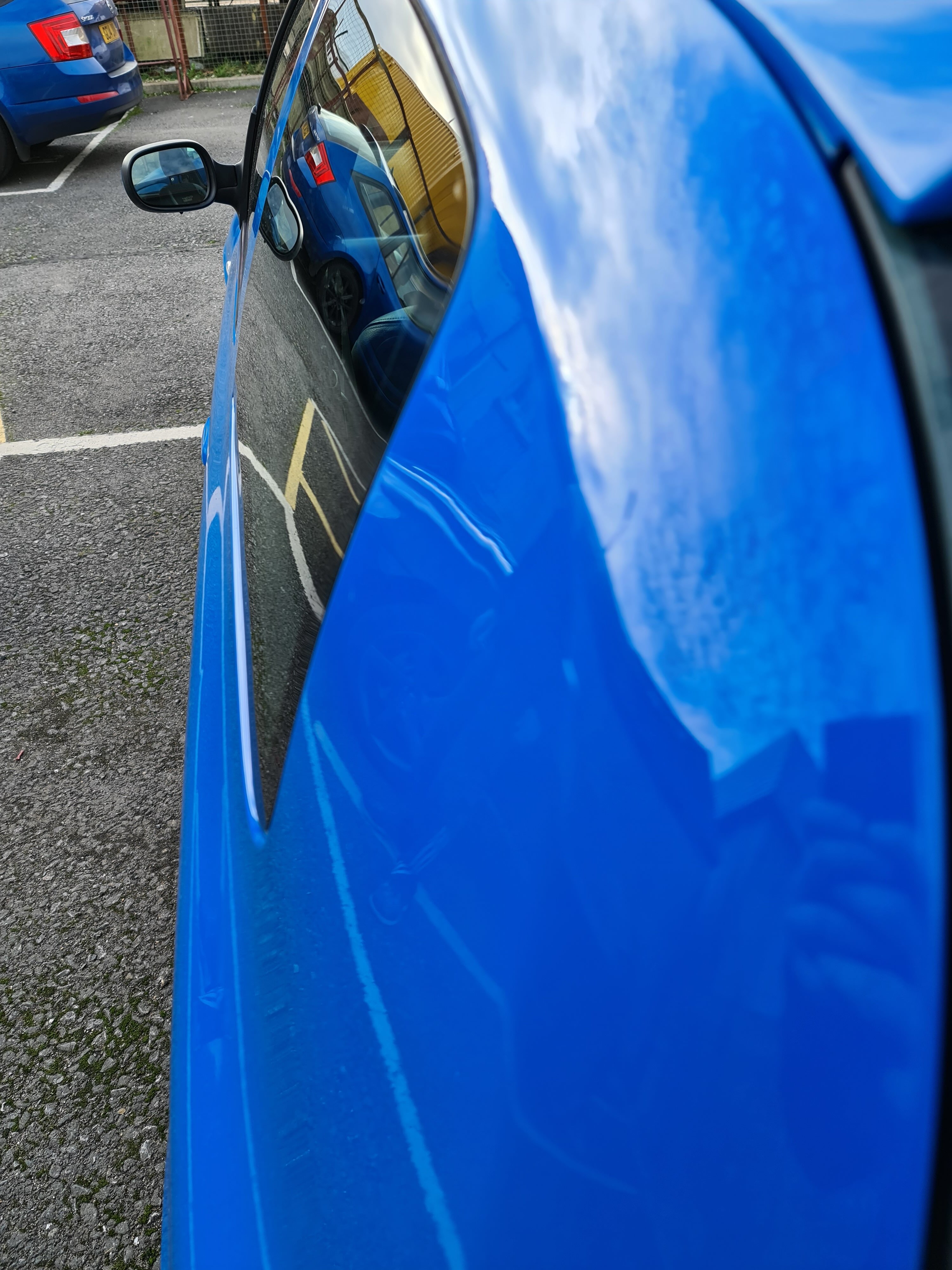

Great to hear some of the car's history. Plans are to return the last few bits to standard bar the exhaust and then just keep, enjoy and maintain it as is. Seems the majority of the issues have since been fixed from when you last saw it, still running a couple of mods, such as the Espace V6 airbox but will definitely be changing that back to standard.
Put theme stripes back on it, they look great with stripes on.
Not too sure on the stripes to be honest, would have to see one in the flesh to make my mind up. Might look into it eventually but it wouldn't be until the rest of the car has been sorted as still a few scuffs on the bumpers and the bonnet. Also the alloys could do with a refurb before then!
Looks good! Do you have any progress pictures to show the blend lines?
What sort of price did this cost you out of interest? Mine need doing!

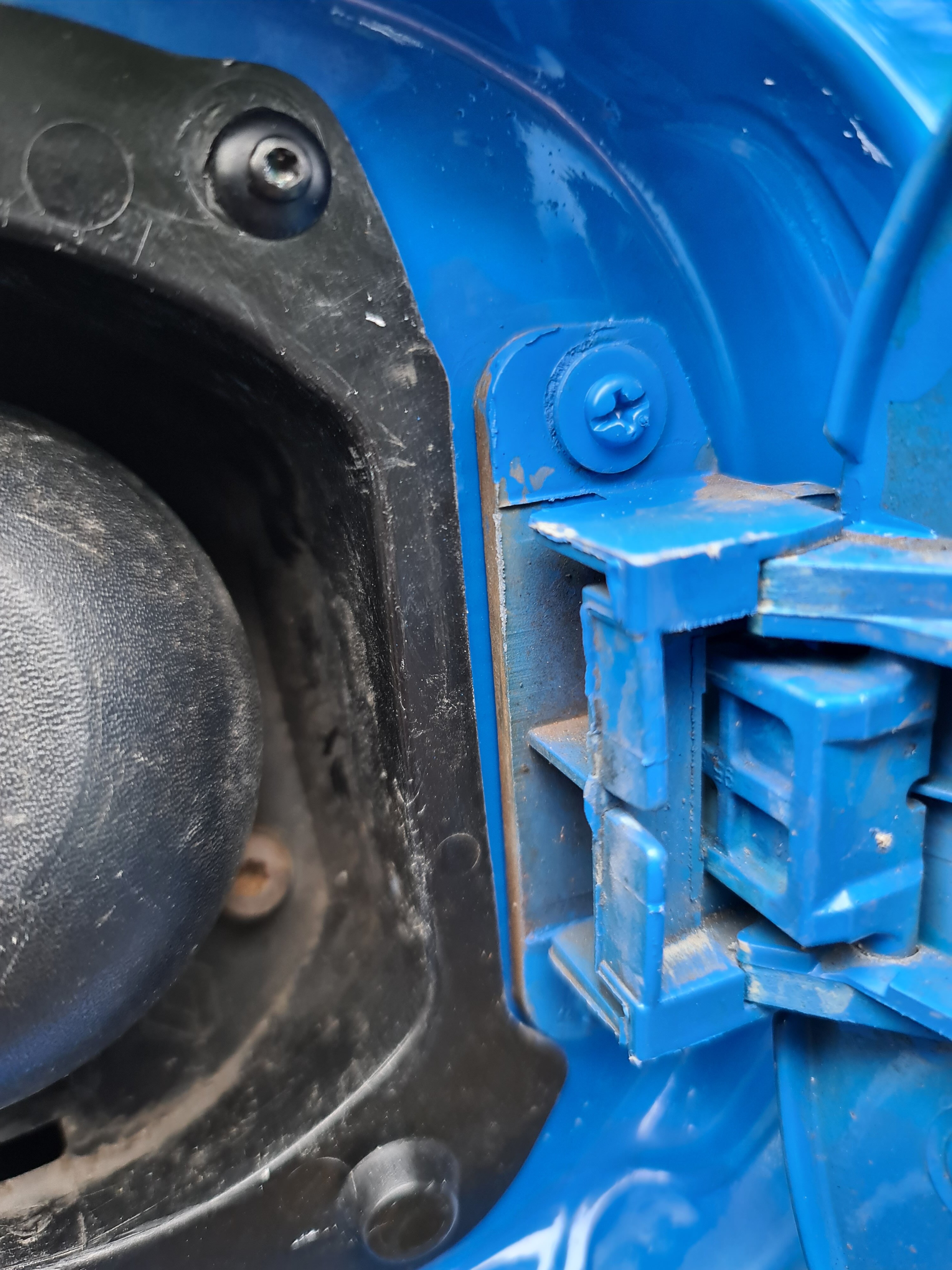

Approx £350 in total including replacing some of the rivets on the fuel cap, only have before and after pics unfortunately. Just needs a bit of a wash to get some of the dust off now, can see it in some of the photos.
That’s a great price mate. You've certainly not hung around with this!!

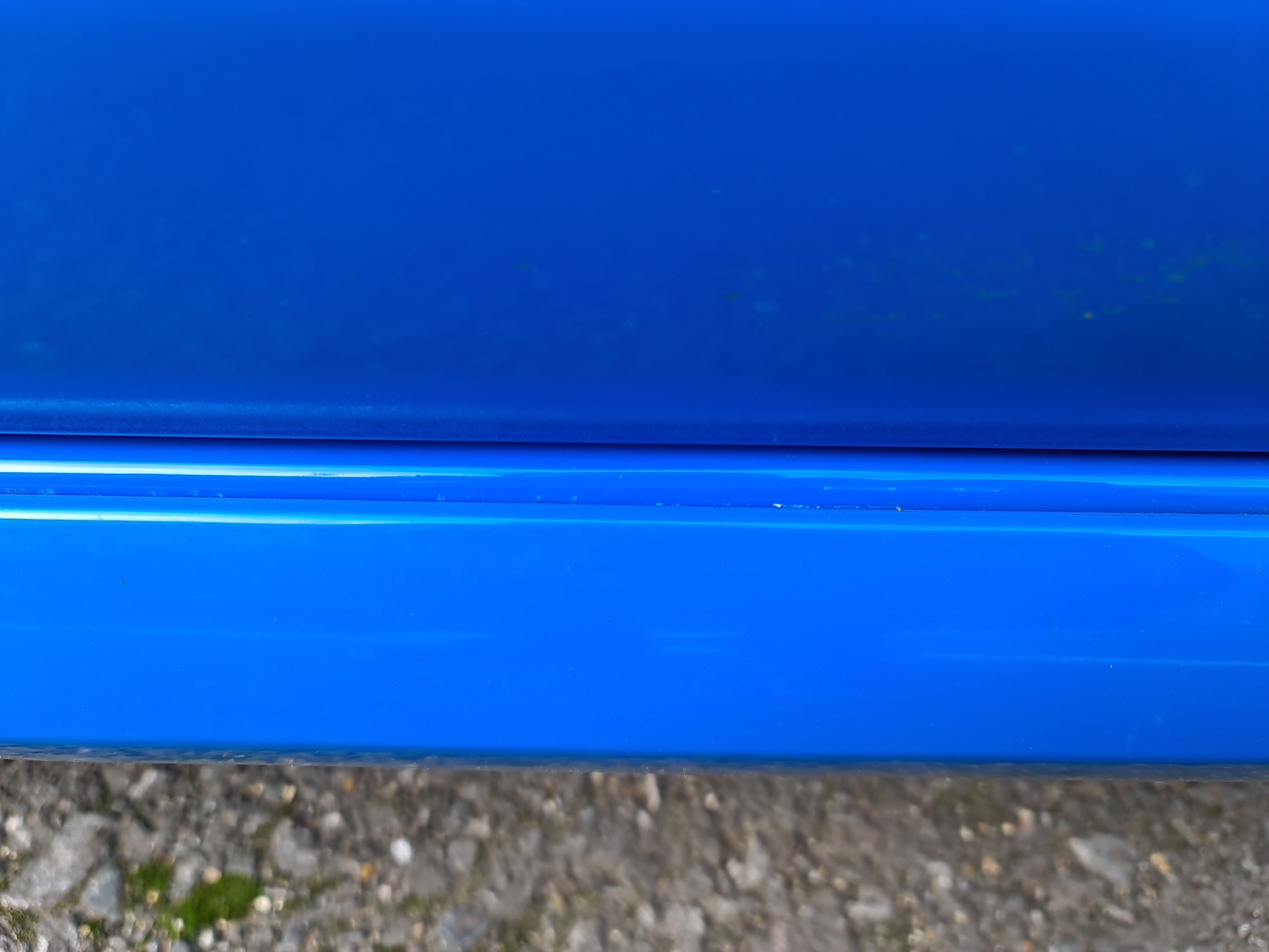

Liking the progress, but what has happened to the rubbing strip? Looks like it’s been badly masked?
Not too sure but the strips don't match the rest of the body work and there are a couple of lines like that already on wing mirrors so think it was already like that, dont think the lighting helps much either! Will all get sorted in time as the plastics need matching to the metalwork, seem to have faded slightly worse with age than the metal, just might take a while to get it all there.

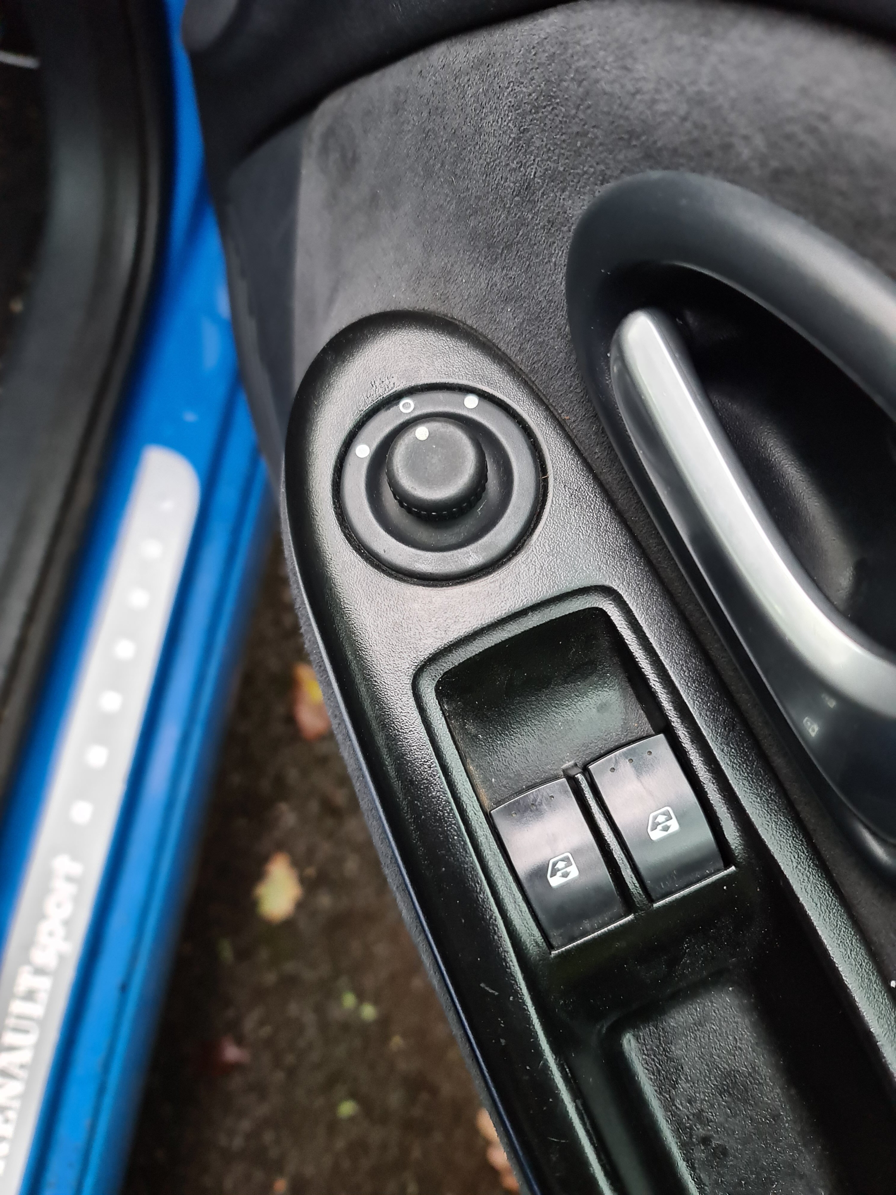

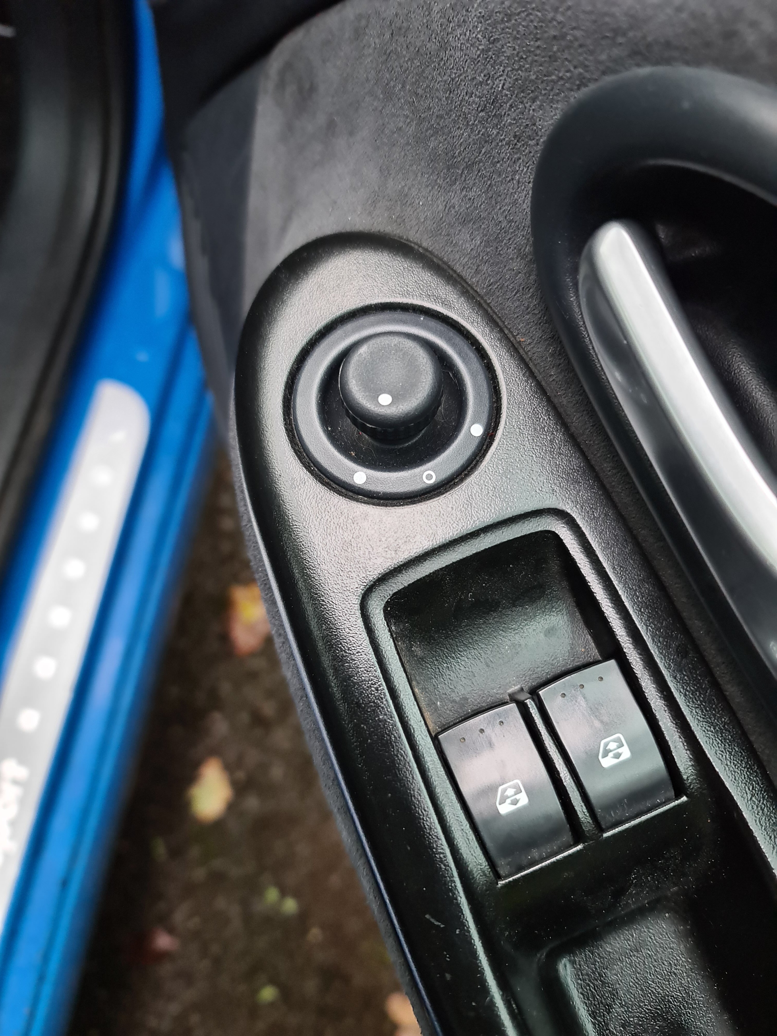

Changed over the mirror switch so it's no longer inverted, only had to buy three before one finally turned up without getting lost.

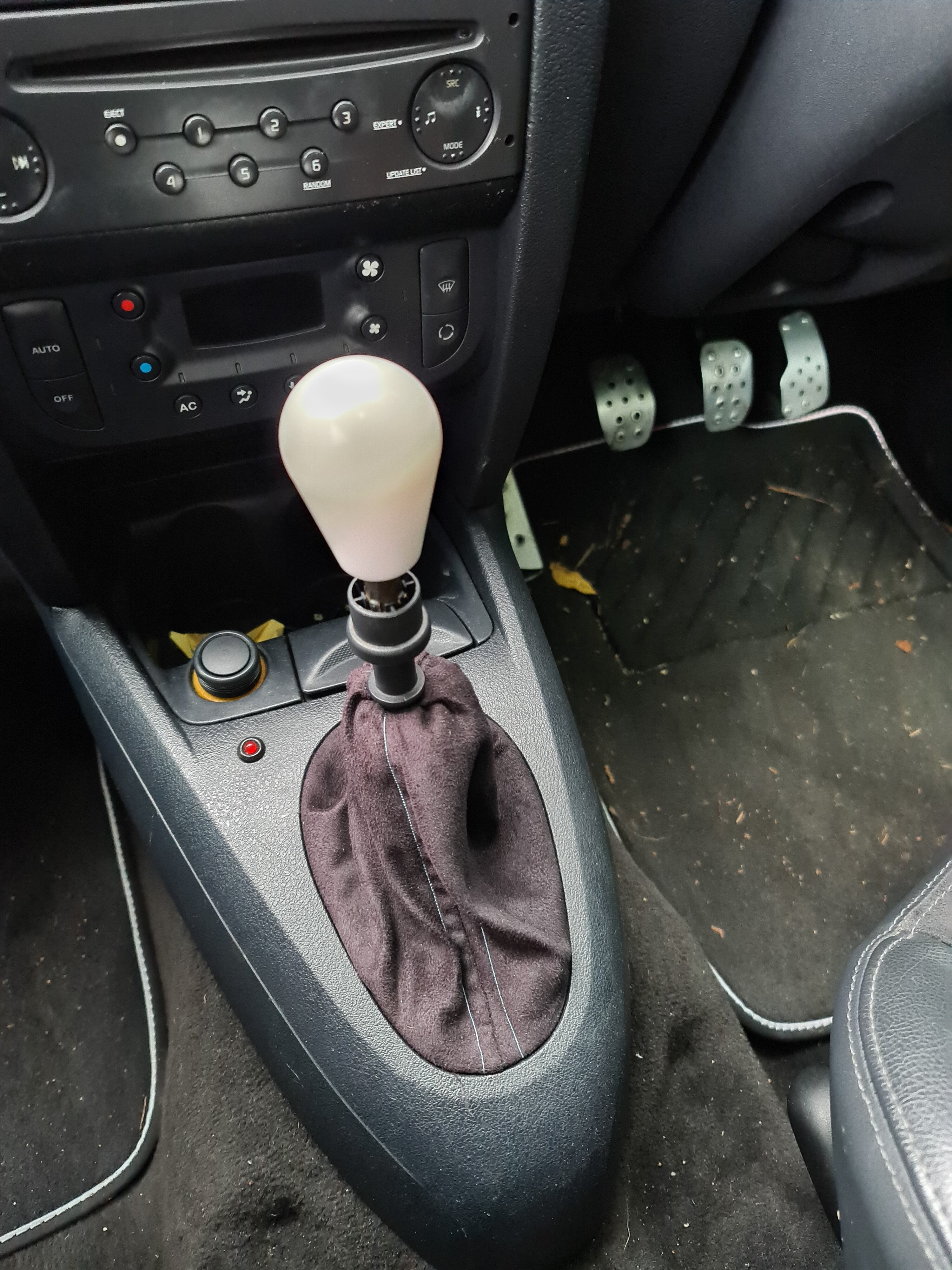

Also switched the gear knob for the genuine OEM one, the nylon one was a real pain to get off.
Can't seem to insert the photo of the new gear knob without the post breaking but just imagine the standard one and lots of nylon dandruff covering the car from where I cut it off.

Thanks all, bodywork is good except for the usual filler cap rust which is now sorted. The only other rust appeared to be on a panel that was previously replaced so sort of expected. Anyone know the part number or where I can get the plastic support behind the bumper near the number plate as that could probably do with being replaced eventually due to a few cracks I can see at the back of it?

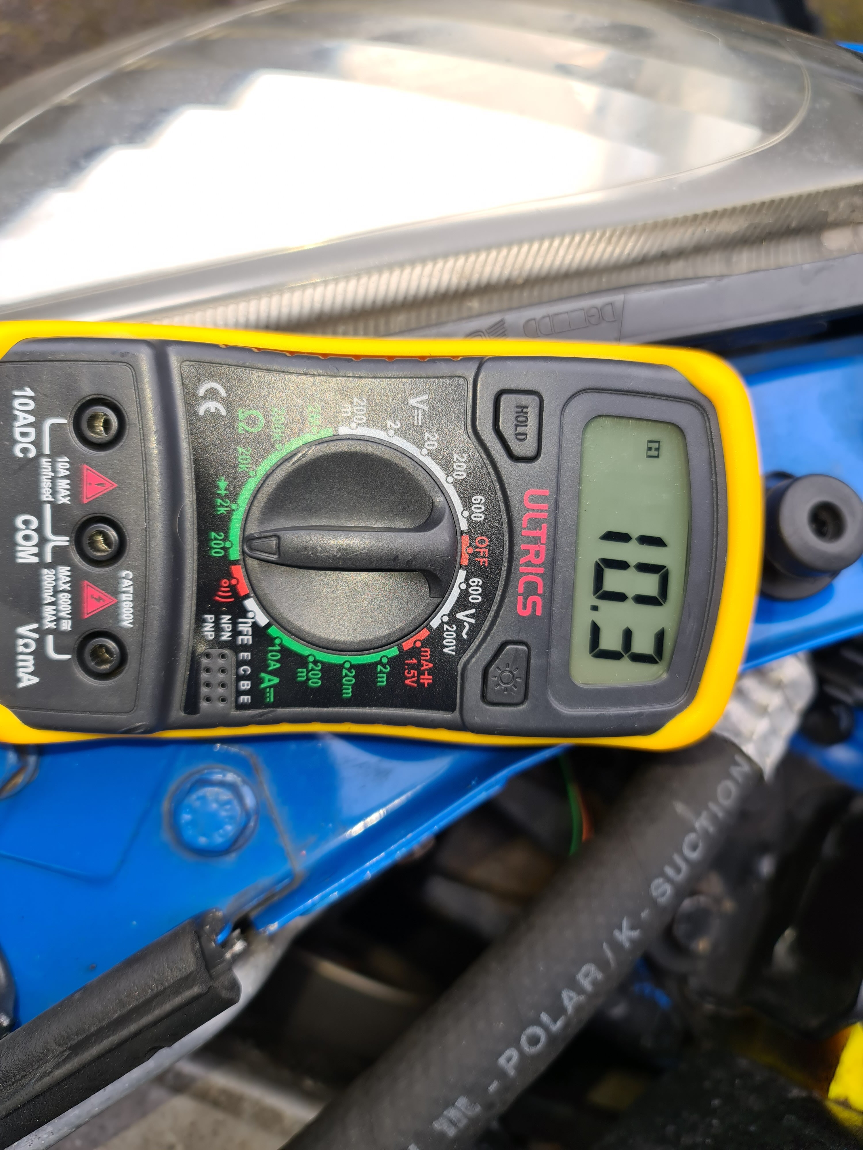

Spent a bit of time trying to determine what the fault might be and tried a couple of things that were suggested. Switched around the aircon and fuel pump relays and the fault seems to have disappeared although now a Misfire is showing on Cylinder 2 especially when cold but the spark plugs are due to be changed shortly so have ordered a set from @George@RTR_Parts, which arrived the very next day, ready to be installed over Christmas.
Just need to go back in to the relays at some point and figure out what they are to order some replacements.

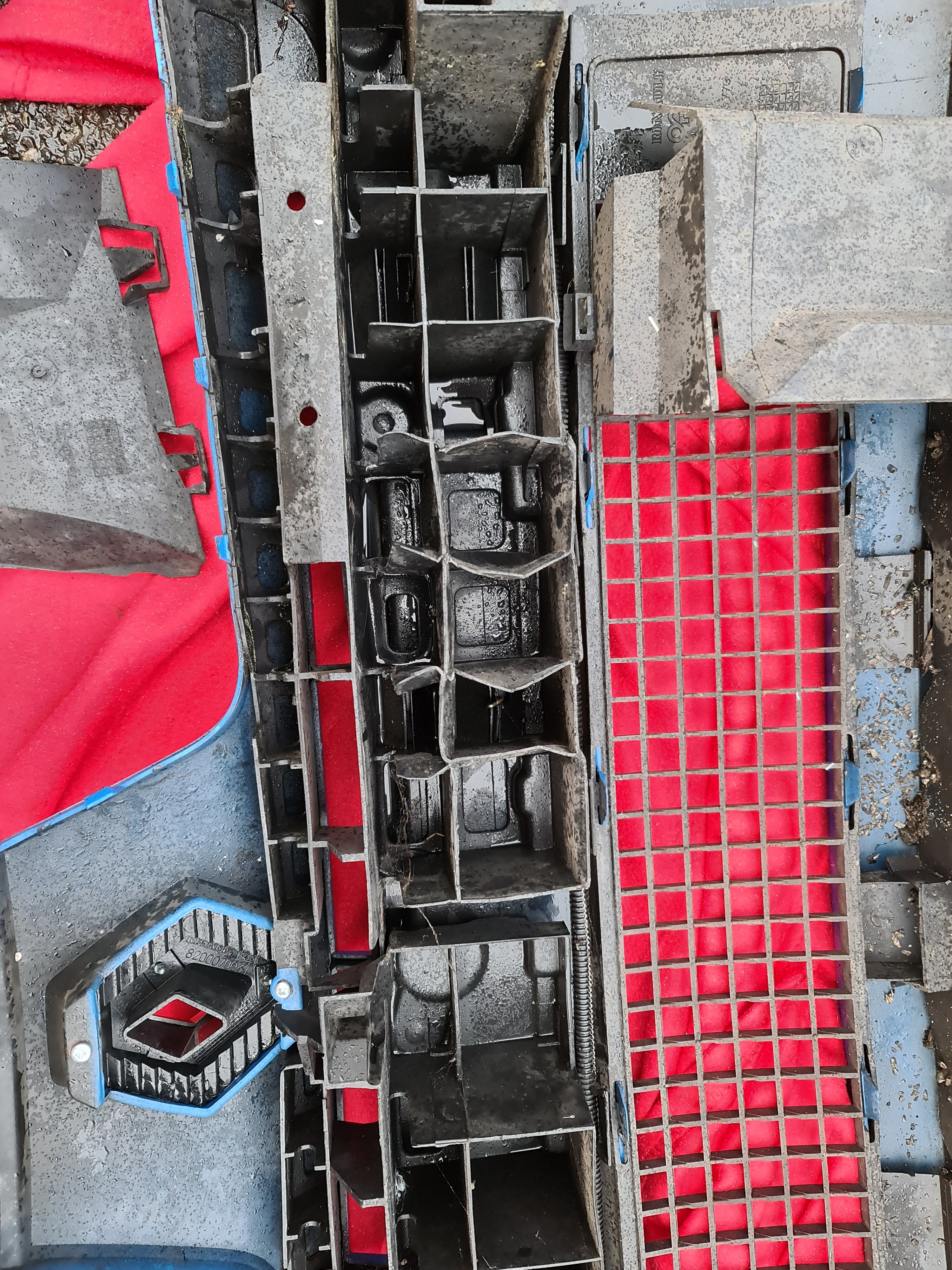

Never noticed this previously the grille was also out of the clips that usually hold it in but that was easy enough to push back in once the bumper was removed, thinking someone may have reversed into it recently, luckily the front of the bumper is otherwise intact.
Sorry to hear you're not having much luck recently. I hate selling cars for this very reason!
As I recall the crash box in the bumper was like that when I fitted it. I would have swapped it for the section in the old bumper, but that was missing that section completely!

Well its good to know its probably not been hit then, got a replacement but that wasn't fitting so have just taken the old one out for now and left it empty until the bumper is sorted in the new year.

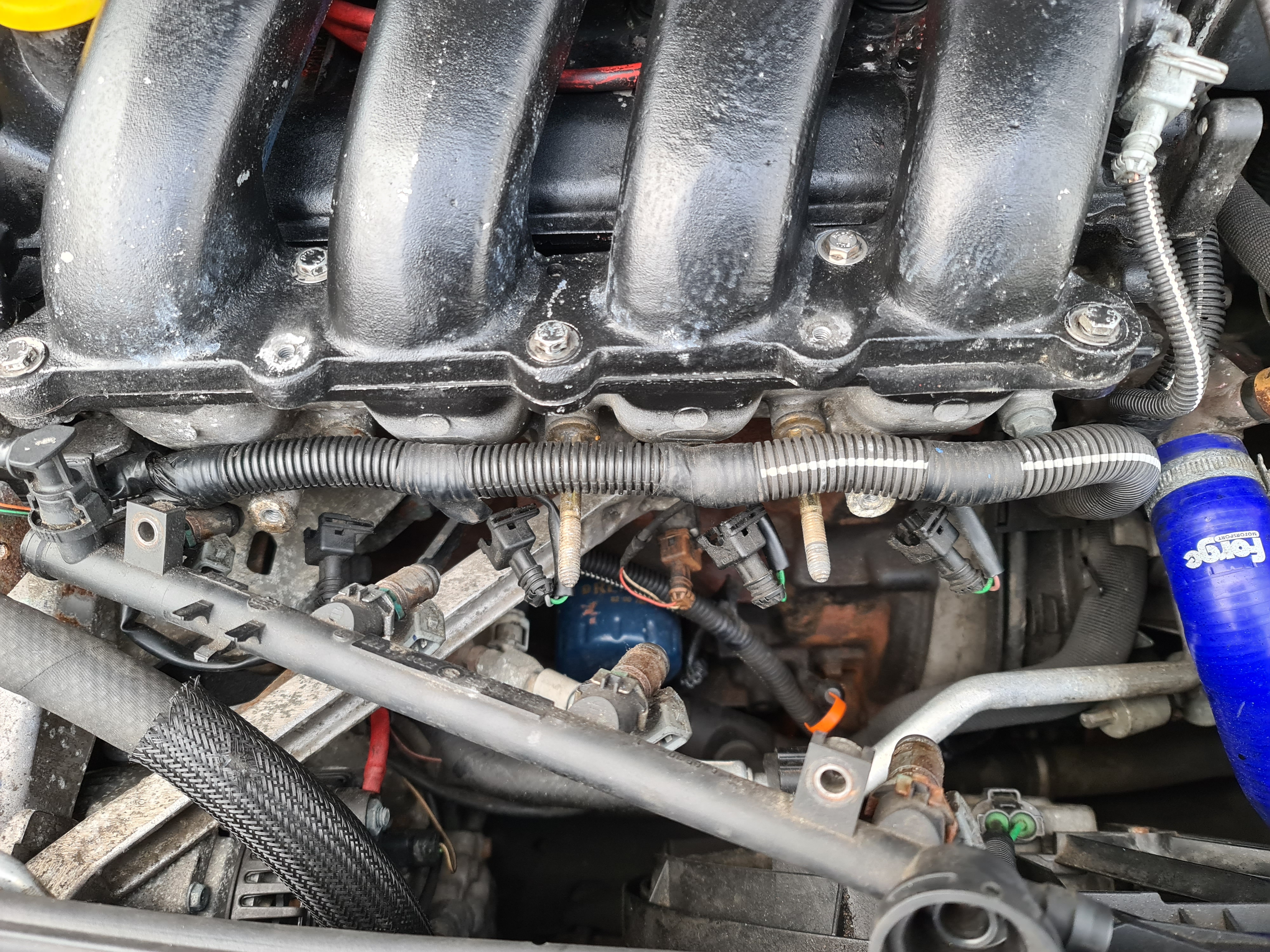

Misfire issue appeared to be getting worse and more often the EML was constantly flashing with a cylinder 3 misfire on the way back from the body shop and was running quite rough so thought it was the right time to change over the injectors.
Purchased a set of nearly new injectors from a breaker hoping at least one of them would be good enough to swap over. Every single one of the nearly new set was reading 16+ so decided to check to see what condition all the current ones were and if any were better.
Injectors checked this morning and think its safe to say that injector 3 was the issue, one injector measuring fine at 14.3, two injectors at 13.0 and the injector on cylinder 3 showing the below...
All replaced and took for a quick test drive to the petrol station, running as smooth as ever and the EML is no more.

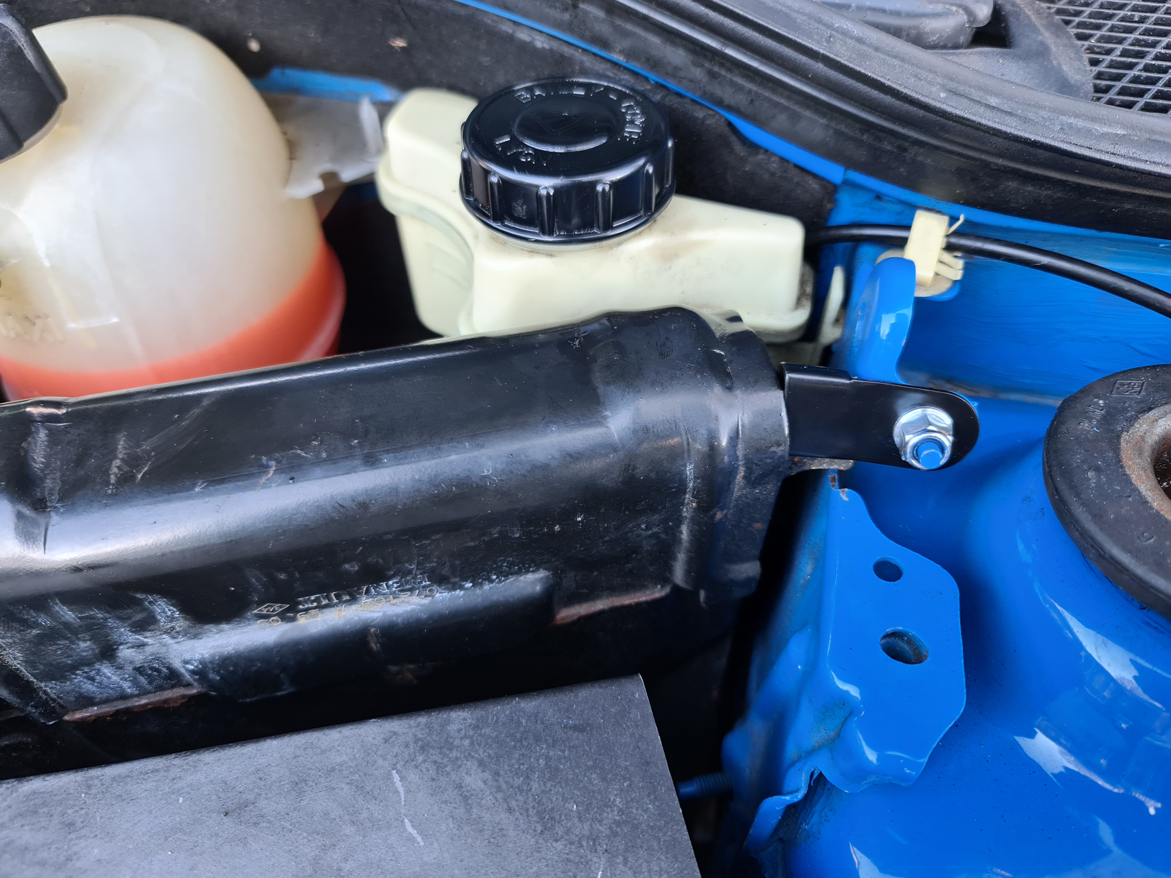

In between all of this I have also fitted an ECU brace made by @CFAB definitely makes it look a bit neater than before and although it was a tight fit the bracket appears to be holding strong with no more ECU wobble, will fiddle with it a bit no doubt next time to try and get it to sit better but haven't had much of a chance to do anything to it besides a the few minutes it took to fit that.
Much better mate.....
Yeah you may need to push the ecu over abit mines a good 5-10mm away so loosen the bolts and have a move about.
You can also bend the tab slightly to make it more level and sit upright. I used a non marking set of pliers. As mine was really bent for some reason.

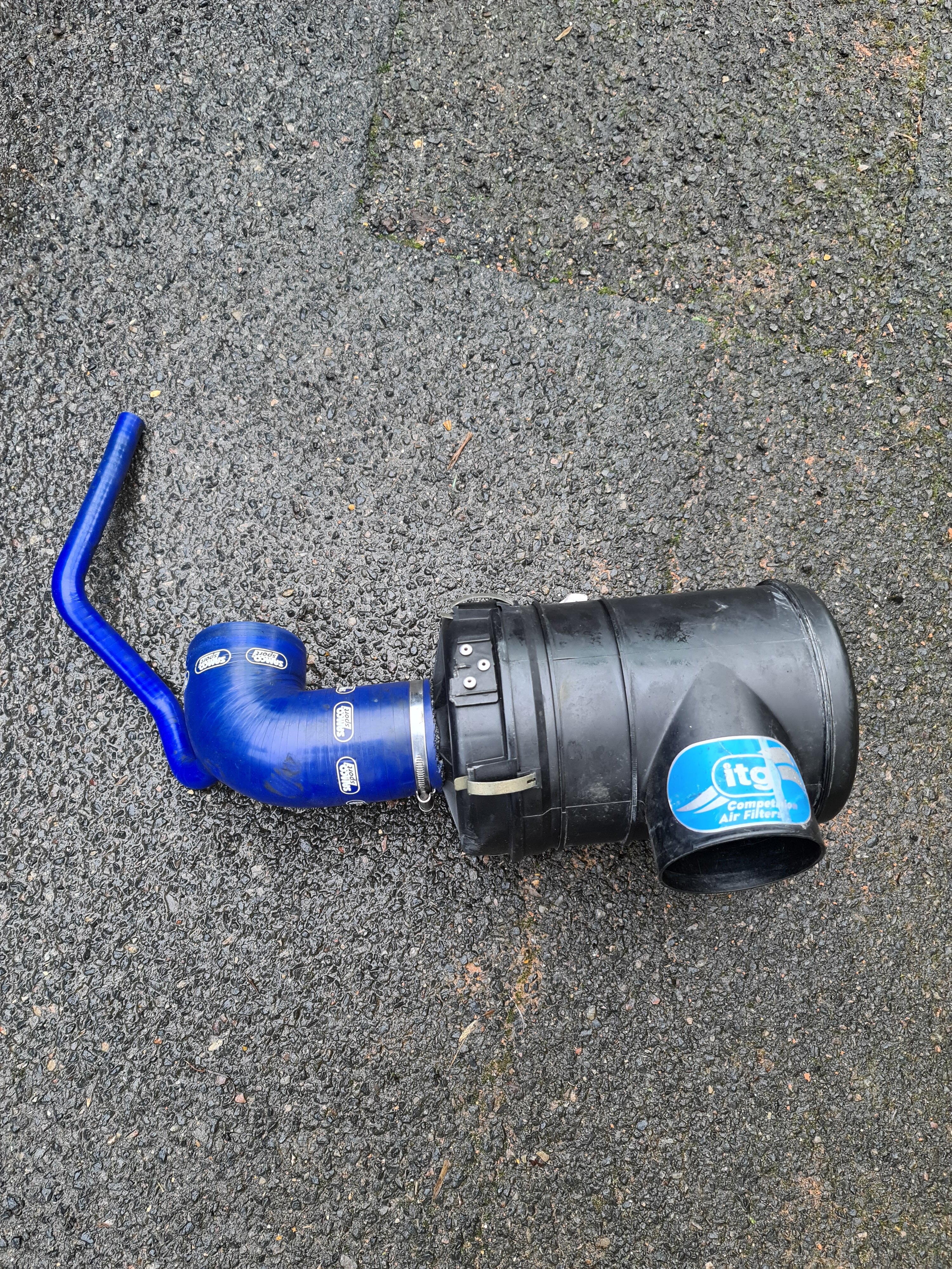

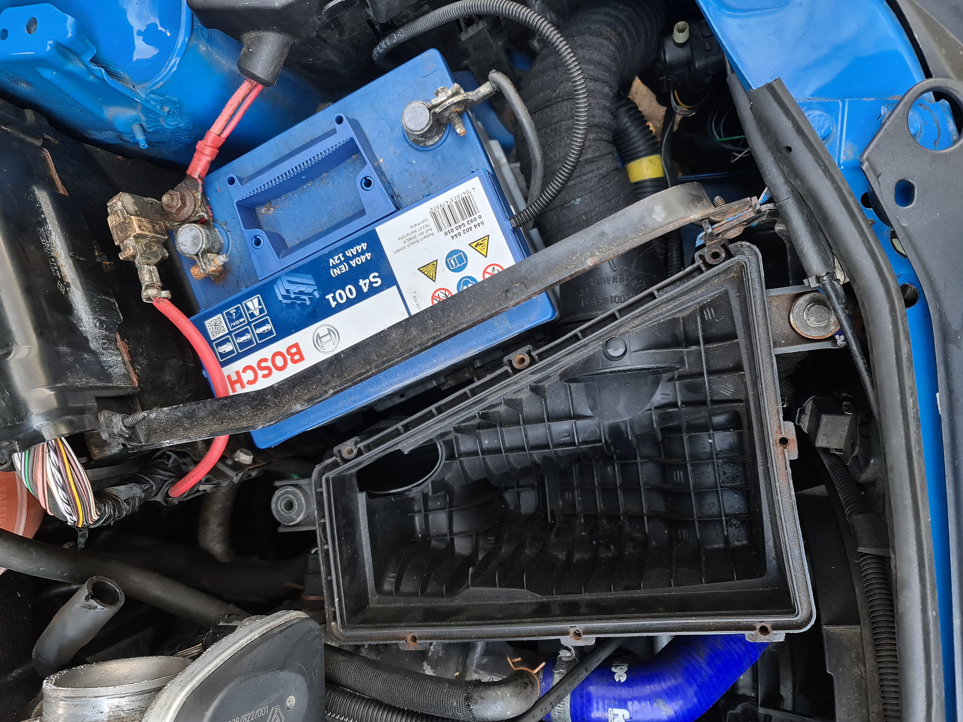

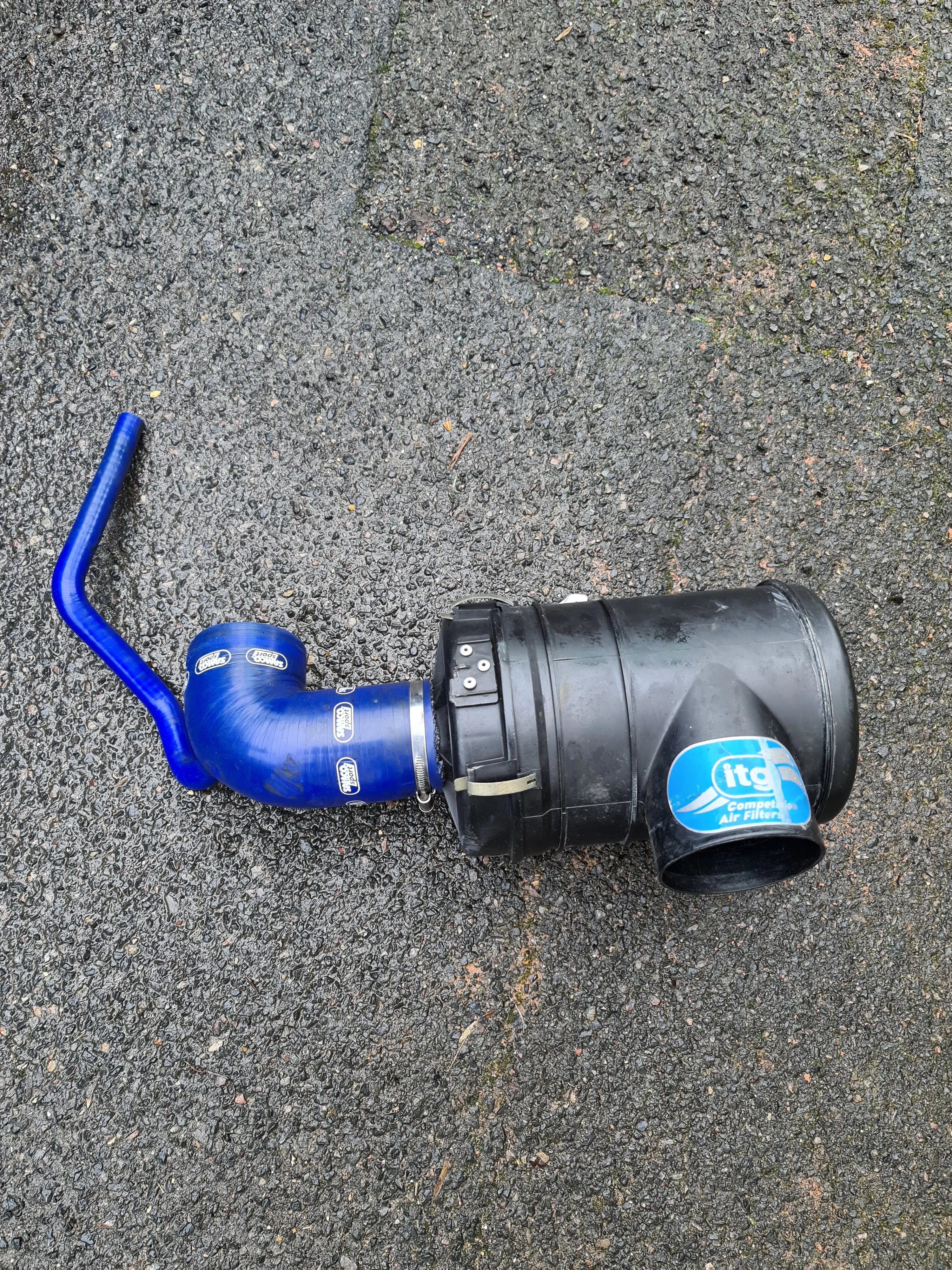

Couple of jobs in between this including replacing the airbox back to standard with a K&N filter as seen below, fitting some colour matched washer blanks and headlight restore as they were starting to go yellow and hazy. Once the weather is a bit better (and the car cleaned) will get some photos of how it looks now.
Old airbox (from a Espace V6) which just pulled out in about 5 seconds:
Standard 182 Airbox with all pipes being refitted:
Acoustic valve was still in place and hadn't been removed even though it wasn't used by the Espace airbox so was easy enough to attach the pipe back to it. Just need to fit the rear bracket to the airbox once I find where I put it... The top of the airbox could also do with a clean where the faded inspection label was.

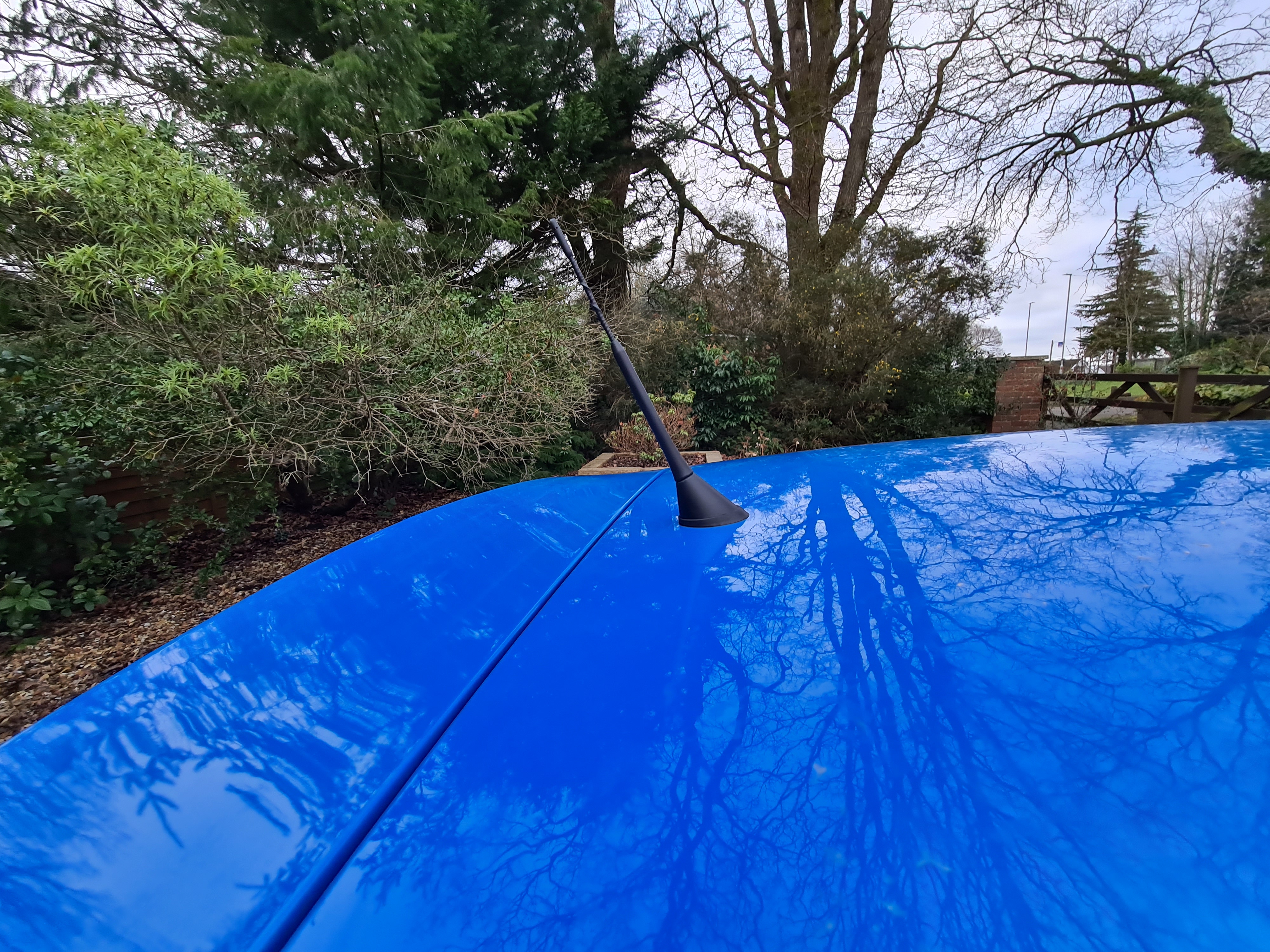

Got the aerial to replace next but unsure if I will get around to it before or after the gearbox, tried a few different head units and antennas and all seem to pick up very few if any stations so will require a new aerial base and to check the wiring. If its the aerial base/wiring will look at getting a combined DAB/FM aerial with suitable head unit installed, currently just a standard Clio Mk2 radio is fitted.

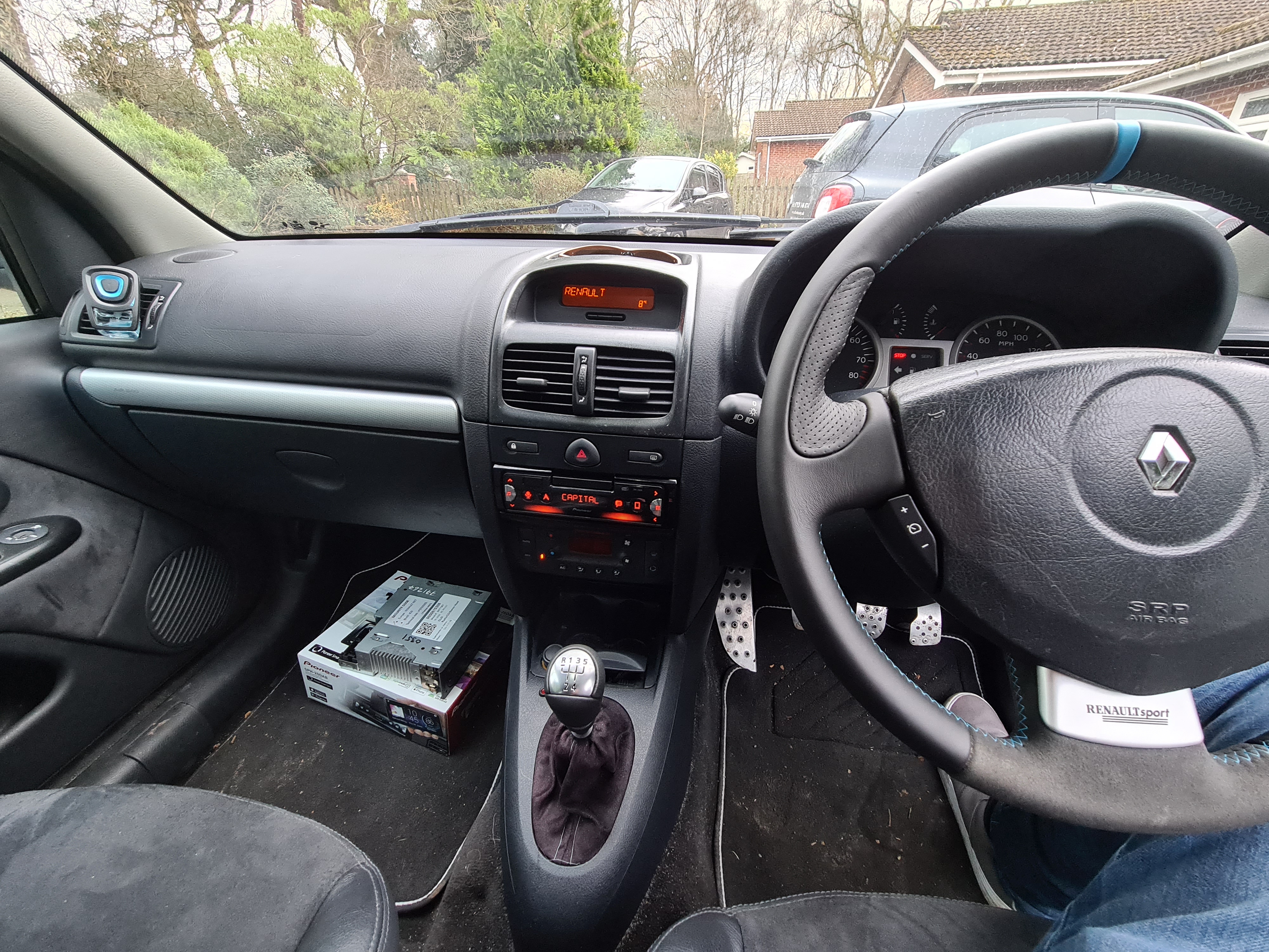

Due to the Clio now being out of action it gave me a chance to fix the radio and aerial, switched for a shorter DAB aerial and compatible head unit and all works well, no more silent journeys once its running again. Set the head unit to the orange colour the rest of the dash lights are so it didn't look too out of place:

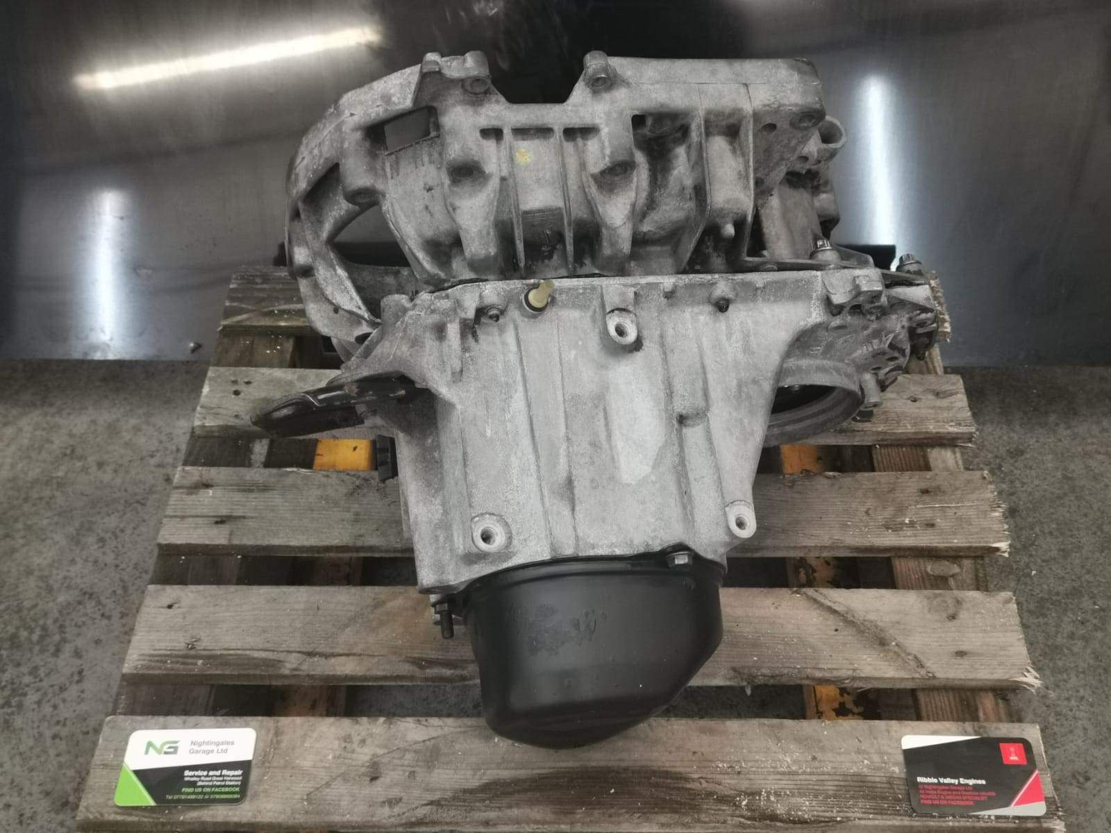

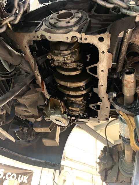

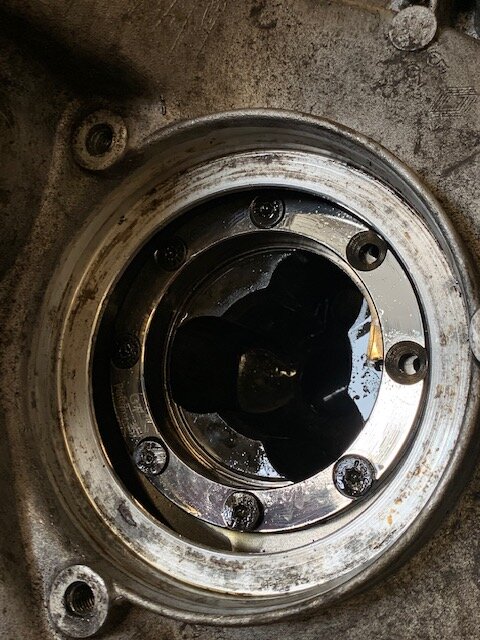

Gearbox and starter motor replaced. Shift feel is so much better and the state of the old gearbox proves it was needed, once removed the oil leak from the bottom end was cleaned and new gaskets fitted.
Old Gearbox, as removed...

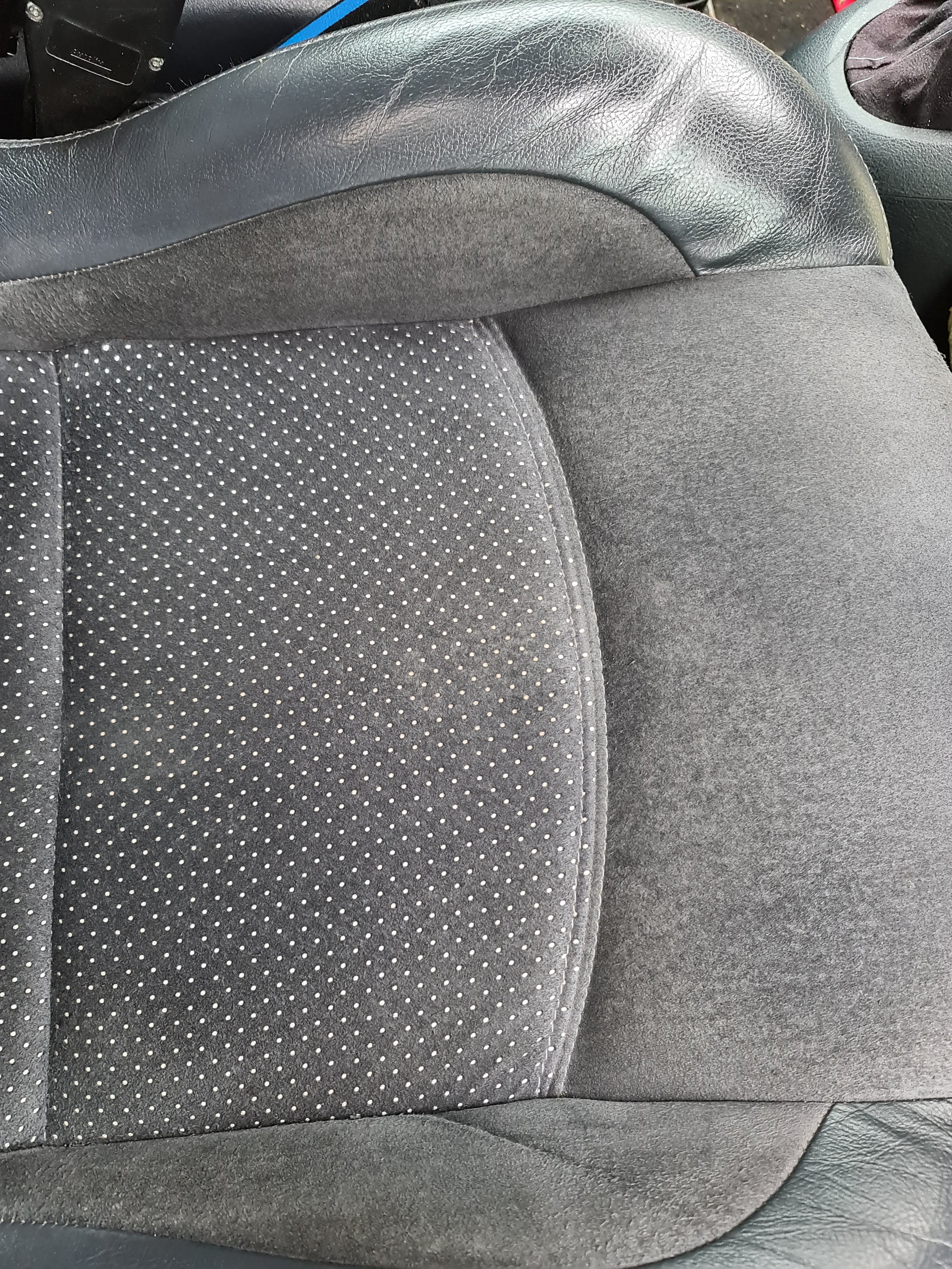

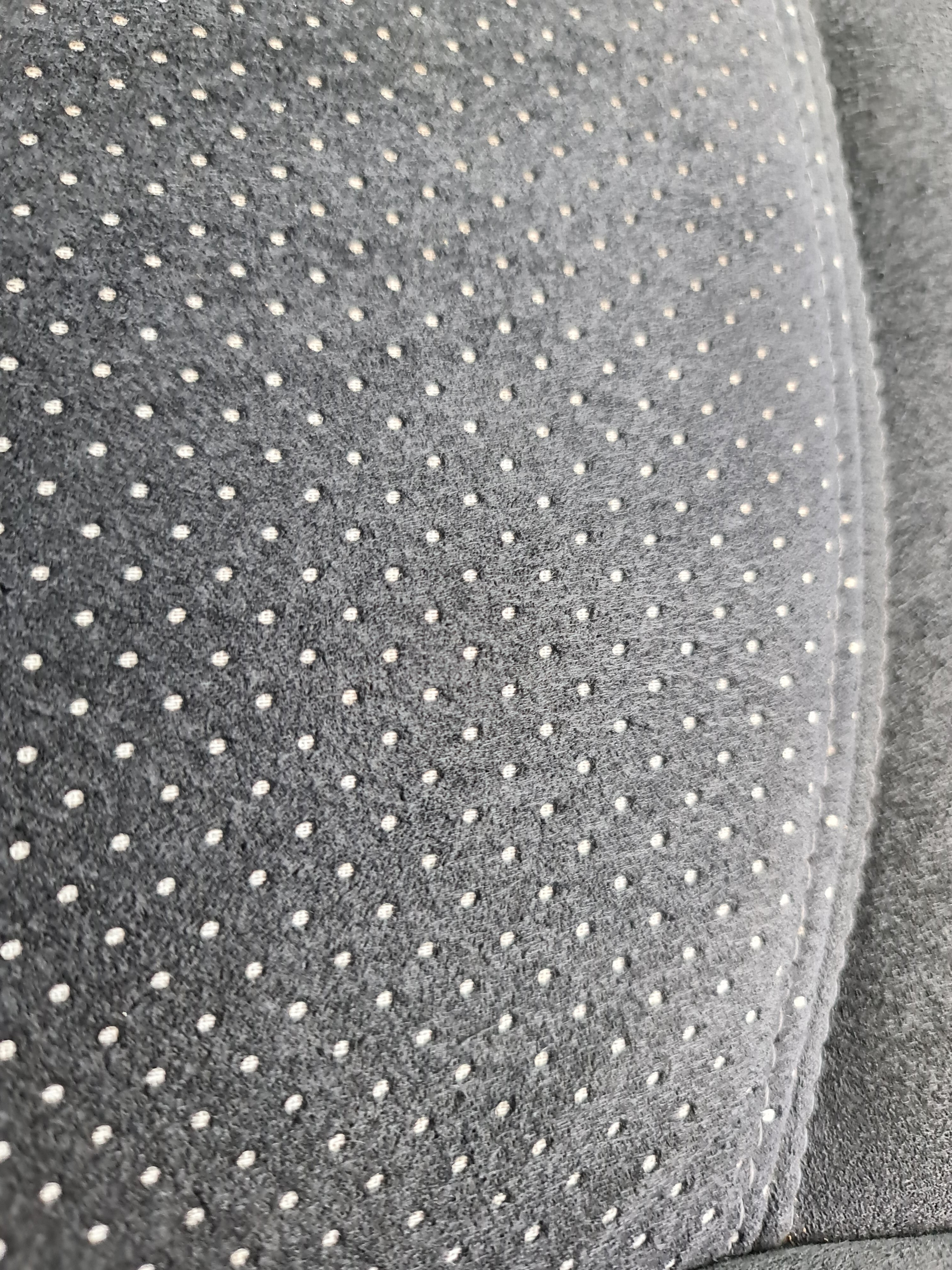

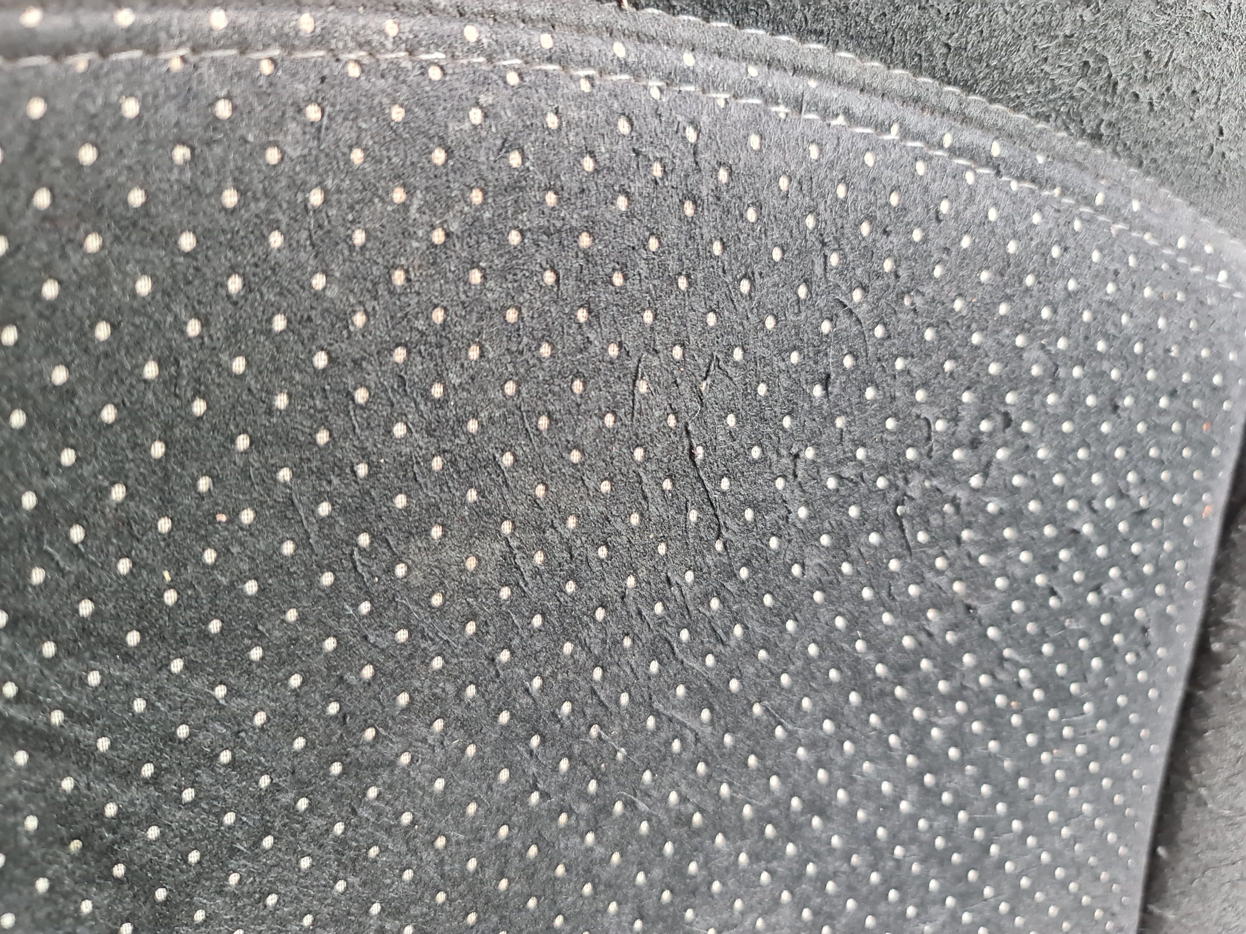

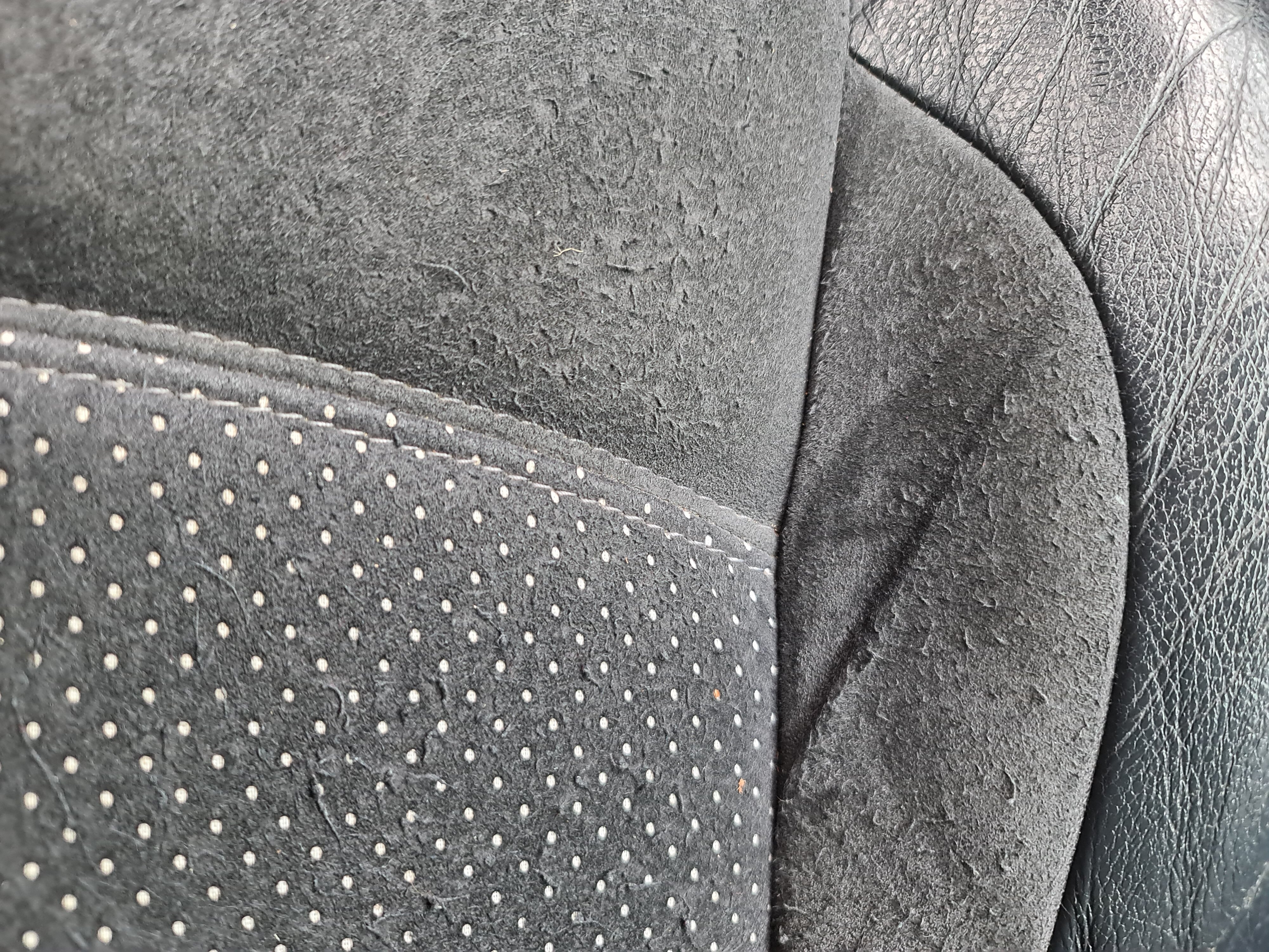

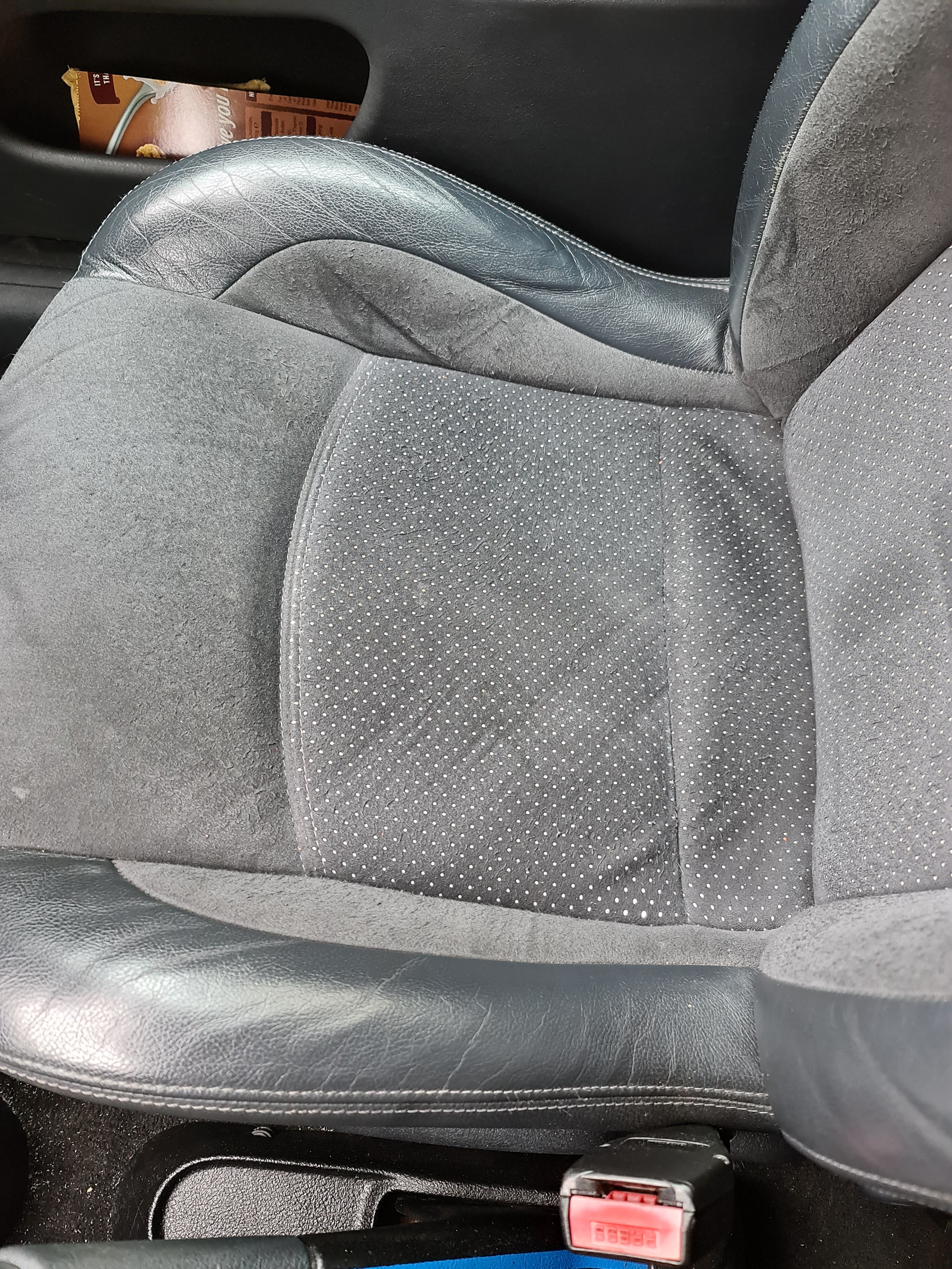

Also started to take the sticky interior apart and clean off the rubber, some bits came out better than others whilst a few bits appear to have been replaced with standard black Clio parts at some point so also got a few sticky rubber parts to clean and replace those with.

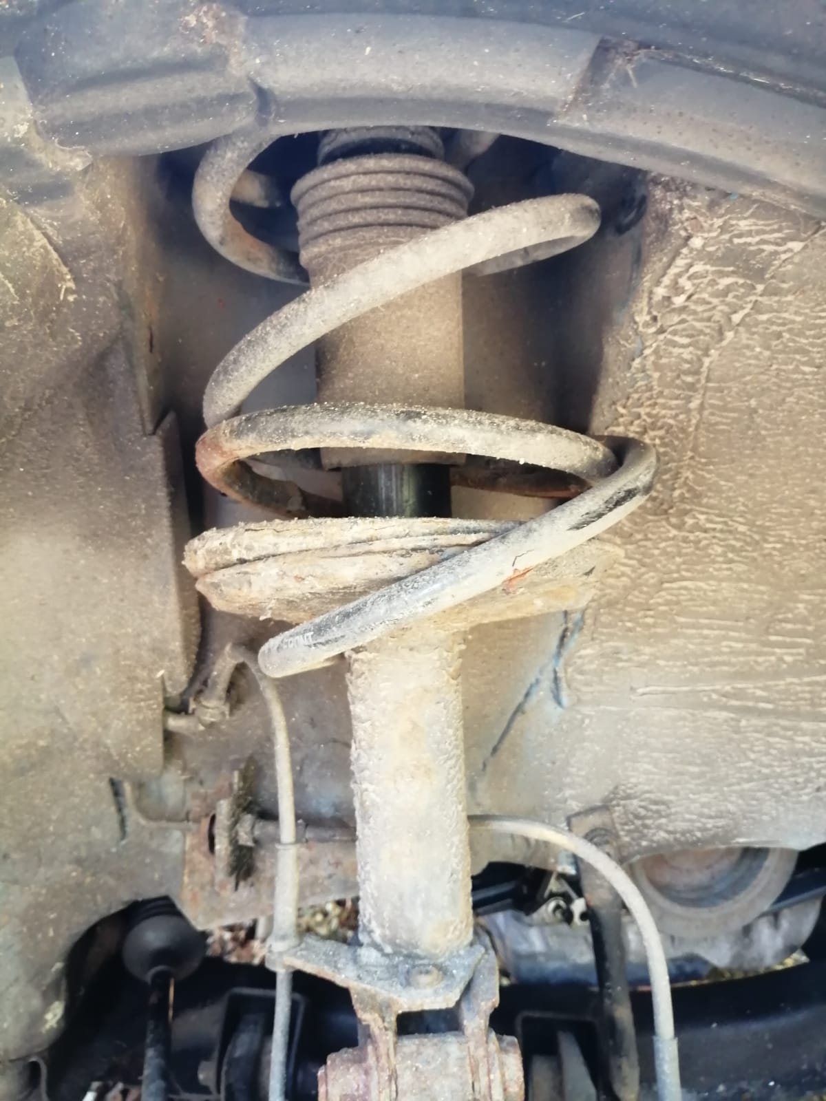

So despite putting off replacing the springs and shocks it appeared I was given little choice. Heard a loud crack and bang from out the front late at night but looked out to see nothing out of the ordinary. Start the car up at the weekend and immediately think something is off and looked like it was leaning to one side. Got a couple of mins away and the driver side is really bouncy and felt off, drove back and jacked it up to find this:
The cooksports had snapped, on the front driver side. Managed to source and collect a set of new Eibach Prolines and new genuine cup shocks. Gave the old shocks a clean once off to check for any Renault markings or branding out of curiosity but there were none where I was expecting to see them so can only assume these weren't genuine.
All fitted front and rears and been for a short test prior to getting wheel alignment sorted and much happier, no more knocking from the shocks, far softer and slightly higher ride which is what I wanted, compared to the cooksports and whatever shocks were on it last.
New shocks and springs fitted:
need to treat the new shocks to a lovely new set of stainless ABS sensor brackets mate!
Thanks, was going to look for some of these, and these look perfect, managed to get the rusted ones off with a lot of effort but wasn't expecting the shocks to be so rusted. Only other part that could do with replacing as they have rusted beyond saving is the top part of the shocks that the springs go between but not sure what to look for...?
