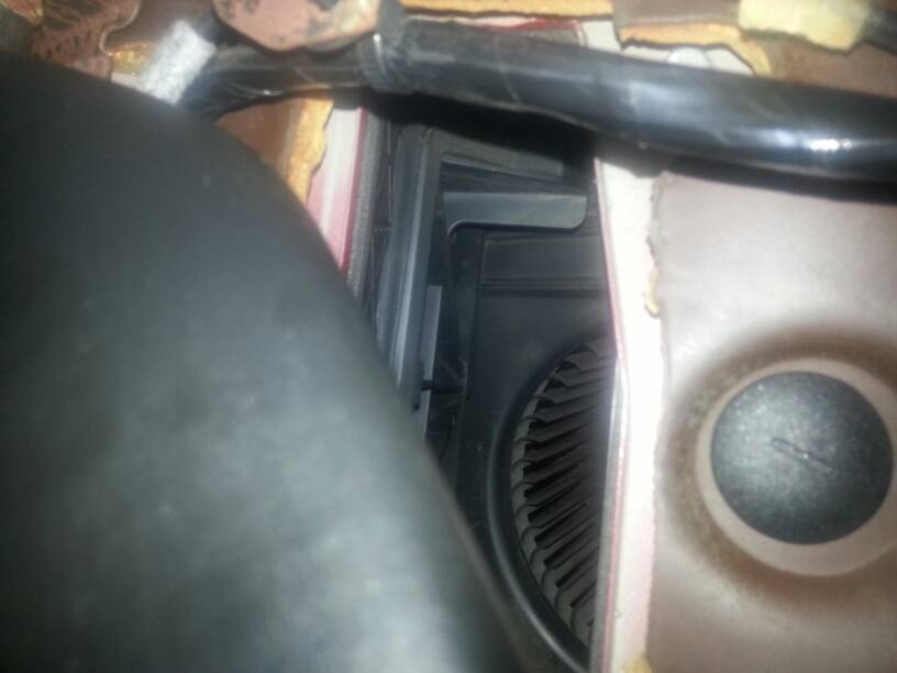

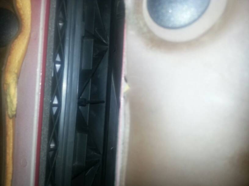

Maybe its still slightly damp from your leak? I forgot i was supposed to grab a pic. Ill get one now for ppl asking.
  PH2 Flamer
This is the flap
And the fan inside
Sorry for the pics this stupid tapatalk rotates them.

that is the main fan for the heating ? just under my front seats is damp to touch which doesnt seem to be getting better

Thinking about it though, im pretty sure the main vents have a seperate blower motor.
When its daylight ill play with the fan speed and see of this fan speeds up/slows down
  PH2 Flamer
And im supposed too.
Remove drivers side scuttle and there it is, or pop ur head under the steering column and there it is. You can even feel the blower if the vent is open. Like my pic shows.

My windows seem to be demisting a lot better now, but the recirculation button doesn't sound like it kicks the flap all of the time, is that normal? :S
  "Navy" N17 TWO
My recirculation flap is definitely not moving, tried pressing the button between most functions/combinations on the Climate panel
whilst my head buried in the drivers footwell with a torch :dapprove:
No joy :S
What else can I check to resolve this, or is the motor goosed, if so is it easily changed?
Thanks in advance!
  PH2 Flamer
Just open the flap with your hand mate.
Most likely means the motor is faulty. No idea how easy it is to replace though.
