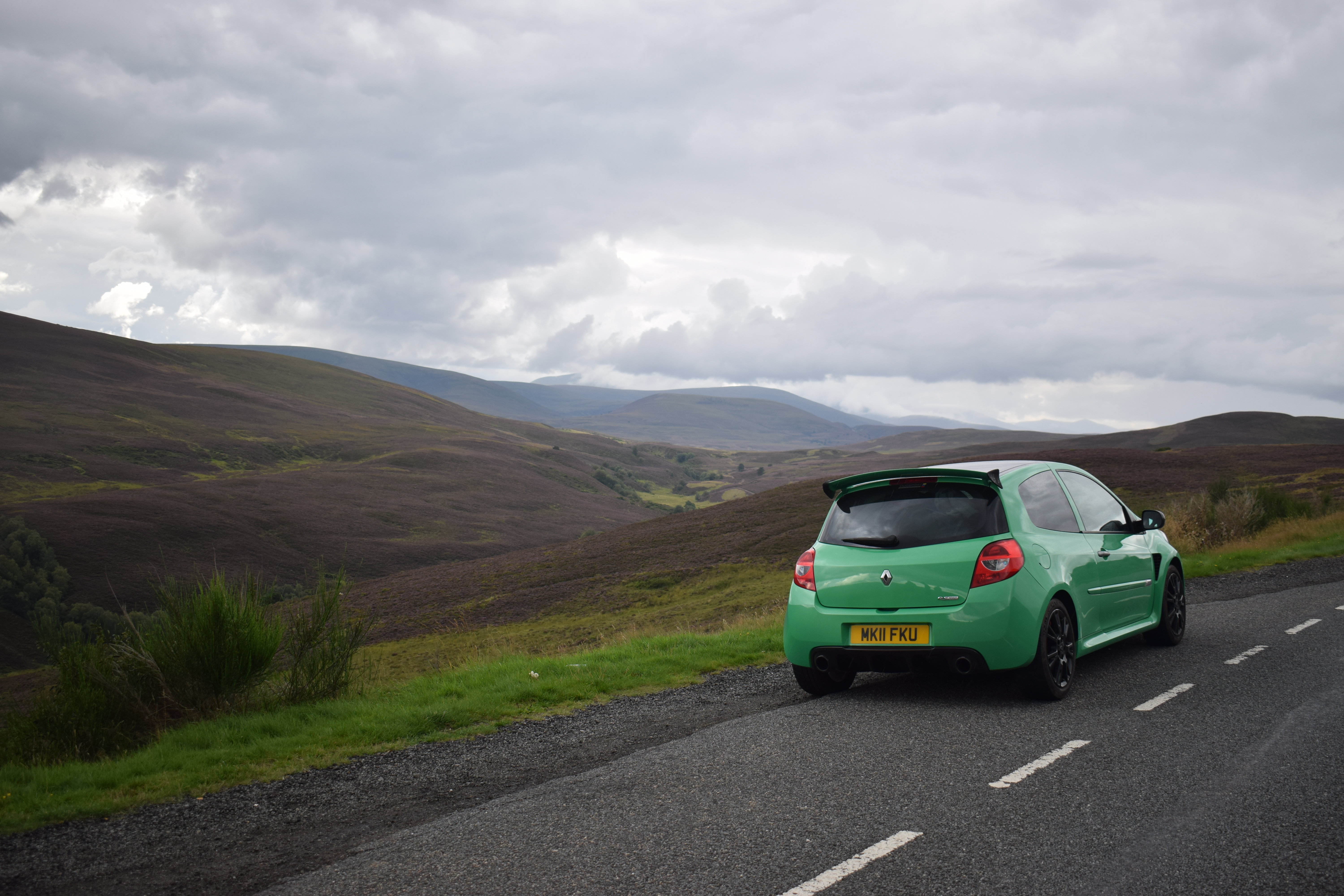

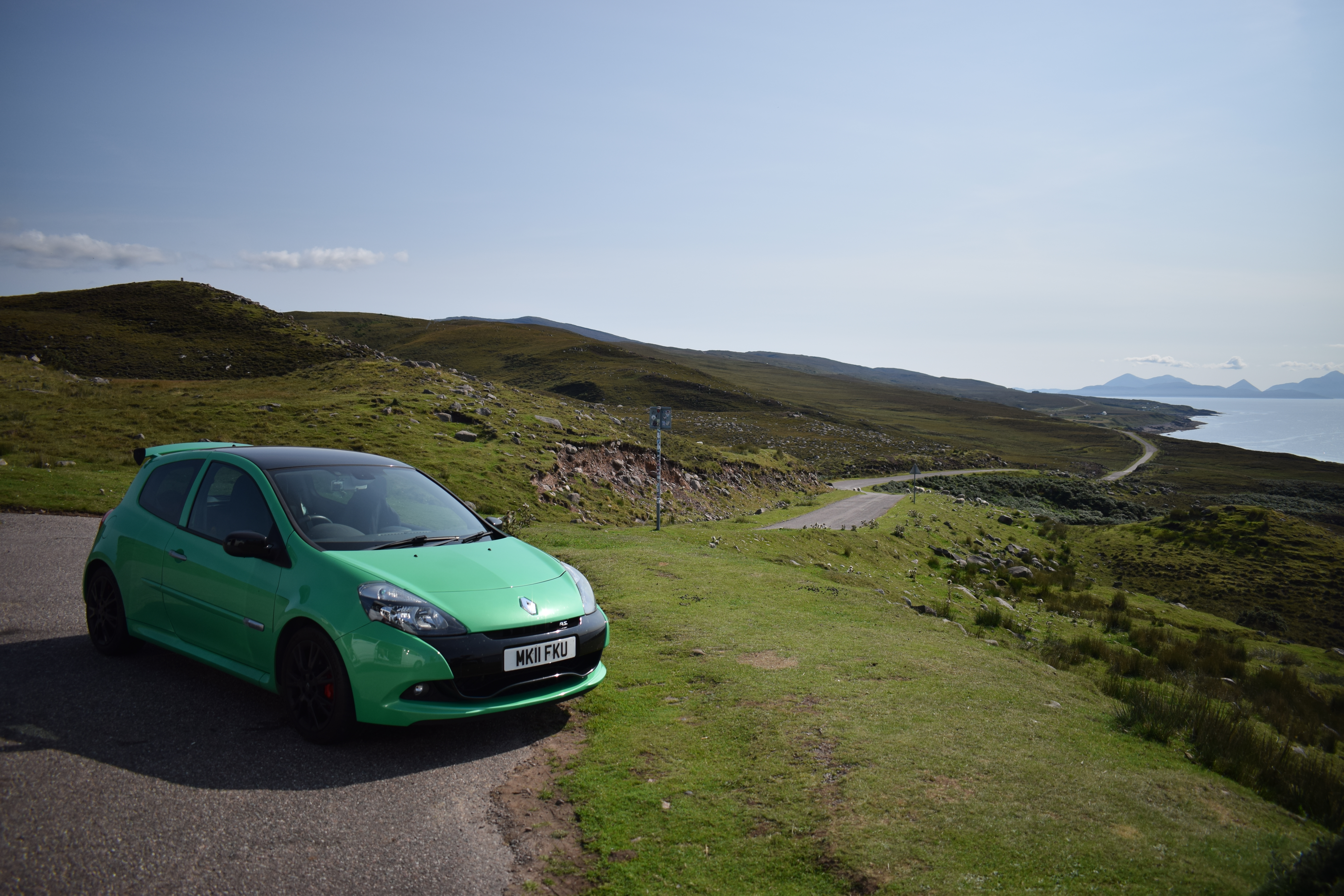

Hi all! I've been lazy for far too long so I thought this would be as good a time as any to say hello!
This car might be familiar to some of you, I know that it's changed hands several times on the forum in recent years. Introducing my new to me Alien Green Clio 200:
Bought the car in August after years of keeping an eye on the classifieds and waiting for my wallet to agree with me (a big thanks to Innes for parting with it, new to the forum so not sure if I can tag him). Since then it has been:
  • around a good chunk of Northwestern Scoland
  • on track at Knockhill
  • over the water to NI for a week or so
I'm still amazed at how clean the car is for the age and number of owners, I almost feel guilty for racking up close to 3k miles!

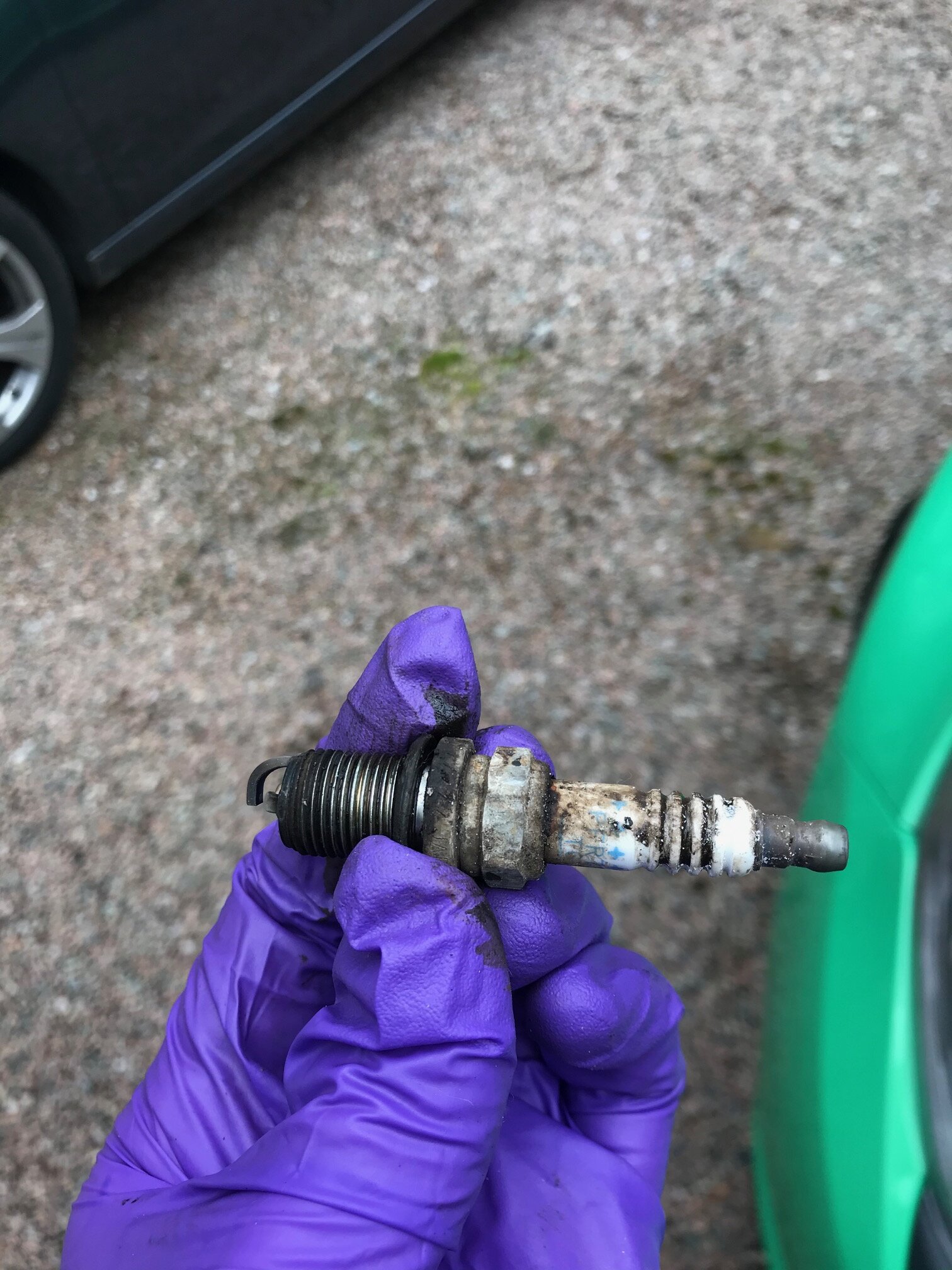

So far all I've done is fix a few little issues. A fairly severe intermittent power issue reared it's head at Knockhill. Thankfully it turned out to be nothing major, the windscreen washer hose had perished and washer fluid was pooling on top of one of the plug wells. A bad seal on the coil meant the spark plug was almost completely submerged in oily screenwash. New plug and washer pipe and all is well!
Bogging!

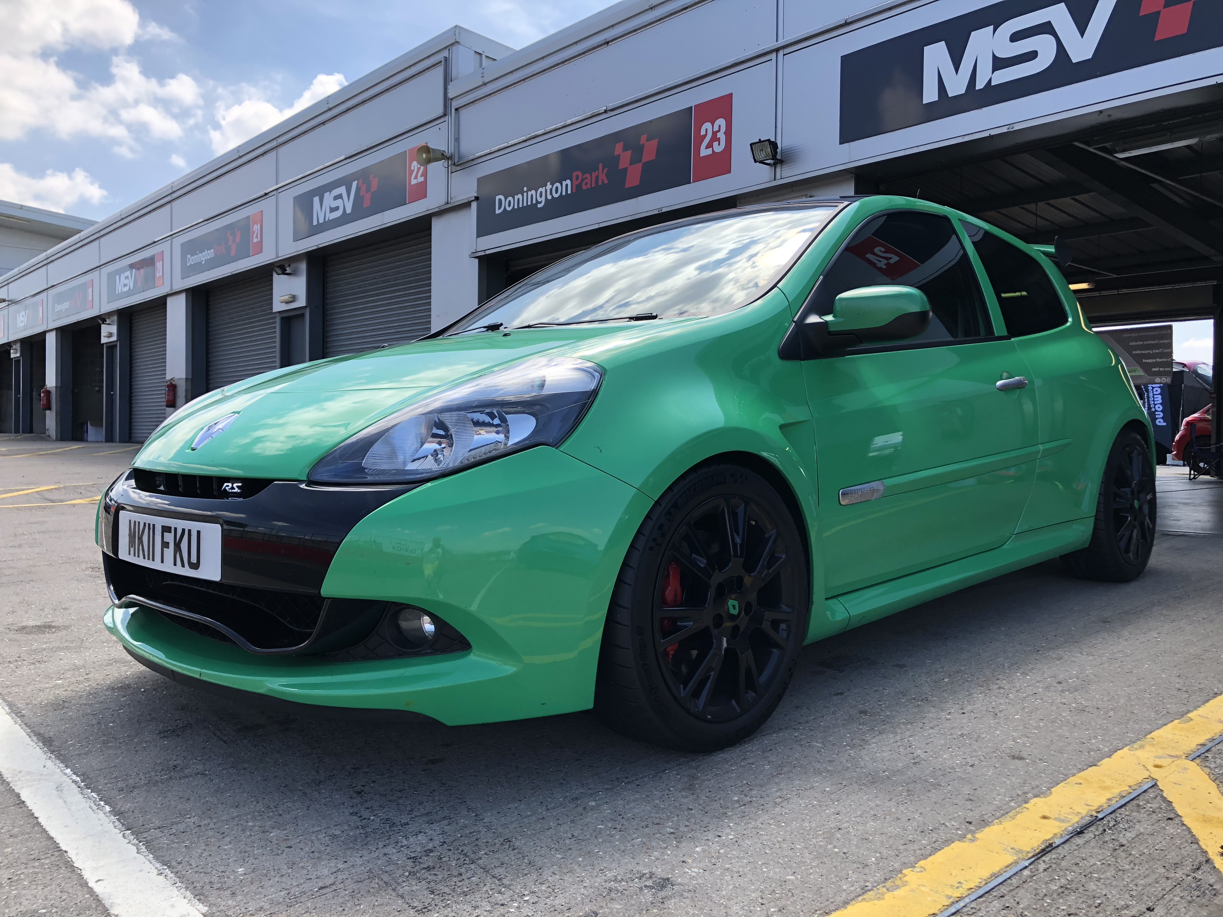

Here’s one of the pics that Mossy sent to me:

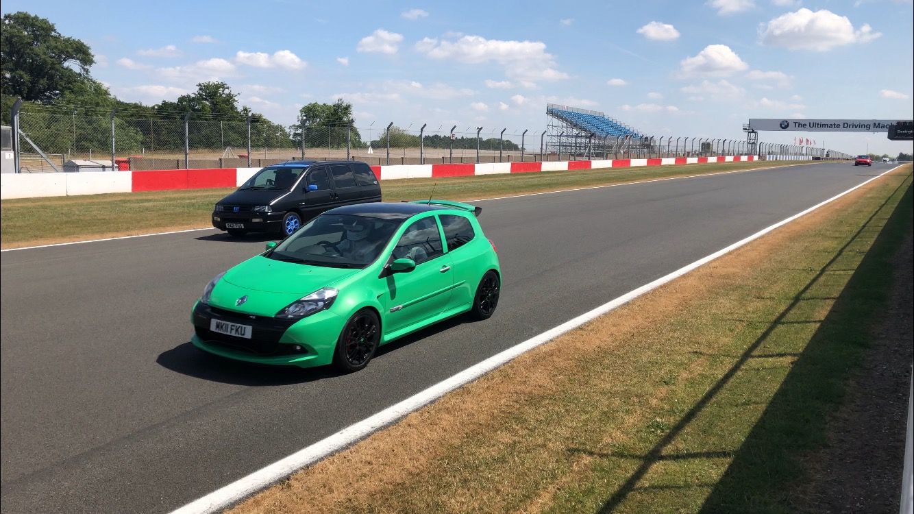

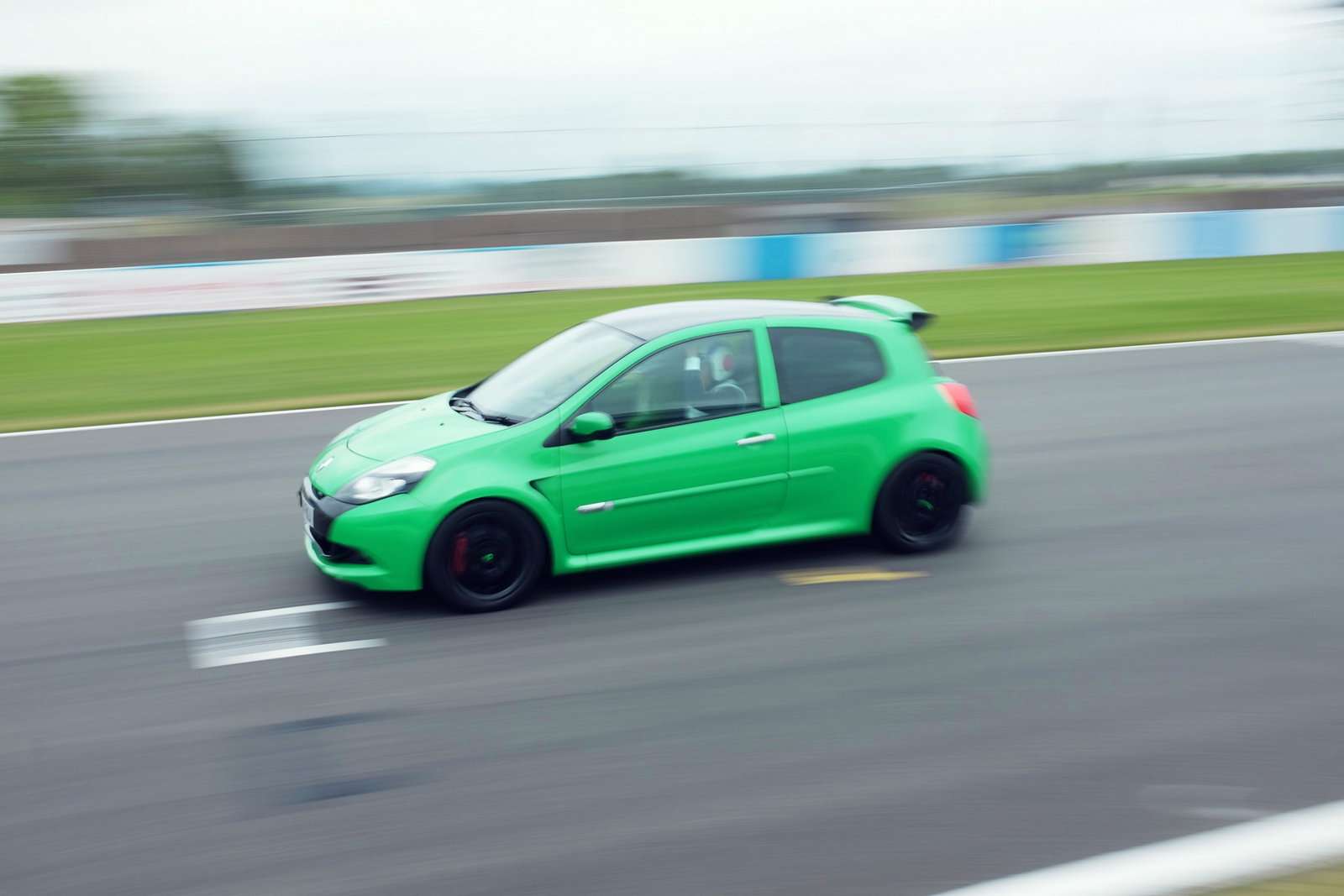

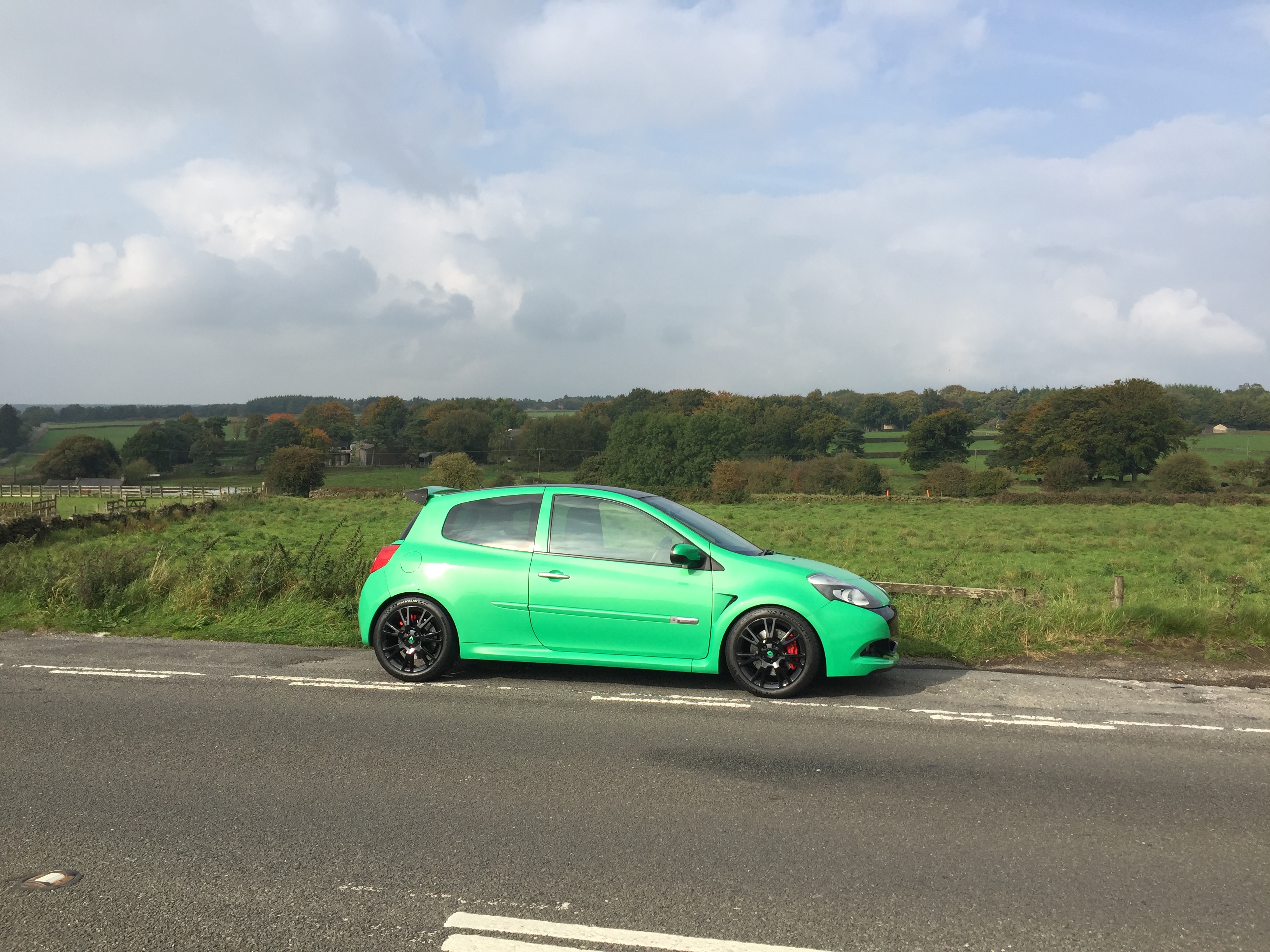

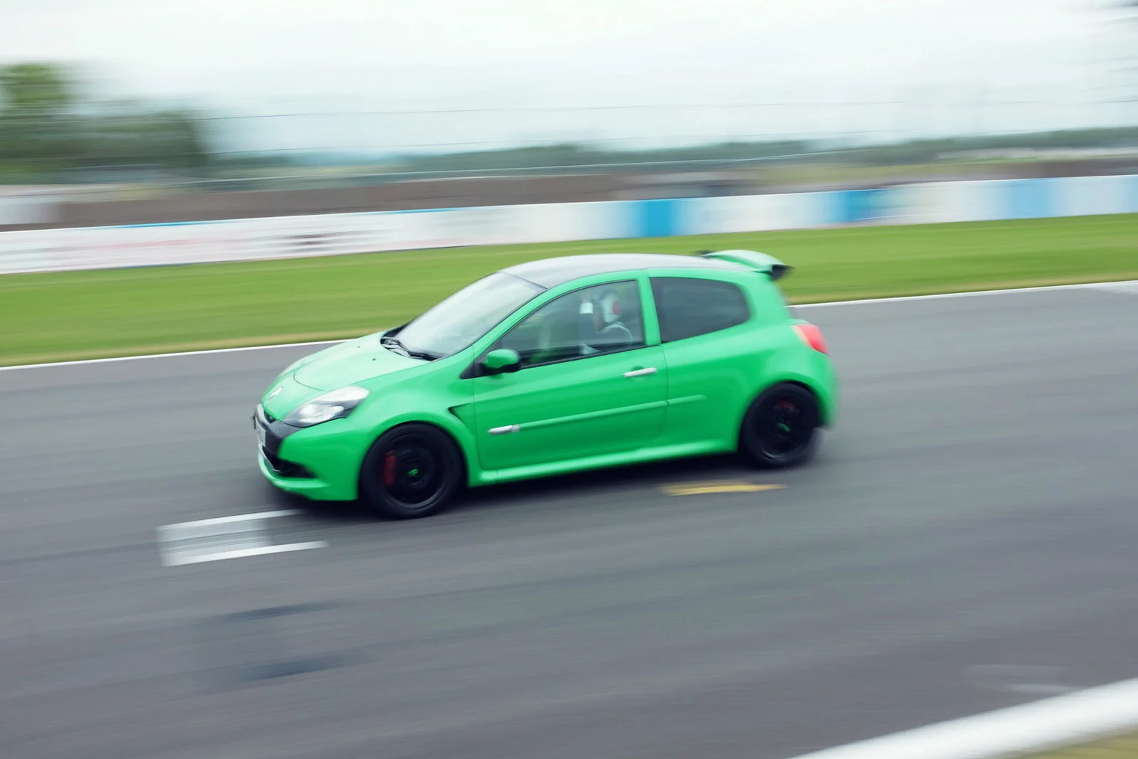

And here’s a few more of some scenic road trips and Donington Park whilst in my ownership:

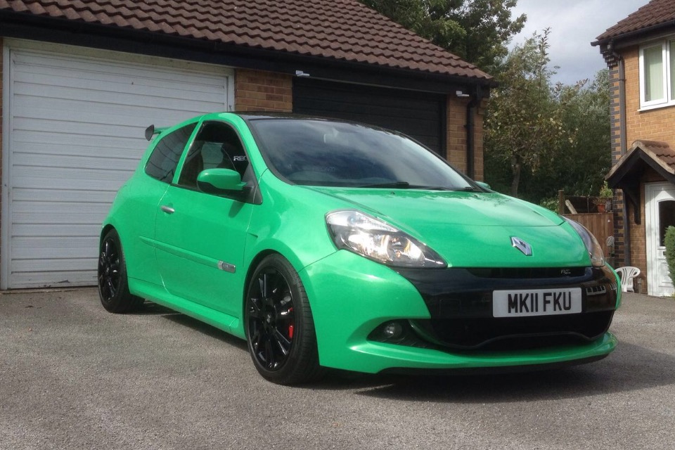

And the final shot of FKU as she set off for her new home in Scotland:
On the day at Donington it was absolutely flying - the only mk2 that came past me was fully stripped and running bodies lol! We had the a/c on too 🤣🤣

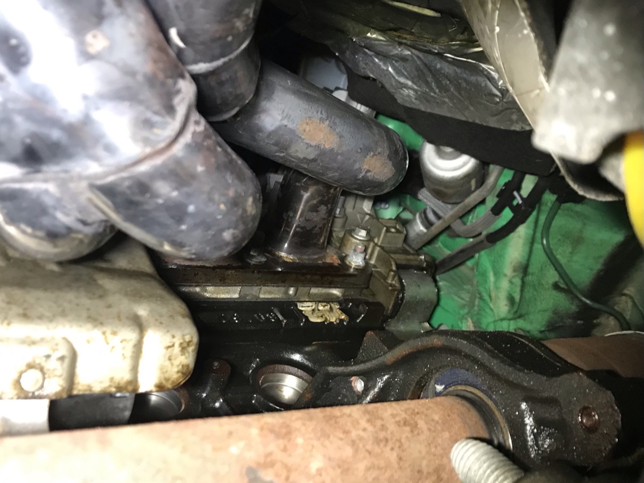

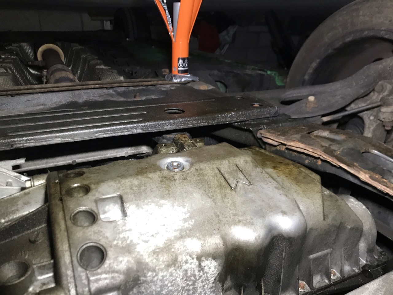

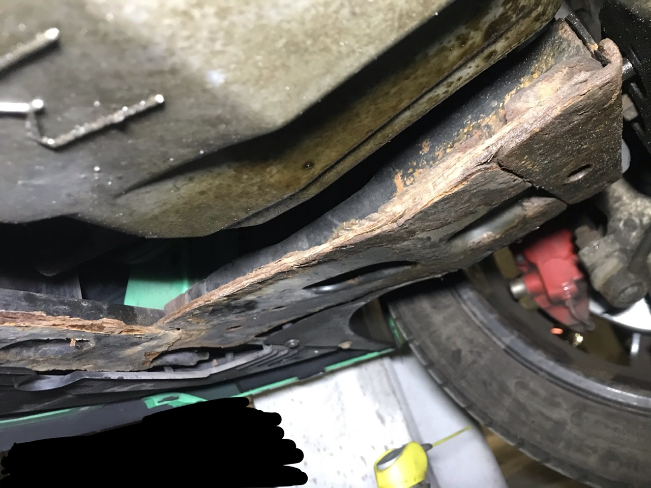

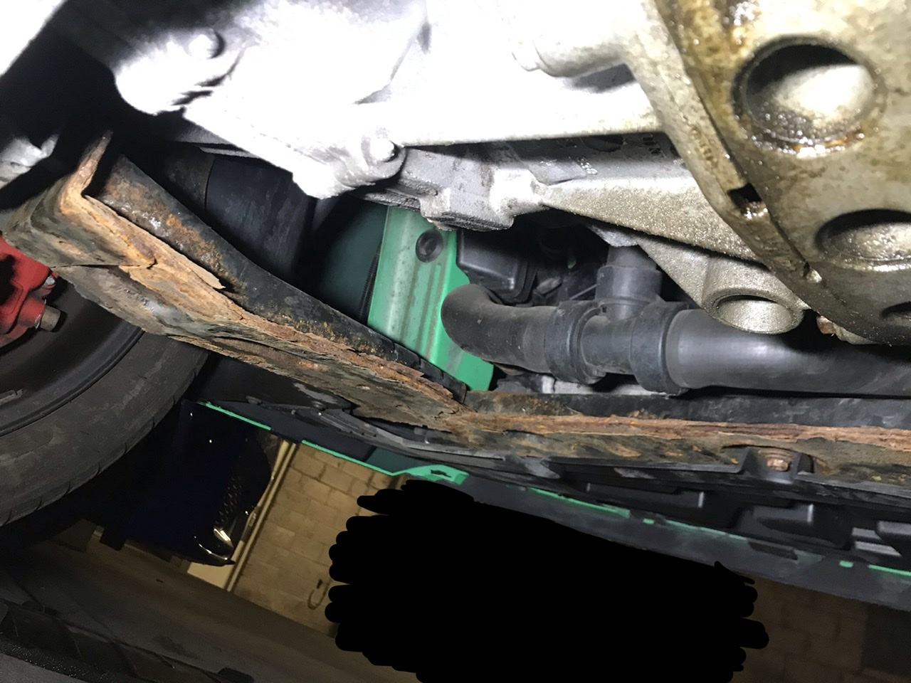

The first oil change and first time having a proper look under the car, and some little nasties have revealed themselves!
First off, the usual rusty front subframe/radiator support. No surprises there at all, but what have some of you done with this before? Is it worth jumping though the warrantee hoops or am I better just taking this one off and getting it blasted and powder coated?
Next, and definitely more concerning, a nice oil leak from the back of the engine. I can’t quite see exactly where it’s coming from but I’ll book it in with the local garage and see what the word is. Hopefully nothing too expensive 🤢

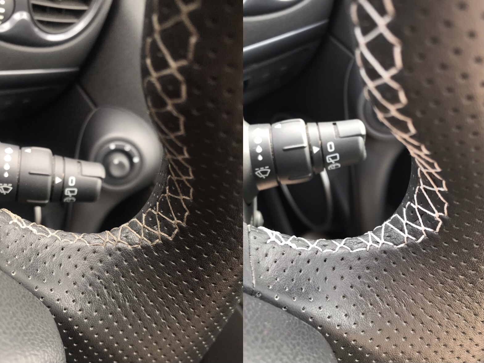

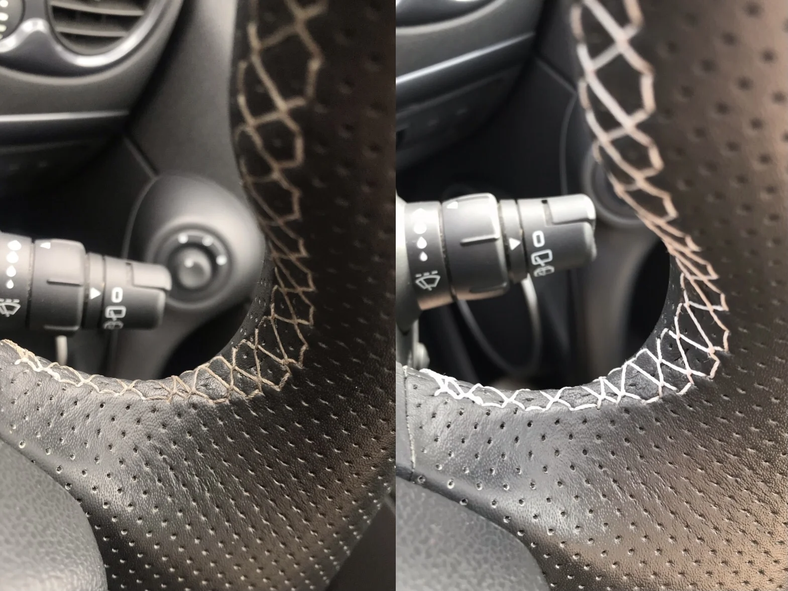

It’s been a hot minute since I was last on here! I decided to give the steering wheel stitching some well needed love. After some boredom and a toothbrush I’m amazed at how well it’s all cleaned up!
I’d very much recommend if you have some spare time. All that was used was water with washing up liquid and a small pinch of washing powder.
As for the oil leak from the previous post... it was not the cheap option :sick:

what was the outcome?
NorthloopCup
Whoever had done the belt before had used the wrong part for one of the cam seals, so it had pushed itself too far in and was leaking oil. The end result was a full cambelt job with all the bells and whistles for peace of mind.

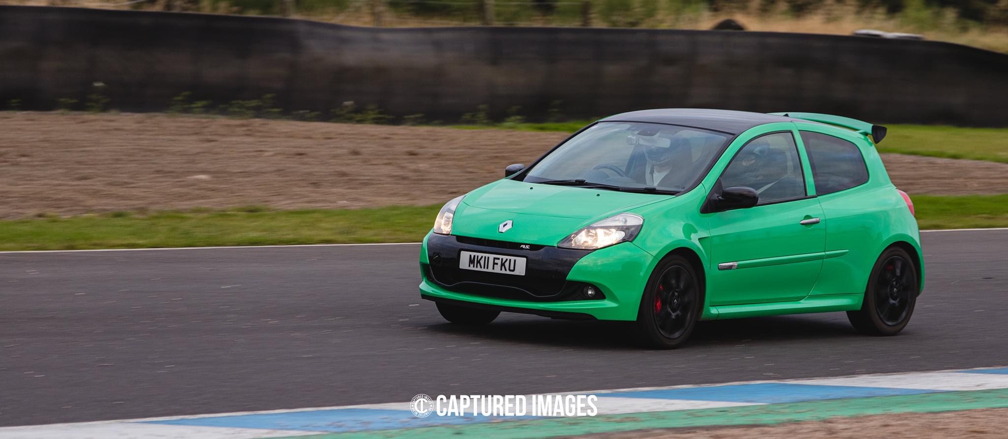

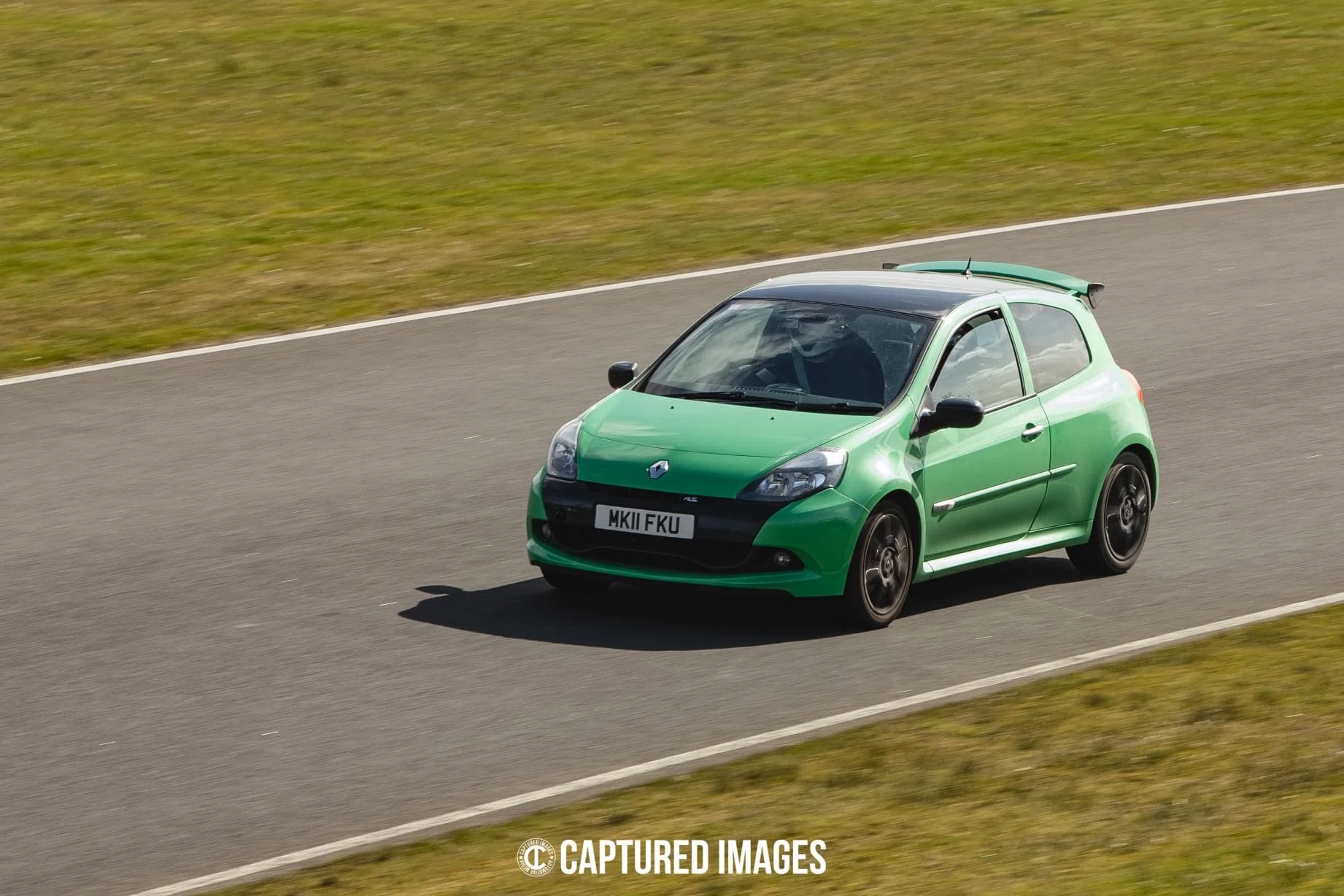

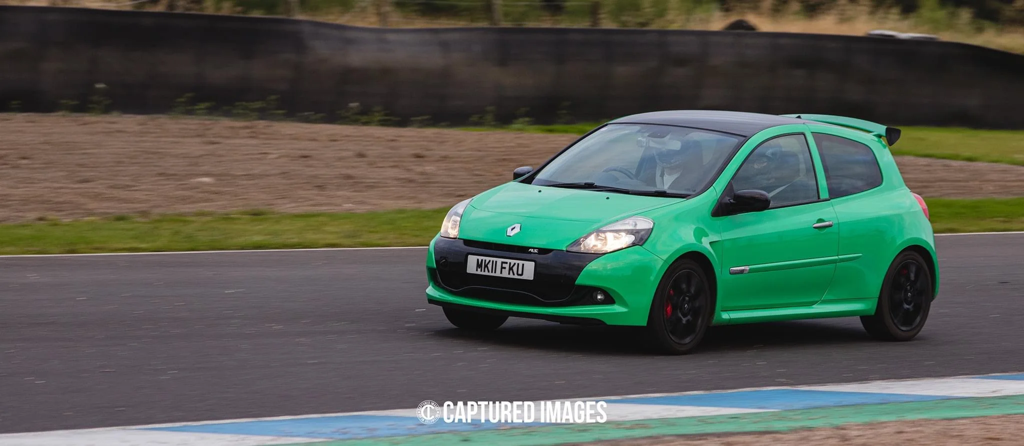

I’ve been meaning to get some glamour shots recently but haven’t got round to it, here it is at Knockhill a few weeks back though! Still going strong!
