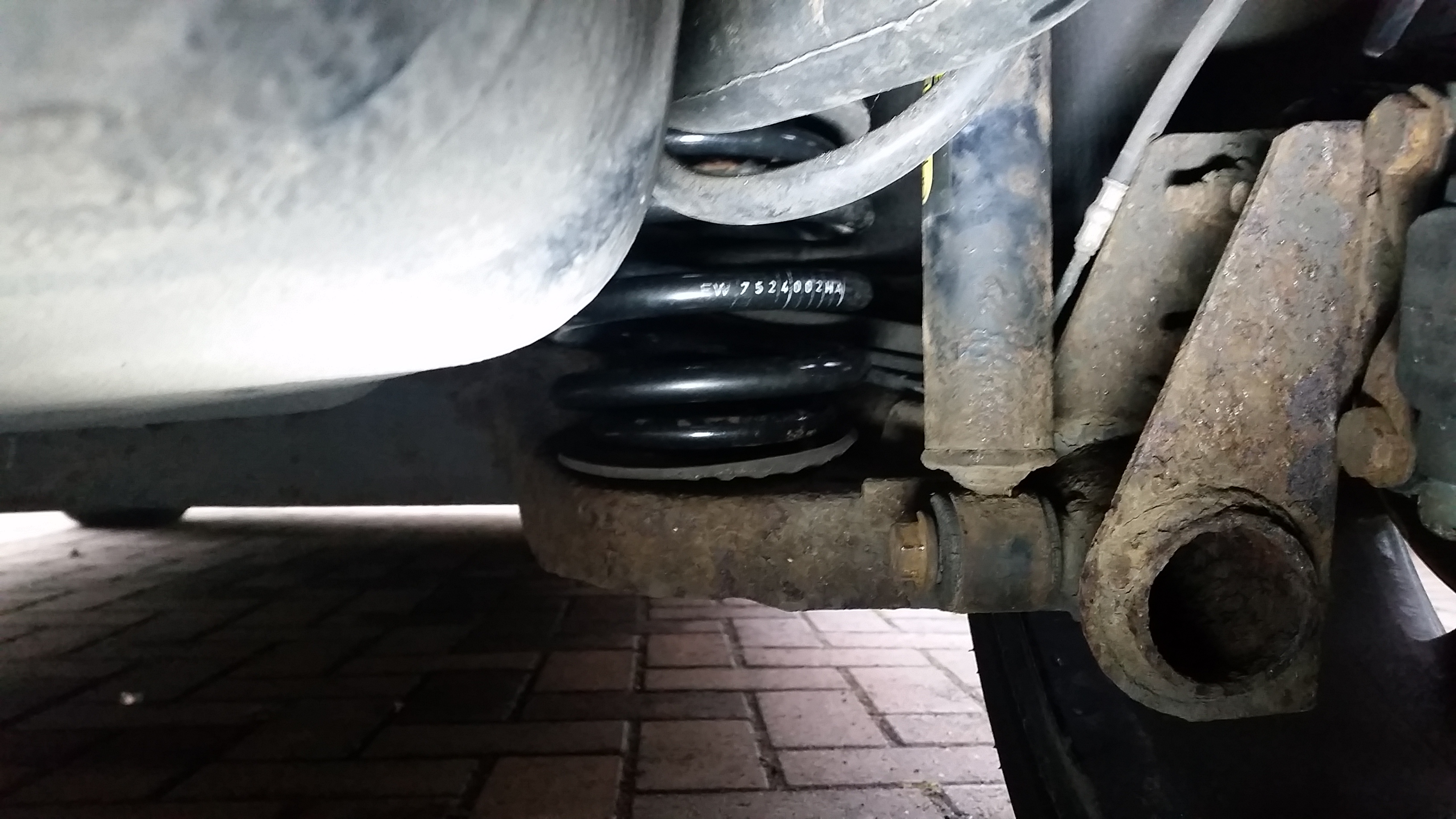

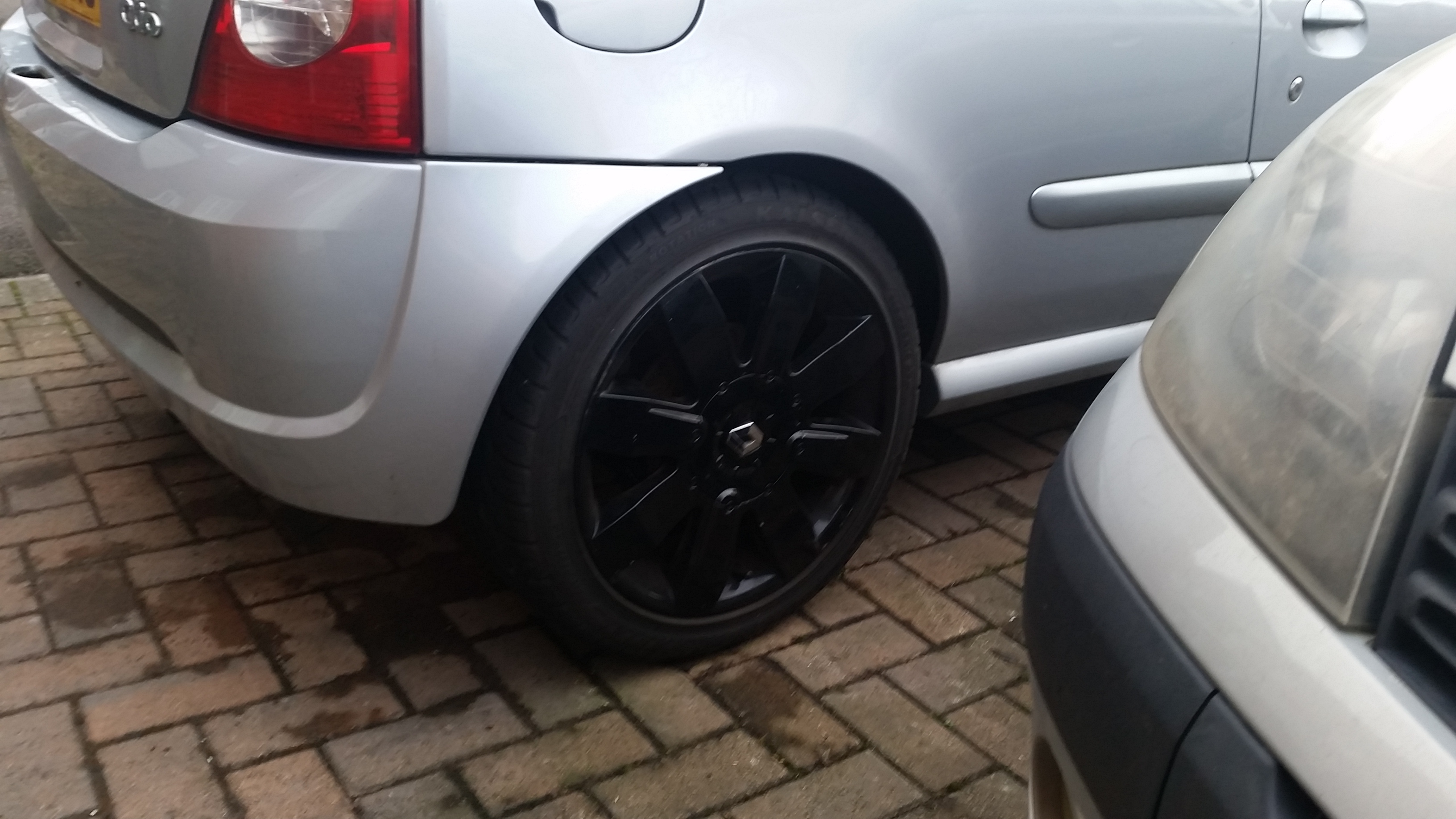

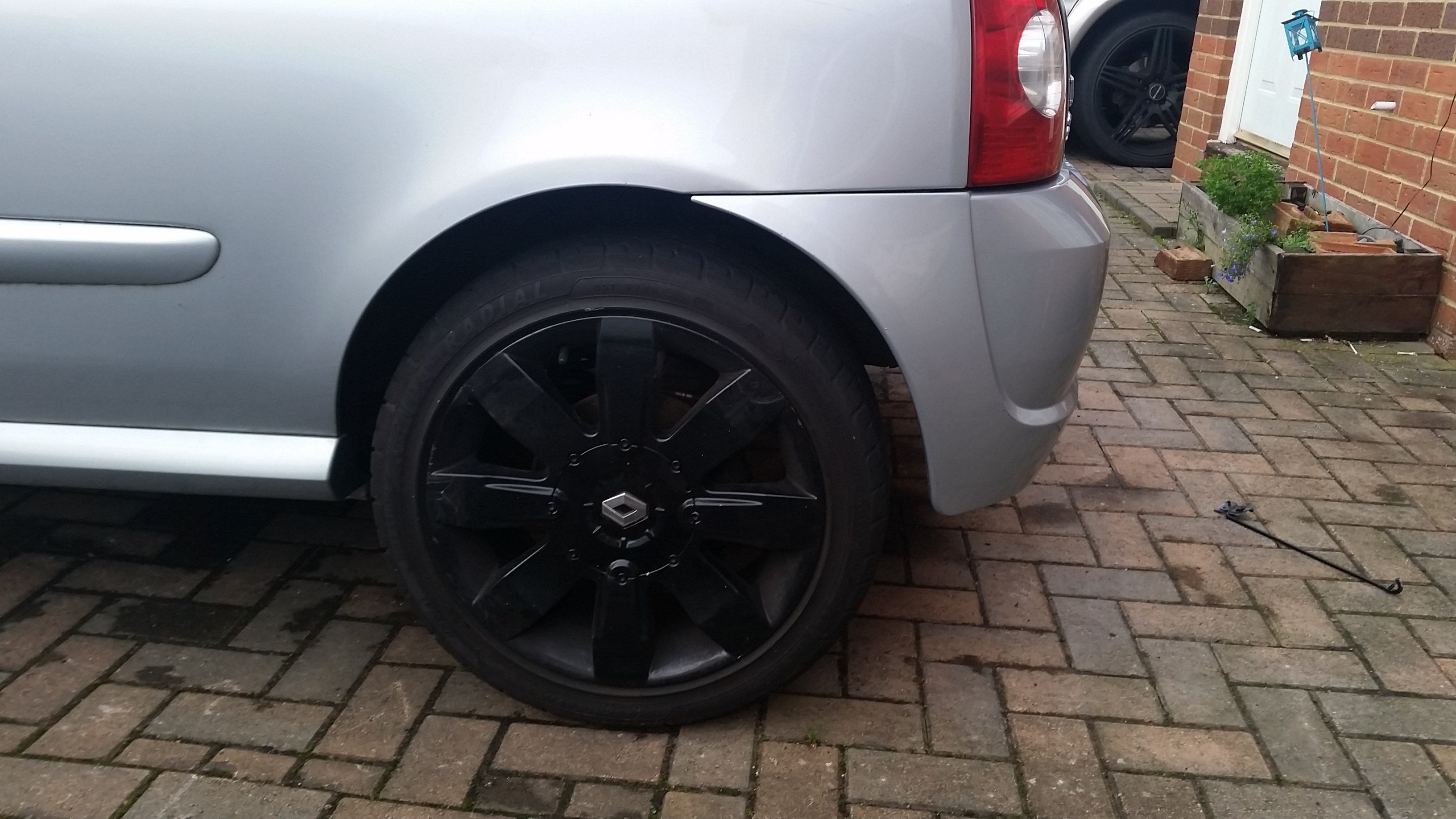

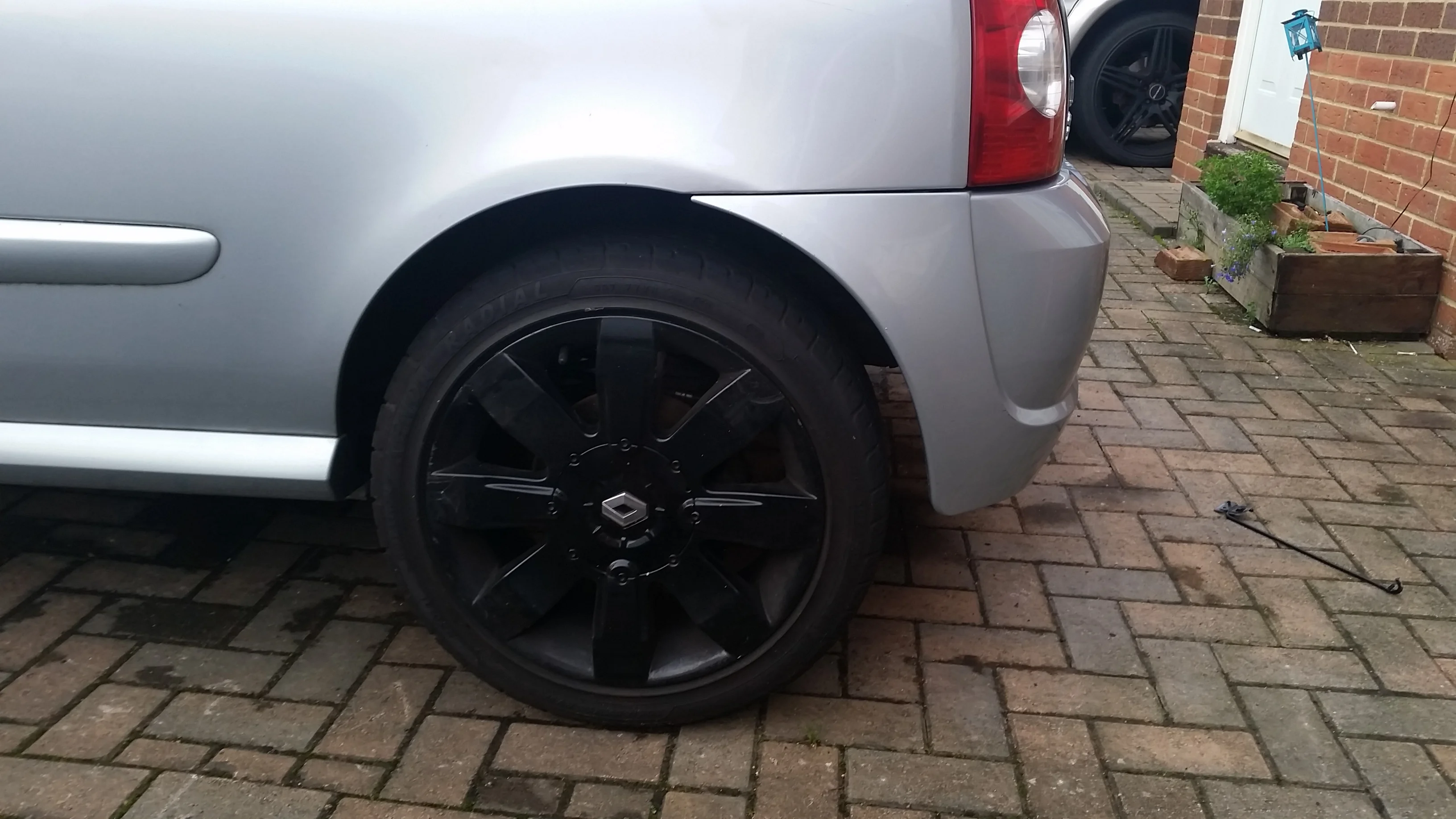

So early start this morning, and some photos of the difference
Passenger side
Please excuse the damp shock, I might have damaged the piston when swapping them over

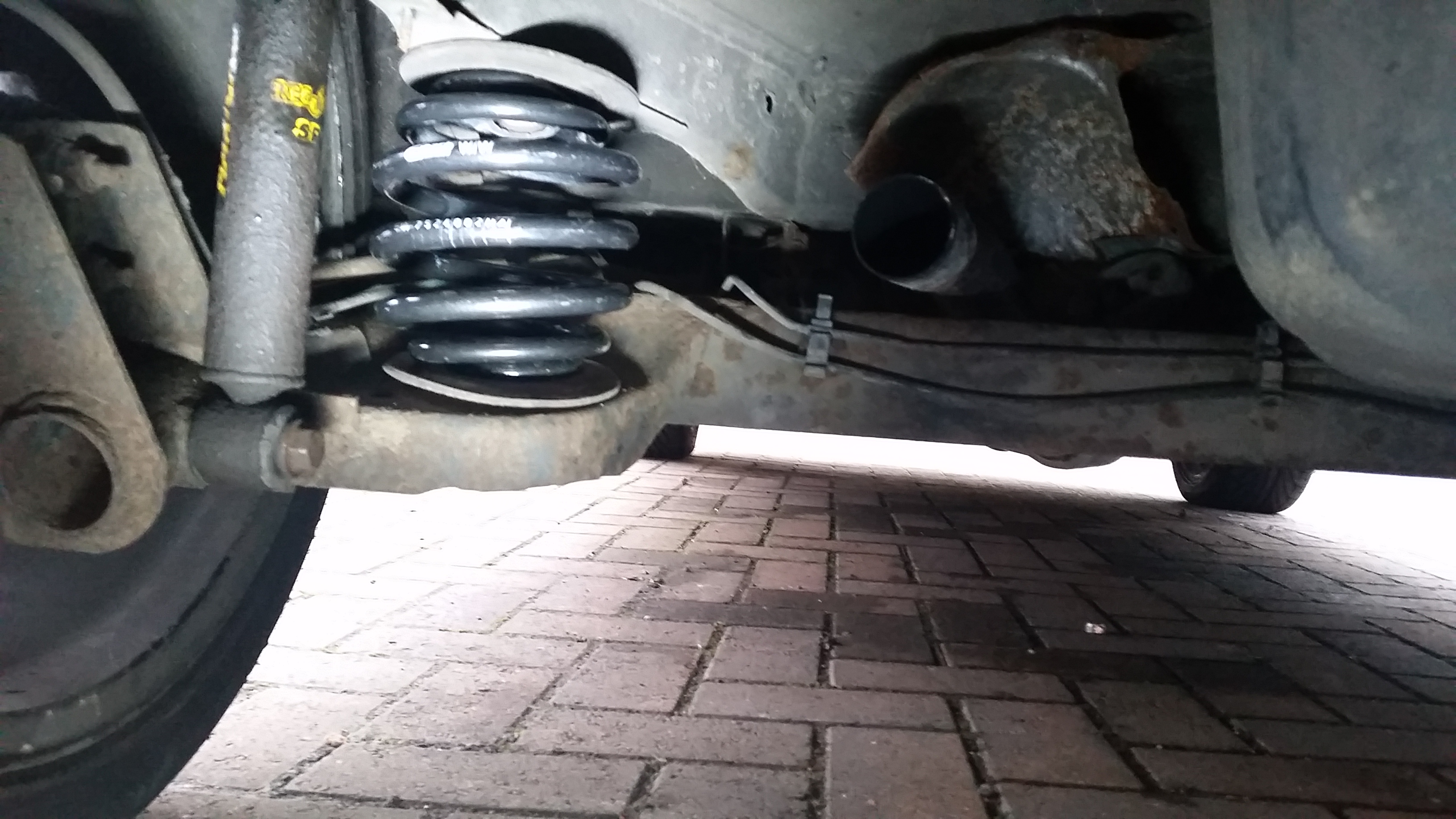

Drivers side
Comparatively speaking there is a lot more movement in the roll bar on the drivers side compared to passenger, and by looking at the springs in the photos the drivers side is compressed more than the passenger
I'm starting to think it's probably best to just get another axle and swap them over, see what happens
  Clio 172 Merc ML55
That's on eibach proline too, new axle coming up, I was trying to work out if the passenger side was high or the drivers low
