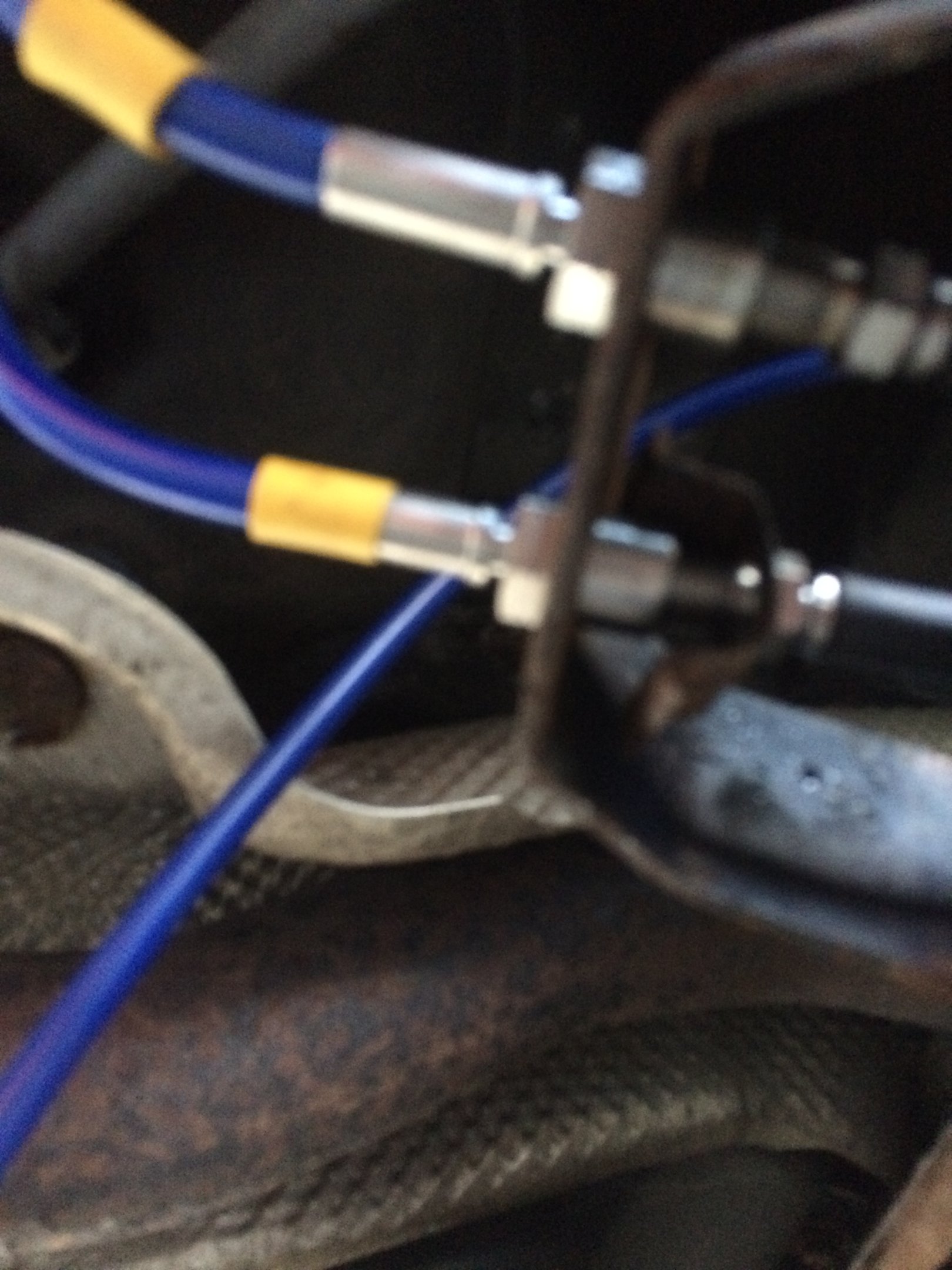

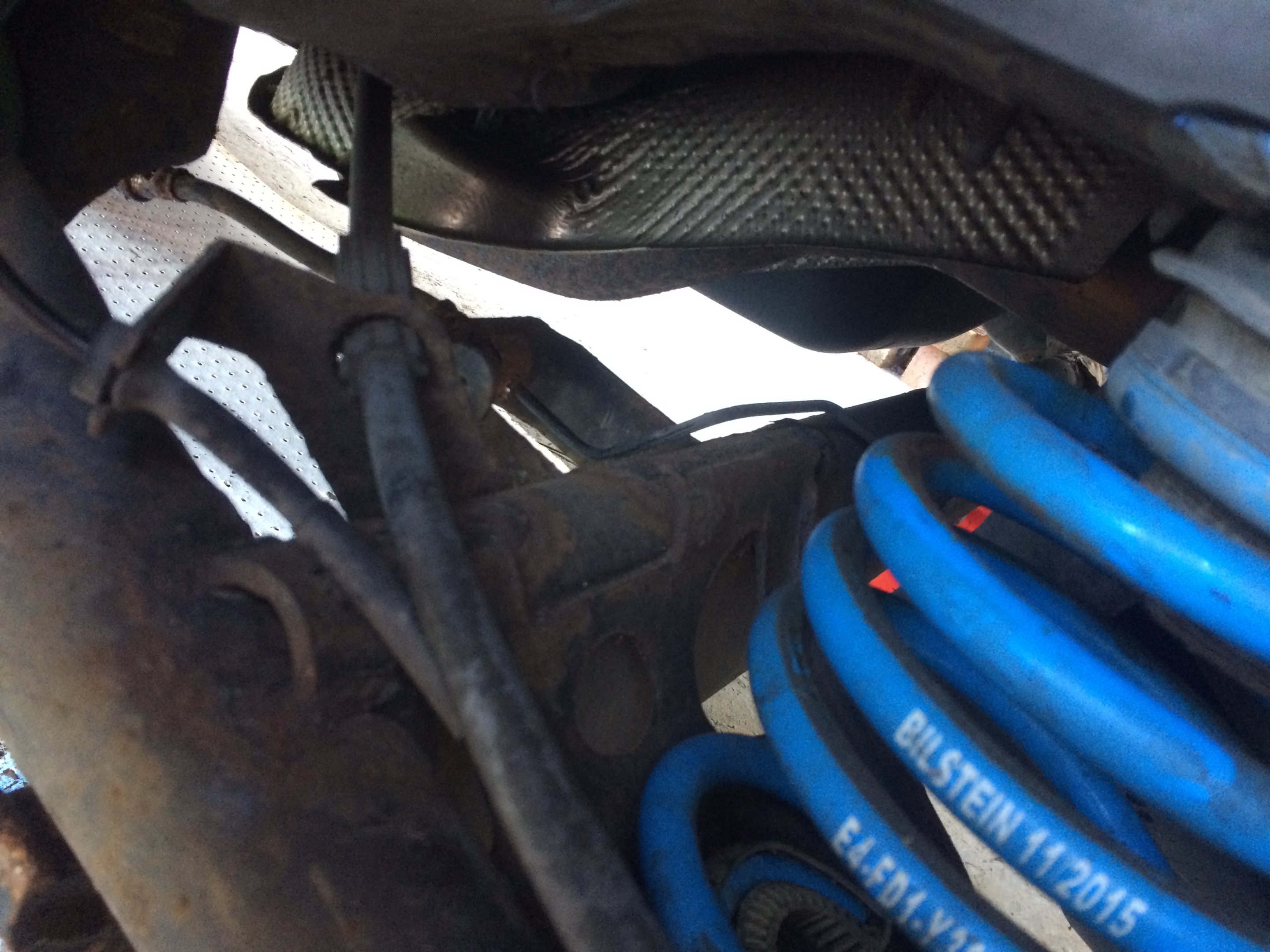

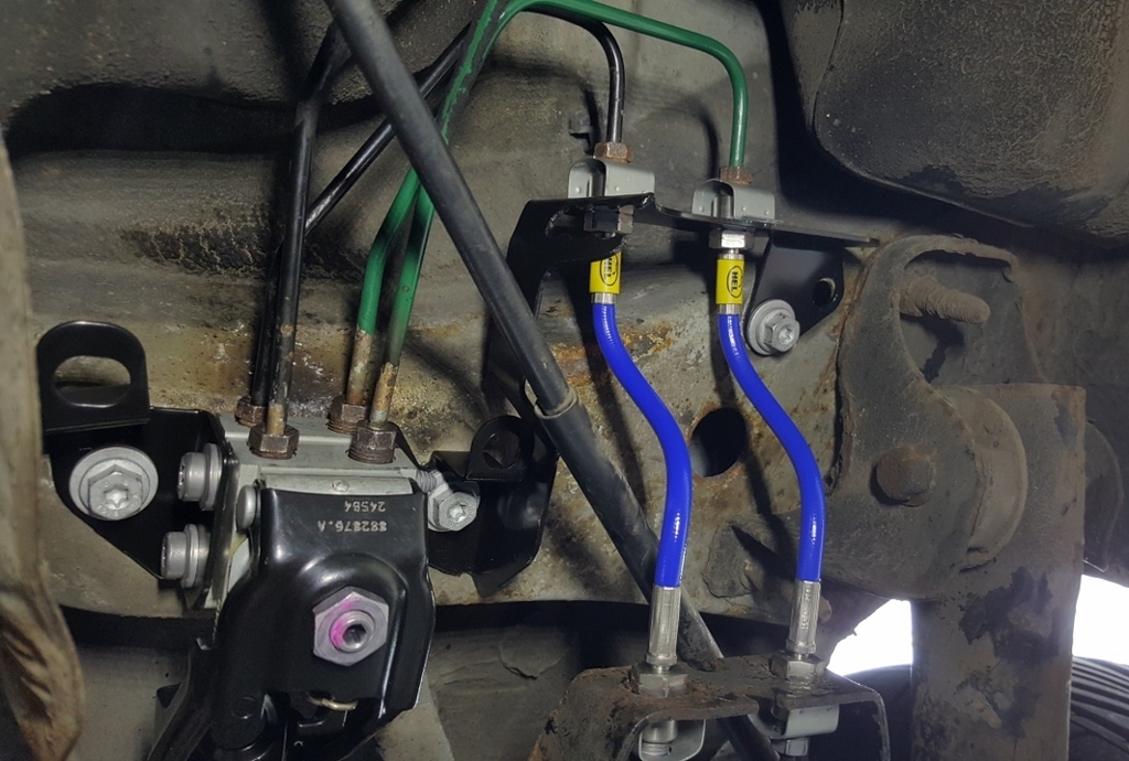

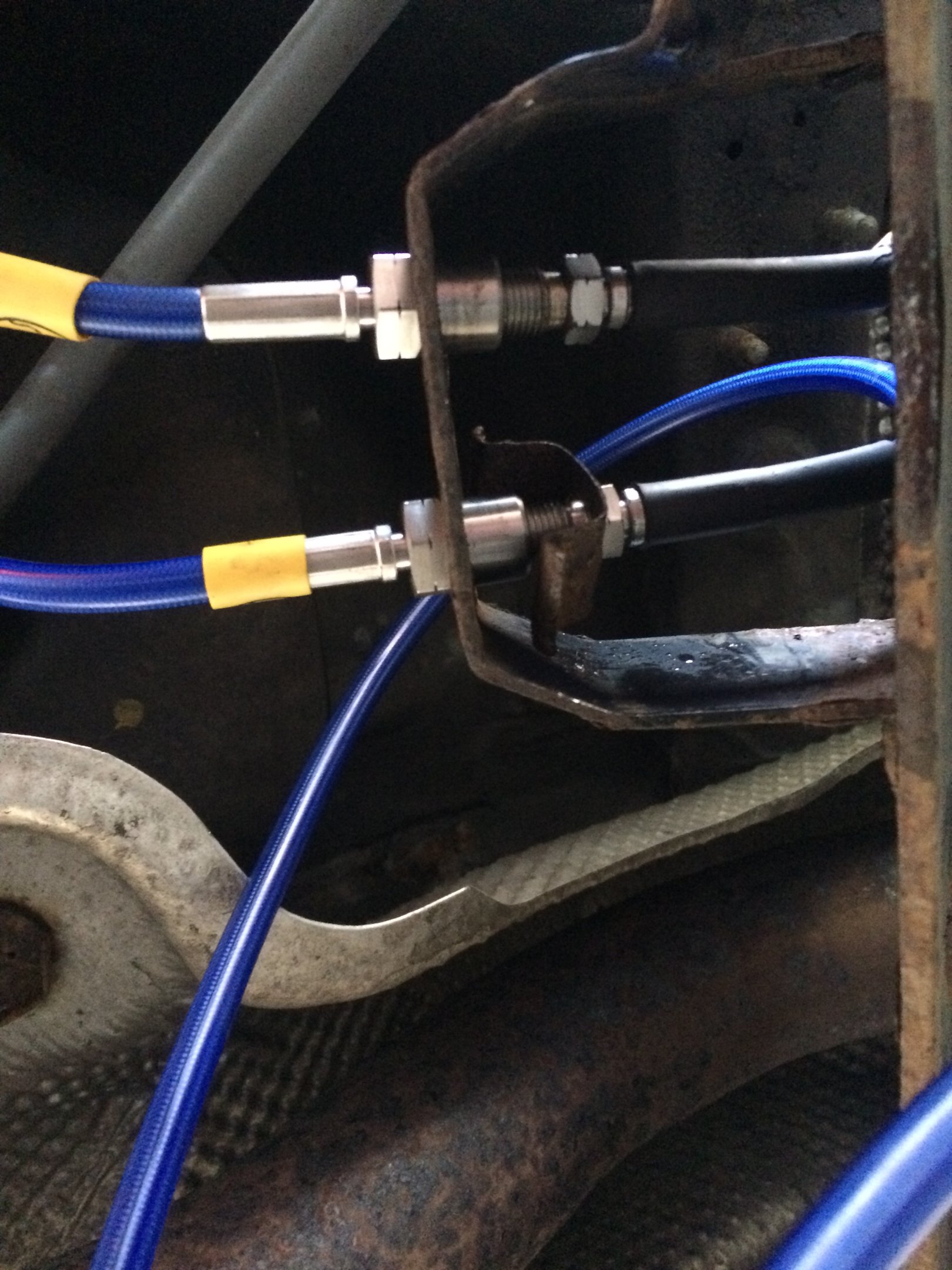

Hi I am have problems with my brake lines fitting hel braided brake lines and they seem like wrong ones contacted hel says they are right but the mail union seems too big because it won’t keep bracket tight so lines are moving about also they are resting on the rear subframe see pics can someone please help

Looks like you need some new retaining clips, pictures look like you have missing ones too?
Touching the rear beam could be because they are loose or the hard lines themselves have been bent or pulled around.

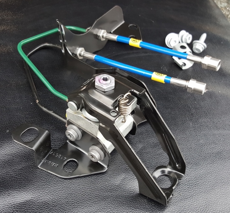

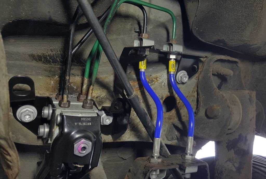

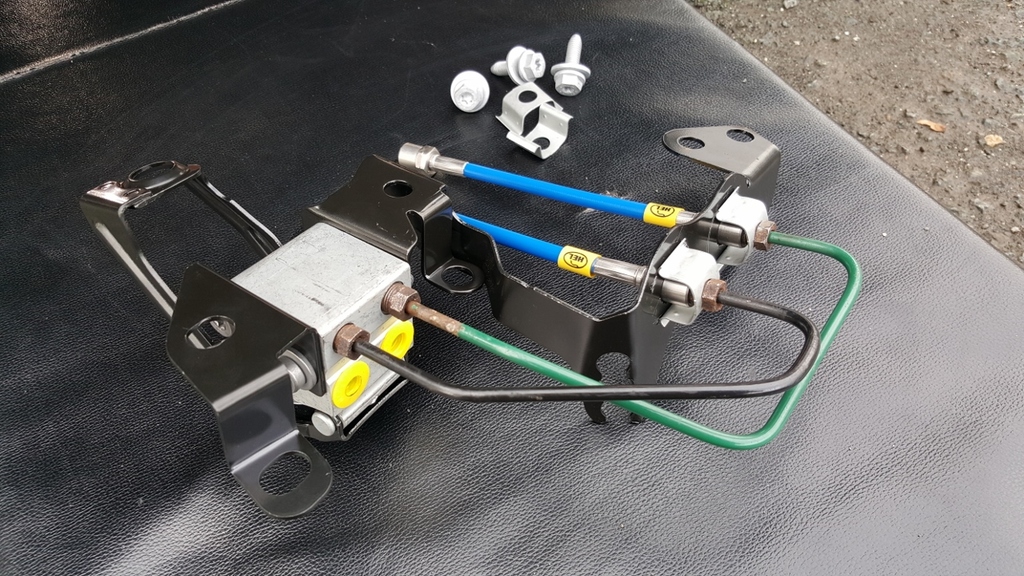

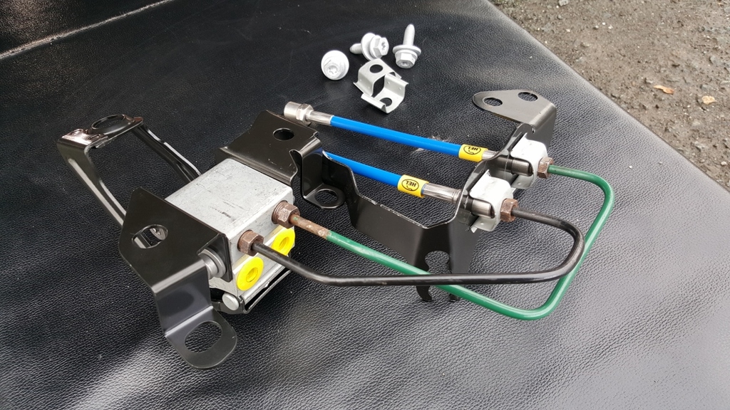

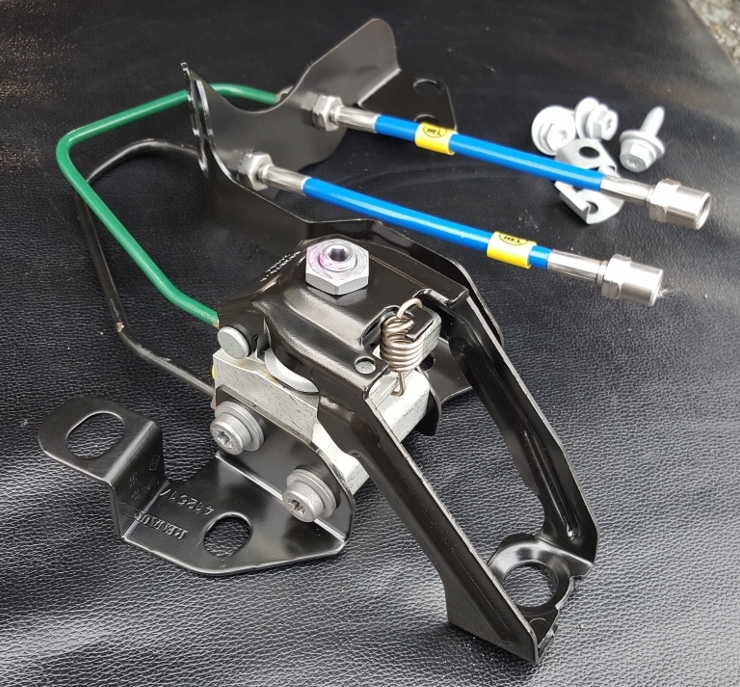

Here's some photos of when I did mine but I think I needed to bend the clips a little to tension them

Yeah clips not on the other one was jus thinking what I could do to move it forward from subframe even with new clips I doubt it would do anything set up on a 182 I’d different thanks for the reply
