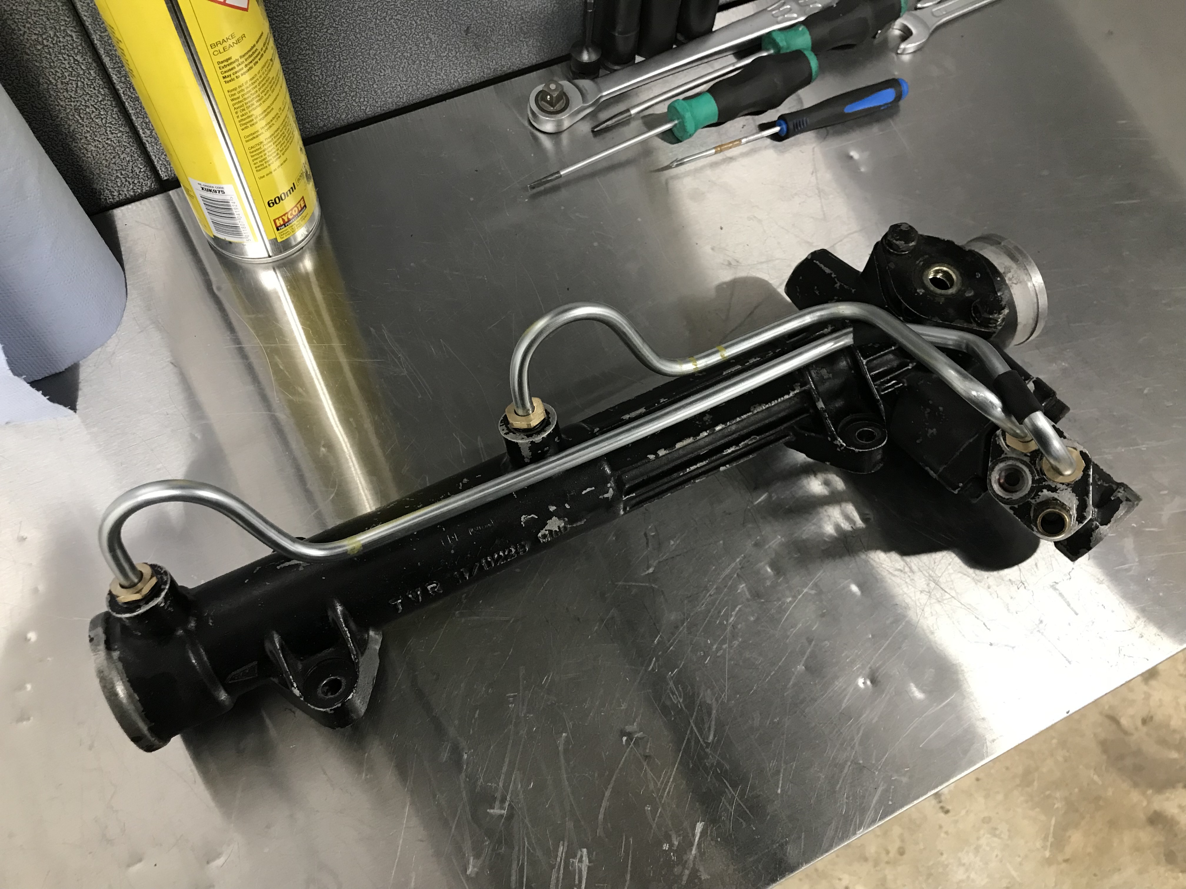

Beauvais Motorsport
Not really a problem with thinner softer line (copper or aluminium) but coated steel line and larger diameter steel line will not bend so easily using the cheap tools off eBay as they can slip and the line will kink.
Had that happen for this job which was already a nightmare.
Also that type of handheld flare tool posted above I have found is the best for single din flares, as it contains the flare better than vice flare tool dies, which seem to not have as much of a lip in the die. So before anyone thinks they might as well buy a full turret set or the likes and be disappointed.
Robbie Corbett
Lovely job that, kept meaning to ask if you made those lines as they look brilliant.
