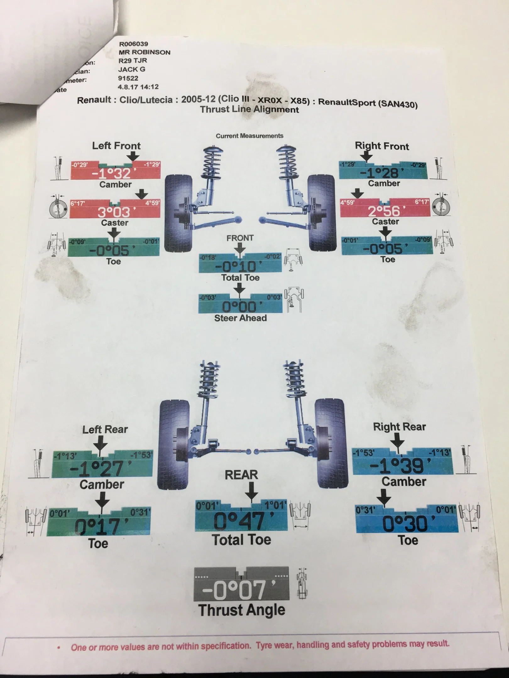

Good Afternoon All,
I'm planning on a few jobs over the winter and one of them was rear shims. At Cadwell it was noticeable that the rear inside of both tyres was minimal which leads me on to my next question. Should I fit shims and if so how much Camber?
This is my current set up:
Initially I was thinking of going for 1 degree but there is no basis behind my thinking!
Any help/suggestions/thoughts would be appreciated.
Tom
