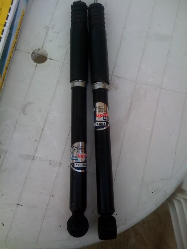

I got some new dampers from Icarus, who sent them very quickly and they are all good (thanks for that), however when i went to change them over the rubber bungs and the wee metal pipe are 17mm wide, where are the new shocks need 19mm wide bits.

bonus random pic of what i need :
Post the pic of your current ones as well as they are nothing like mine!
The ones that came off were 19mm, the bilsteins that went on were 19mm - hence I'm confused.

ben, have you seen them like that before? and no not KONI, LIP Gas-Tech
Renault say they can only be gotten with the shocks, but Icarus(who i obviously believe) said he got a pack the other day.

It appears the ones that are on the Clio Cup (which what seems the orginal shocks) are 17mm (i.e the coller and the mounts).. However the new shocks (pic above) are 19mm, so the collor and the bungs will not work..
I guess (and what Icarus says) that 19mm is the standard for the metal bit (the plunger).

what you saying that buying new from renault will NOT get me 19mm wide ones, but 17mm? and ben do the mountings you have had look like the pic?

The renault (road) ones have a 16mm bolt on top, koni use the wider rubbers, sleves and bolts as do the likes of bilstien iirc

That is a Renault road car mount, same as on mine etc
right the more i keep saying 17mm and 19mm (what the guy in the garge told me) that just seems too big.
Im sure where the color fits it more like 9mm (the other is 7mm) and the nut is 10mm.
So ben.
can you explain, are those correct for the 172 Cup, and the shocks I have need different mounts? if i went and brought genuine cup shocks (even thought they come with the kit) would they fit in those 7mm holes.

Ahhh.. right i mean a Clio 172 Cup - Road car, not a race spec 'Clio Cup Racer' car.
Hence the insert (the tube) will NOT go over the threaded section.
I think we know the problem now.. :)
