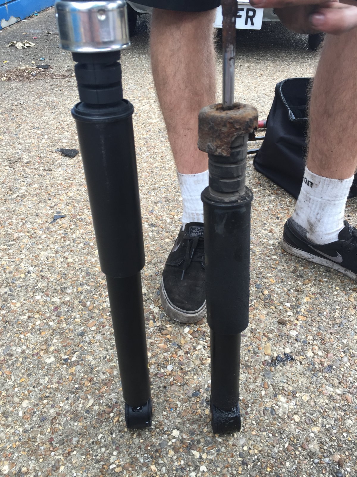

Got the dampers changed over today with great help form my pal alfie, was quite straight forward took an hour to do both. The old ones were not in a good state picture below. The new genuine cup dampers look good quality and were a straight fit.
