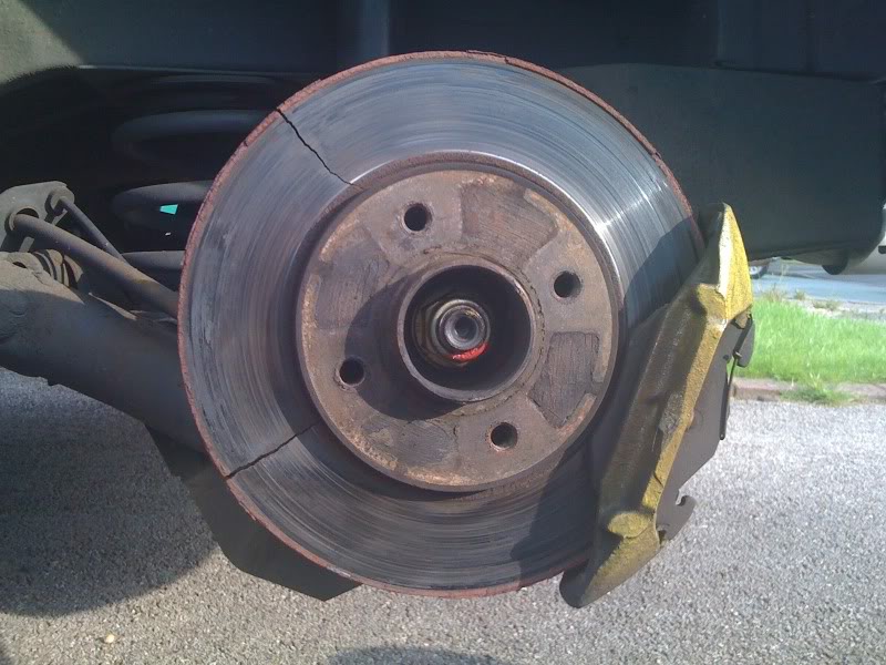

How much should I be looking to pay to get the rear discs, pads and calipers changed on a 182? I've just been quoted nearly £600 including labour and vat but this sounds way too pricey!
Is there anywhere local to the West Midlands that could do this cheaper?
(Bear in mind that my 1 rear disc currently looks like this)

2 cracks, very nice.
The price of rears disks with bearings and ABS rings has come down alot recently, your quote shouldnt be anywhere near that even with new calipers surely.

Its hard to say without look but I doubt the calipers caused the cracks, the cracks are due to them being really worn and corroded. Renault have reduced the price of the discs to around £100. The pads are not too taking around £35 from memory. Its easy to fit yourself, theres a guide on here somewhere. Its very dangerous to drive it while its like that.

I'm definately not driving with it in that state!
Don't get ripped off by a main dealer or local garage. Take it to someone that knows about these cars and won't pull the wool over your eyes. Fred can't be far from you?

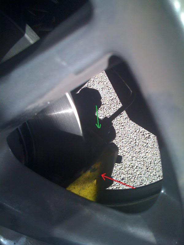

As they have just been changed on that same hub but now look like below (i.e. still yellow), have they been changed? Are they where the red or green arrows are pointing?

The green arrow is the caliper, the red arrow is the carrier which bolts to the caliper. Without a clearer picture it's impossible to say if they've been changed as they could have swapped the old carrier onto a new caliper (as I did).

Thanks, thats what they've done by the looks of things having checked against the other side.
