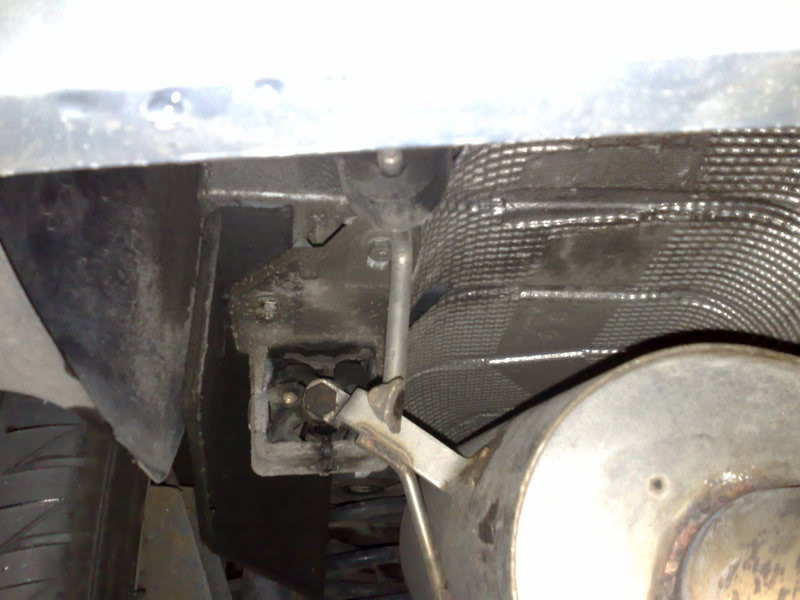

I'd get a new mount if I were you - Although Prospeed will beef up the mount with some random bits of rubber. Excuse the pic - My ProSpeed was not one of their best. lol. You can see the extra mount they fitted. With the hanger hanging straight down because the metal snapped around the weld due to poor design causing vibration.
That's the same as mine but without the extra mount and the peice of bar welded to the flat mount on the back box. Such a crap design it's unreal! Yours looks "better" though.....
