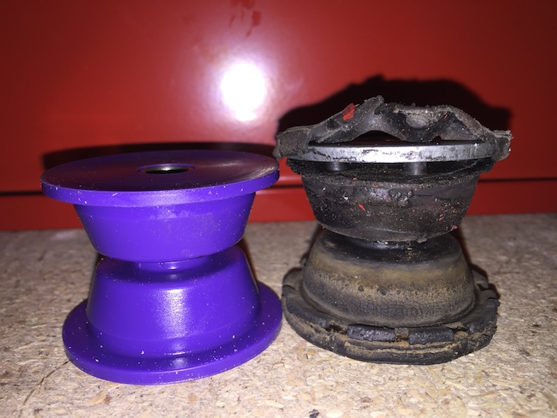

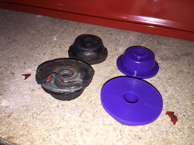

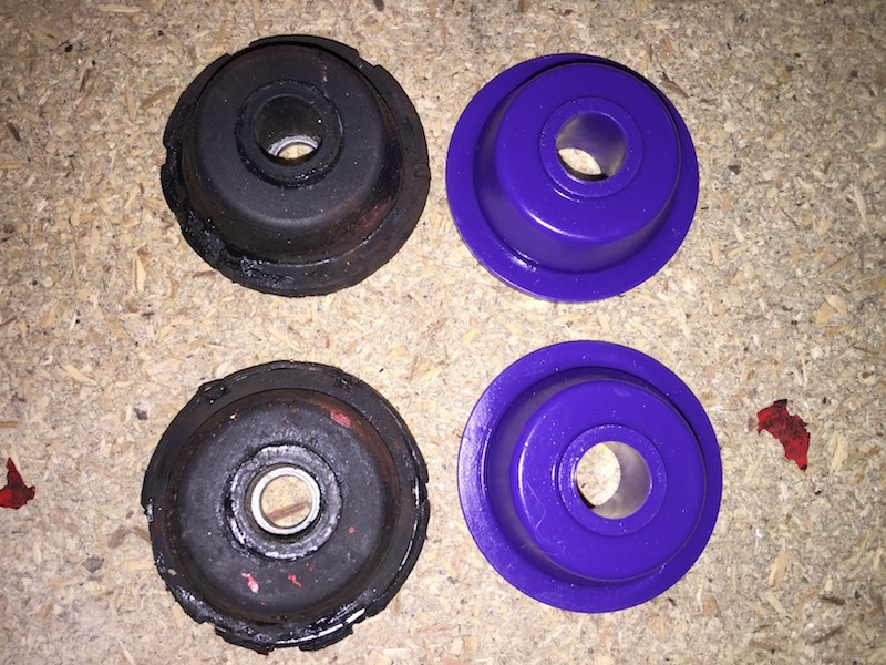

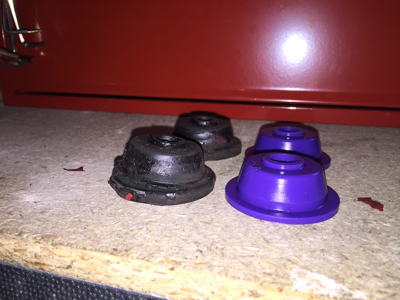

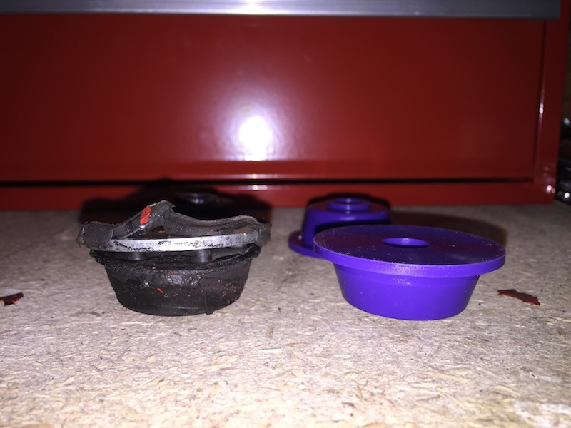

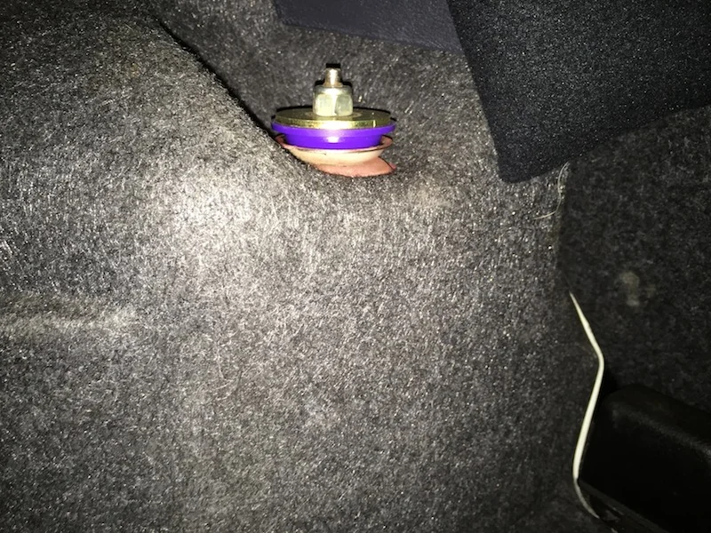

Well as i have every polybush for the RS 1*2 i thought i would sort out the easy ones.
Or what i thought was the easy ones.
Kept telling myself its 2 nuts and 2 bolts but yet the all got the better of me.

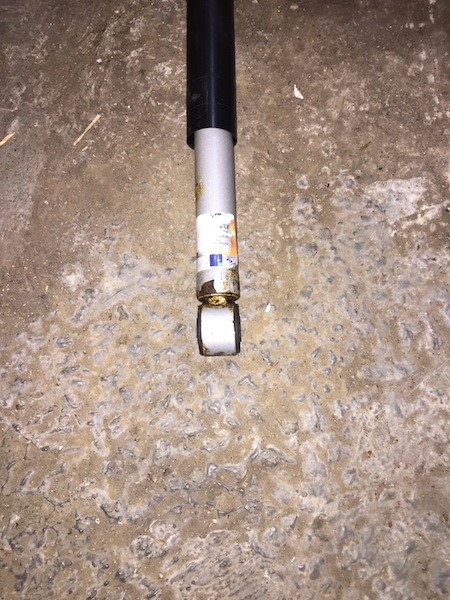

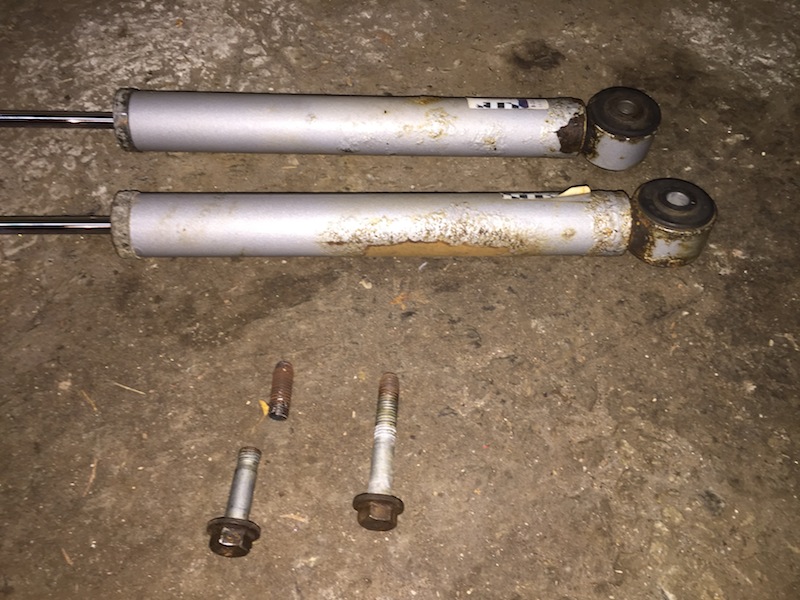

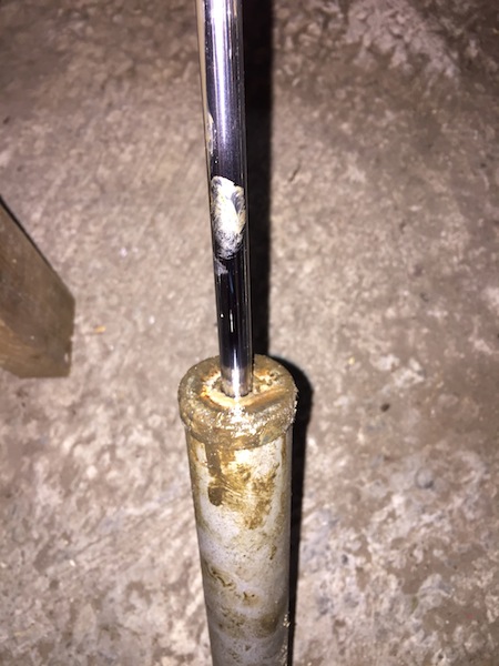

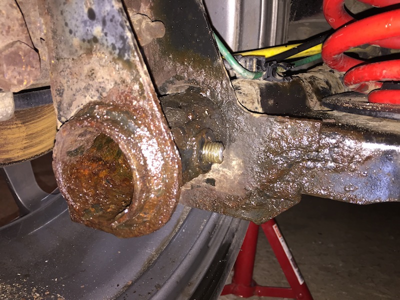

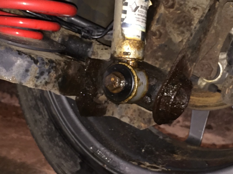

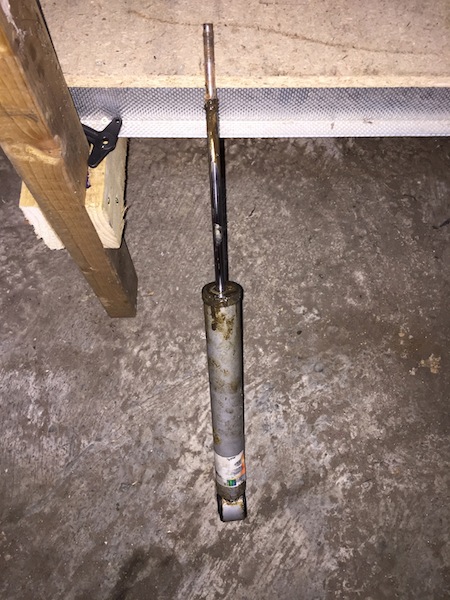

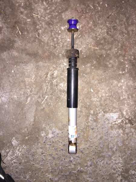

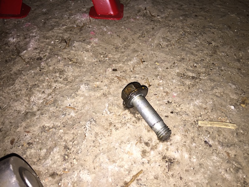

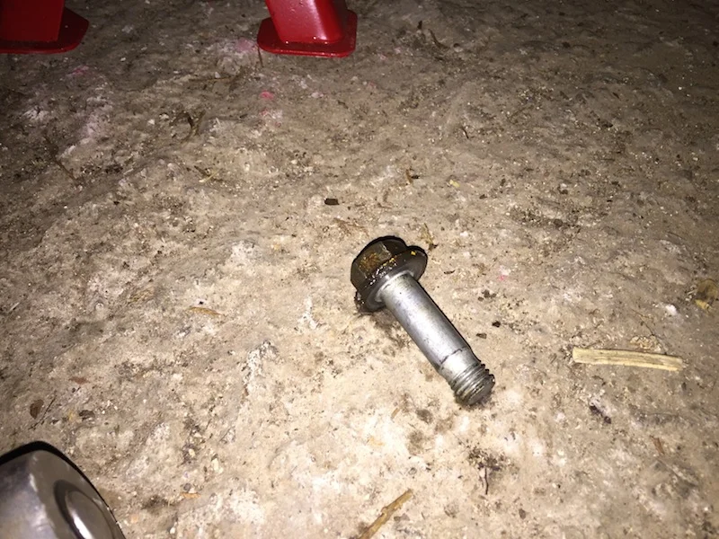

Rear shock bushes are stuffed as you can see and whole doing this i snapped the bolt and found that my reasr are leaking badly so come tomorrow i will order up 2 new bolts and 2 sachs rear shock.

Poly Bush mounts from eBay
I love my Koni, it's great being able to tweak them
Bought from my work for £11.80
I might go down the route of Konis at a later date but just now I'm sticking with OE Sachs
My shock bolt's snapped in the rear beam on the Trophy too.
Welded a nut to them and they came out no bother, the heat must have loosened it up a bit.
This is exactly what I'm going to be doing this sunday, Popping a bolt on it and then heating the mofo up till its glowing white

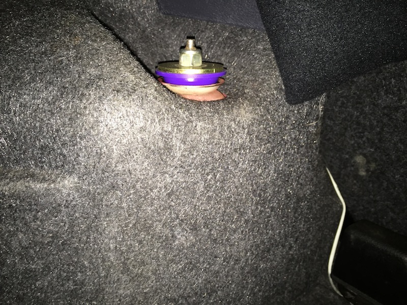

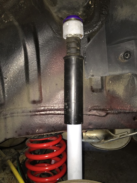

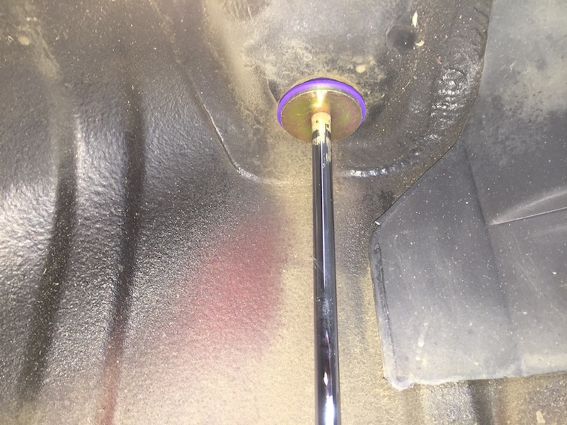

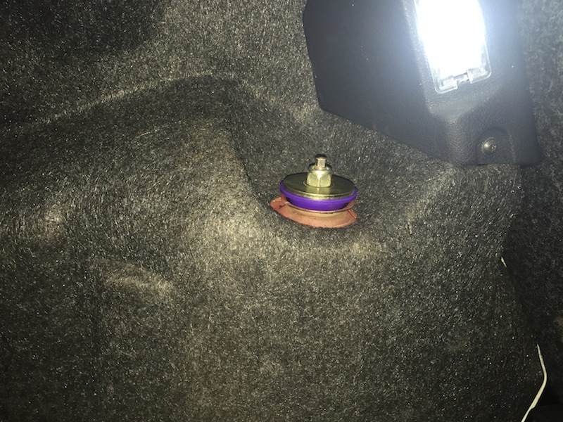

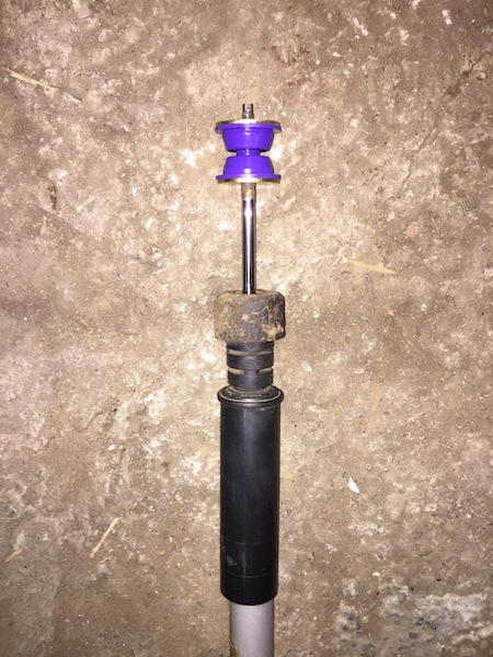

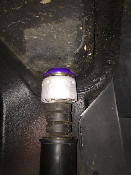

Even tho my rear shocks are dead and i have a new set on order from Renault i decided to use the best of the two old ones to check out the fitting of the rear bush's

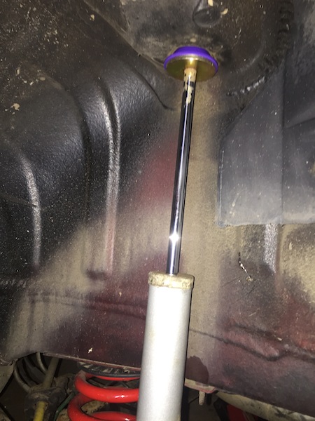

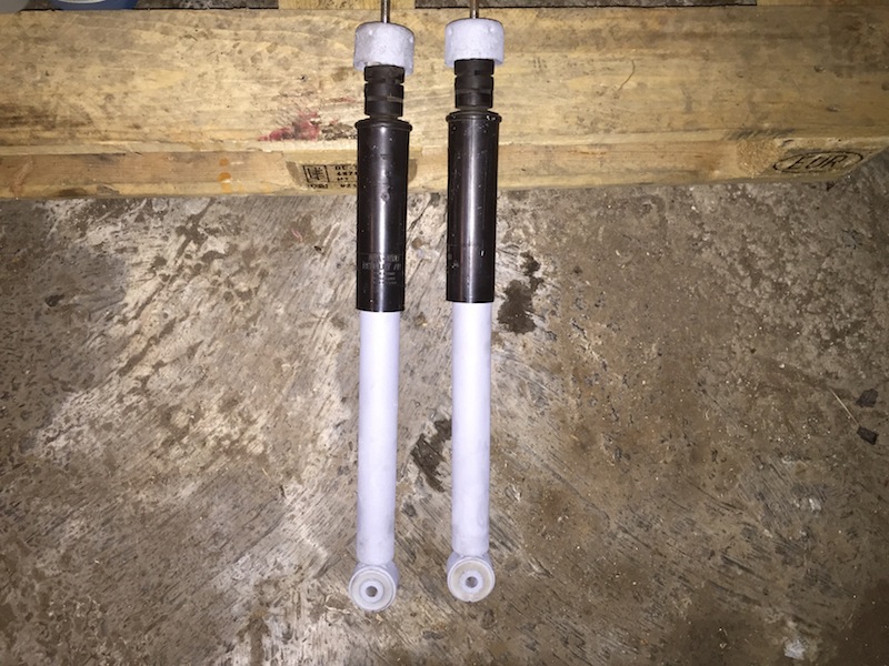

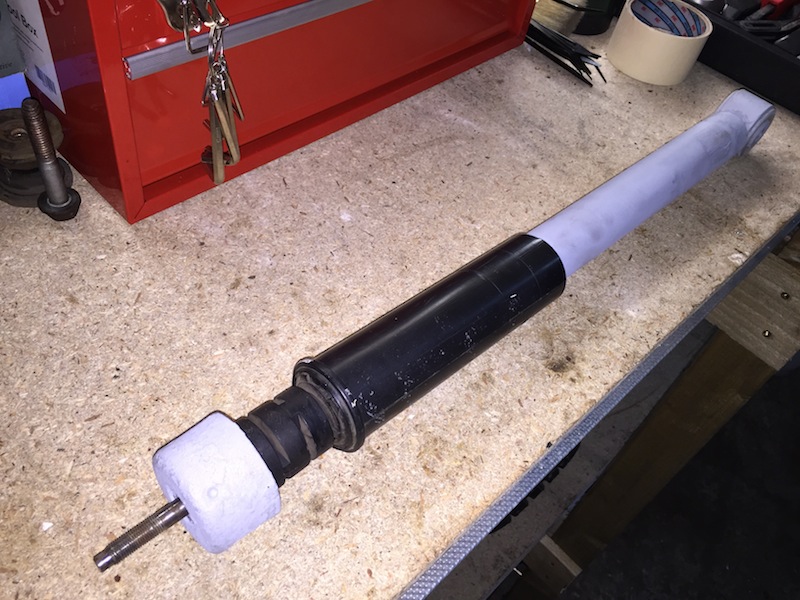

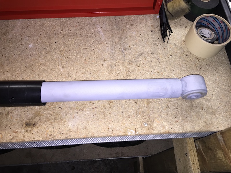

Well got board with the rear sachs just sitting and as they will be getting binned when my new ones arrive i thought i would spray them and build the car back up with the polybushes.
As you will see from the pictures above they where rotten anyway.
