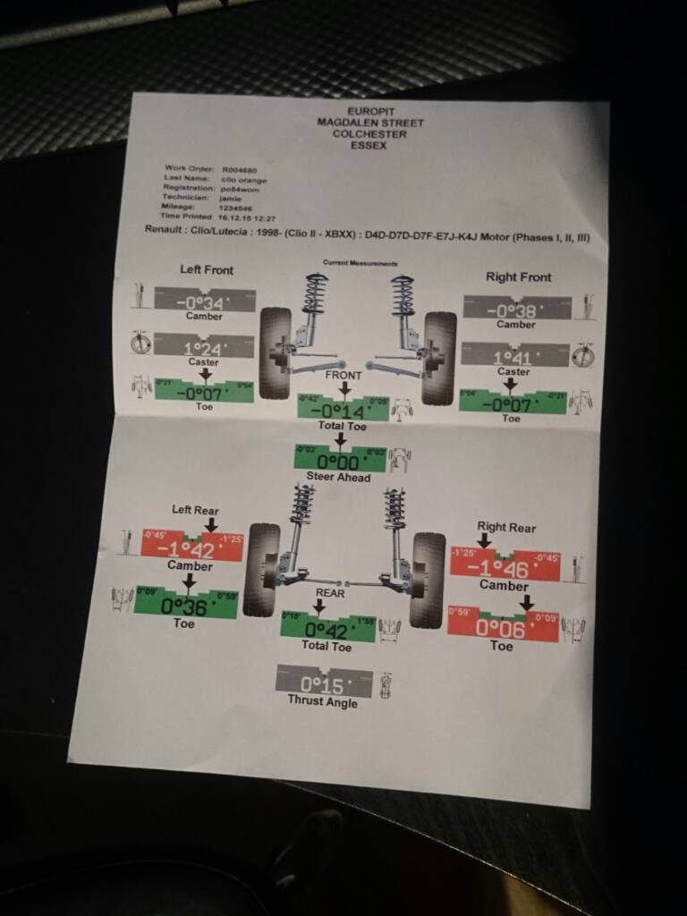

I had my front alignment done yesterday as my steering wheel was out to the right a bit, they sorted the front and the drive is supposed to be spot on

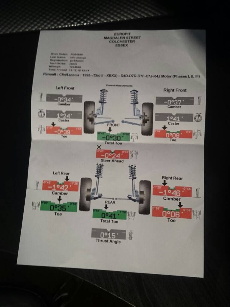

I noticed on the print out that it says there is a difference in rear toe,one side is 0.06° and the other is 0.36 which results in a thrust of 0.15°
When I drove away I slowly noticed that the steering wheel has to be held slightly off to the left now, is this because of the difference in rear toe?
How do I go about adjusting the rear toe, disks off and some very thin washers behind one side? If so, what sized washers would be recommend to counteract this 0.3°?
Before
After
