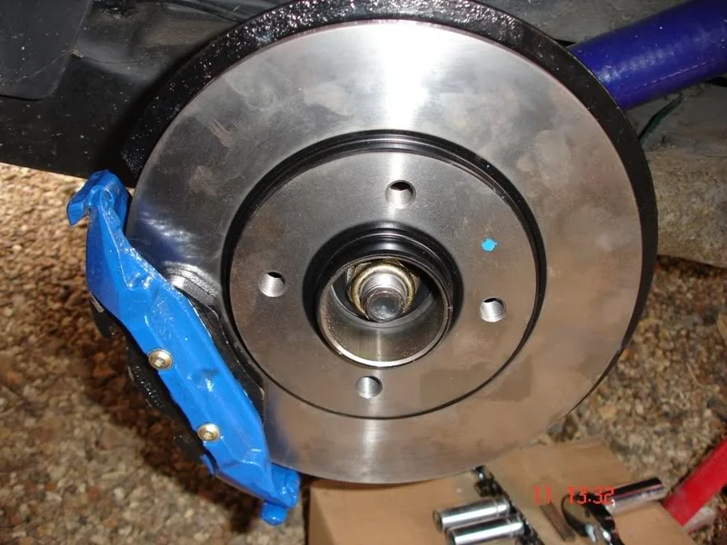

Ok i have just finihsed putting my rear disc back on the clio (Mk1 with Rsi rear beam) after having a new bearing pressed in.
Now i have tightened it up. Its really stiff to move by hand (even with teh wheel on)
Its not massivly tight.
is it the wrong bearing?
Or should i have doen something else??
there is no other things that i have maybe forgot to put back on??
Its just teh disc back onto the stub axel then torque up with the castle nut in place?
Are the fronts the same size as the rears?
Just thinking that he may have giving me the wrong one?
Cheers D

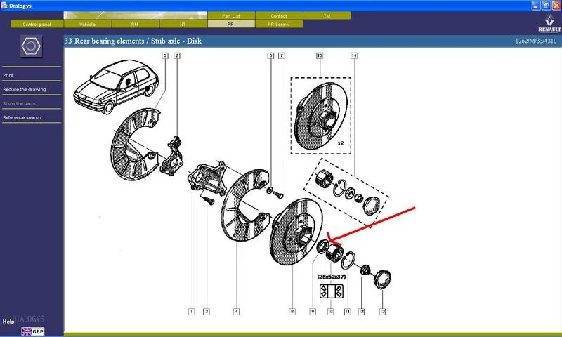

Cant find the receipt at the moment mate, but will try to dig it out later for you if dont get the part number from someone else
There was a picture of it on the Dialogy's software they use when I ordered mine, I pointed it out to the sales guy.
Will see what I can do later
Oh and mine is for the Hybrid/Williams, tell them to look under that for the part number....code C57M
I have just installed Windows Vista and dont have the Dialogy software installed any more otherwise I would look it up for Dave
cant see pics at work?! :(
im lucky enough to have unrestricted access to my pc/net, thank god i work for a p**n site company :P
well look at the very helpful pic terrorist posted, does that look like it goes behind tghe disc? Yep, well theres your answer.
Yes it does Dave, spacer goes on 1st
Then your disc slides on with your bearing already pressed like this
