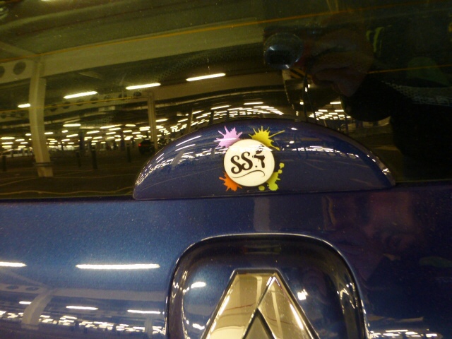

Autocrash was doing really nice, professional quality blanks, colour coded to your car. Streamline carbon do CF ones as well I believe.
