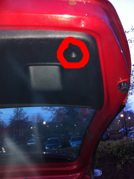

1st) how the hell do you get the trim off to get the motor etc?
I can only find 1 screw?
2nd), do I remove the motor too?

there are a number of screws across the panel, and removing that will give you access to the wiper motor.
3 bolts and a plug on the wiper motor.

1 screw
rest of it just pulls out with some considerable force, poppers i think
remove the motor as well :)
then you need a a grommit form halfords to plug zee hole!

by the way, a lot of people spend a lot of time grafting filling the hole in the rear wiper surround and are completely unaware that the poverty spec models without a rear wiper had a blank surround and you can buy them from renault too.

Kind of thread related. Got my rear wiper off with the ball joint splitter, easy.. but this plastic bit, do these plastic points need to come out/off for my new one to go in? Tried pulling out with my hands, need some grips.. or any other tips?
