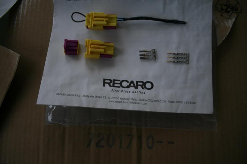

Sorry for the late reply...This is what you need
  ClioSport Blue Edition 17
Hello richy, do yoy have pics of how to install this resistor??
images
