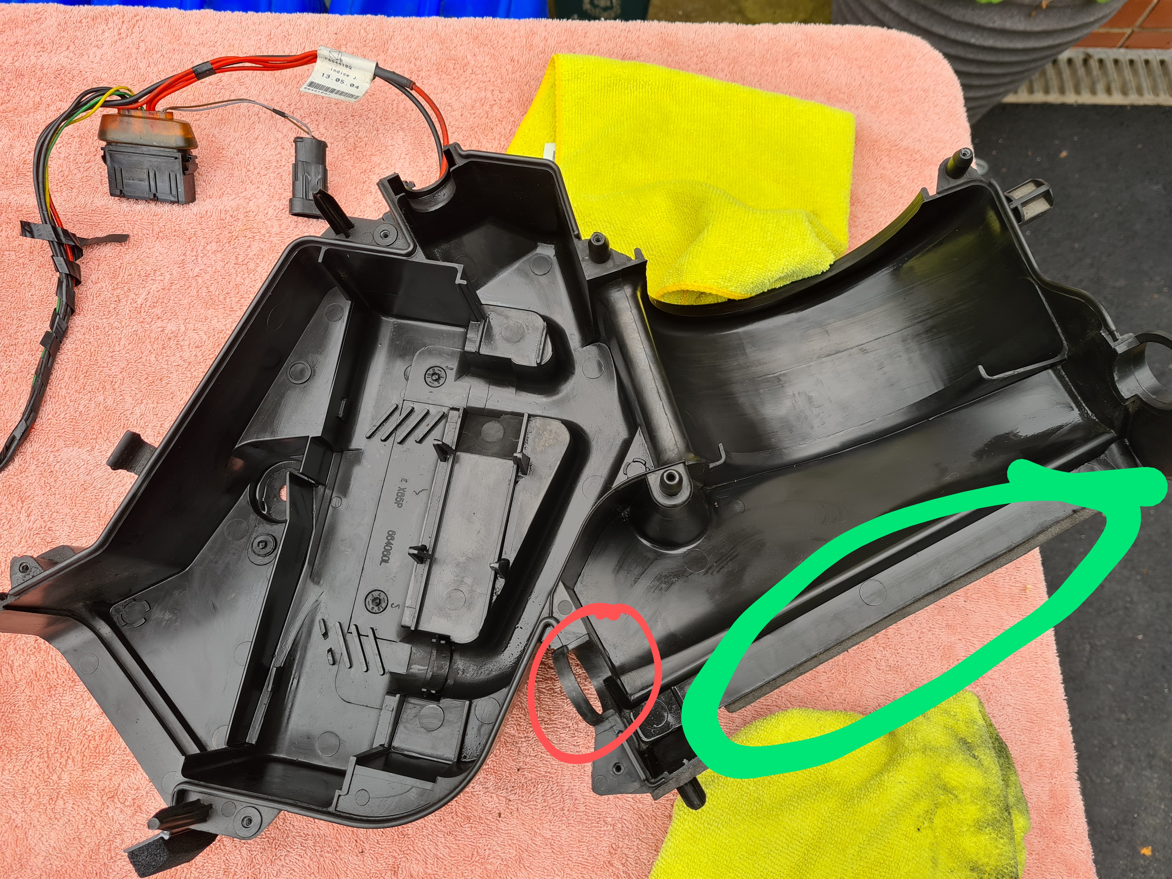

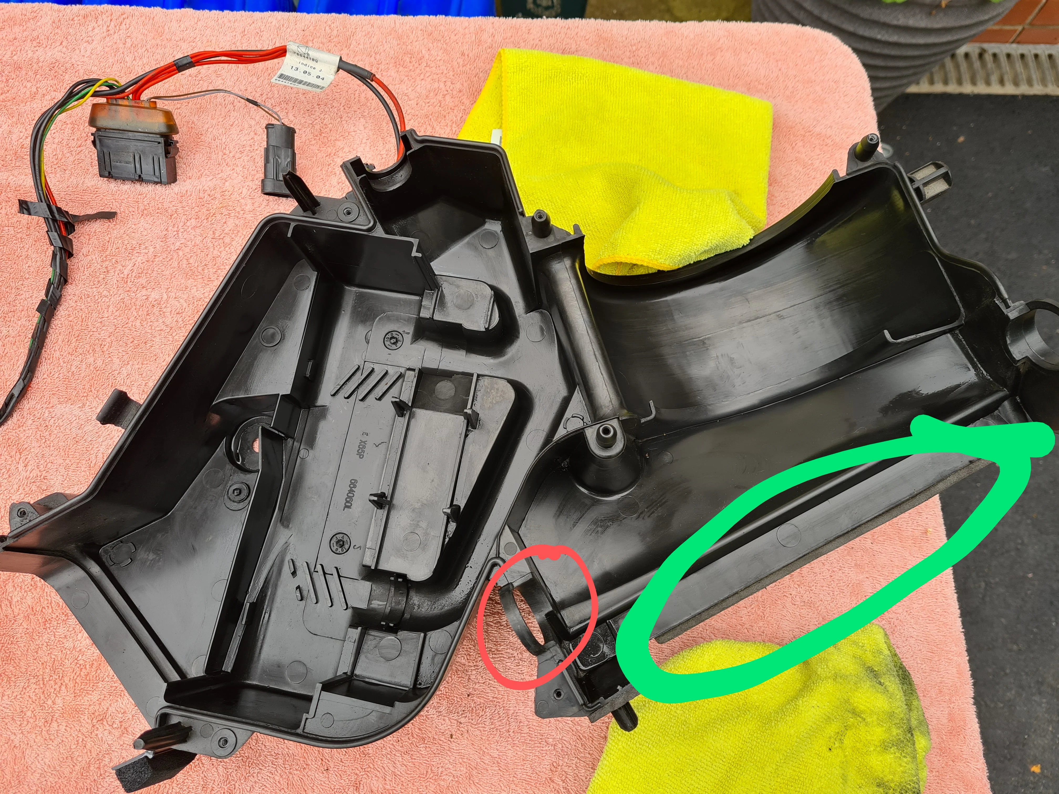

Hmm can't seem to find them, I must not have taken as many photos as I remember.
Basically you take the heater/recirc/evaporator unit out of the scuttle and the plastic tube with square hole that might have cracked sits in the hole that's circled in red with the recirc opening through the bulkhead circled in green
MLB
Ah right this is helpful, post nine shows the square hole that I mean! The actuator is screwed in with two screws
