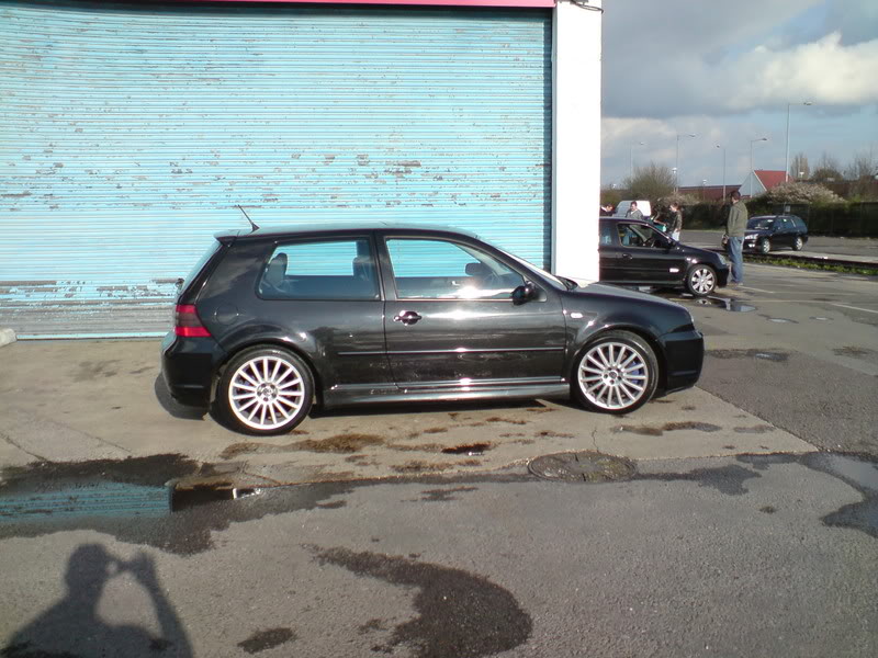

Thanks for info! I've not got any close up pics of the swirls but you kind of get the idea from this photo:
  #174
Hmm, you should be ok with the #83 / cutting pad combo, but you'll probably have to do more than one pass with that combo and you may not get 100% correction.
Can't really say any more without knowing what your paint is like to be honest!

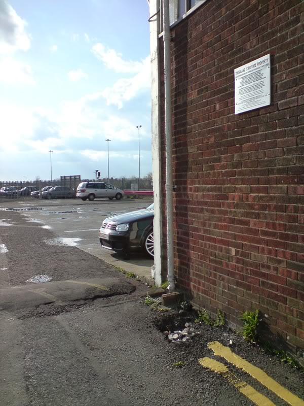

PMSL! hahaha. I remember that day when you hid the R32 behind the corner so the clios could only see its nose....awwwww! ;)

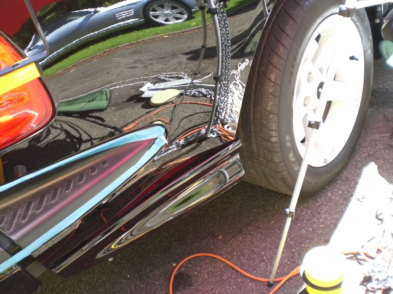

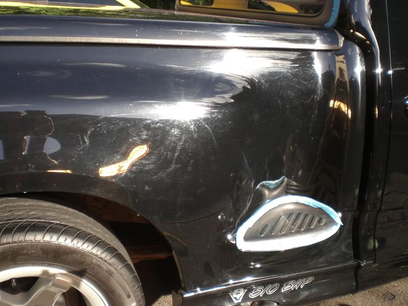

This pic is from the last detail I did. One pass with a G220 with SFX-2 pad and Menz 106FA polish (so not the most abrasive pad or polish combo), nasty swirls etc as you can see but very good correction :)

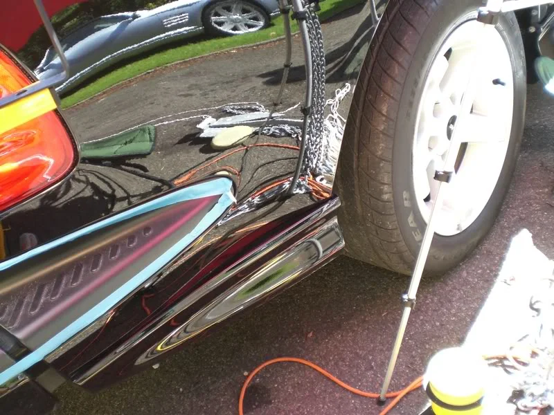

A general before and after from the same car:
