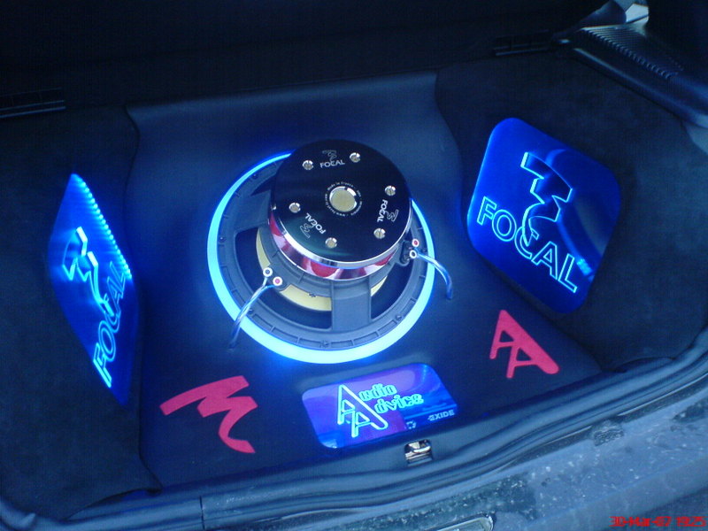

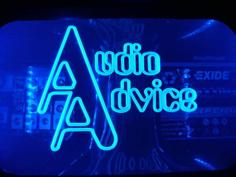

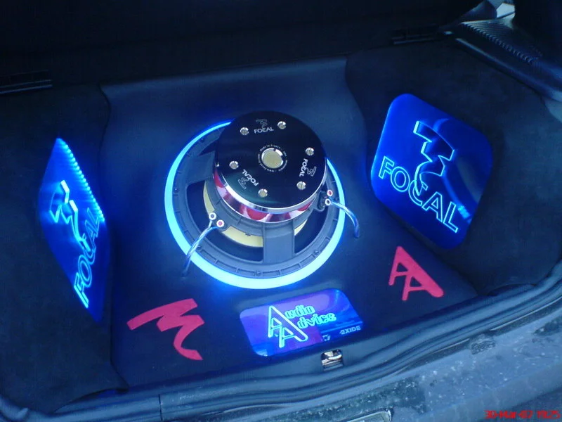

All my wiring is Streetwires 0awg too - good kit and installed by pro's :)
Have a deep-cycle Exide battery for the install with a split charge from the alternator.
Only problem I ever had was the car battery dying in the winter - French electrics FTL!
^ That was all in my dci80 Clio, it hasn't been put into the 172 - yet. I miss it lol

tigger - nice install there :) - AA are very good, i've judged a fair few installs of theirs a few years ago whilst across in NI.
