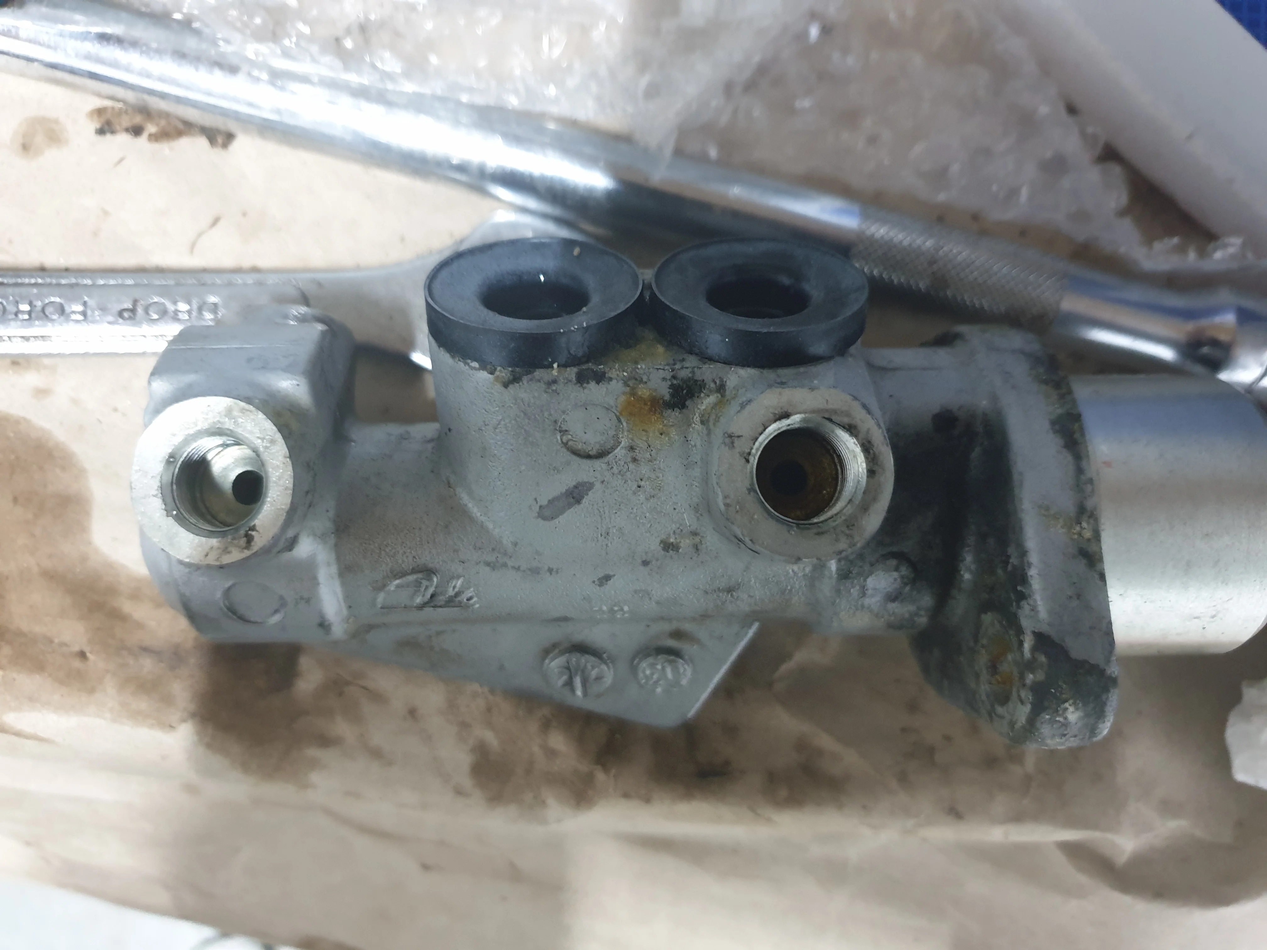

Also this is my master cylinder which came with the car , any ideas which one this is , stamped ate , 90 fittings to a t piece be best for my line to the bulkhead ?

AP Racing or Tilton are the only ones I have tested which give enough pressure reduction, the Wilwood ones may also work but never tested. Stay away from the like of Compbrake or anything non branded from eBay etc.
