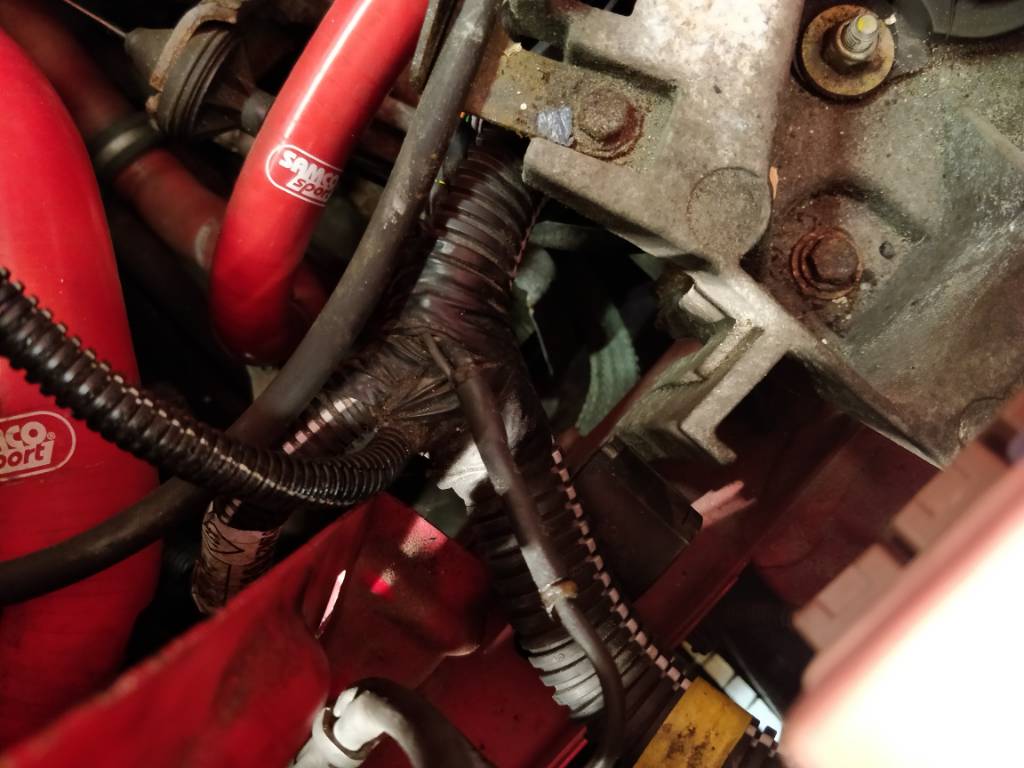

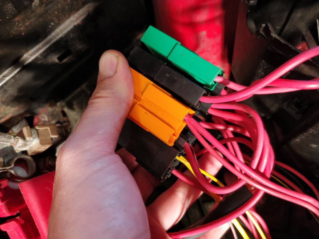

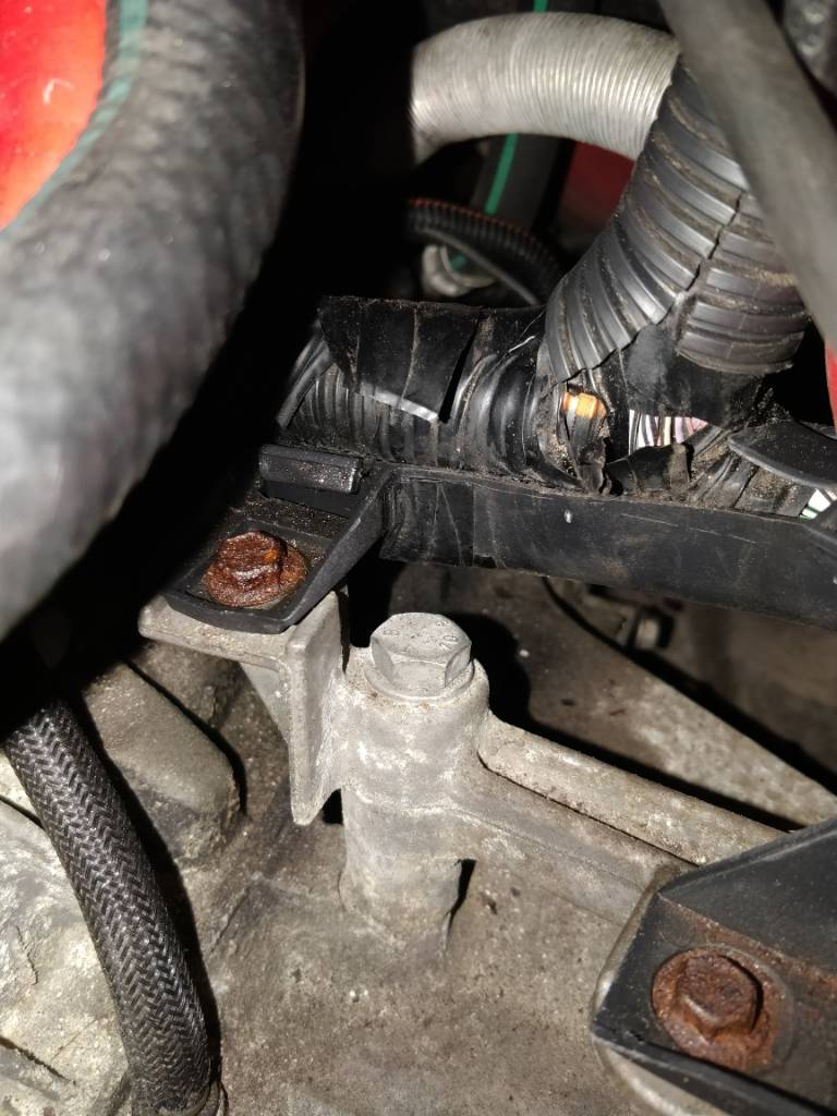

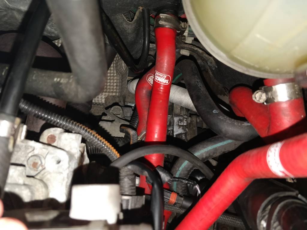

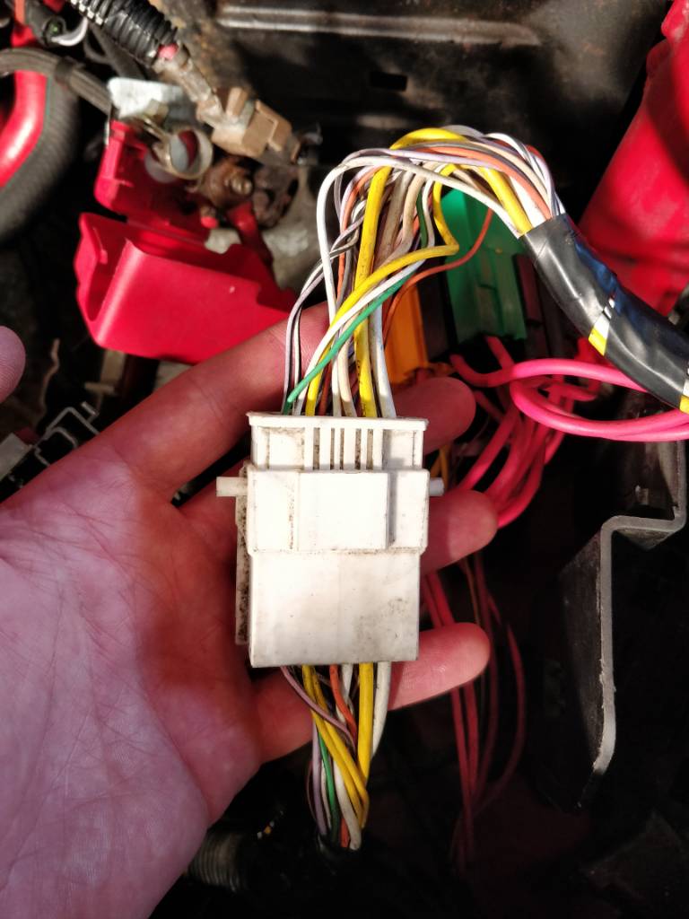

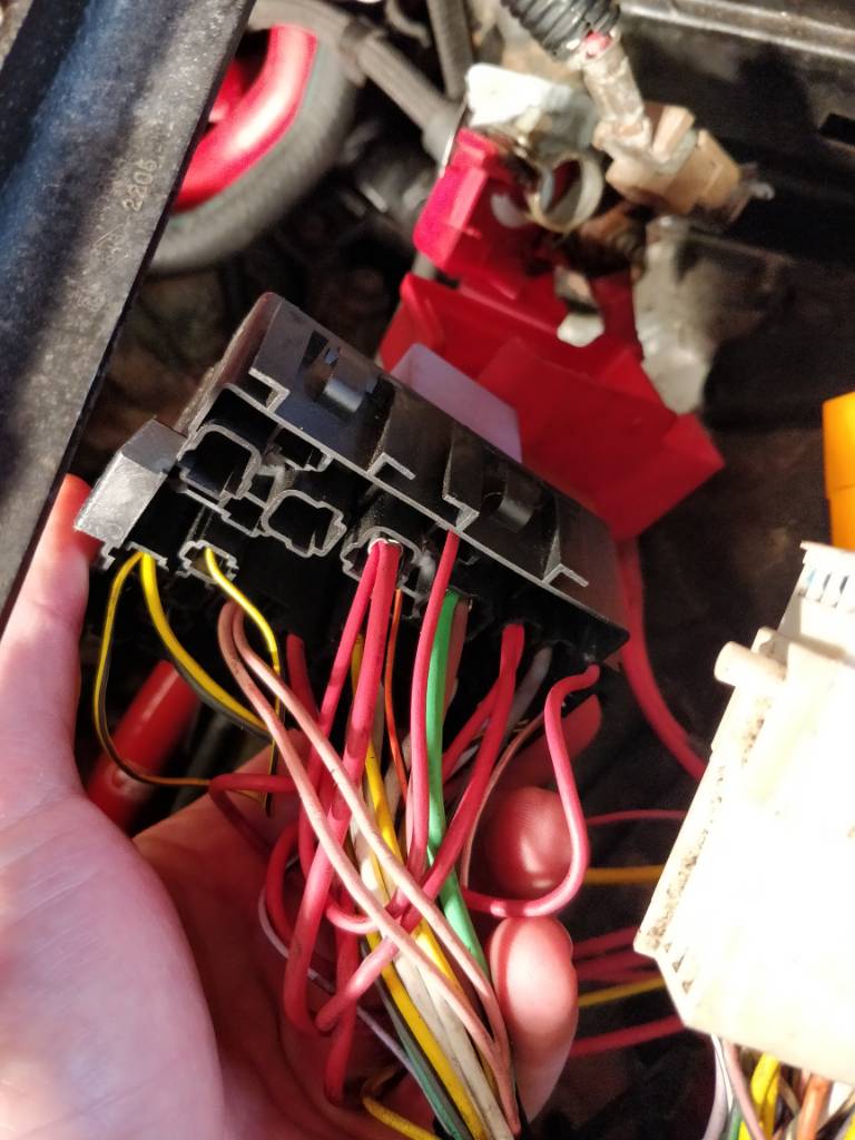

I've checked all of the above and in the process of checking every cable labour intensive. All other controls work like wipers lights heaters. I'm gunna post pics and people if they could say where they found there problem.
