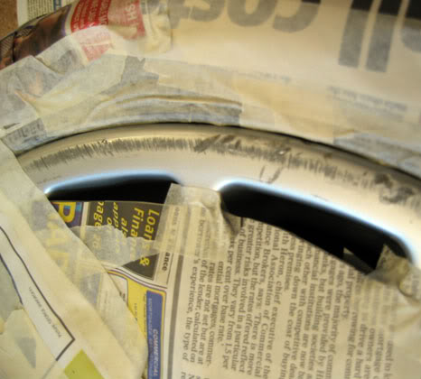

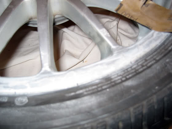

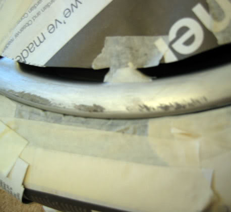

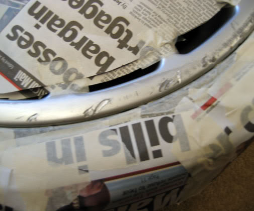

Been refurbing my wheels all yesterday and today... they were kurbed quite well in places.. hours of sanding and now primed was sprayed but colour was to dark so sanded down purcahsed new spray today and colour is spot on:
heres some pic's (going downstairs to prime other 3 wheels now)

what did you use to remove the scoring on the rim ? Looks mint i'm inspired now , just need a set of wheels to try it on.....

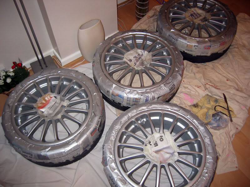

Finished the top coat on all wheels now, only laqeur left to do either l8a on tonight or tommorow and ordered sum OZ carbon fibre centre caps off ebay because ones I got are slightly corroded
Haha, no mate , was doing it in garage but was cold... so brought everything into back lounge to do sanding but all spraying was done in garage.

good stuff fella, cheaper (and more rewarding) than getting chips away out, how did you match the colour or have you sprayed the whole wheel?
Yes mate... firstly had wrong colour... then spoke to Fred and he said it was a Ford Silver of some sort, went to halfords and bought "ford strato silver" was perfect match! No only sprayed just rim and the odd spoke then sort of blended it in a bit... gotta go laquer in a bit

Yea was gonna laqeur them tonight but think its safer to leave them over night then ill laquer them tmrw... cant wait till they are on the car now :D
Yin... was called metal epoxy in a tube... kind of like blue tak you have to knead it together then let it set for about an hour or so then sand it down, but get as rid of as much excess as you can first because its hard to sand down!
