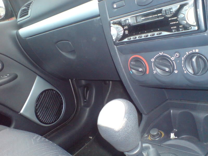

ive just bought a set of handles froma member on here, going to do them soon as possible, done my gearnob during the week there with the dash strips and speaker covers,

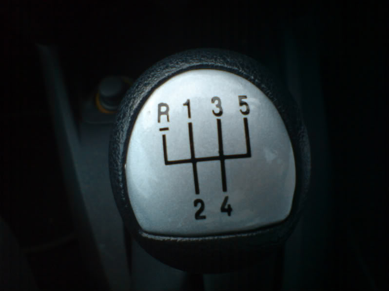

knob with decal
looks good. Really need to know how to remove my PH1 gearknob asthe previous owner obviously wore a ring on his finger
mine originally had the lines and numbers recessed into it and the amount of crap clogged in it was manky so i smoothed it over and got a decal from here on it, also painted in inceberg silver ;)
