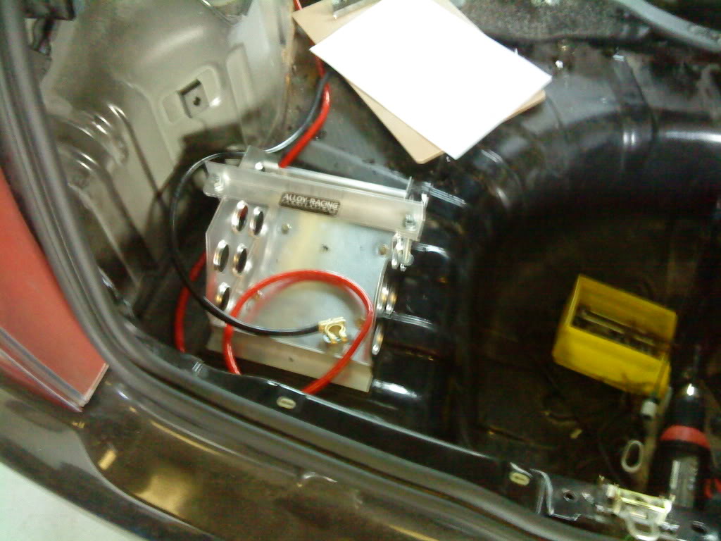

You only need to run a positive, I use the earth that the rear lights use right at the back for mine.
Hold it down with blu-tac, couple of coathangers joined together with sticky back plastic covering them, job done ;) Blue peter styleeeeeeeee
Some Autoleads cable from Halford, cant remember what guage it is but it's MORE than ample. I use the stock battery and a battery tray bolted through the floor!
