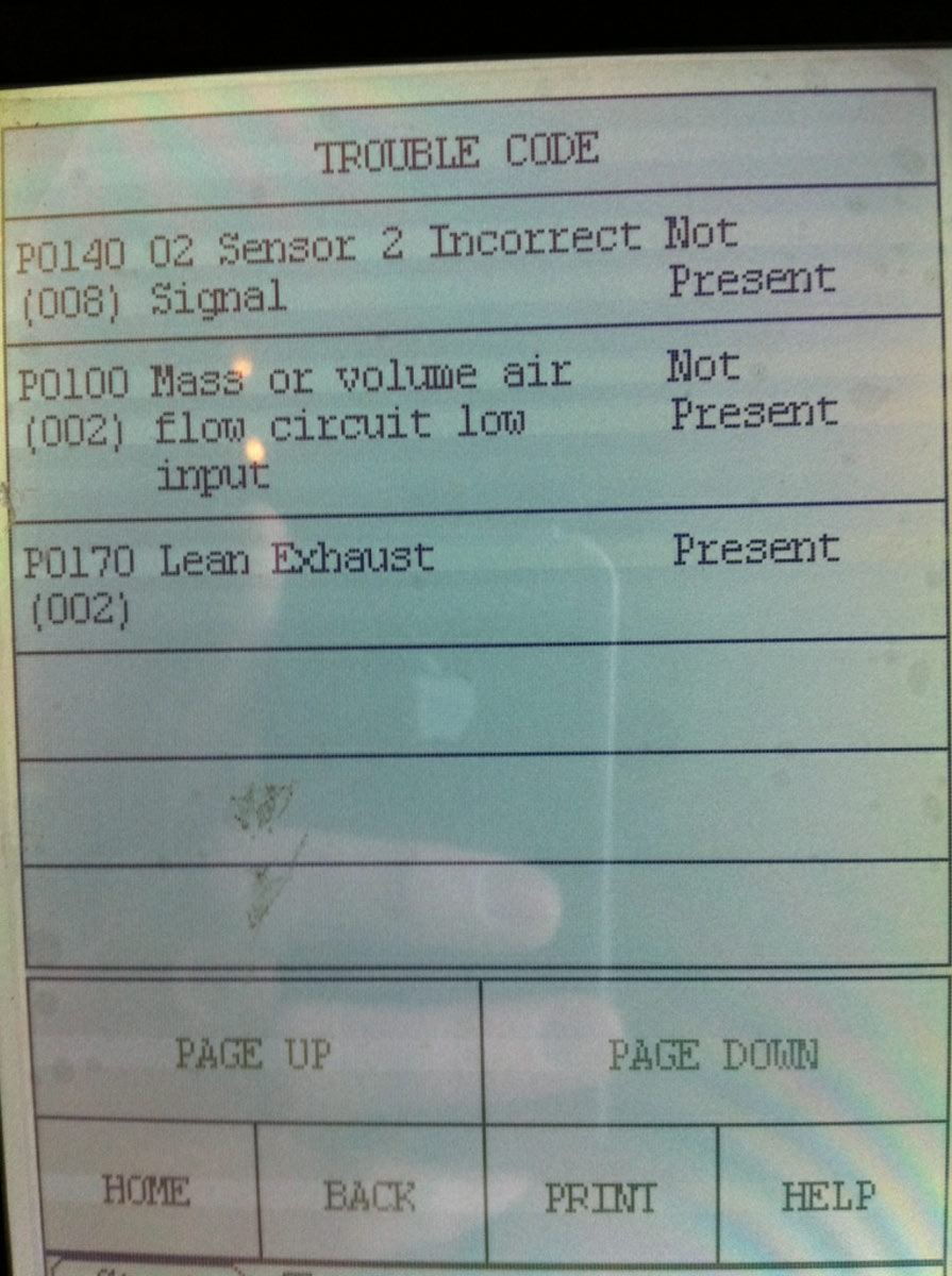

Oh, and this is an example of a car running lean from a diagnostic machine, provided by another member.
Doesn't mean much to me tbh, shows something's out of control slightly maybe i.e lambda and the car has reached its max fuelling parameters maybe. Doesn't tell you exactly your AFR. I wouldn't trust that as gospel anyway.
Others might disagree but that's just a throw away code afaic.
That was just an example of lean error codes exist, anyway... that was my diag machine.... & it was indeed the airflow meter at fault.... causing the Lamda to give a wrong signal. Car wasnt a renault... but its now running perfect again.
As for Luke's issue, somebody needs to go & see his car and diagnose the problem.
Usually the case with code readers, you need to have proper diagnostics gear and check live data or else you end up at the wrong end of the car replacing the wrong part if you go by codes.
Luke's car just sounds like a simple missfire tbh, wd40 on all the plugs, leads and coil pack plugs, bets are that improves it ten fold.
