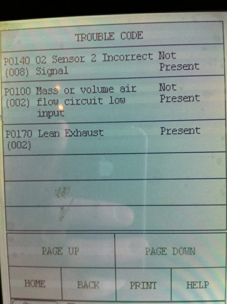

Im no rocket scientist and might be wrong but to me its nothing to do with any map. The op is describing a miss firing engine ??? Rough idle, drop in power for a split second and then pick up again, shaking etc? I think he's getting confused because he has fitted a de cat and it coincides with the mis fire starting or s the only thing he has changed so is blaming that.
I would like to know as well how your mechanic can tell its running lean with a fault code reader?
I thought it was misfiring too! That's why I got my spark plugs and HT Leads changed (as they were fucked) so I thought that it might be to do with the exhaust. Do you think it is misfiring and I need a new coilpack or something? Bloody hell! One problem after another haha!
He didn't think it was running lean from a fault code reader, this is what my dad and a few other people (that like to think they know about cars :eek:) think because of the new exhaust, and as I know nothing I thought that could be it, could that explain these issues too?
Oh, and this is an example of a car running lean from a diagnostic machine, provided by another member.

Your dad is correct that at full throttle with a free flowing exhaust that a car with a MAP based fueling algorithm will lean out slightly, the the effect is going to be very small, it wont cause misfires.
