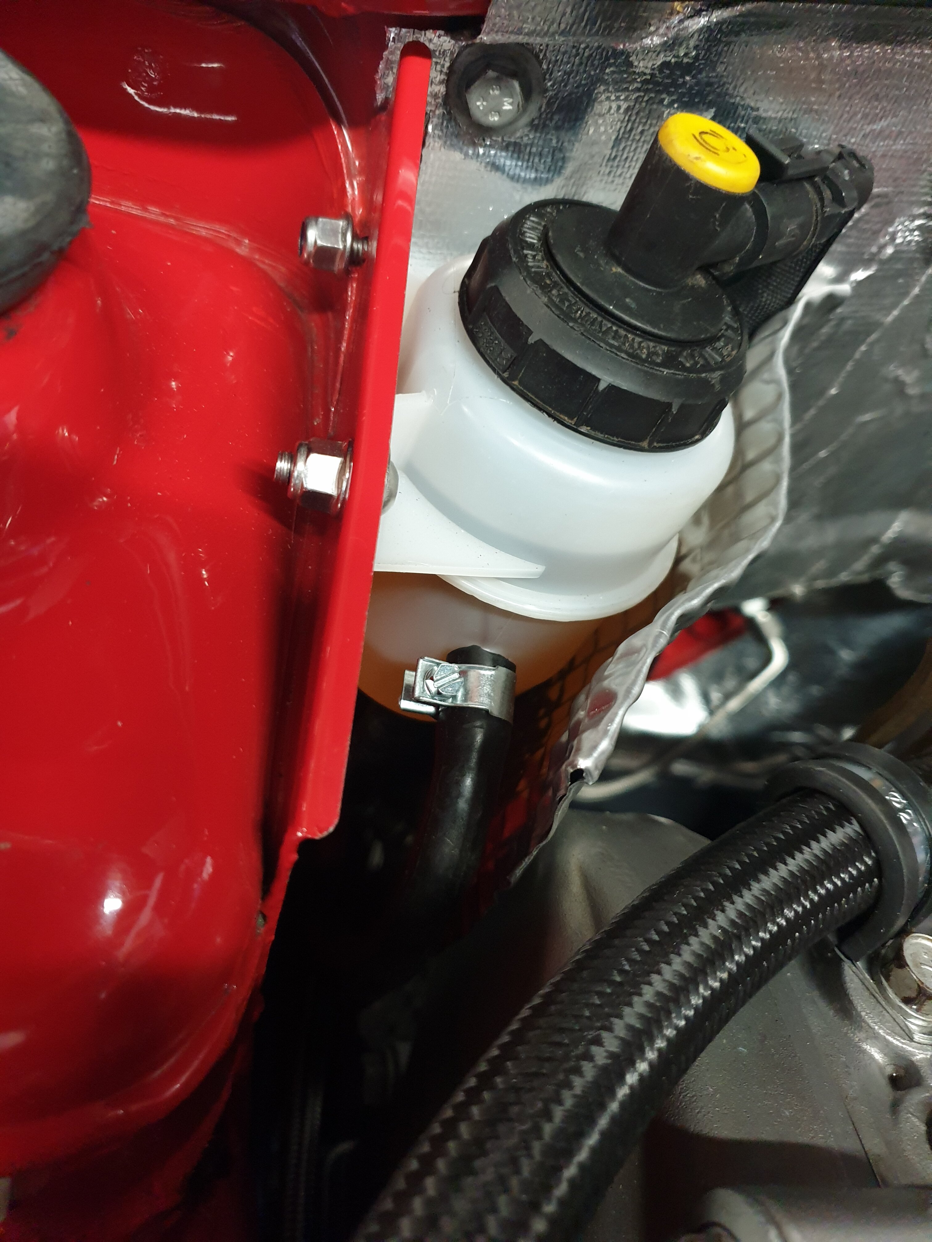

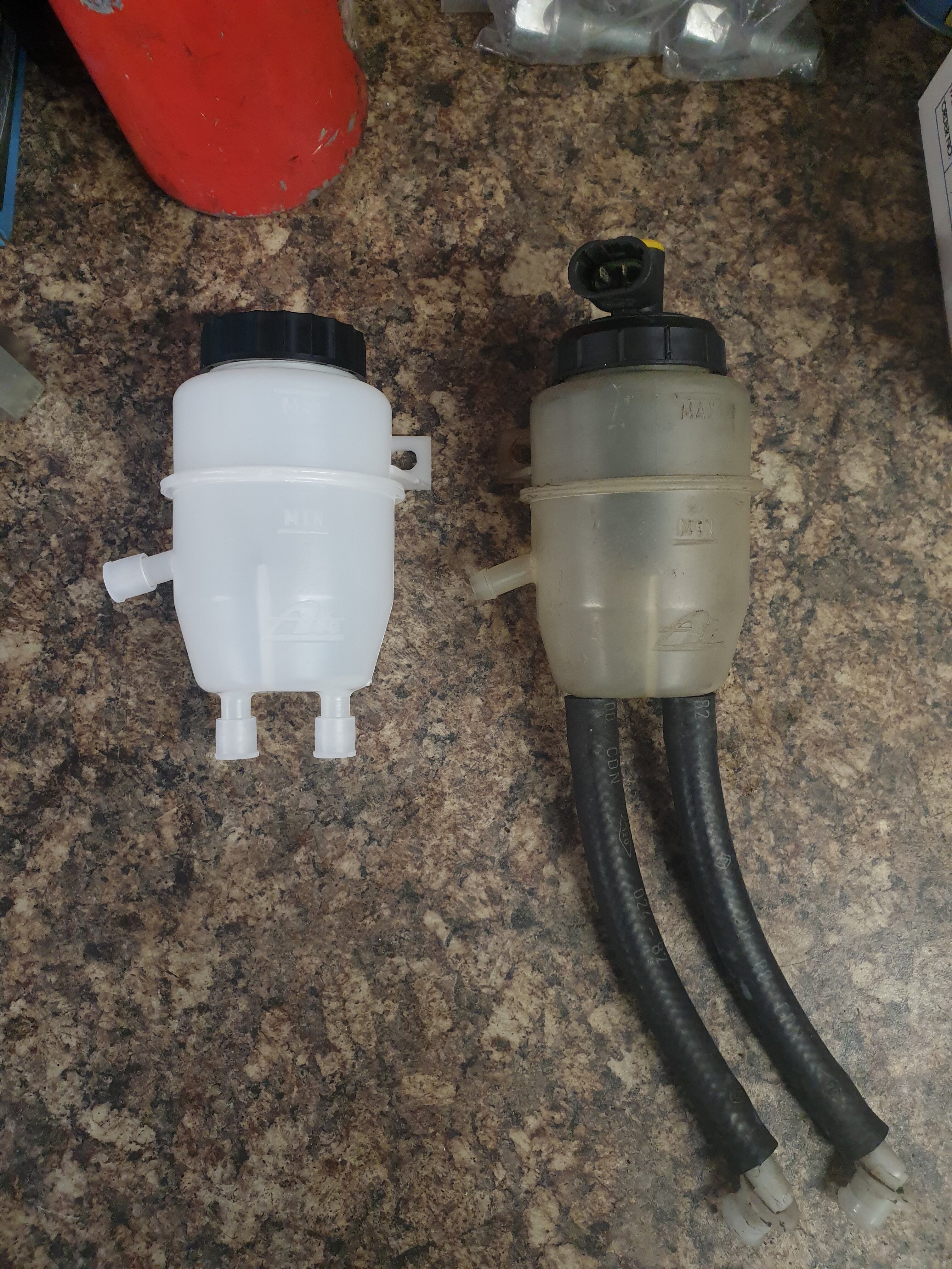

I use a clio v6 remote reservoir on my Trophy. The bottle is an ATE one shared with bmw and angled plastic fittings that fit in the top of the master cylinder joined by rubber brake fluid resistant pipe. The ATE bottle is easily available and renault level sensor fits straight in, however if your using normal cable clutch you will need to block off the feed for the hydraulic clutch. Other option is to use a universal reservoir, shoudl be able to ick up the plastic push in fittings up ok.
Old one showing pipe run

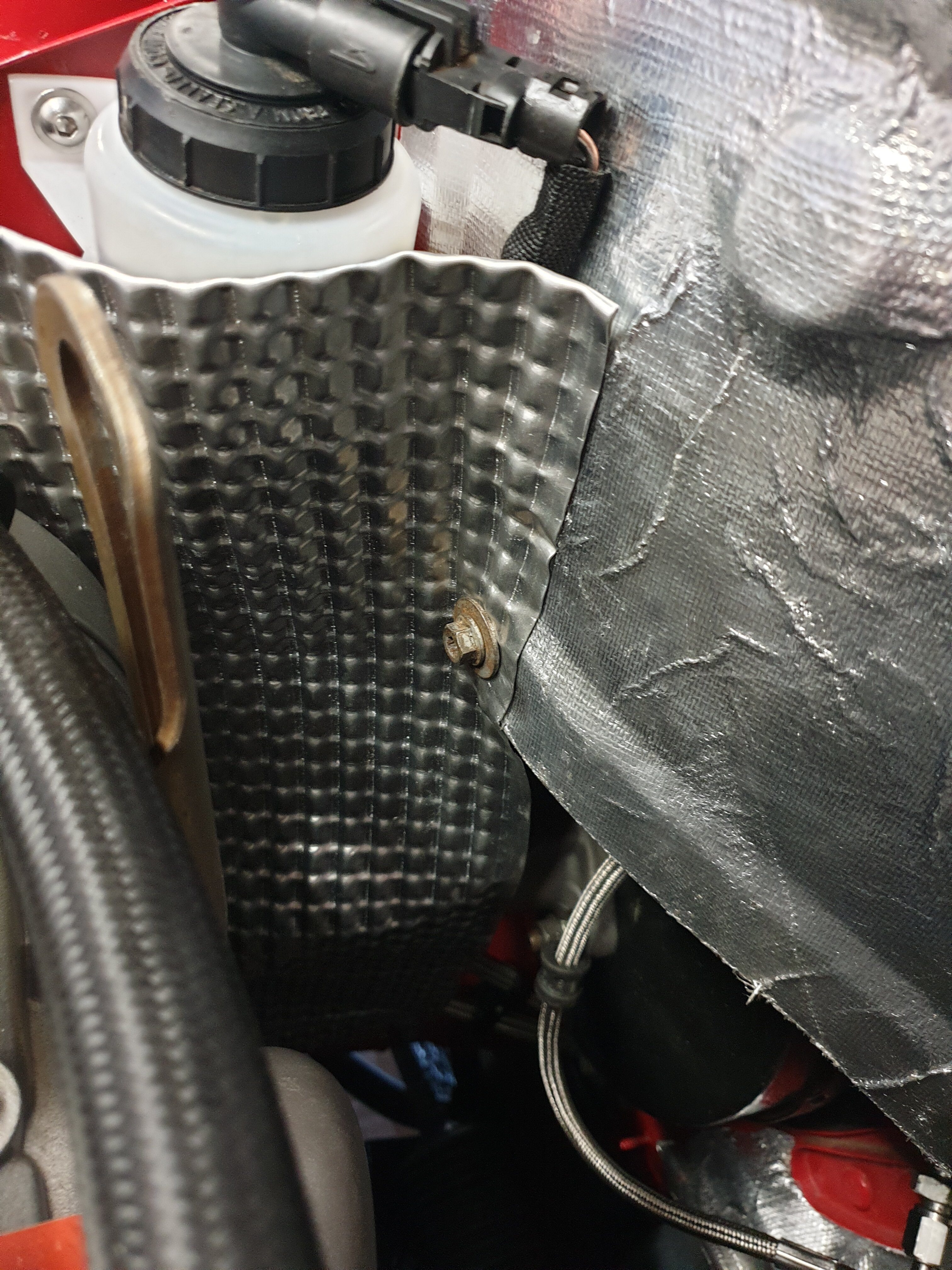

New one fitted with nimbus heat shield
I use a clio v6 remote reservoir on my Trophy. The bottle is an ATE one shared with bmw and angled plastic fittings that fit in the top of the master cylinder joined by rubber brake fluid resistant pipe. The ATE bottle is easily available and renault level sensor fits straight in, however if your using normal cable clutch you will need to block off the feed for the hydraulic clutch. Other option is to use a universal reservoir, shoudl be able to ick up the plastic push in fittings up ok.View attachment 1608213Old one showing pipe runView attachment 1608214
New one fitted with nimbus heat shieldView attachment 1608216View attachment 1608216View attachment 1608212
