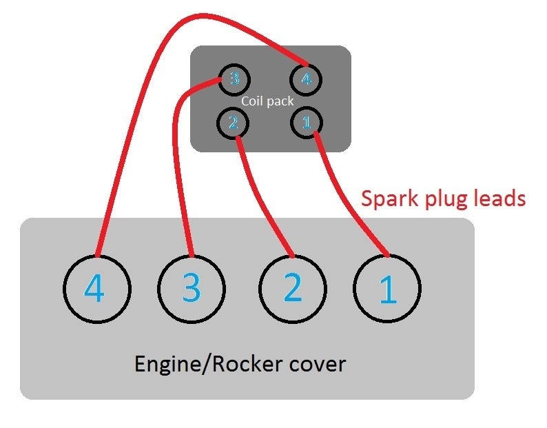

Removed Manifold now i dont know what order my HT leads go!
Mr R.
  A special one.
It has the numbers on the coilpack where the plug leads go.
Number 1 is the gearbox end.
welshname
Gearbox end on the car is 1 and then work to the left to get to 4.
On the coilpack its:
Bottom right - 4
Bottom left - 3
Top left - 2
Top right - 1
That's looking into the engine bay with it bolted down.
  LY 182
Bottom right - 4
Bottom left - 3
Top left - 2
Top right - 1
Im sure Mine is
bottom right -1
bottom left - 2
top left - 3
top right 4
  LY 182
Haha no worries then, i changed my coilpack last night and got 3 and 4 mixed up, soon knew about it when i started it up, pops and bags everywhere hah
Just for future reference....
