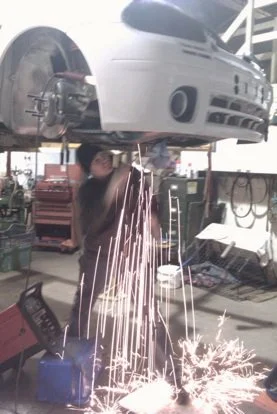

I had to Dremel one the first time I did it!
New engine build I'm putting hex heads on!
good luck finding M7's :( f**king french
Dont round the bolts off of you'll be doing this
