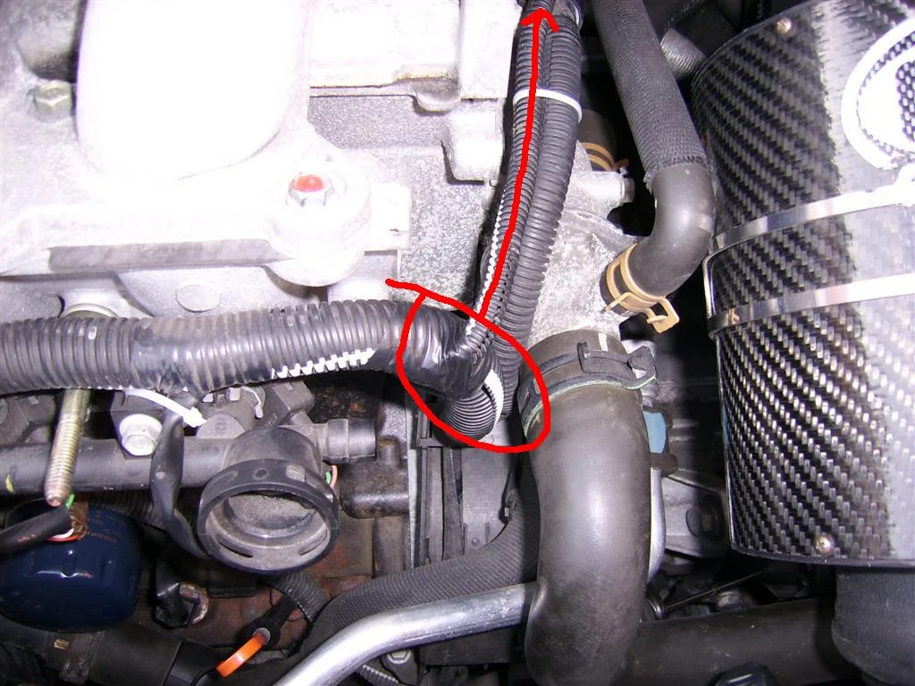

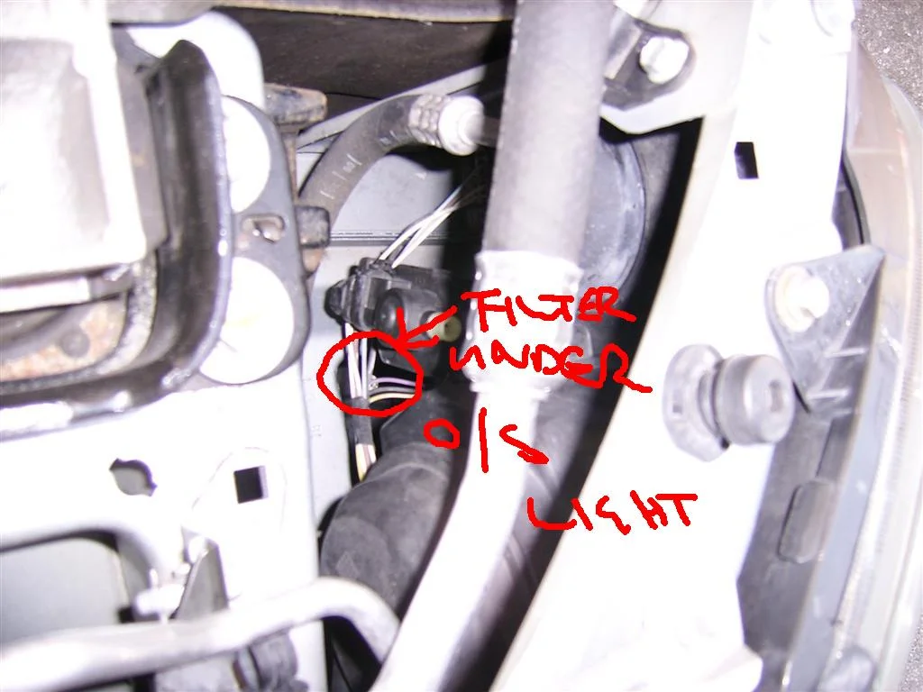

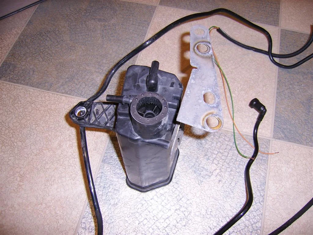

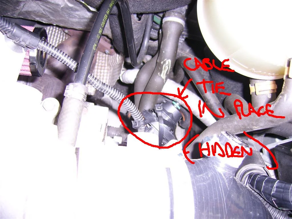

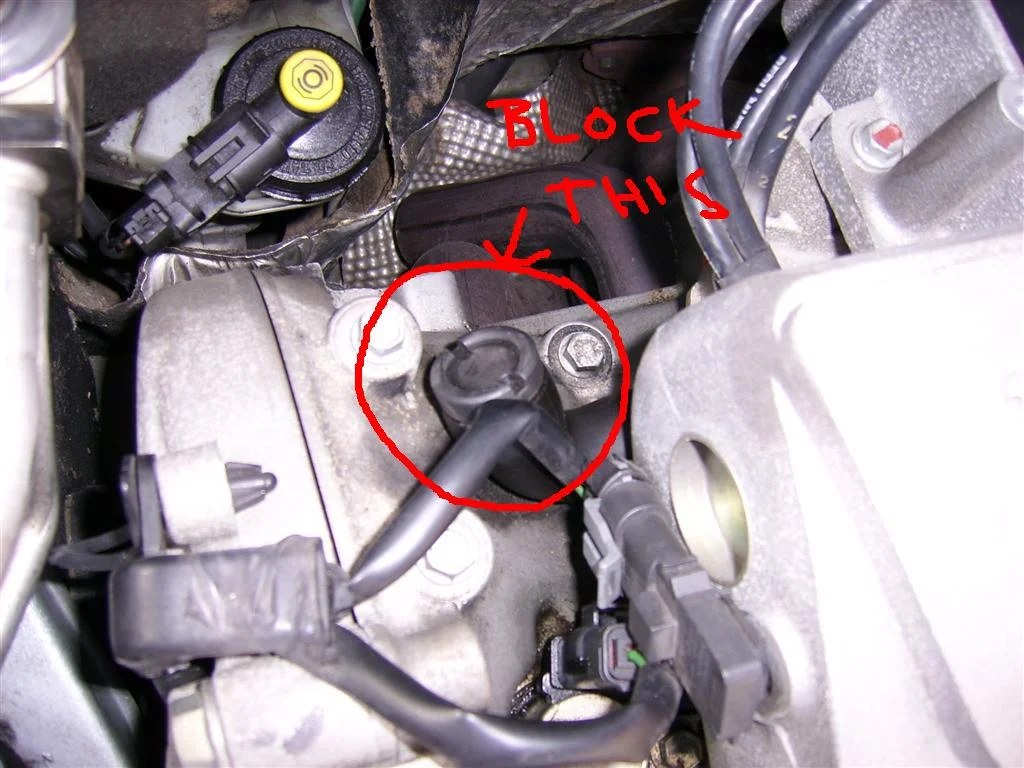

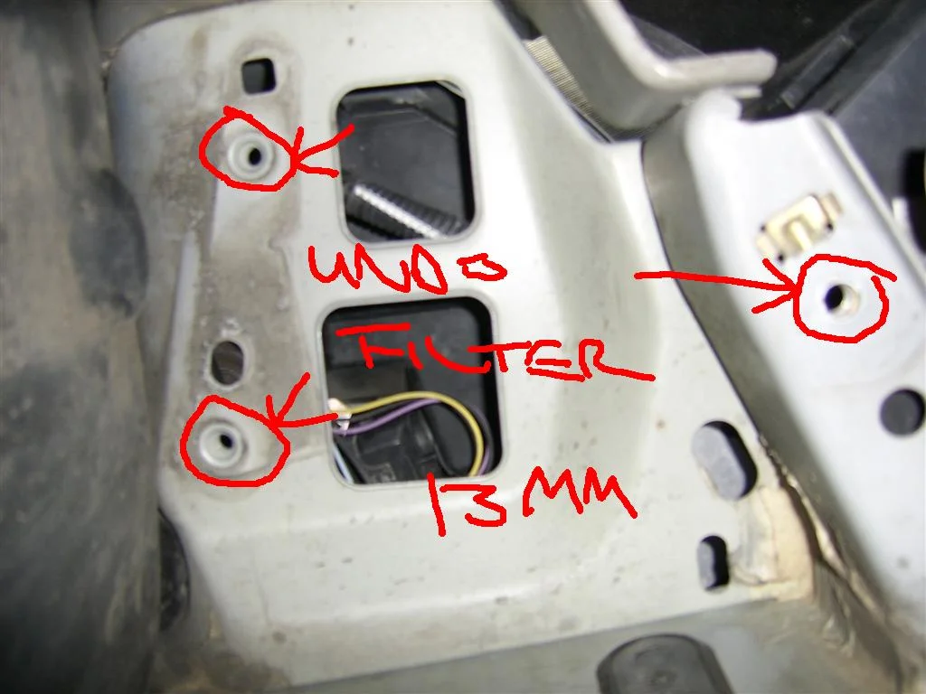

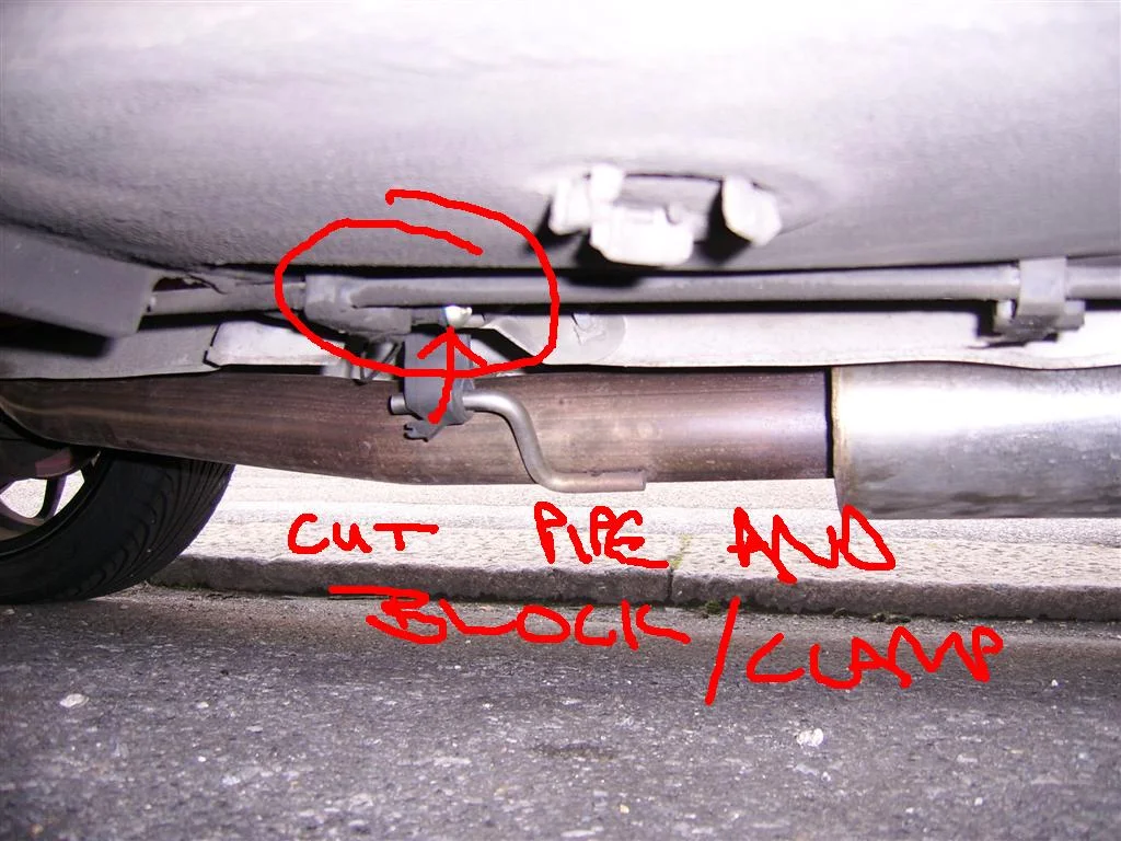

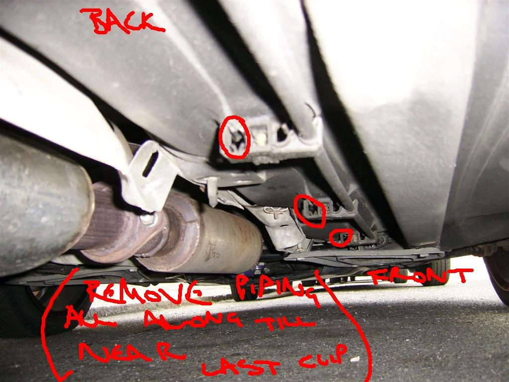

pics went missing???

Mine was removed by Mark Fish when he fitted my brake ducts......it's a bit more of a lumpy idle than standard and the fuel smell is lot stronger.
I sold the car last weekend, but my emissions light hadn't come on and the unit had been removed at the start of September 2007.
  182 inside
good man. your idle may be a tiny bit lumpy. I ran a vent from the tank along the handbrake line and no more fuel smell.
  182 inside

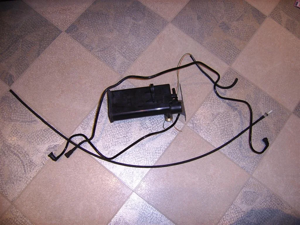

pic of all the guff removed from car.
Any chance of putting this into a guide mate ?
As i don't get the steps involved(where to block pipes at engine end etc) :S
And where to tap your new vent in to get rid of fuel smell.
