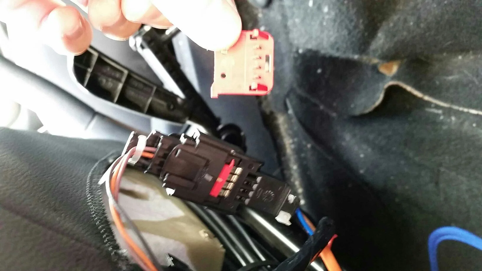

Hi guys, I'm finally trying to remove my drivers seat to fit the sport seats I bought a while ago, I've unscrewed the seats but I can't seem to disconnect one of the plugs underneath! Could someone give me some pointers please!
This red bit came off when trying to disconnect it?

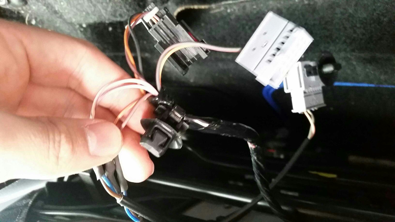

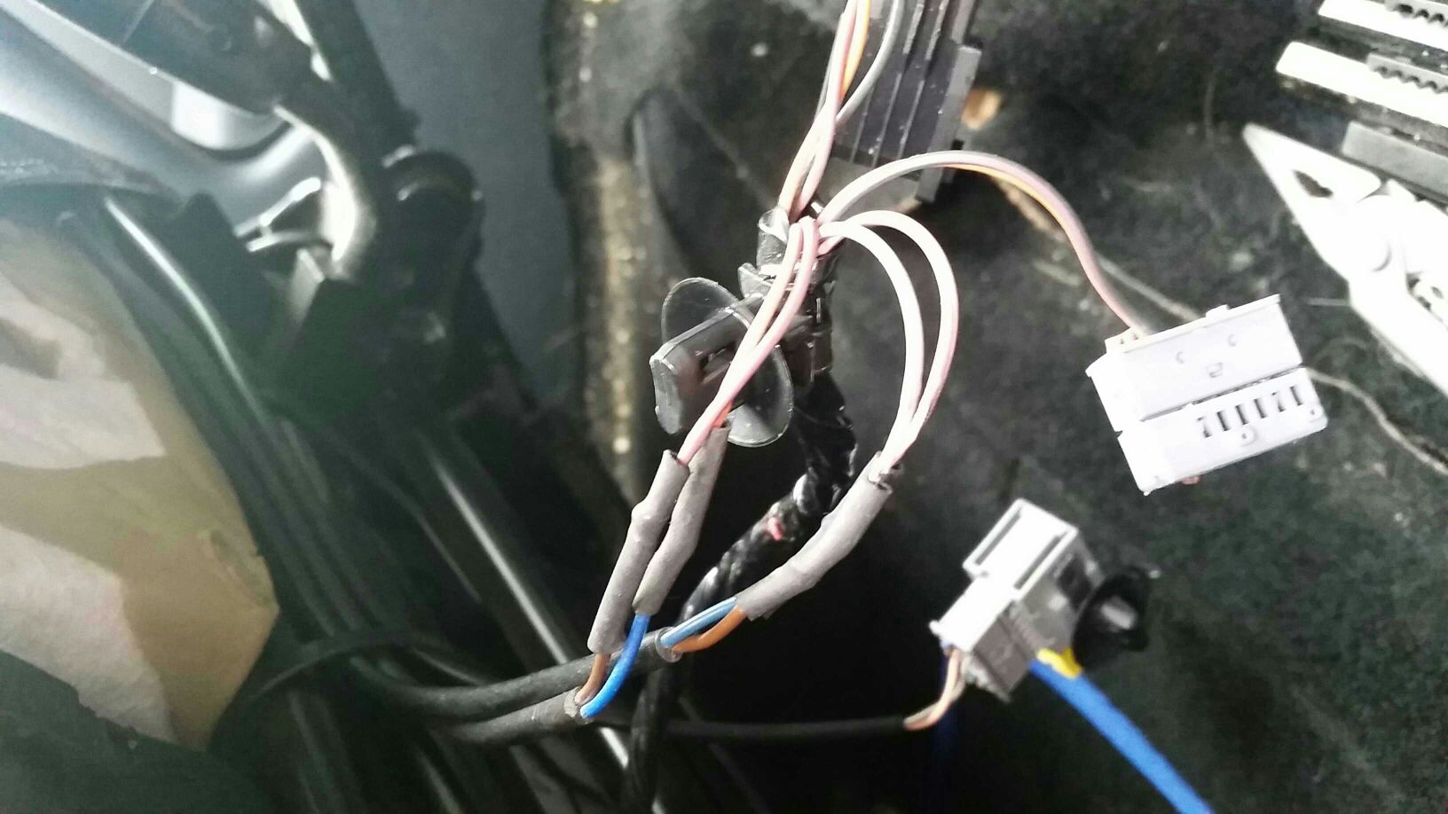

Right, I managed it after about 20 minutes of trial and error! But now I'm faced with another issue - I assumed that once I'd removed the connections I would be able to remove the seat but it seems as if someone has played with this seat before? Or do I just need to cut some wires? :S
The thick black cable goes toward the car while the rest of the wires go toward the seat?!
The red bit doesn't really matter so don't worry too much.
You need a very thin flat blade screwdriver to slide into the locking part of the clip and jam it in there. Once it's jammed in, pull (quite hard!) the two black bits. DO NOT pull the wires because they'll break before the clip comes apart.

Thank you so much Daniel, I literally just managed to do it but thank you for the help - Any idea about my new issue? :L
Those cables have already been cut & joined by the looks of it.
You'll need to cut them to get the seat out & rejoin them once the seat is back in. Mark the cables up before you cut them though or you'll forget the order the need to be joined :)
I thought so! The car only had one previous owner when I bought it and that was an old lady apparently!
