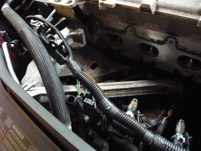

Any tips for refitting? Manifold is tight and doesn't seem to want to slide easily with the new ptfe gasket.
right, im now in a pickle.:(
from the picture below can anyone tell me what bolts/parts i need to remove/loosen to allow a big enough gap for the manifold plus a ptfe gasket to be fitted?
