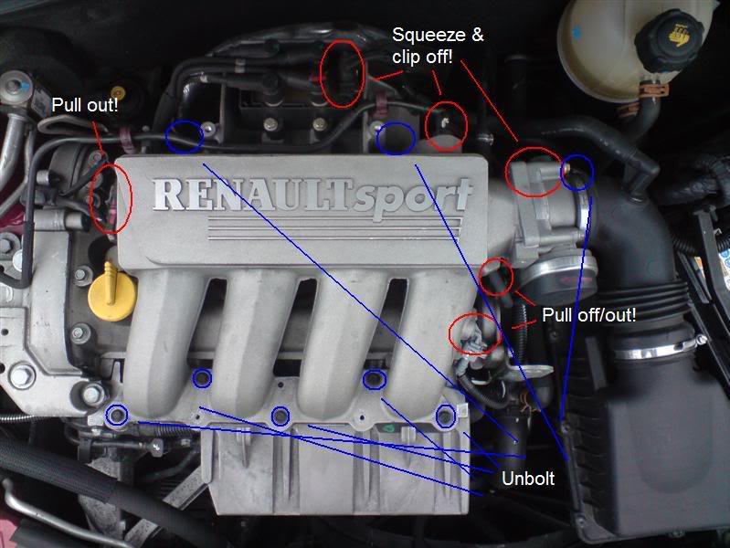

Removing plenum?
You like?

^ Sorry darling next time you have a techinal fault I'll take a nice picture show you where everything is and if your really lucky ill pose too ;)
Matt if there isn't already a guide in the members section and im sure Dan would of looked might be worth sticking your diagram in there with a few words when your next bored at work :)

Taking the lower inlet piece off is a lil more tricky took me a while the first time i took mine off!
