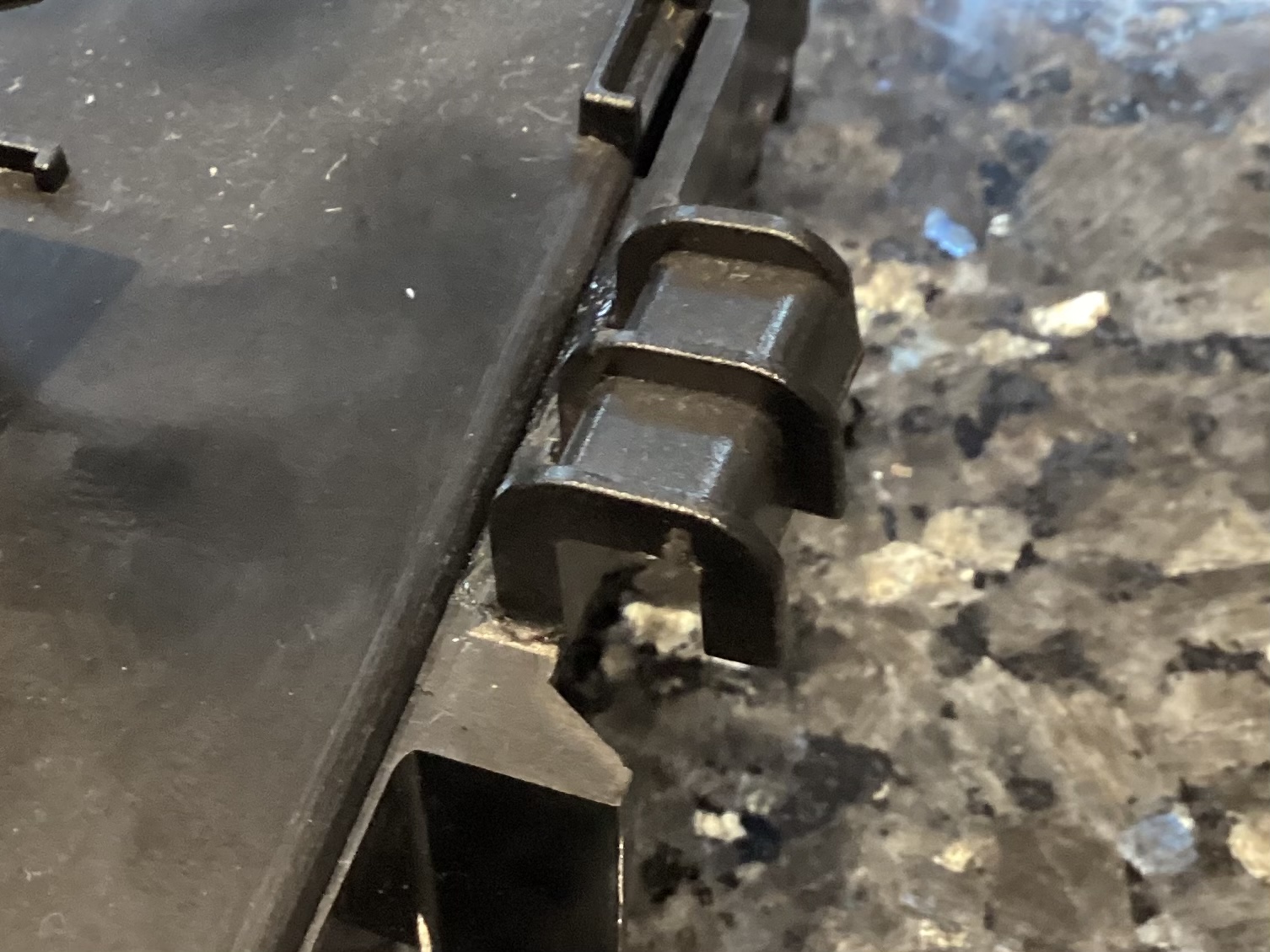

Old thread bump but nobody mentioned a small tab on top of the unit. Once the 13mm boot and torx screw are out, push the UCH up to release the tab, then move it to the right before pulling down. Otherwise you’ll just snap the plastic tab. Ask me how I know
