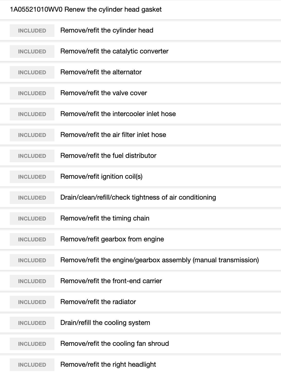

We have a 2013 Renault Clio 0.9 TCE 90 in our workshop with major water issues, the top of the gearbox is covered in anti-freeze and the level is dropping fast. Regardless to this, the owner of the car has driven the car regardless of the issues and cooked the headgasket.
Autodata is quoting 11 hours work, and states the gearbox needs to be removed. This seems absolutely bonkers to us, and we're wondering if anyone has done a similar job?

This is part of the list of things to remove, what a headache

Sure it's not the thermostat housing cracked above the gearbox, I used to do about 5 a week! Usually people continue to drive them with no water and then toast the head gasket

Sounds like the jobby mate, but this one is definitely cooked. The garage that have bought the car to sell on are swiftly sending it to auction now!
