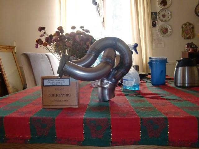

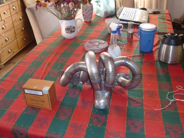

Engine is a F7r with H rods and wössner pistons, volvo s60R injectors and saab 9-5 aero turbo.

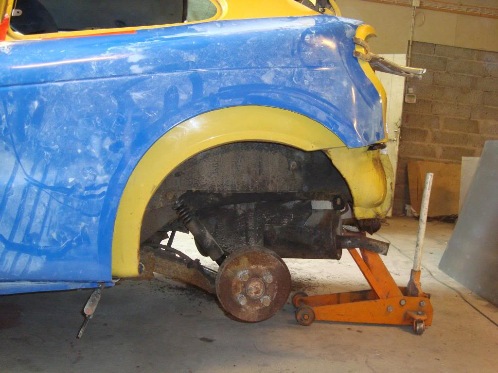

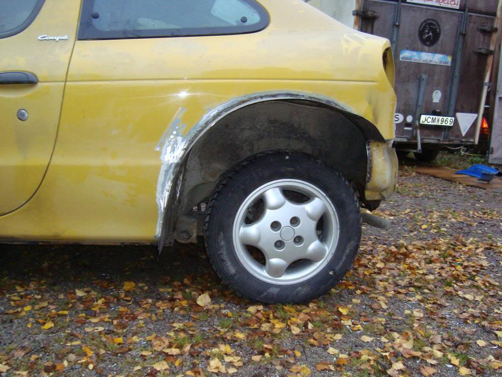

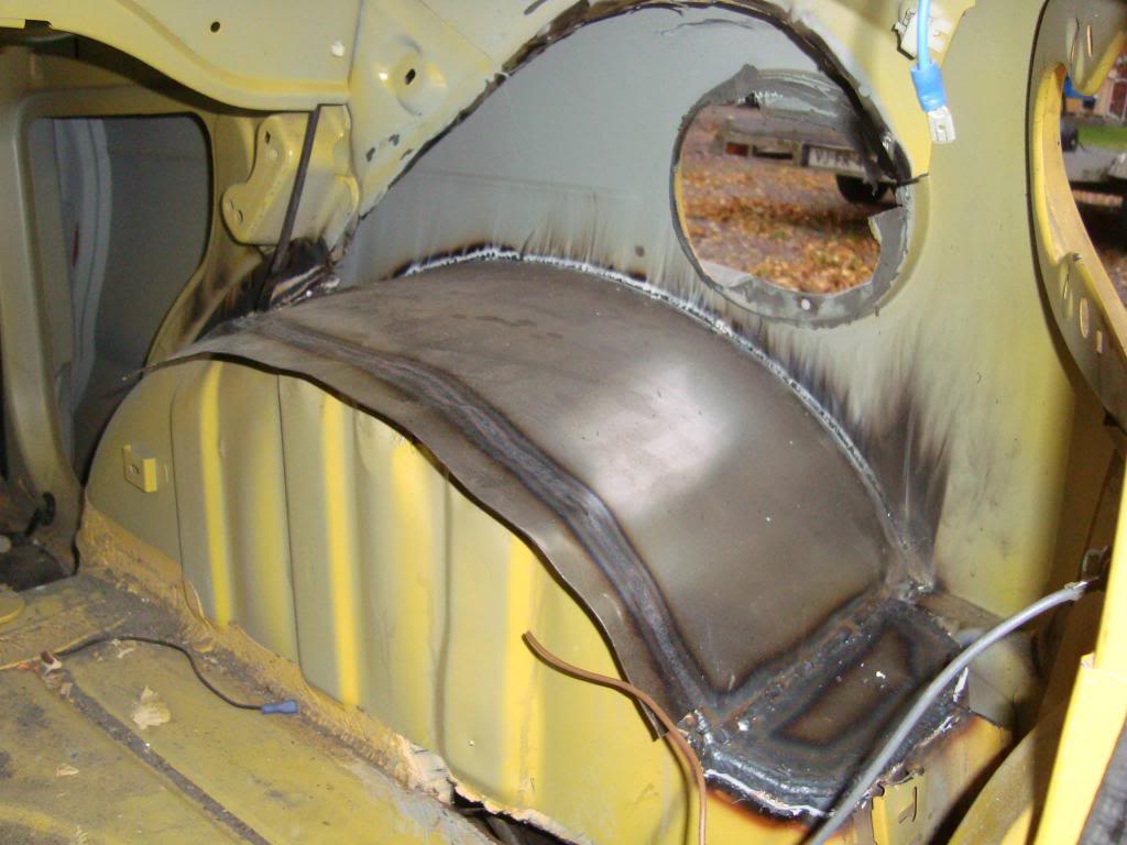

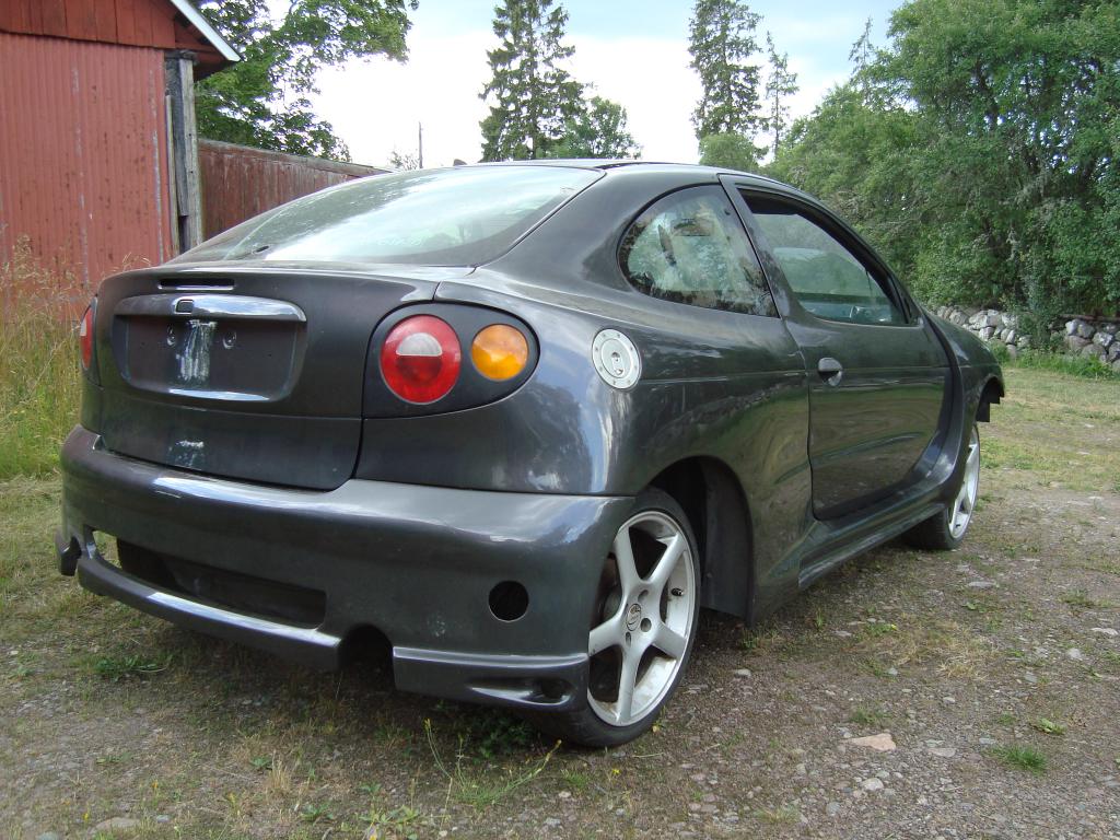

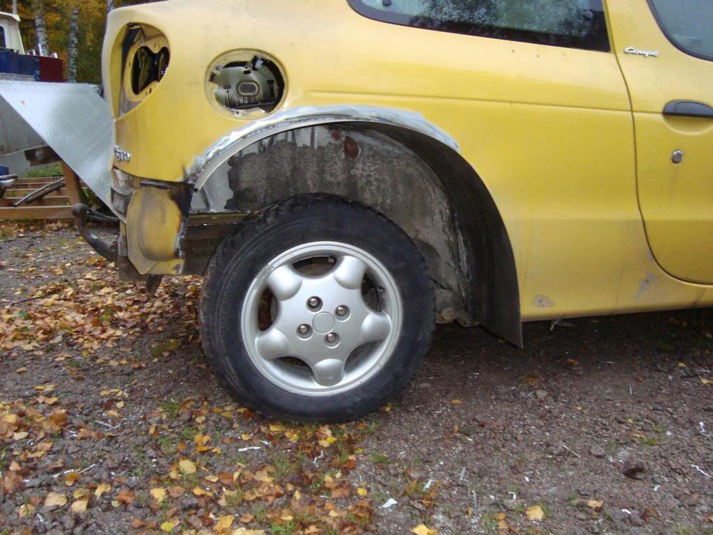

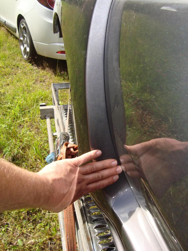

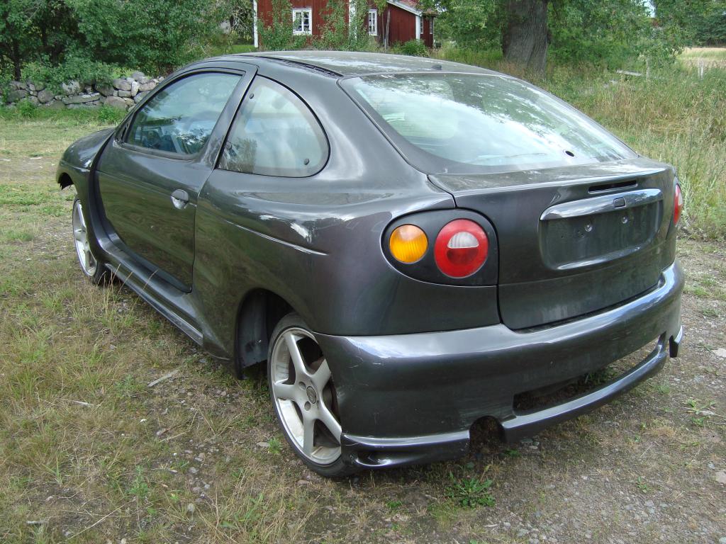

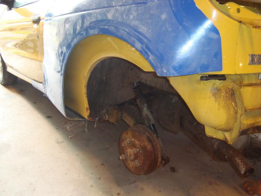

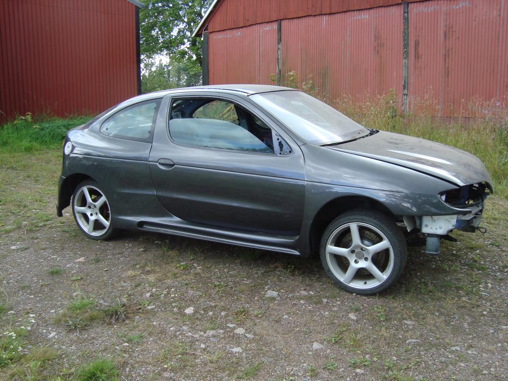

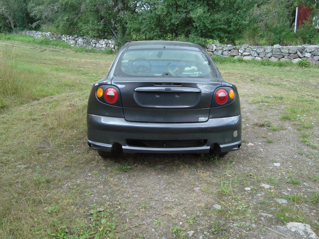

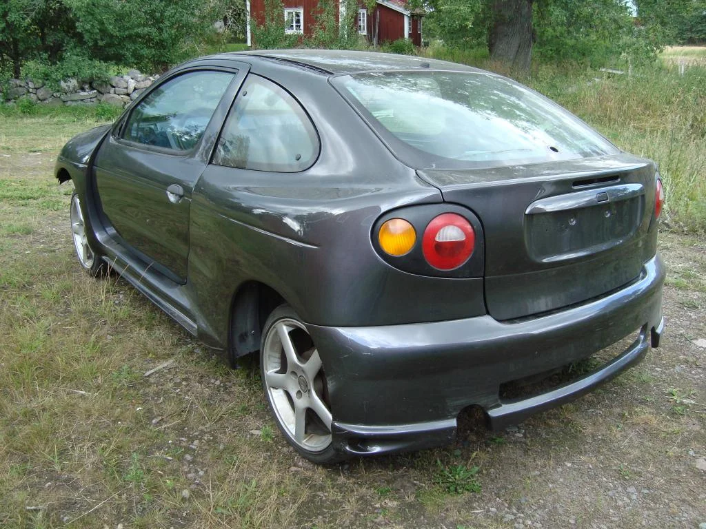

started to build rear arches on the 1,6 but now i have found a megane with maxi kit and new paint in a colour i was thinking (without engine and box )
so i will have to see how that turns out. it also has a megane cup rear axle
rear axle need to be wider so that is something that will take some time

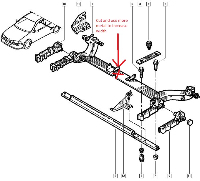

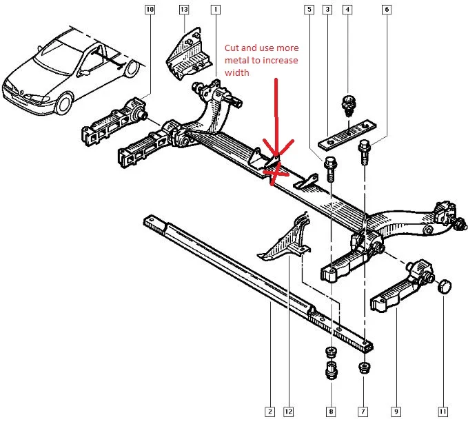

It is going to be hell of a job to remake both axles, never saw a single maxi project (original excluded) with wheels standing in a right position...
But if they did this back in 1998, why can't you? :) This project gonna be a pure art of mechanical engineering ;)
Came up with an idea while typing, lol: with a little bit of cutting and welding you could easily modify old torsion bar rear axle. Just need to re position rear dampers mounting points, cut old axle in half and make it longer and buy 4 custom made torsion bars (length increased).
But if they did this back in 1998, why can't you? :smile: This project gonna be a pure art of mechanical engineering :wink:
It has been done ...
you cant just cut it in half as you need to make the arms longer and not the fixing points, so if i do like you say i cant fit the axle in the air :)
will make other stubaxles with spacers and fit to my cup rear axle. front will be RS II spindles.
