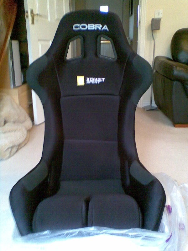

here:
  205Gti,HondaCBR600RR
The airbags won't be in the bucket seats so you will need resistors to stop the light coming on.
They're cobra's. You need to speak to them direct you can have pretty much anything embroidered in the fabric including the renault diamond and RS lettering. I had a set of sazukas with it done, they were one of the first sets in the country with the new font embroidered in them. I miss them :( great seats.
I cant remember what I paid tbh, they do vary depending what seat construction you have and material for the covers etc. 800ish probably isnt far of for two basic seats with cloth covers, the sidemounts, subframes and cheap harness'. Get the custom low subframes if you do get them, the standard ones are way too high. You will have to remove or cut down the plastic sill trims and the air ducts that are under the carpet and run from the centre console to the rear footwells though.

Do you have a site for a cobra supplier so i can weight up my options?
Just google cobra's website there's a sales line on there. It's only a couple of bits of plastic not like you're having to weld plates in or cut metalwork out. Nothing that can't be rectified cheaply and easily if you ever take them out and go back to standard.
