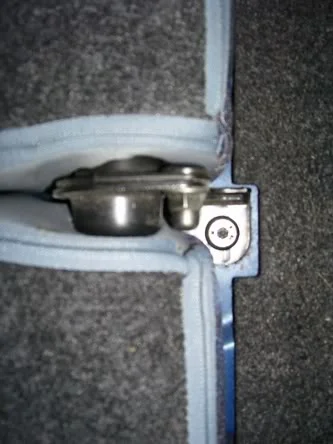

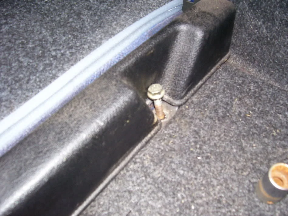

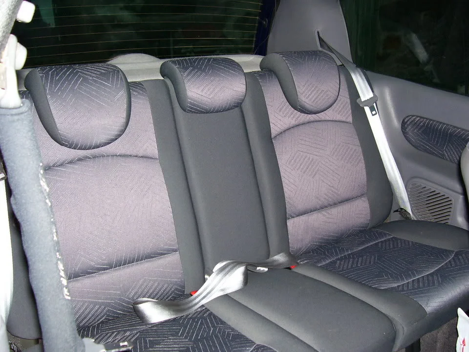

The rear seats are easy to change. Firstly take out the base (which is very easy) and then remove the black bar in the boot with a 17mm socket.
You can now get to the bolt holding the seat back in. Undo the bolt that is closest to the back, then you may have to loosen the front bolt.
Lift the sides out of the guides and slide the seat towards the boot. Refitting is just a reversal, but before you do that swap the rear side cards over whilst you have the space.

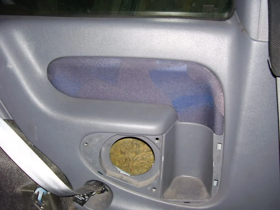

To change the rear doorcards

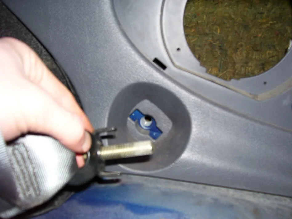

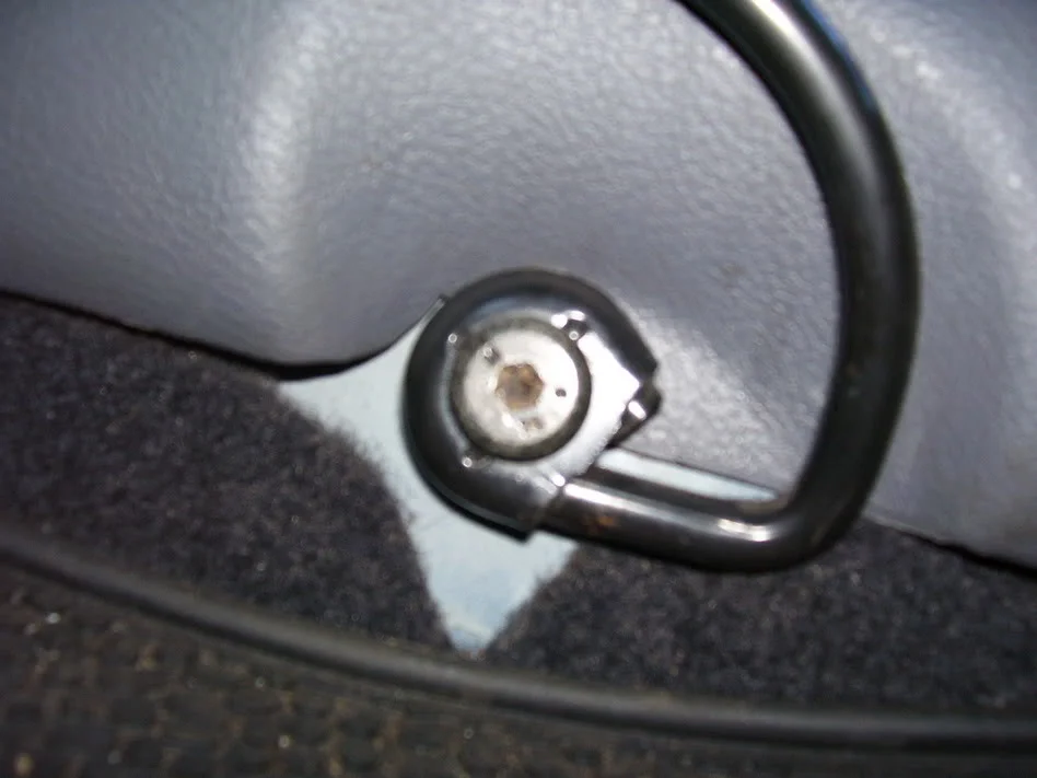

unbolt both the rear seatbelt
and the front one,
(pic coming soon, but you have to undo the bolt in the black bar, raise it to vertical and wiggle it out) then carefully prise the card off having already removed the speaker or at least the wiring.
The front doorcards (pics coming soon) are a little more complicated. On my mk2 ph1 I actually needed to extend the electric window switch wires by about 4 inches. Firstly remove the speaker cover then the speaker and then the window switches. Next remove the screw holding the handle on and remove the cable from it. Remove the grab handle screw and pull this out. You then have to remove the bit of plastic running up to the top of the door at the rear and pull off the plastic that cover the mirror mountings. Now undo the four screws at the bottom of the door. The only things holding the panel on are a few plastic clips and very sticky black stuff. Gently pull the panel away from the door and cut the black stuff away. Again its just a reversal for fitting the new one.

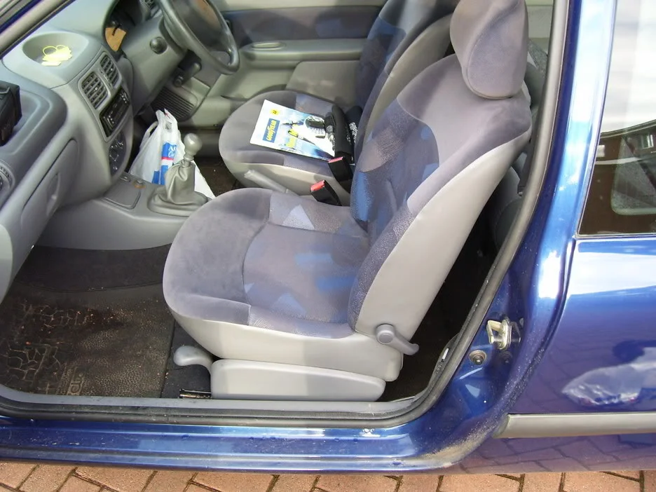

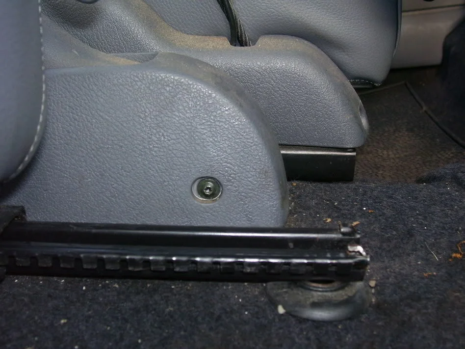

There are 2 ways to remove the front seats, one is to go underneath the car and undo the 4 bolts that hold the subframe in and the other is described here.

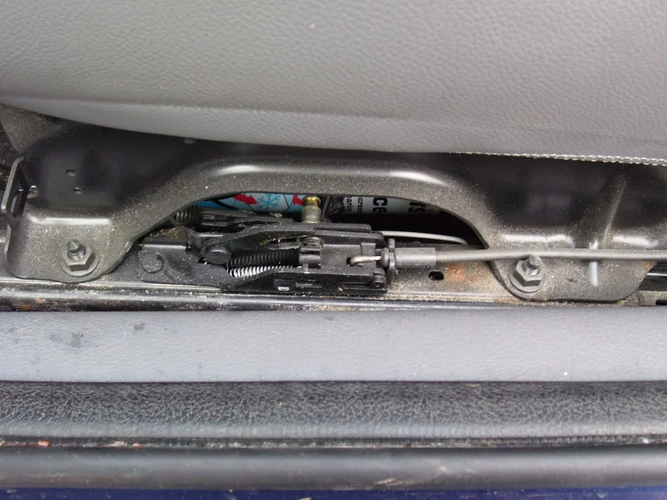

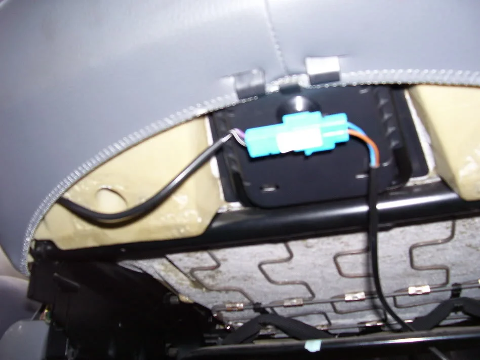

The front seats are daunting but easy enough. Firstly disconnect the battery and wait for at least 5 minutes and undo the wires underneath the seats,

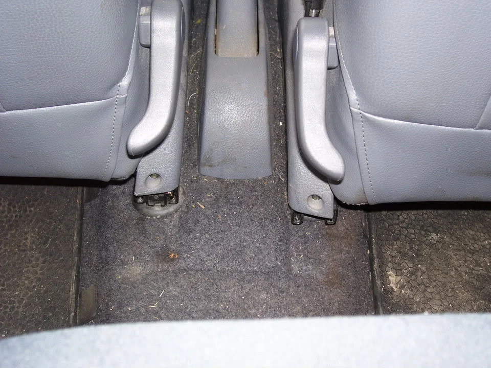

then remove the plastic side covers at each side of the seat
at the base of the seat using a torx socket to undo the screw and push them towards the front of the car. Unscrew the handbrake surround with the same torx socket and lift this over the handbrake to allow better access.

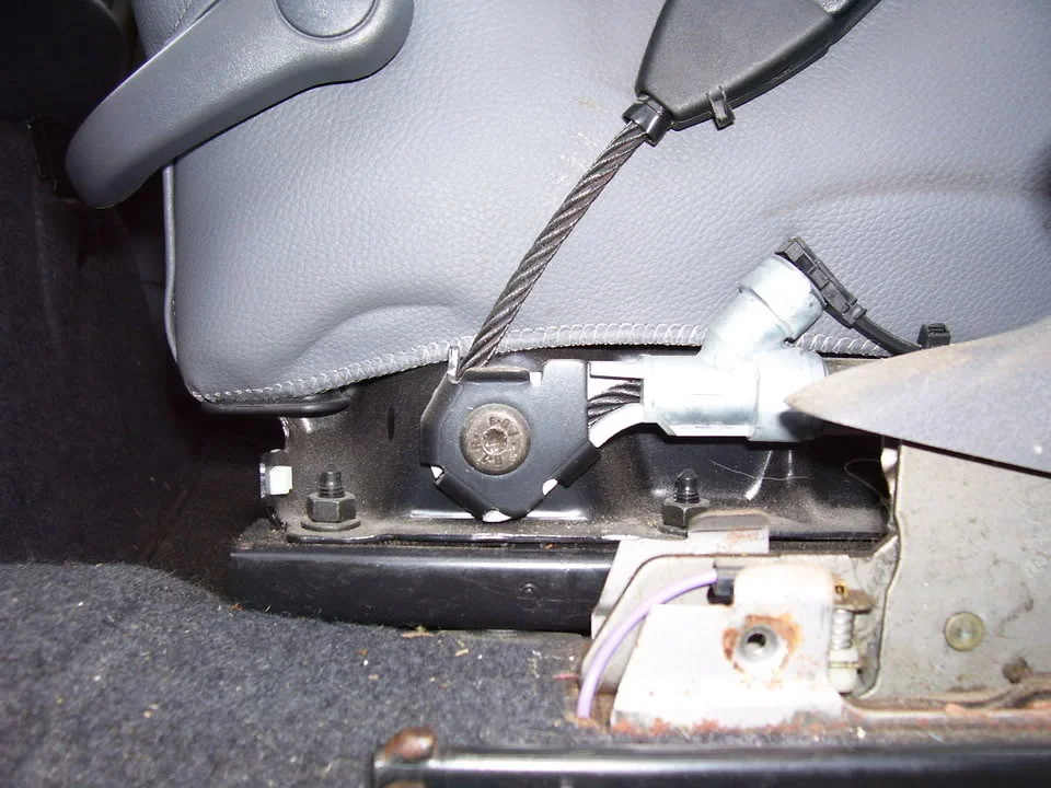

Remove the seat belt holder/pretensioner

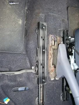

so you can see all the bolts underneath the pretensioner. Then remove the wire running from the seat to the subframe that operates the lift function

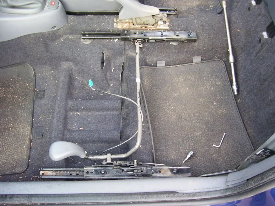

On one side there are 2 bolts
and the other side there are 3 bolts
so just undo all of these and the seat will come out leaving the subframe in the car.

Its a 13mm or 1/2 socket for the black bar John sir! (I felt the 1/2 fitted better)

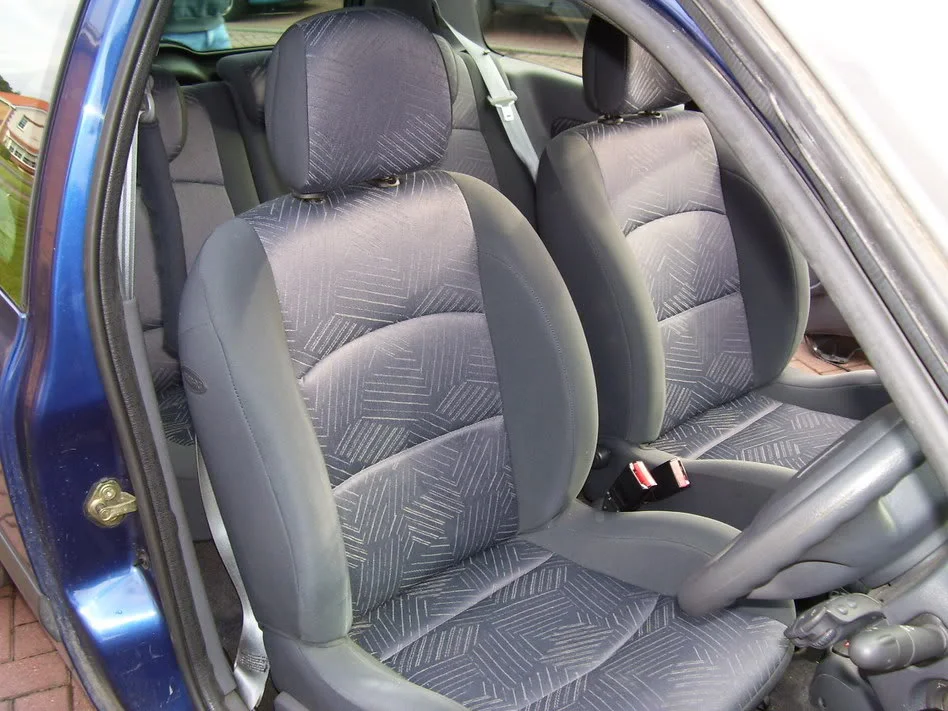

Seats are lush - full 2005 182 interior for the bargain price of £420!
Cheap for a set of minters seen 2000 interiiors for that price bet you snapped his hand off You must have got lucky with the bolt in the rears i had to drill the fcuker out the rest was easy
I am well chuffed...had to drive to Swansea to pick em up tho which was the only downside. The ebay link was posted on here and I thought loads of people would be bidding on it but I sneaked in in the last 10secs and got it!
There is one slight scuff on the rear seat but it's a 10min job to tidy up.
