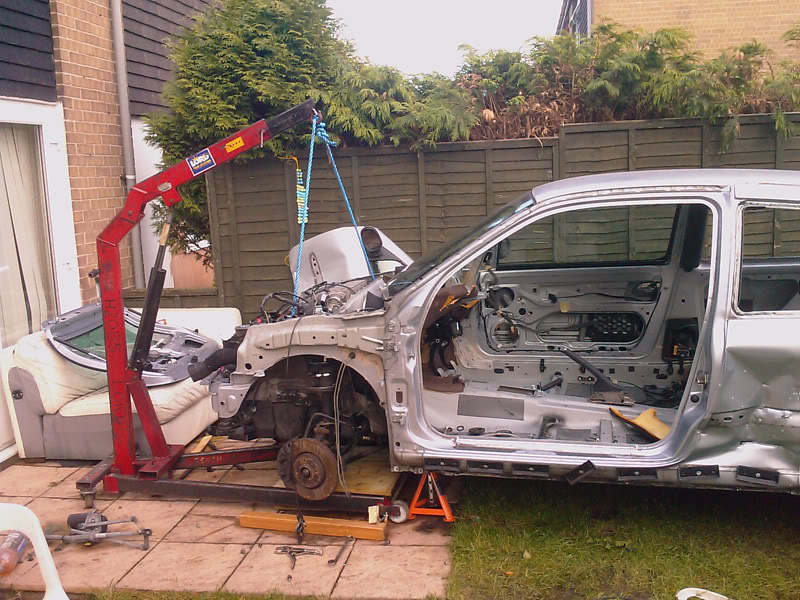

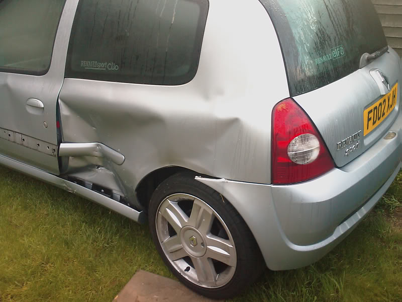

found these pics, dont know if they are of some use
The fixings rivet onto the side of the car, with the open bit of the triange facing out, and the shortest side at the bottom. the sideskirts then have a lip on the top which hooks over the top of the plastic fixings.
Then just a case of sticking a screw into the the skirt under the front wheel arches, and rivetting them into the sills.
