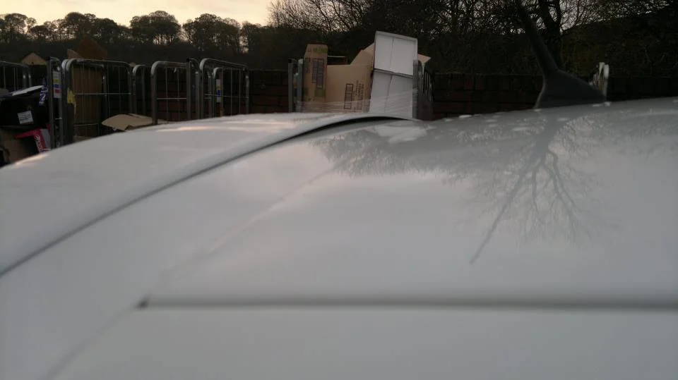

so it went in today what i hoped for the last time to have the high level brake light sorted on the spoiler.
got it back, spoiler not fitted correctly, massive gap at the roof. it goes back in monday.... lol
service manager still on holiday so struggling to get anywhere other than a polite little lass who does try her best to help but clearly doesnt have the power to put things right their and then!
